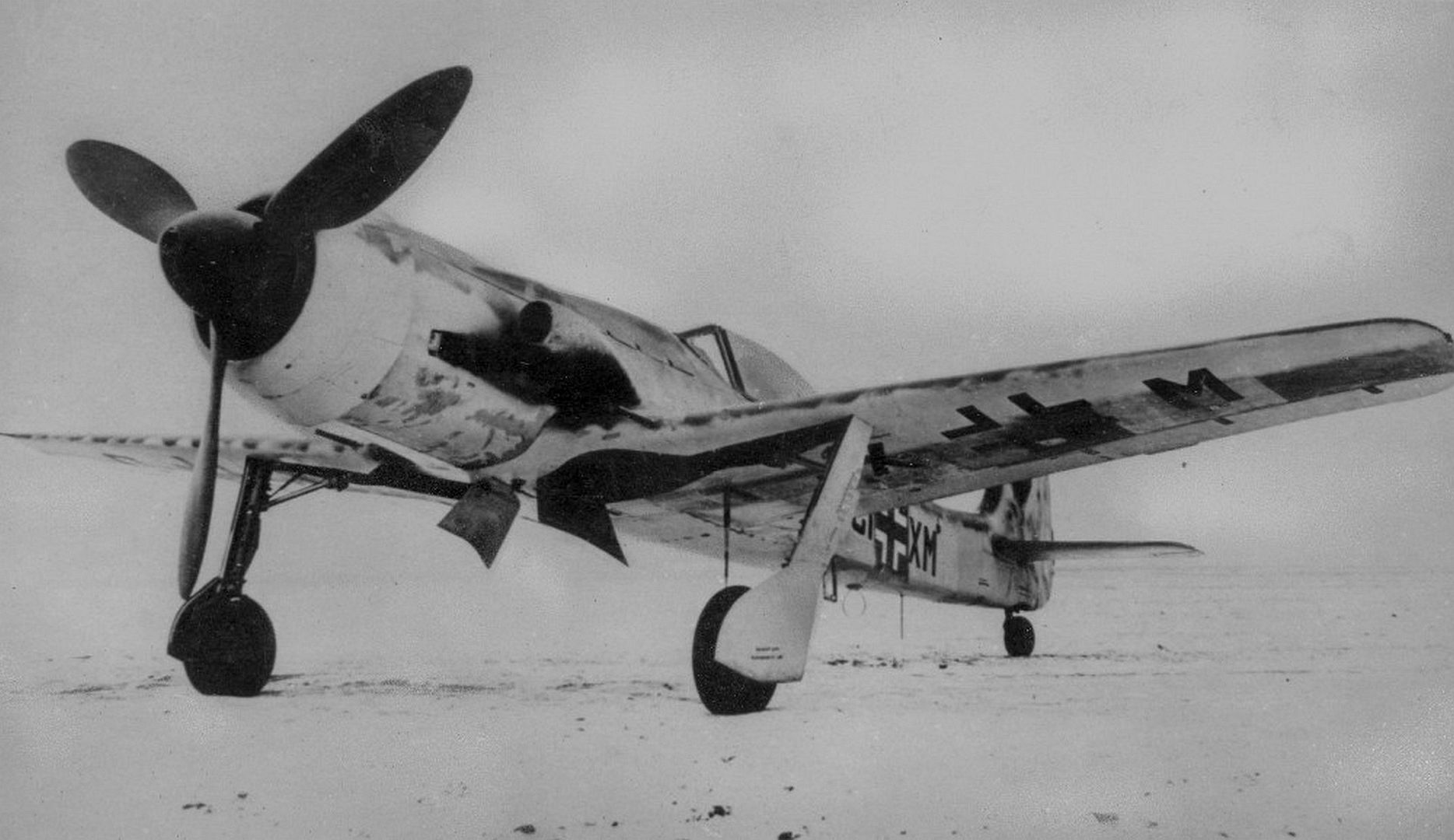

Below TA-152-W-Nr006
Below Focke-Wulf Ta.152V-7 (Ta.152C-0-R11) CI+XM serial number of the machine (W.Nr.110007) at the airfield in the city of Langenhagen

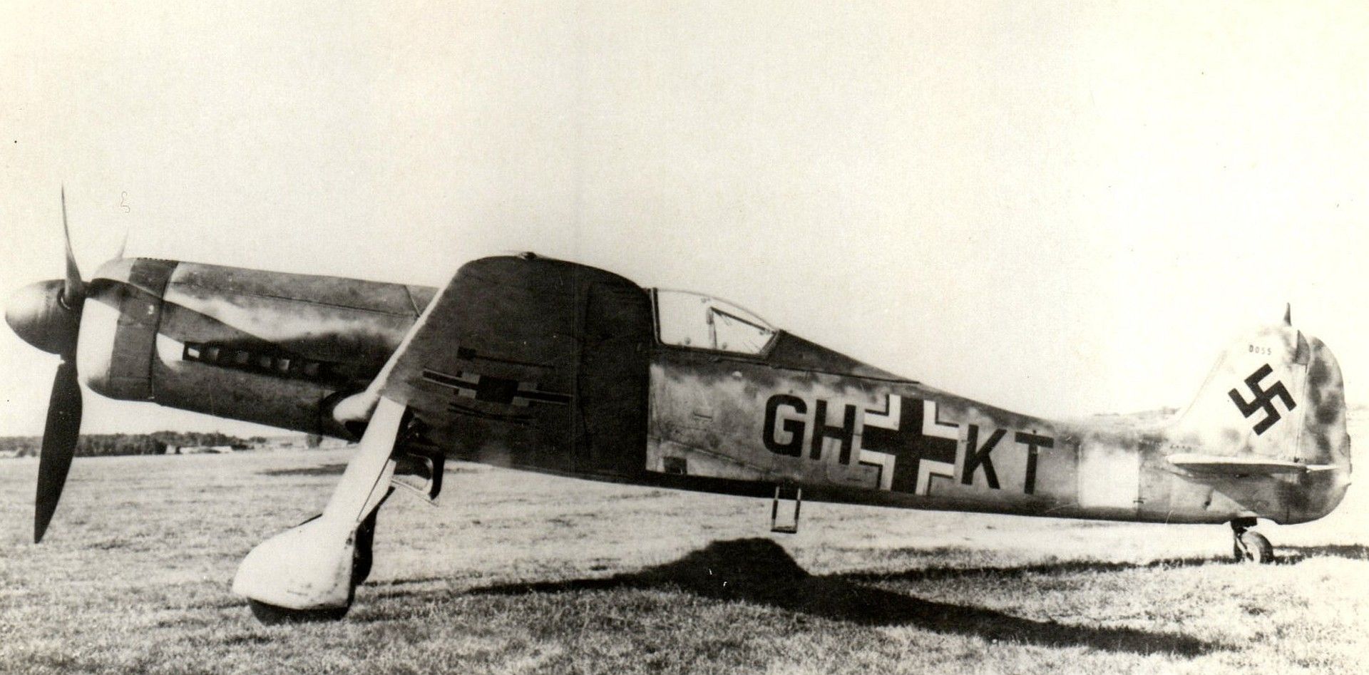

Below TA-152 GH-KT Wr Nr 0055

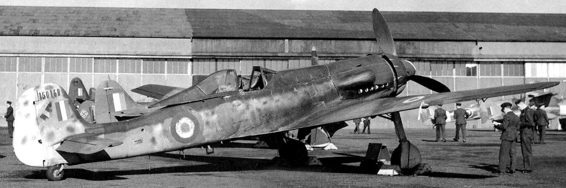

Below Focke-Wulf Ta 152H-1 (Wk. Nr. 150168)

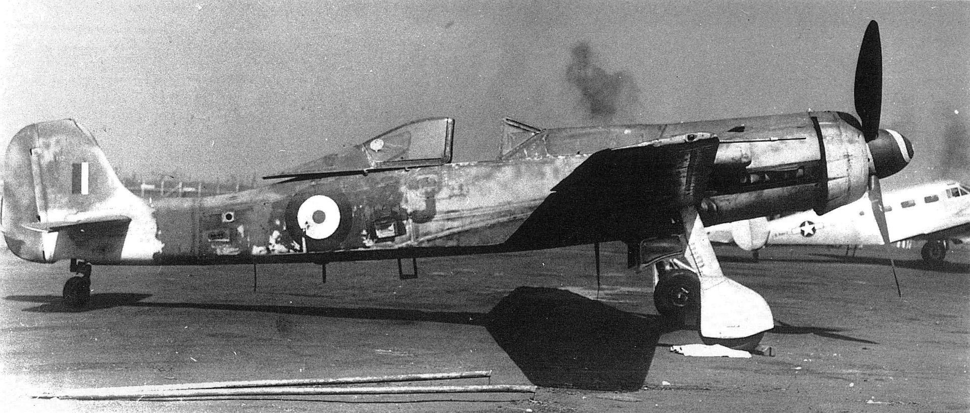

Below Focke-Wulf Ta.152H-0 (Werk Nr 150010) The NASM plane, the last Ta.152 in existence, is a pre-production Ta.152H-0 model. For many years it was described (wrongly) as Werk Nr 150003. It is now thought to be Werk Nr.150010. This places the airframe in the range of pre-production H-0 models, a variant marking the transition from the Ta.152 prototypes to full production Ta.152H-1 airplanes. It was probably built at Focke-Wulf's production facility at Cottbus, Germany, in December 1944, and delivered by Erprobungskommando Ta.152 at Rechlin, Germany, for service testing with the Geschwaderkennung CW+CJ. Transferred to the operational Luftwaffe unit JG 301 where it became 'Yellow 4' with II/JG 301 and the Yellow/Red RGV bands were painted on its aft fuselage. It ended up with the staff flight (Geschwader Stab) of JG 301 where it was coded 'Green 4', and the green bar was painted over the RGV bands. It was flown operationally by Ofw Walter Loos in 1945. As the Soviets rolled over eastern Germany, many Luftwaffe pilots took off and steered their mounts west; they preferred to be captured by the Western forces. Surrendered to British forces at Tirstrup, Denmark. Flown by the RAF to Aalborg, Denmark, for servicing. Handed over to Col Watson. Flown to Melun/Villaroche (A-55), France. Later flown to Querqueville (A-23), Cherbourg, France. Operation Seahorse. HMS Reaper loading number 32. Shipped to the USA on the Royal Navy escort carrier HMS Reaper 19Jul45 arriving at the Military Ocean Terminal, Bayonne, New Jersey 31Jul45. Barged to Atlantic Overseas Air Materiel Center, Newark Field, New Jersey. Foreign Equipment Branch, Technical Data Laboratory, Air Technical Service Command, Wright Field, Dayton, Ohio 1Aug45. Assigned FE-112.

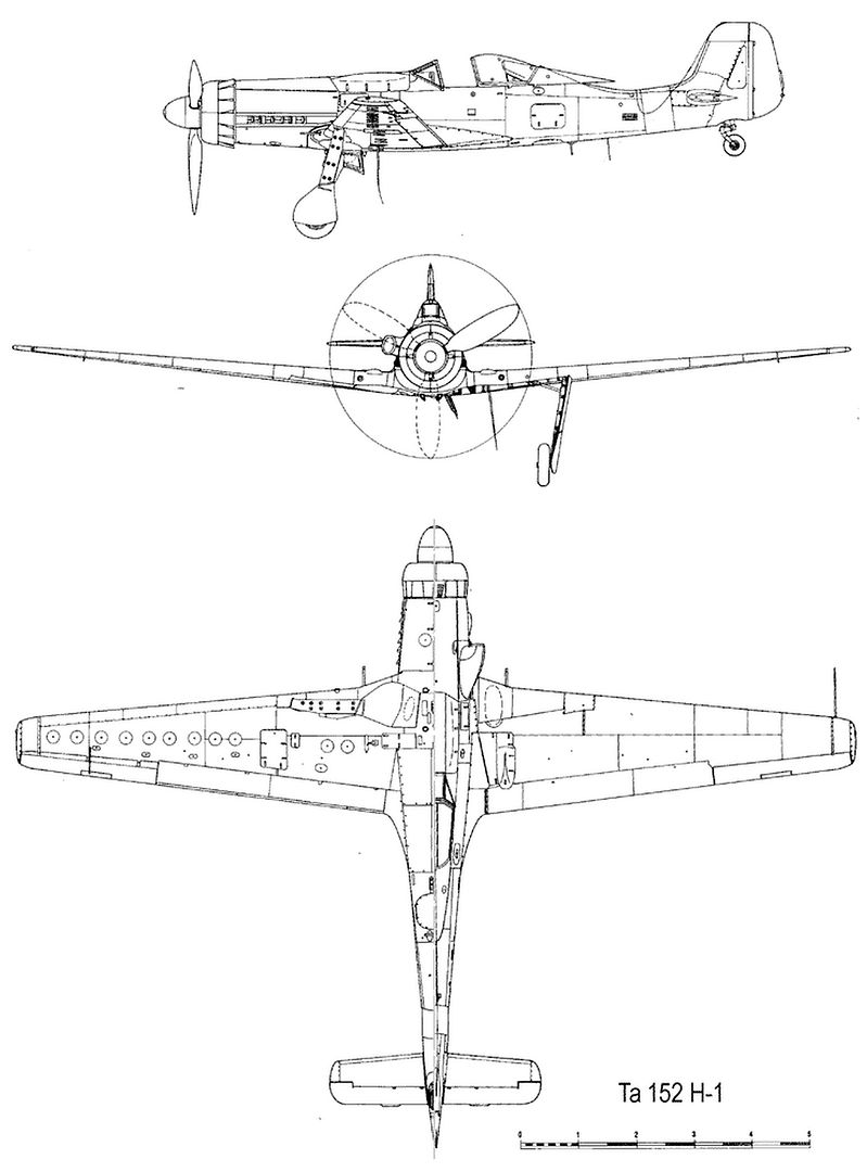

Specifications (Ta 152 H-1)
Crew: one
Length: 10.82 m (35 ft 6 in)
Wingspan: 14.44 m (47 ft 5 in)
Height: 3.36 m (11 ft 0 in)
Wing area: 23.5 m2 (253 sq ft)
Airfoil: root: NACA 23015.3; tip: NACA 23009
Empty weight: 3,877 kg (8,547 lb)
Gross weight: 5,217 kg (11,502 lb)
Max takeoff weight: 5,217 kg (11,502 lb)
Fuel capacity: 992 L (262 US gal; 218 imp gal)
Powerplant: 1 × Junkers Jumo 213E or Junkers Jumo 213E-1 V-12 inverted liquid-cooled piston engine, 1,287 kW (1,726 hp) for take-off
1,530 kW (2,050 hp) for take-off with MW-50 water/methanol injection
940 kW (1,260 hp) at 10,700 m (35,100 ft) with GM-1 Nitrous Oxide injection
Propellers: 3-bladed Junkers VS-9 constant-speed propeller
Maximum speed: 580 km/h (360 mph, 310 kn) at sea level with MW-50 boost
759 km/h (472 mph; 410 kn) at 12,500 m (41,000 ft) with GM-1 boost
Range: 2,000 km (1,200 mi, 1,100 nmi)
Service ceiling: 15,100 m (49,500 ft) with GM-1 boost
Rate of climb: 20 m/s (3,900 ft/min) at maximum weight of 5,217 kg (11,502 lb)
25.4 m/s (83 ft/s) at 4,727 kg (10,421 lb)
Time to altitude: 10,000 m (33,000 ft) in ten minutes and six seconds
Wing loading: 196.8 kg/m2 (40.3 lb/sq ft)
Power/mass: 0.276 kW/kg (0.168 hp/lb)
1 × 30 mm (1.181 in) MK 108 cannon 85 rds
2 × 20 mm (0.787 in) MG 151/20 cannon 350 rds
