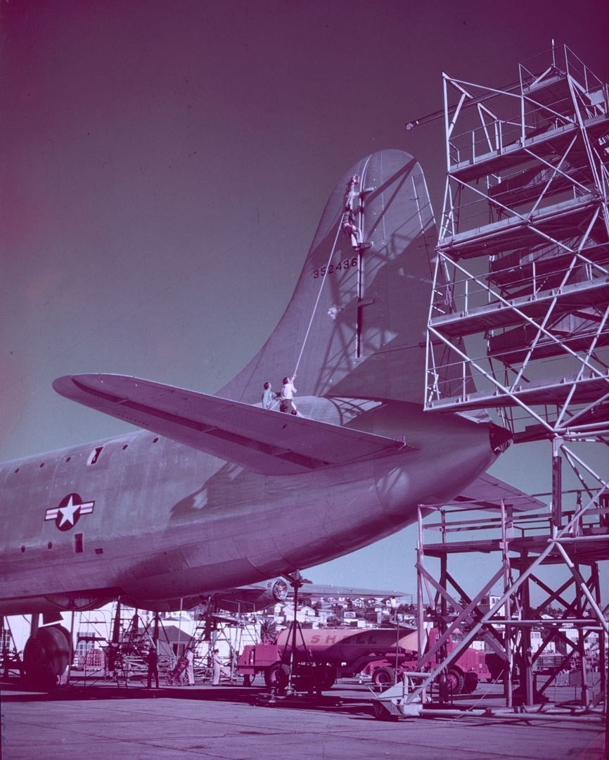

The XB-36 was generally much like the original Model 36 proposal, differing mainly in being fitted with a conventional single-fin tail assembly instead of the twin fins envisioned at the outset. The prototype was unarmed and not fitted with operational kit. It had tricycle landing gear, with single-wheel main gear. The main gear tires were ridiculously huge, with a diameter of 2.8 meters (9 feet 2 inches), and landings were hard on both tires and tarmac.
The XB-36 was experimentally fitted with tracked landing gear, but it only flew once in that configuration, the landing gear not holding up well to the exercise.
The second prototype performed its initial flight on 4 December 1947, again with Beryl Erickson at the controls. It was designated "YB-36"; it initially had the single-wheel main gear, but was later refitted with much more practical four-wheel bogies. The YB-36 also had a raised "bugeye" cockpit instead of the conventional cockpit of the XB-36.

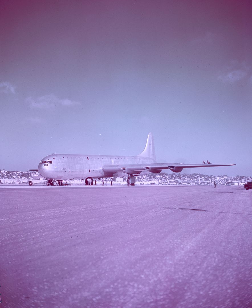

XC-99
From 1942, even as Consolidated was (slowly) working on getting the XB-36 out the door during World War II, the company was considering a transport version of the bomber, the "Model 37". The plan was to use the same wings, engine, tail, and many subsystems of the XB-36 mated to a double-decker fuselage, with seating for 400 troops, rivaling a modern jumbo jet.
As with the XB-36 itself, development of the Model 37 was a low priority, and the sole prototype, designated the "XC-99", didn't fly until 23 November 1947. By that time, the military had decided they didn't need such a big cargolifter after all, and the airlines had lost interest in the concept. However, the single prototype did go into service with the Air Force, acquiring a nose radome, and remained in operation until 1957.
