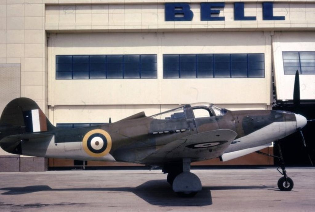

Main AdminIn 1940, the British Direct Purchase Commission in the U.S. was looking for combat aircraft; they ordered 675 of the export version Bell Model 14 as the "Caribou" on the strength of the company's representations on 13 April 1940. The British armament was two nose mounted 0.50 in (12.7 mm) machine guns, and four 0.303 in (7.7 mm) Browning machine guns in the wings; the 37 mm gun was replaced by a 20 mm (.79 in) Hispano-Suiza.
British expectations had been set by performance figures established by the unarmed and unarmored XP-39 prototype. The British production contract stated that a maximum speed of 394 mph (+/- 4%) was required at rated altitude. In acceptance testing, actual production aircraft were found to be capable of only 371 mph at 14,090 ft. To enable the aircraft to make the guarantee speed, a variety of drag reduction modifications were developed by Bell. The areas of the elevator and rudder were reduced by 14.2% and 25.2%, respectively. Modified fillets were installed in the tail area. The canopy glass was faired to its frame with putty. The gun access doors on the wing had been seen to bulge in flight, so they were replaced with thicker aluminum sheet. Similarly, the landing gear doors deflected open by as much as two inches at maximum speed, so a stronger linkage was installed to hold them flush. The cooling air exit from the oil and coolant radiators was reduced in area to match the exi t velocity to the local flow. New engine exhaust stacks, deflected to match the local flow and with nozzles to increase thrust augmentation, were installed. The machine gun ports were faired over, the antenna mast was removed, a single piece engine cowling was installed and an exhaust stack fairing was added.
The airframe was painted with 20 coats of primer, with extensive sanding between coats. Standard camouflage was applied and sanded to remove the edges between the colors. Additionally, about 200 pounds of weight was removed, making it lighter than normal (7,466 lbs gross). After these modifications, the second production aircraft (serial AH 571) reached a speed of 391 mph at 14,400 ft, in flight test. As this speed was within 1% of the guarantee, the aircraft was declared to have satisfied contractual obligations. Despite the success of these modifications, none were applied to other production P-39s. Later testing of a standard production P-400 by the Aeroplane and Armament Experimental Establishment (A&AEE) revealed a top speed of only 359 mph.
The British export models were renamed "Airacobra" in 1941. A further 150 were specified for delivery under Lend-lease in 1941 but these were not supplied. The Royal Air Force (RAF) took delivery in mid 1941 and found that performance of the non-turbo-supercharged production aircraft differed markedly from what they were expecting. In some areas, the Airacobra was inferior to existing aircraft such as the Hawker Hurricane and Supermarine Spitfire and its performance at altitude suffered drastically. Tests by the R.A.E at Boscombe Down showed the Airacobra reached 355 mph (571 km/h) at 13,000 ft (3,962 m). The cockpit layout was criticized, and it was noted that the pilot would have difficulty in bailing out in an emergency because the cockpit roof could not be jettisoned. The lack of a clear vision panel on the windscreen assembly meant that in the event of heavy rain the pilot's forward view would be completely obliterated; the pilot's notes advised that in this case the door windows would have to be lowered and the speed reduced to 150 mph (241 km/h) On the other hand it was considered effective for low level fighter and ground attack work. Problems with gun and exhaust flash suppression and the compass could be fixed.
No. 601 Squadron RAF was the only British unit to use the Airacobra operationally, receiving their first two examples on 6 August 1941. On 9 October, four Airacobras attacked enemy barges near Dunkirk, in the type's only operational action with the RAF. The squadron continued to train with the Airacobra during the winter, but a combination of poor serviceability and deep distrust of this unfamiliar fighter resulted in the RAF rejecting the type after one combat mission. In March 1942, the unit re-equipped with Spitfires.
The Airacobras already in the UK, along with the remainder of the first batch being built in the US, were sent to the Soviet Air force, the sole exception being AH574, which was passed to the Royal Navy and used for experimental work, including the first carrier landing by a tricycle undercarriage aircraft on 4 April 1945 on HMS Pretoria Castle, until it was scrapped on the recommendation of a visiting Bell test pilot in March 1946.
