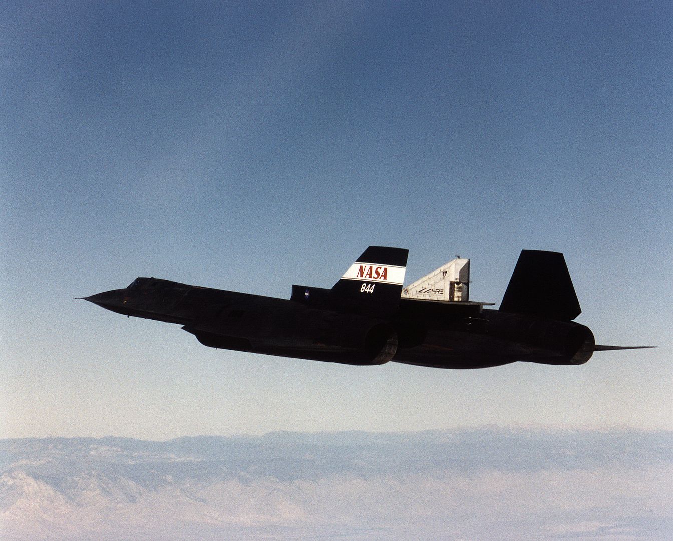

3 December 1975: First flight of SR-71A (AF Ser. No. 61-7959) in "big tail" configuration

25 July 1991: SR-71B, AF Ser. No. 61-7956/NASA No. 831 officially delivered to NASA Dryden Flight Research Center at Edwards AFB, California

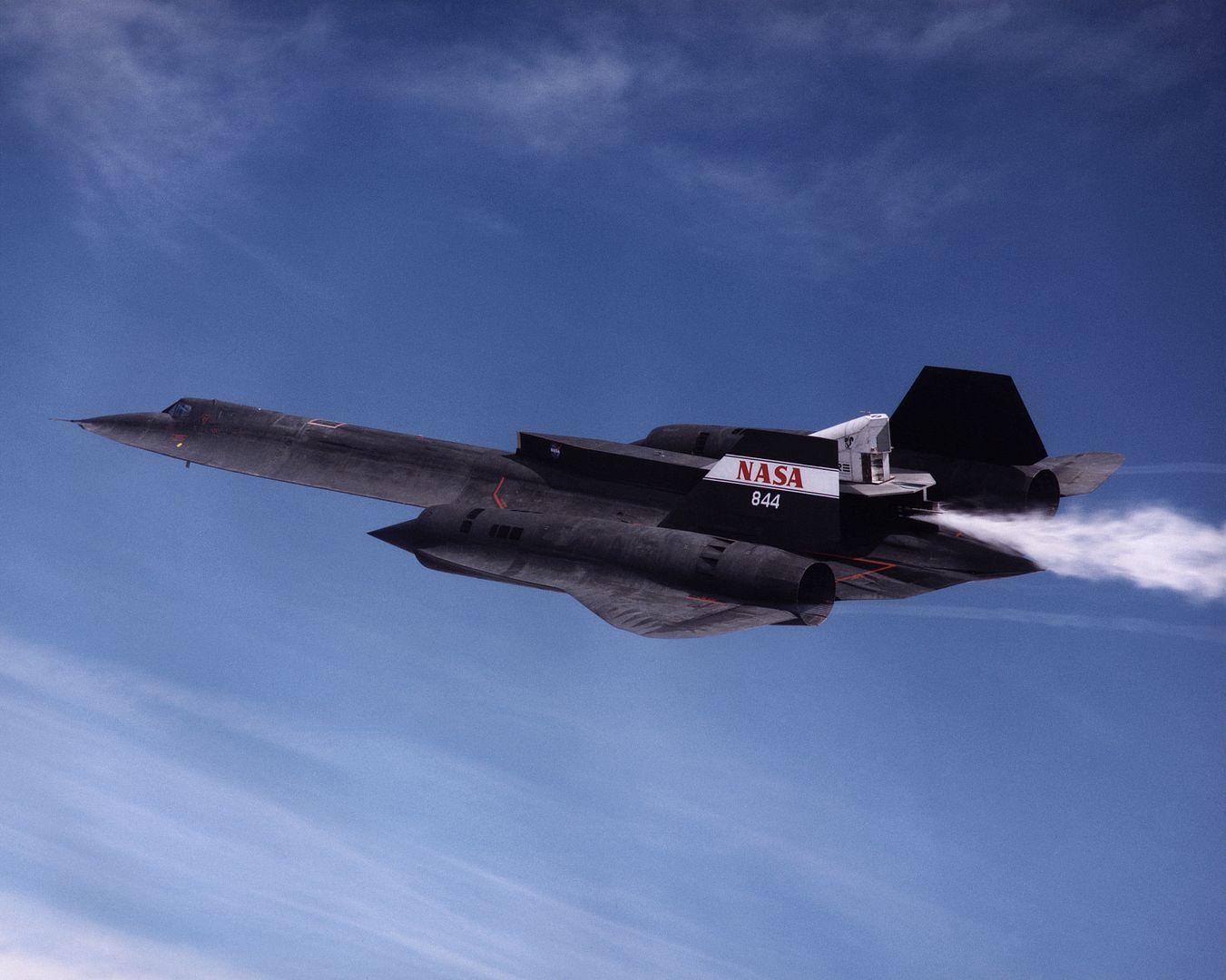

9 October 1999: The last flight of the SR-71 (AF Ser. No. 61-7980/NASA 844)
