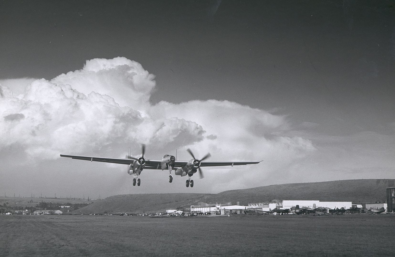

    The second prototype, 44-70156, was fitted with conventional propellers and flown by Hughes on 5 April 1947, after he had recuperated from his injuries. Initially, the USAAF had insisted that Hughes not be allowed to fly the aircraft, but after a personal appeal to Generals Ira Eaker and Carl Spaatz, he was allowed to do so against posting of $5 million in security.The USAAF also required that the aircraft be trucked from Culver City to Muroc Dry Lake for the flight, fearing the repercussions of another crash in a populated area.
    This test flight was uneventful, and the aircraft proved stable and controllable at high speed. It lacked low-speed stability, however, as the ailerons were ineffective at low altitudes. When the USAAF evaluated it against the Republic XF-12, testing revealed the XF-11 was harder to fly and maintain, and it was projected to be twice as expensive to build. An F-12 production order was issued, but the USAAF ultimately canceled it in favor of the RB-50 Superfortress and Northrop F-15 Reporter, both of which had similar long-range photo-reconnaissance capability and were available at a much lower cost.
