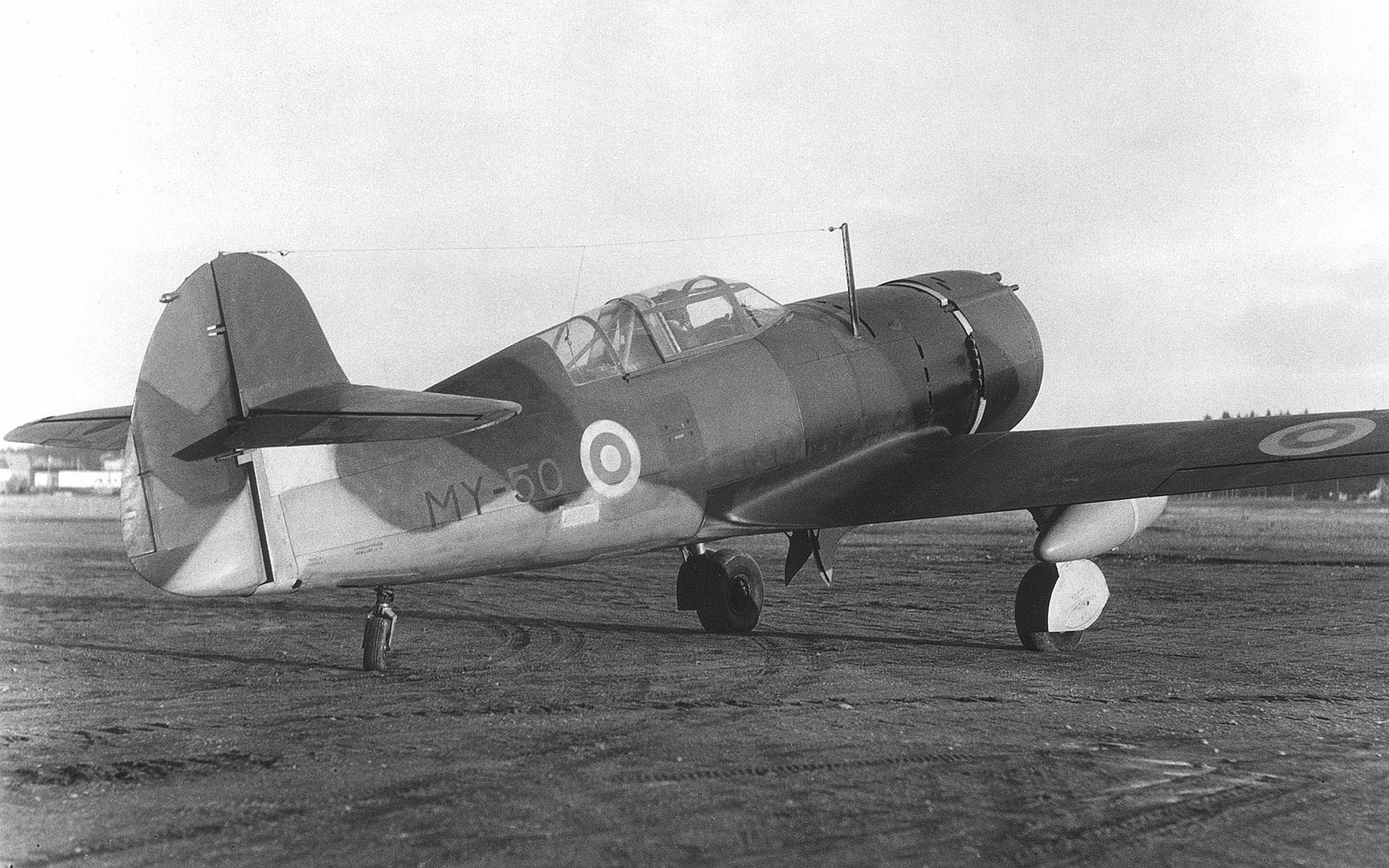

    Due to difficulties obtaining duraluminium, the wings were made out of plywood and the fuselage was metal structure with a fabric and plywood skin. The planned Bristol Taurus III engine was not available due to war, so a Pratt & Whitney R-1830 (civil Twin Wasp) was chosen. Availability of this engine was also problematic, so the first prototype used an R-1830-S3C3-G, while later prototypes and production fighters used less-powerful SC3-Gs. Finland bought these engines from German war booty stocks.
    The first Myrsky prototype flew on 23 December 1941.The prototype was fully functional, but too heavy. After some modifications they soon had three new prototype aircraft. The test flights showed some structural problems during high-speed tests. All three prototypes were destroyed during test flights; two test pilots died, one was seriously injured. The culprit was found to be aeroelastic flutter, which was a poorly known phenomenon at the time. Resolving the flutter problem took almost a year.

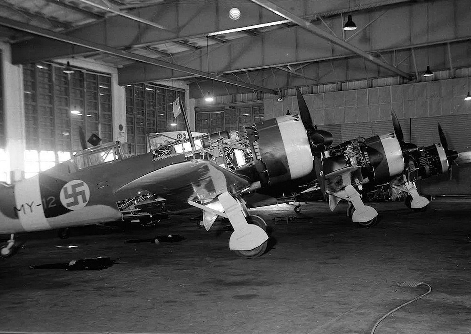

    Series production started in autumn 1942 far before German deliveries of Messerschmitt Bf 109 had begun in 1943. The series production version was called the Myrsky II. 47 Myrsky IIs were built and together with the Myrsky I version and Myrsky prototype the production amounted to 51 in all. Although the aircraft met the specifications set for it, it did not fulfill all expectations due to structural problems.

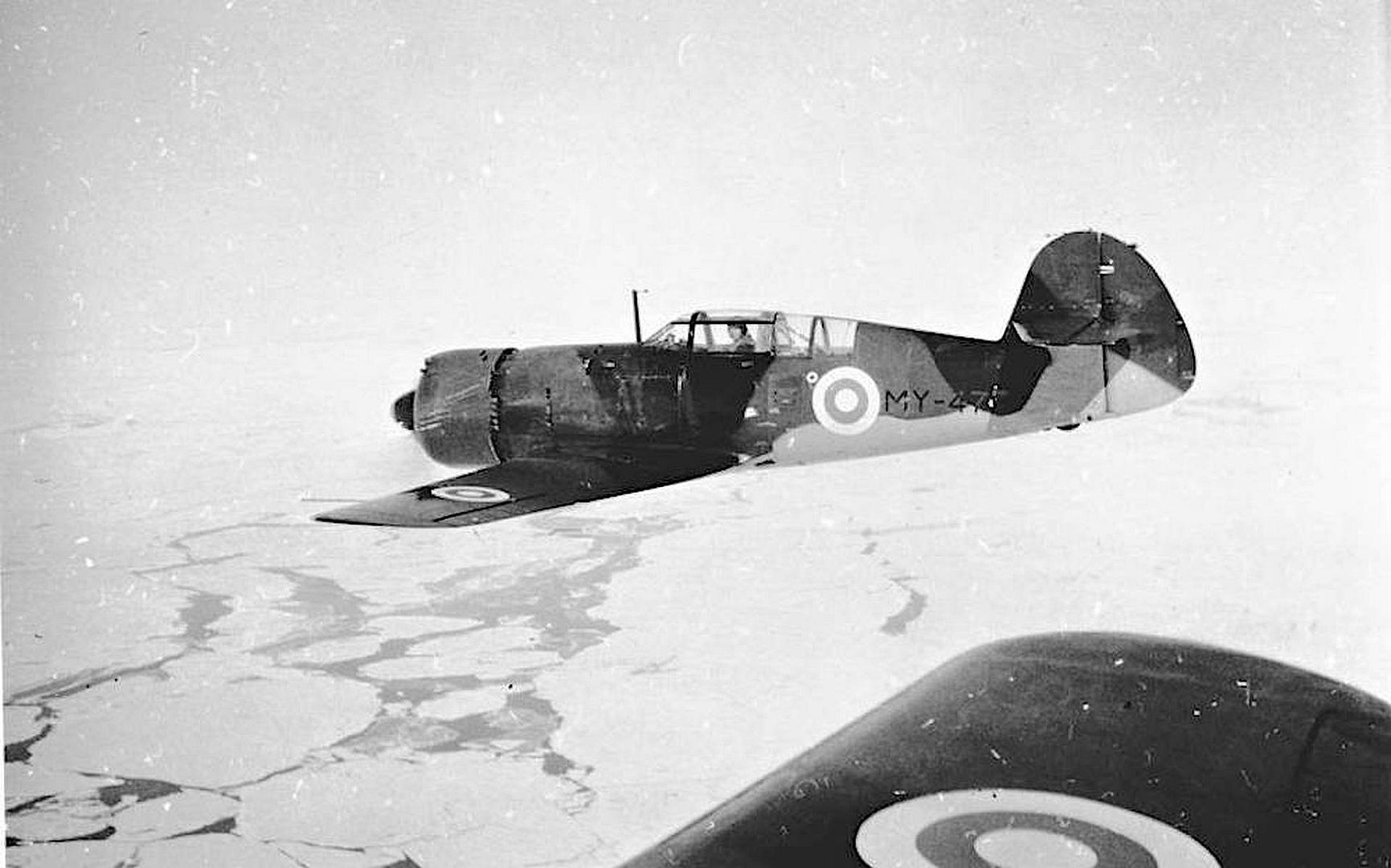

    Reconnaissance Squadron 12 received their first Myrskys during August 1944. Thirty Myrskys were delivered to Reconnaissance Squadrons 12 and 16 before the end of the Continuation War.

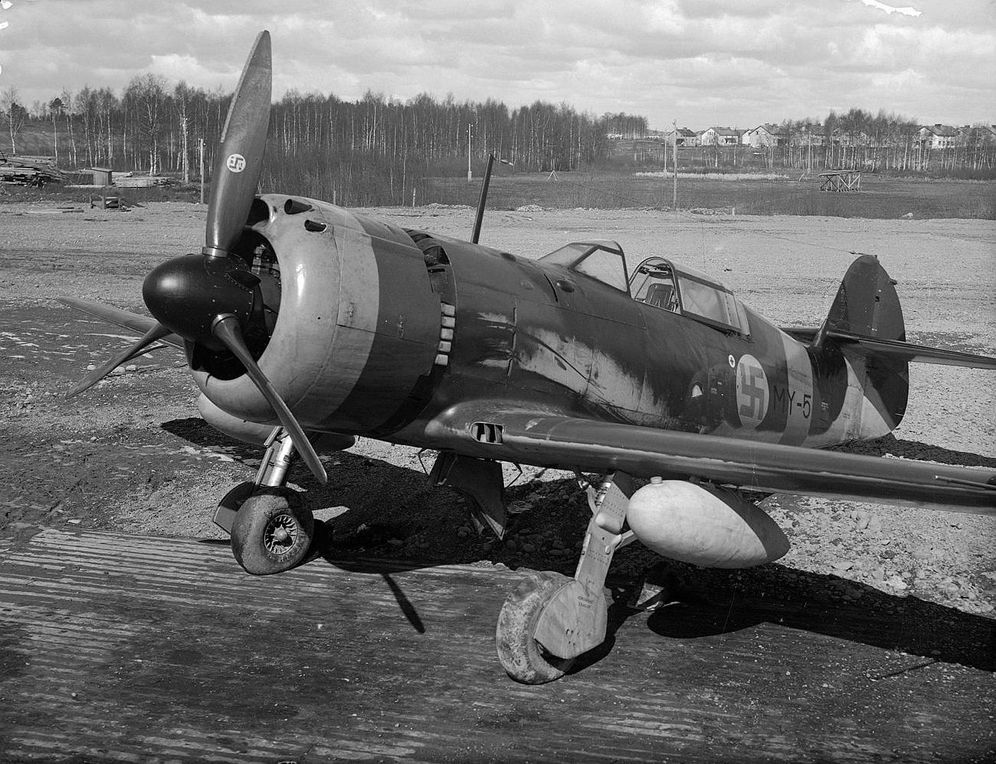

    Fifteen Myrsky fighters flew 68 missions during the Continuation War. During one mission, they met Soviet Yak-7s, but the fight ended without losses for either side. During two other missions, Myrskys damaged two Soviet fighters, which were both destroyed on landing. Six Myrskys took part in a bombing mission on 3 September 1944.

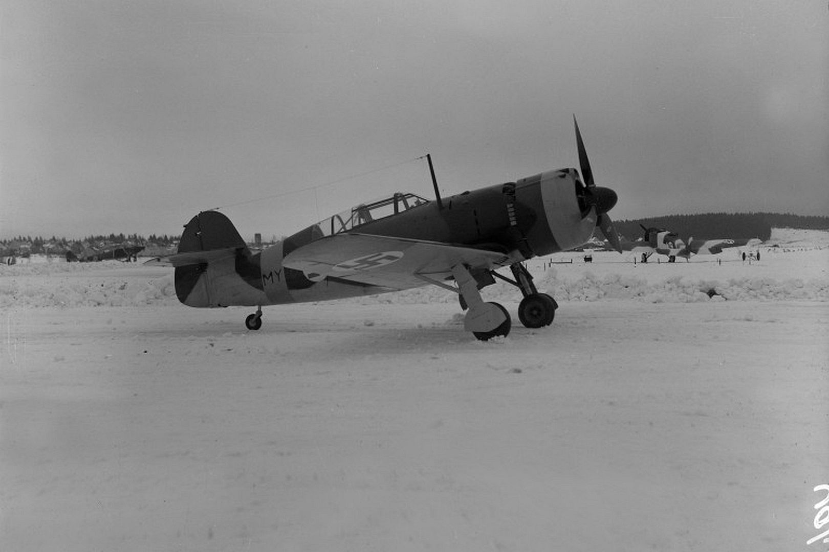

    During the Lapland War, six Myrskys flew 13 reconnaissance missions during November 1944. The wooden construction proved problematic in this theatre, not enduring wet weather or cold well. The war time Lukko glue, manufactured from ersatz materials, which was used for gluing the wooden parts, did not stand rain, frost and humidity, and the glue seams disintegrated, sometimes with disastrous results.

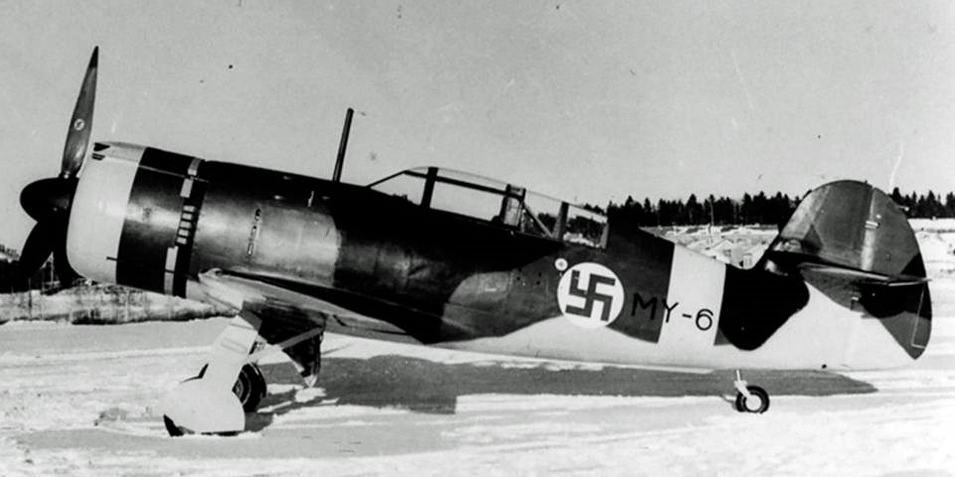

    The Myrsky proved fast and manoeuvrable enough to dogfight the contemporary Soviet aircraft; it was the second fastest Finnish Air Force airplane after the Messerschmitt Bf 109G. Pilots liked the plane as it had good cockpit ergonomics and decent flight and ground handling properties. Its aerodynamic design was excellent, and was later used on the VL Pyörremyrsky fighter and the Valmet Vihuri trainer. Its wide undercarriage gave it decent ground-handling properties. Its main drawback was the construction method: the ersatz materials simply did not stand up to the harsh Finnish weather.
