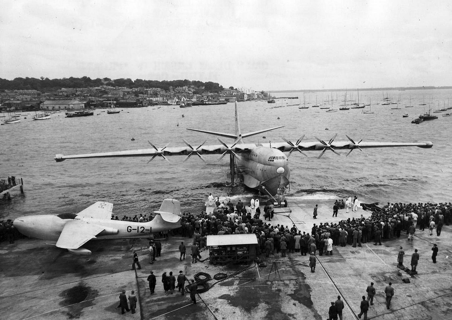

  • The Saunders-Roe SR.45 Princess was a British flying boat aircraft developed and built by Saunders-Roe at their Cowes facility on the Isle of Wight. It has the distinction of being the largest all-metal flying boat to have ever been constructed.
    The Princess had been developed to serve as a larger and more luxurious successor to the pre-war commercial flying boats, such as the Short Empire. It was intended to serve the transatlantic route, carrying up to 100 passengers between Southampton, United Kingdom and New York City, United States in spacious and comfortable conditions. To achieve this, it was decided early on to make use of newly developed turboprop technology, opting for the Bristol Proteus engine still in development to power the aircraft. The project suffered delays due to difficulties encountered in the development of the Proteus engine.

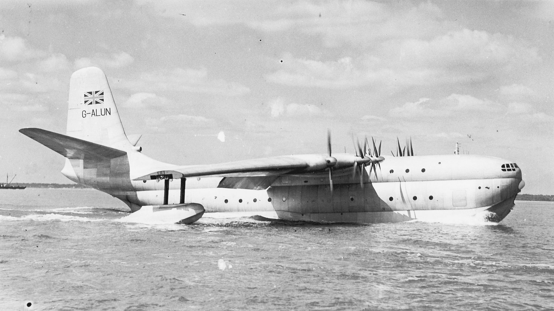

    On 22 August 1952, the first prototype Princess, G-ALUN, conducted its maiden flight. Between 1952 and 1954, the first prototype performed a total of 47 test flights, including two public appearances at the Farnborough Airshow. This work was carried out under a development contract for the Ministry of Supply, the intention being that this would lead to a contract for the aircraft from British flag carrier British Overseas Airways Corporation (BOAC). Although the initial development contract had been successfully met, BOAC eventually decided to focus on its land-based routes using the jet-powered De Havilland Comet instead. The era of the large flying boat had effectively ended prior to the aircraft's completion.
    Work on the Princess was ultimately cancelled after having produced three examples, only one of which flew. By the mid-1950s, large commercial flying boats were being increasingly overshadowed by land-based jet airliners. Factors such as runway and airport improvements had added to the viability of land-based aircraft, which did not have to compromise to accommodate the additional weight and drag of the boat hulls that were necessary on seaplanes, or the mitigating measures needed against the corrosion caused by seawater. Following the project's termination, the three airframes were stored with the intention of selling them on; however, upon receipt of a promising offer for the aircraft, it was found that corrosion had set in while in storage. As a result, all three aircraft prototypes were subsequently scrapped.

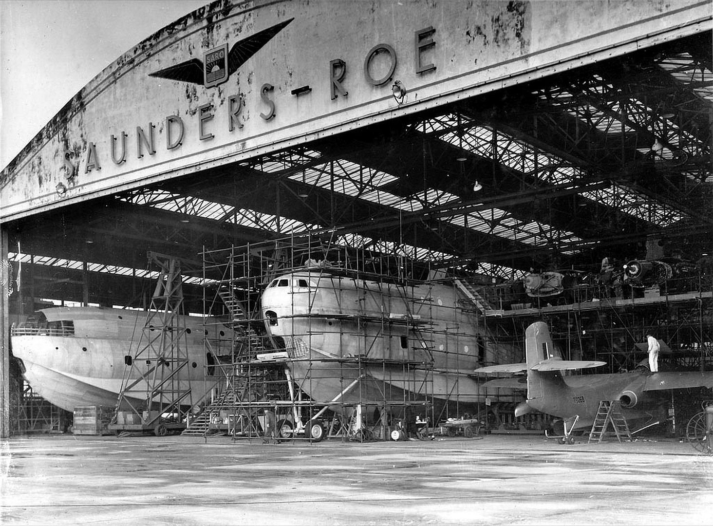

    Work on the SR.45 commenced almost immediately upon receipt of the order. From an early stage in development, progress on the programme was subject to schedule overruns and higher than projected costs being incurred, leading to scepticism of the flying boat's viability within the House of Commons, which was being increasingly regarded as a high-risk initiative with unreliable costing. Specifically, designing and testing of the airframe, as well as the independently conducted development of the Proteus engine to power the SR.45, had been major contributors to the higher-than-expected costs.

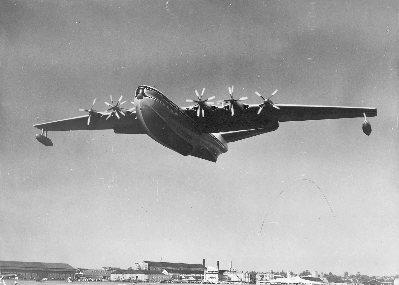

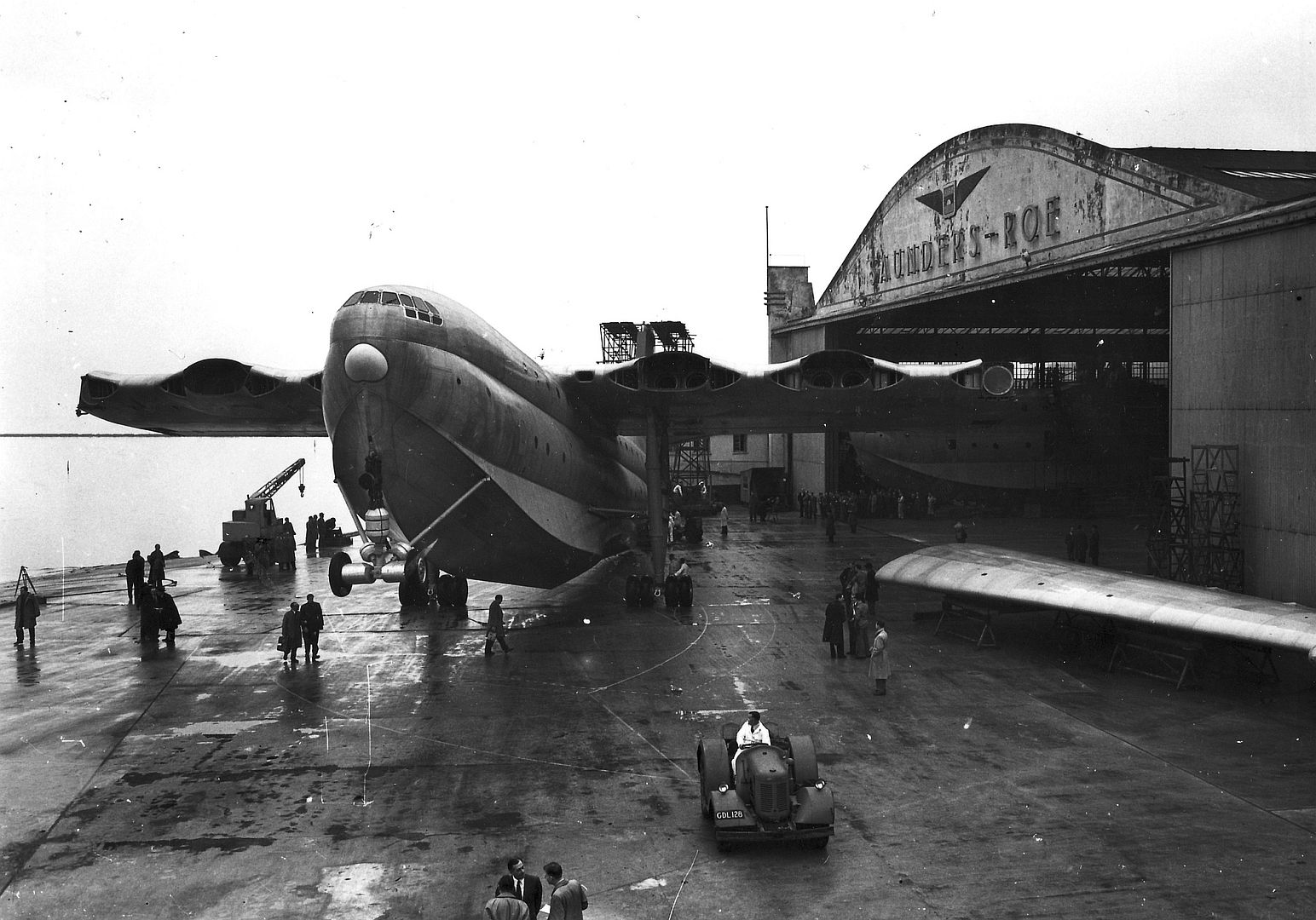

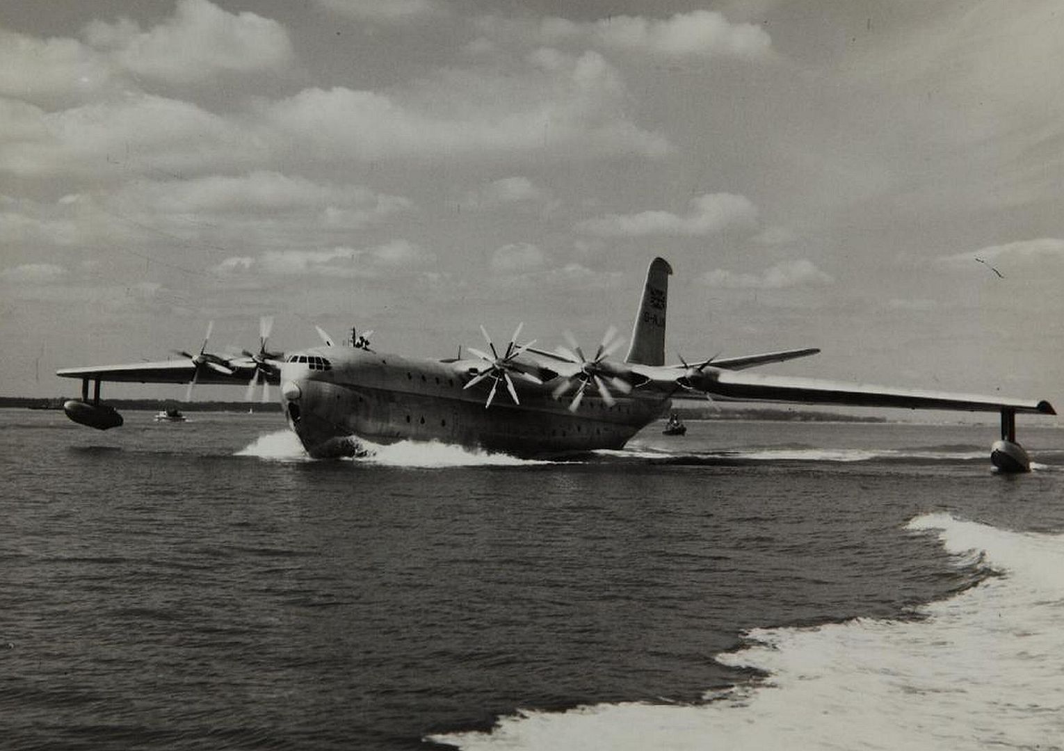

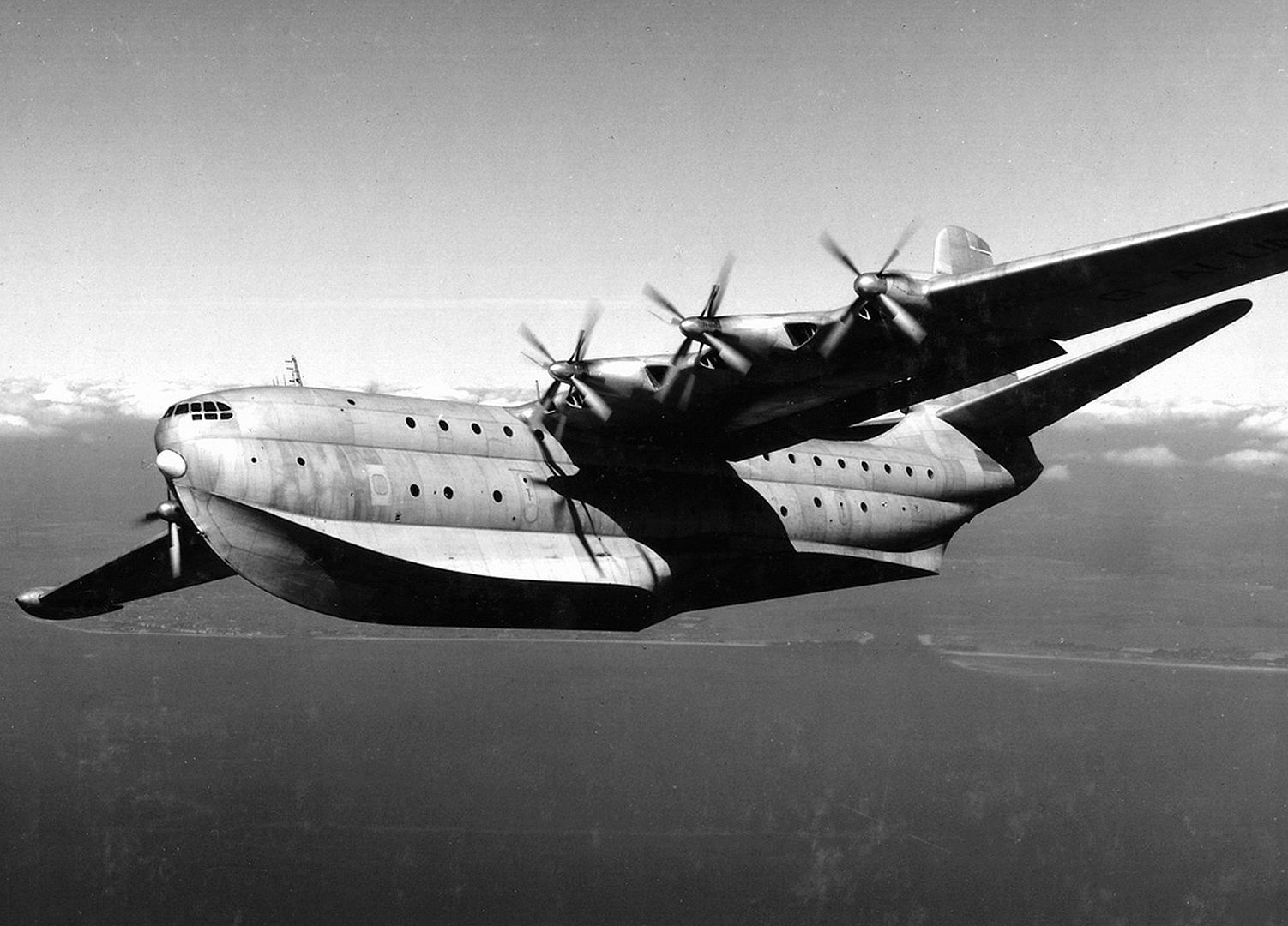

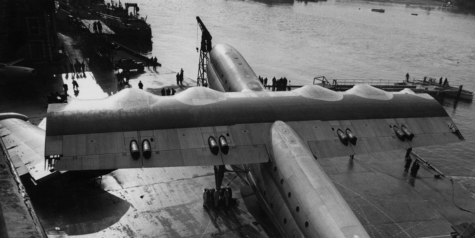

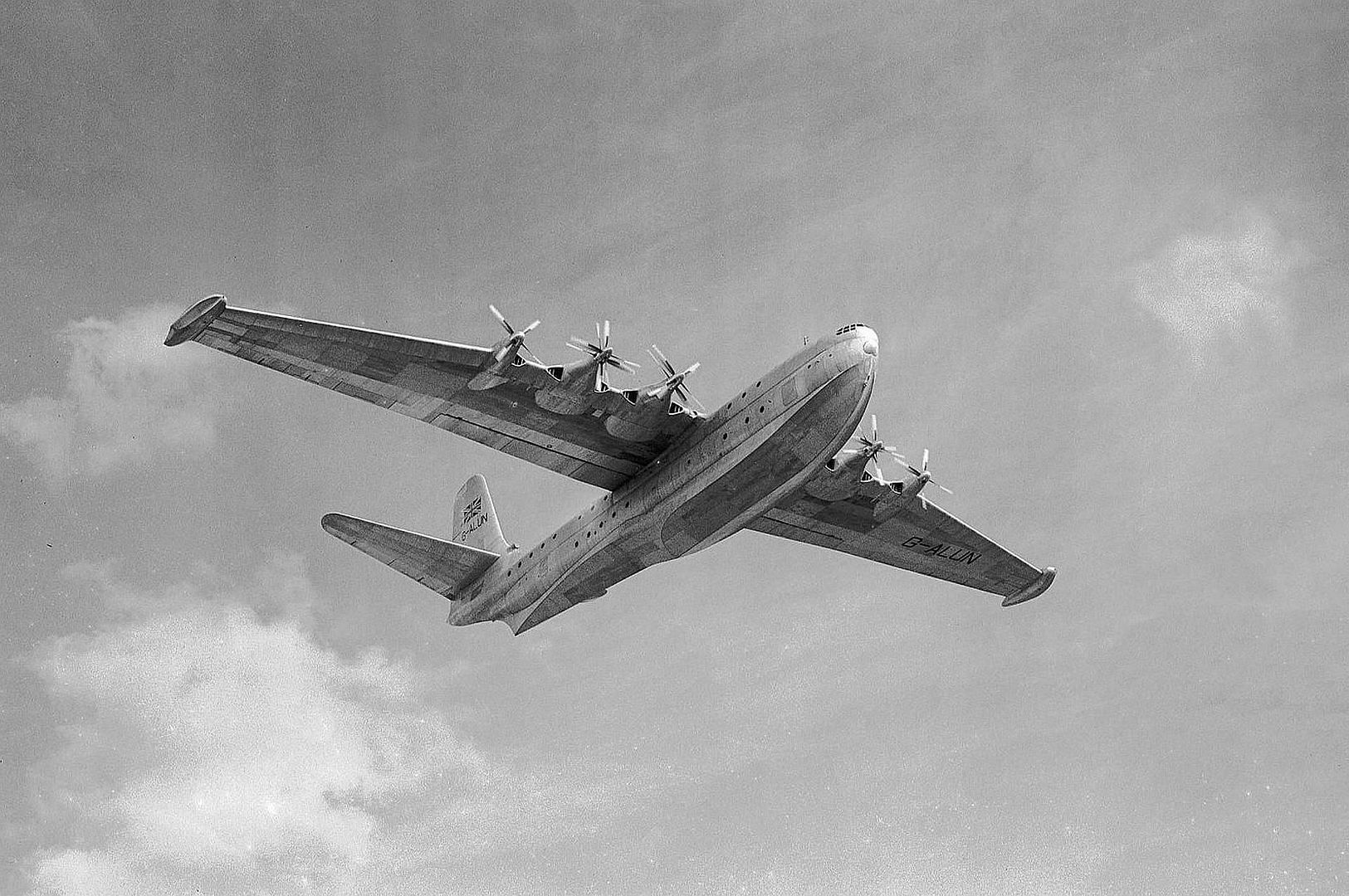

    The SR.45 Princess was a large flying boat, being the largest all-metal flying boat to have ever been constructed. The Princess featured a rounded, bulbous, "double-bubble" pressurized fuselage which contained two full passenger decks; these decks had sufficient room to accommodate up to 105 passengers in great comfort. The planing bottom of the hull had only a slight step in the keel to minimize drag in the air. The Princess was powered by an arrangement of ten Bristol Proteus turboprop engines. These engines drove six sets of four-bladed propellers; of these, the inner four propellers were double, contra-rotating propellers which were driven by a twin version of the Proteus, named the Bristol Coupled Proteus, each engine drove one of the propellers. The two outer propellers were single and each powered by a single engine.

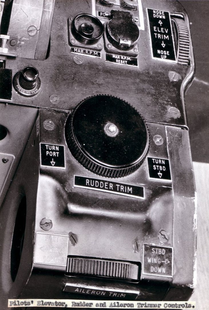

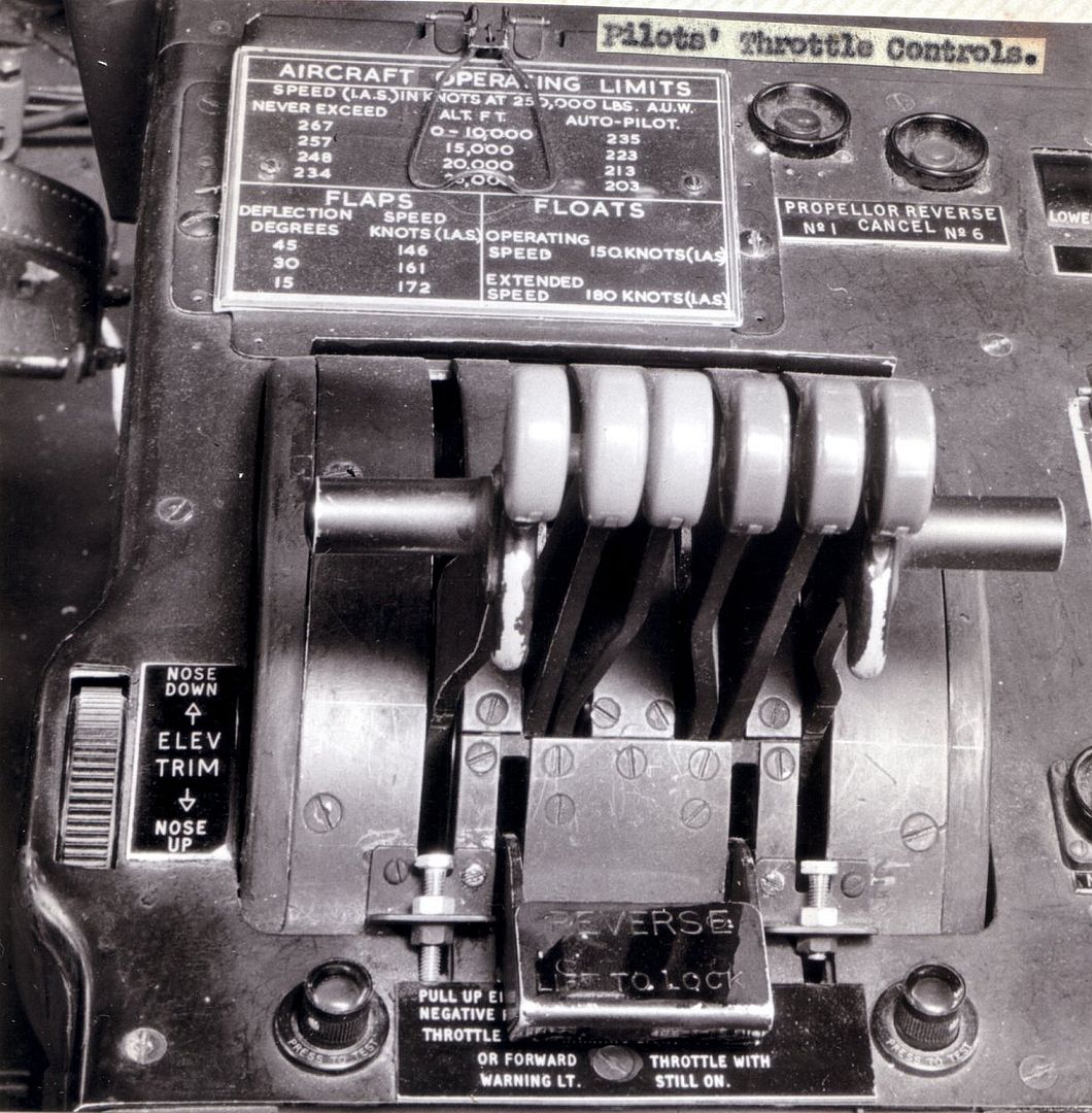

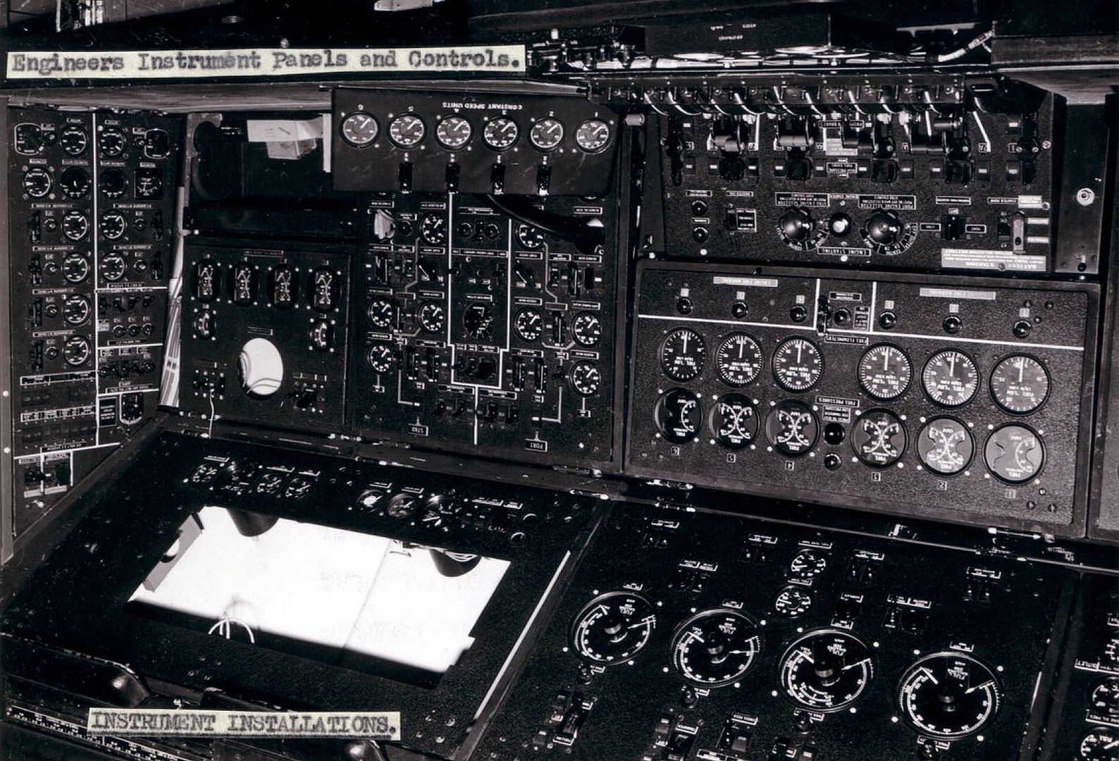

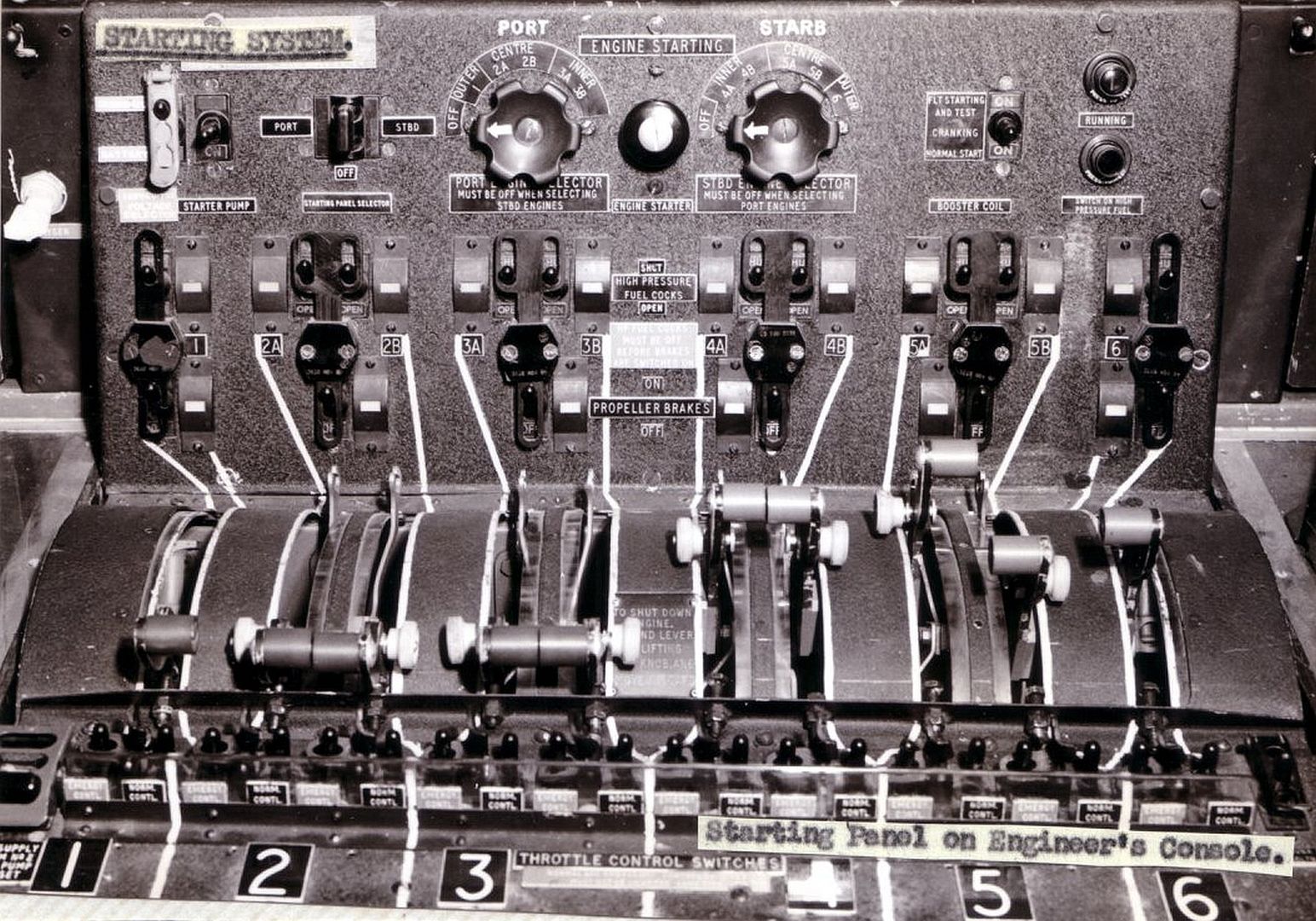

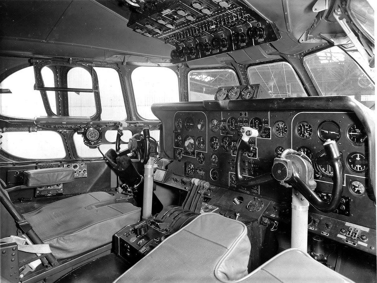

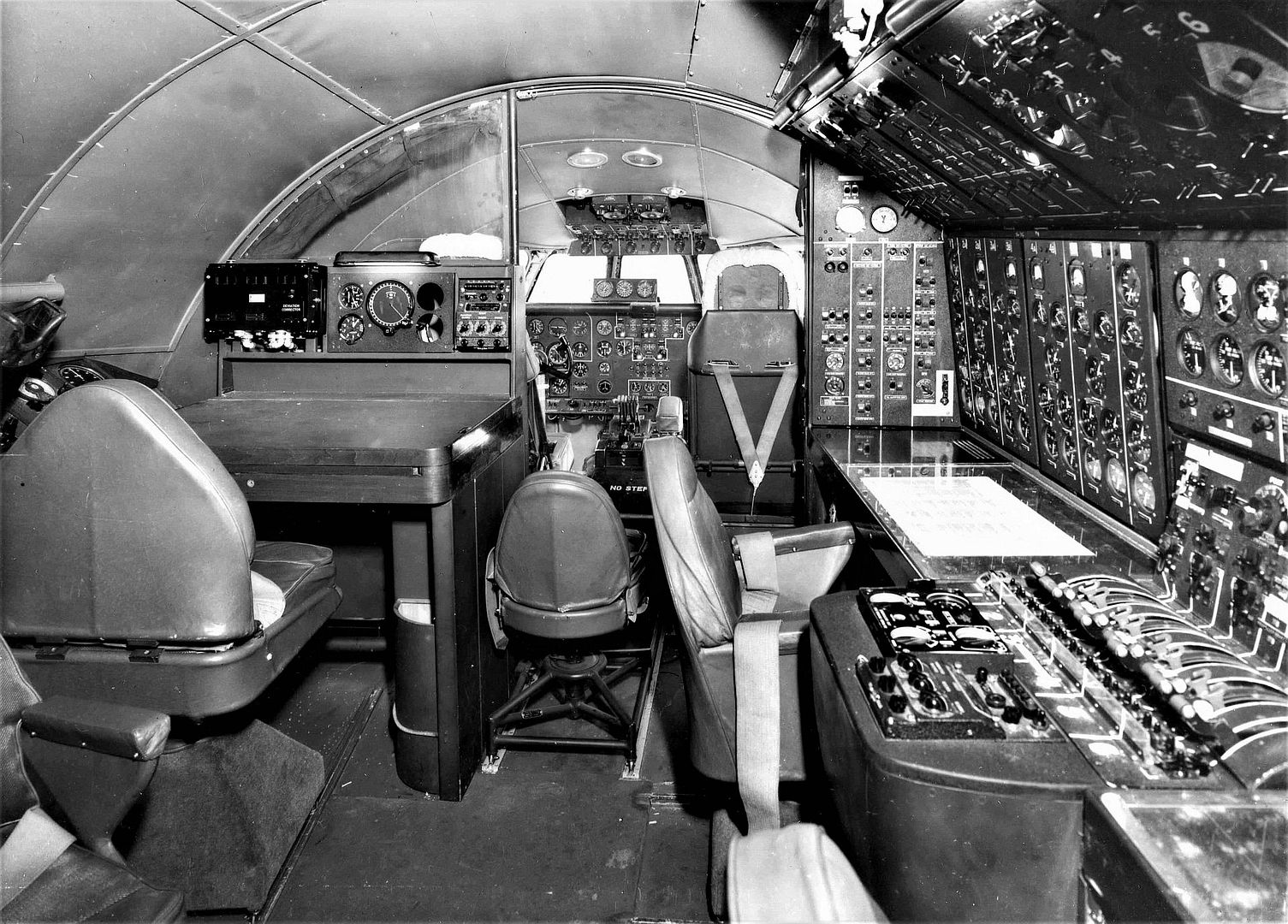

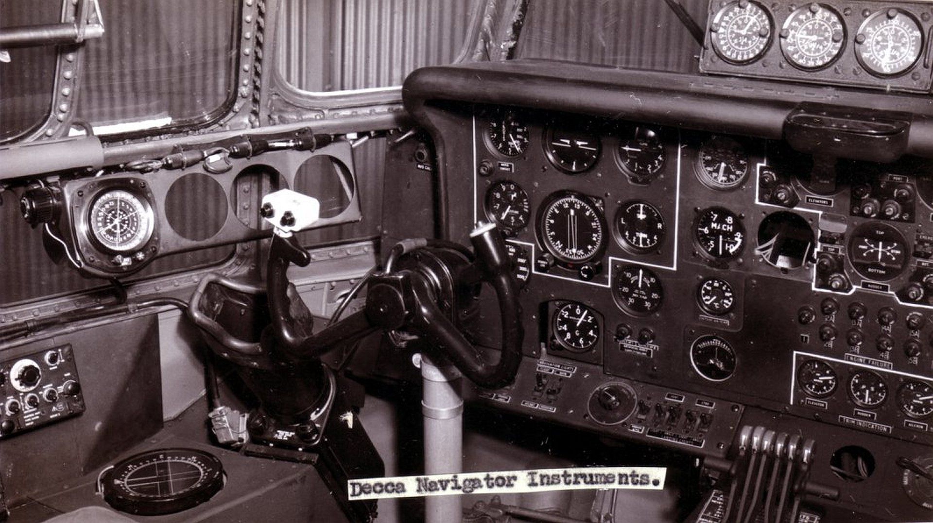

    The cockpit of the Princess was designed to be operated by a pair of pilots, two flight engineers, a navigator, and a radio operator. Early on, it had been intended for the aircraft to be outfitted with some form of powered flight controls, including an early fly-by-wire implementation, in order that pilots would be able to effectively actuate its large control surfaces, which would have to overcome equally larger forces. However, it was decided to opt for a traditional mechanical linkage approach that was augmented by a series of electrically driven power assist units to effectively support actuation instead.
    The ailerons and rudder were split into multiple sections in order that, if a part of the servo-powered control system were to fail, a faulty section could be "trailed" so that it did not act against the remaining working sections. While the prototype aircraft had been fitted with advanced (but conventional) hydraulic controls, Saunders-Roe had intended production aircraft to use an analogue system featuring electrical servos with hydraulic final control actuators. Such a system had been built and undergone ground-testing, but the Princess had been terminated prior to any aircraft having been fitted with the system.

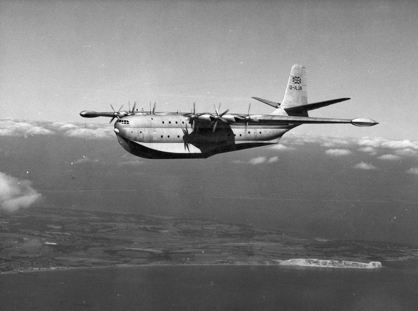

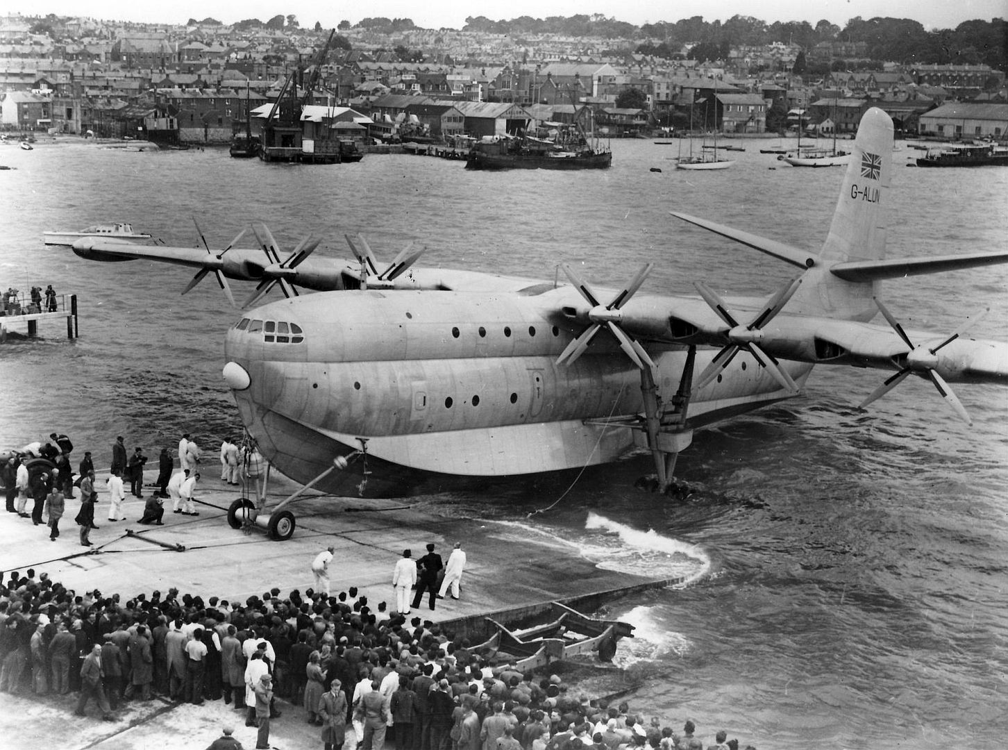

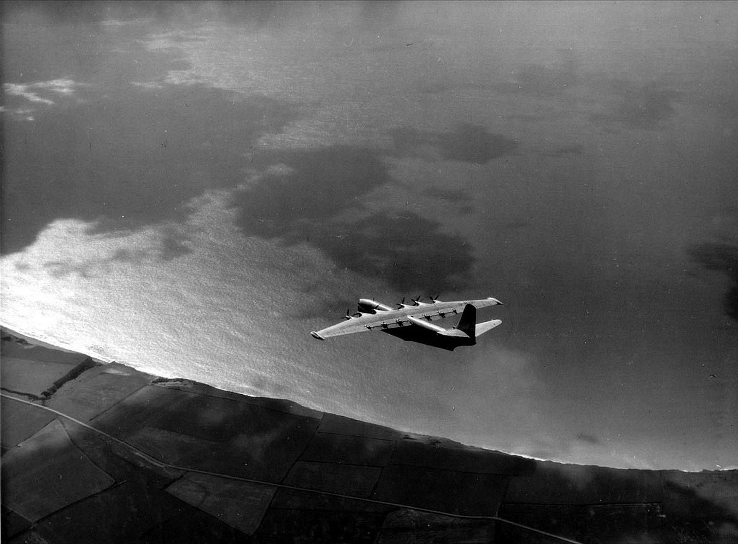

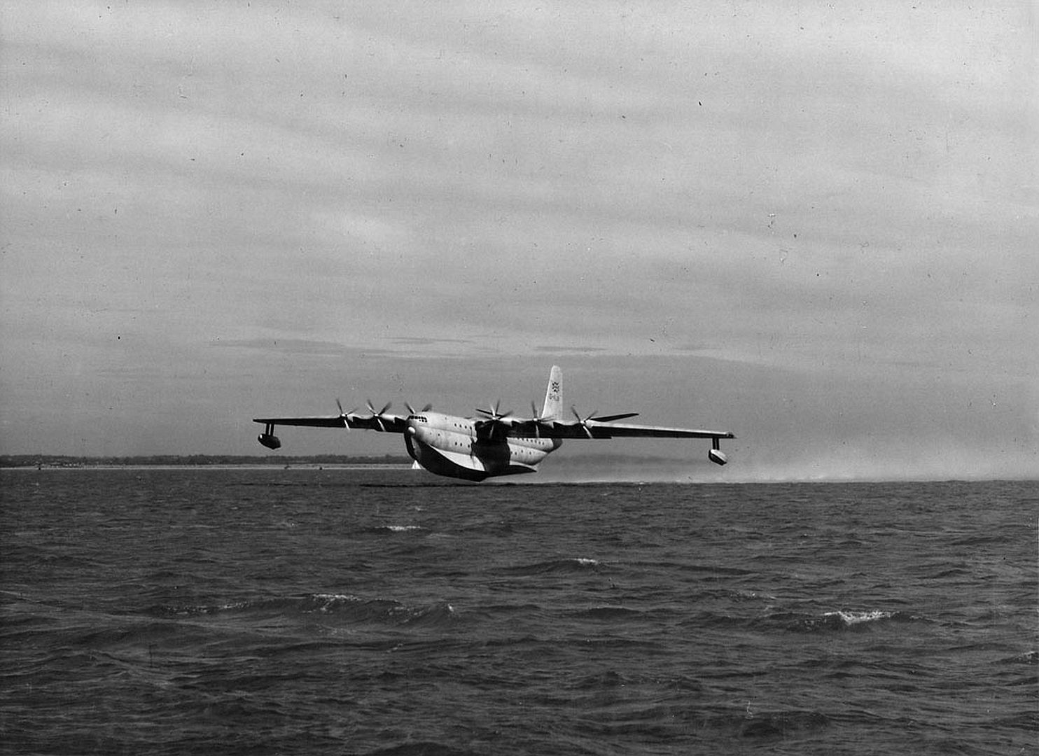

    On 22 August 1952, the prototype, G-ALUN, conducted its maiden flight, piloted by Geoffrey Tyson. The initial flight lasted for 35 minutes, in which the flying boat performed a complete circumnavigation of the Isle of Wight. According to aviation author Phillip Kaplan, the Princess had not been intended to fly that day at all and only taxiing tests had been scheduled to take place, and that Tyson had decided to proceed due to the excellent conditions present on the day. The prototype was quickly put through several test flights with the hope of being able to sufficiently ready the flying boat to appear at the 1952 Farnborough Airshow, however indications of engine reliability issues were encountered and this led to the intended flight display at Farnborough that year being abandoned.
    As further testing of the prototype continued, the reliability of the engines and gearboxes continued to be problematic, but not to the extent that flight testing was prevented. Evaluation of the flying boat continued into 1953, during which particular attention was devoted towards addressing the difficulties uncovered. During the 1953 Farnborough Airshow, the prototype was displayed. Flight tests of the prototype continued up until 27 May 1954, by which point it had been found that the Proteus engine, once perfected, would be capable of enabling the type to achieve its envisioned performance figures. G-ALUN was the only model to fly, performing 46 test flights in total during which 100 hours flight hours were accumulated.
