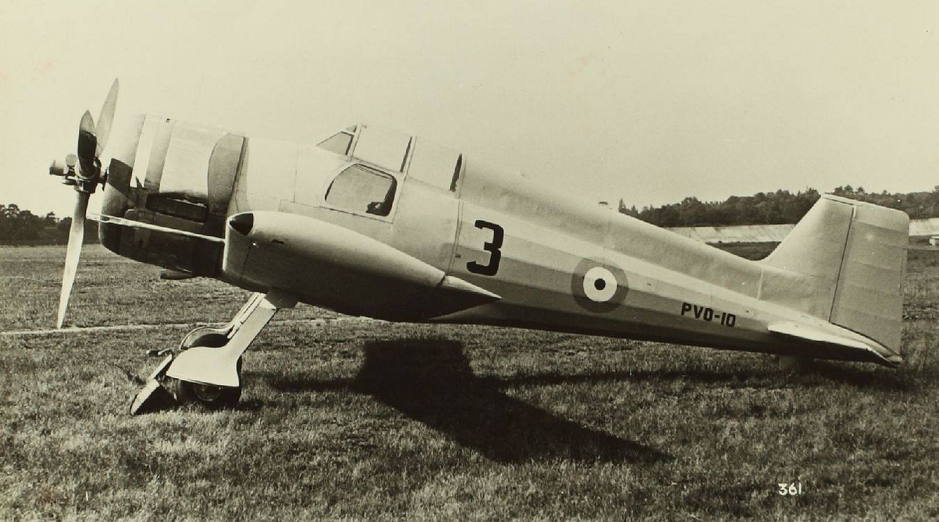

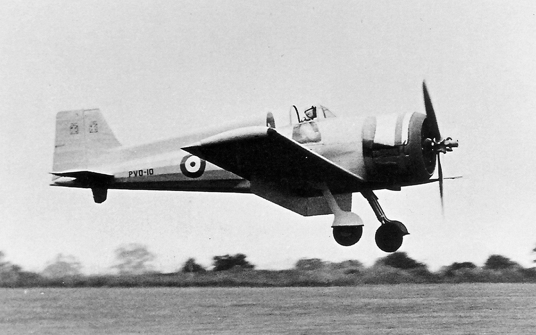

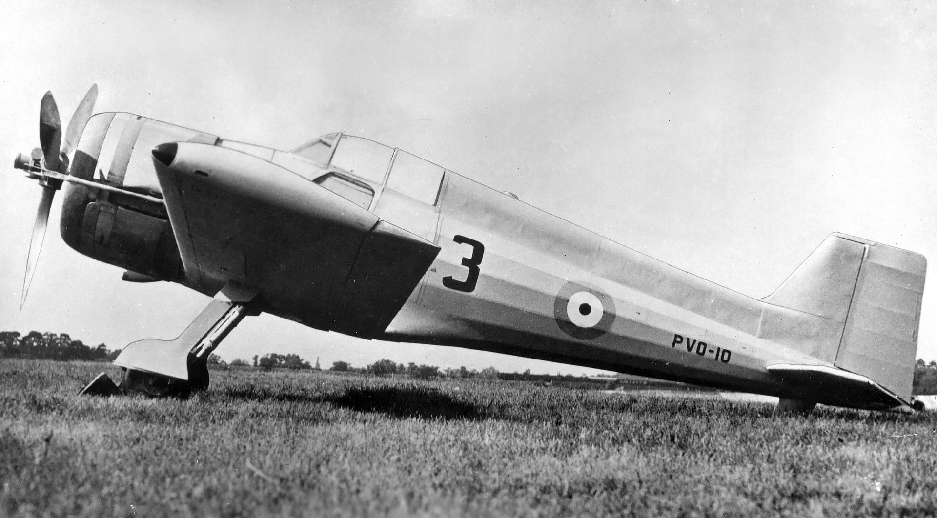

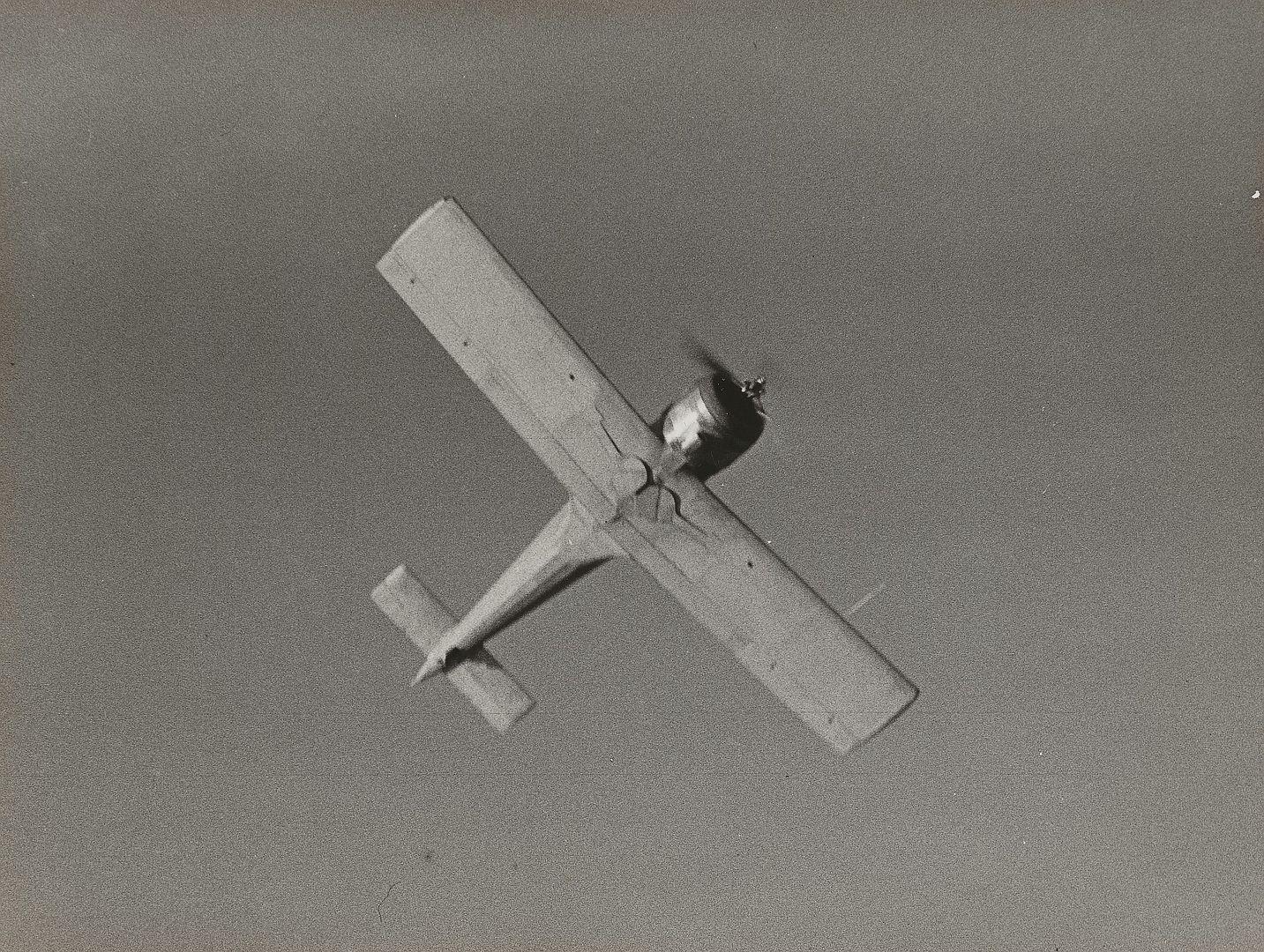

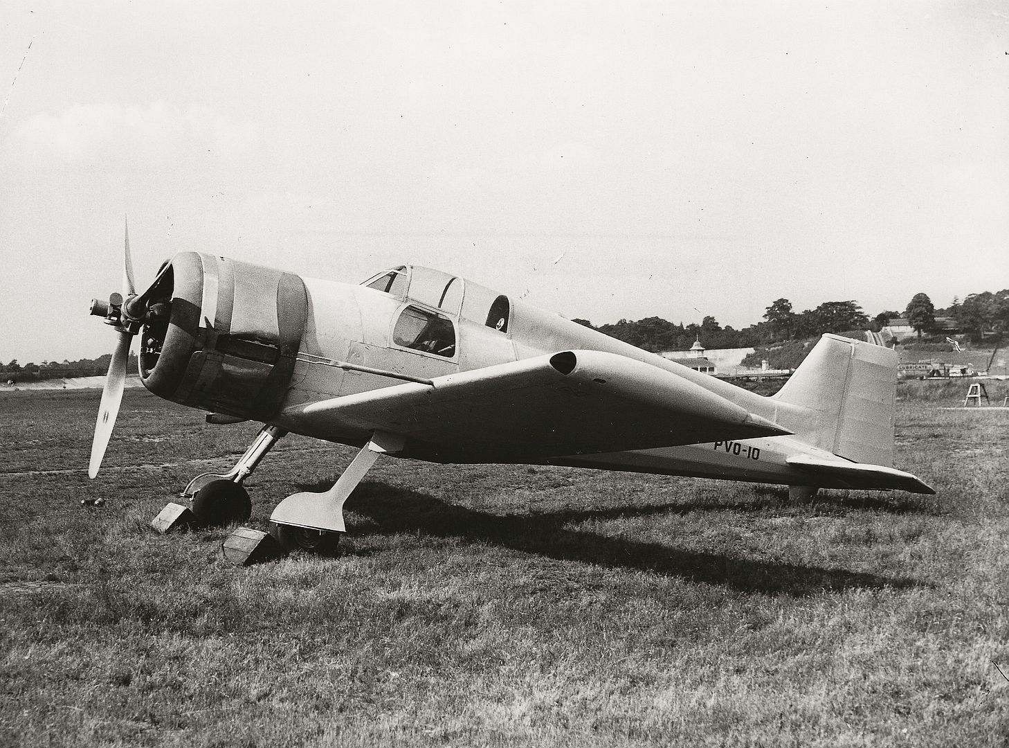

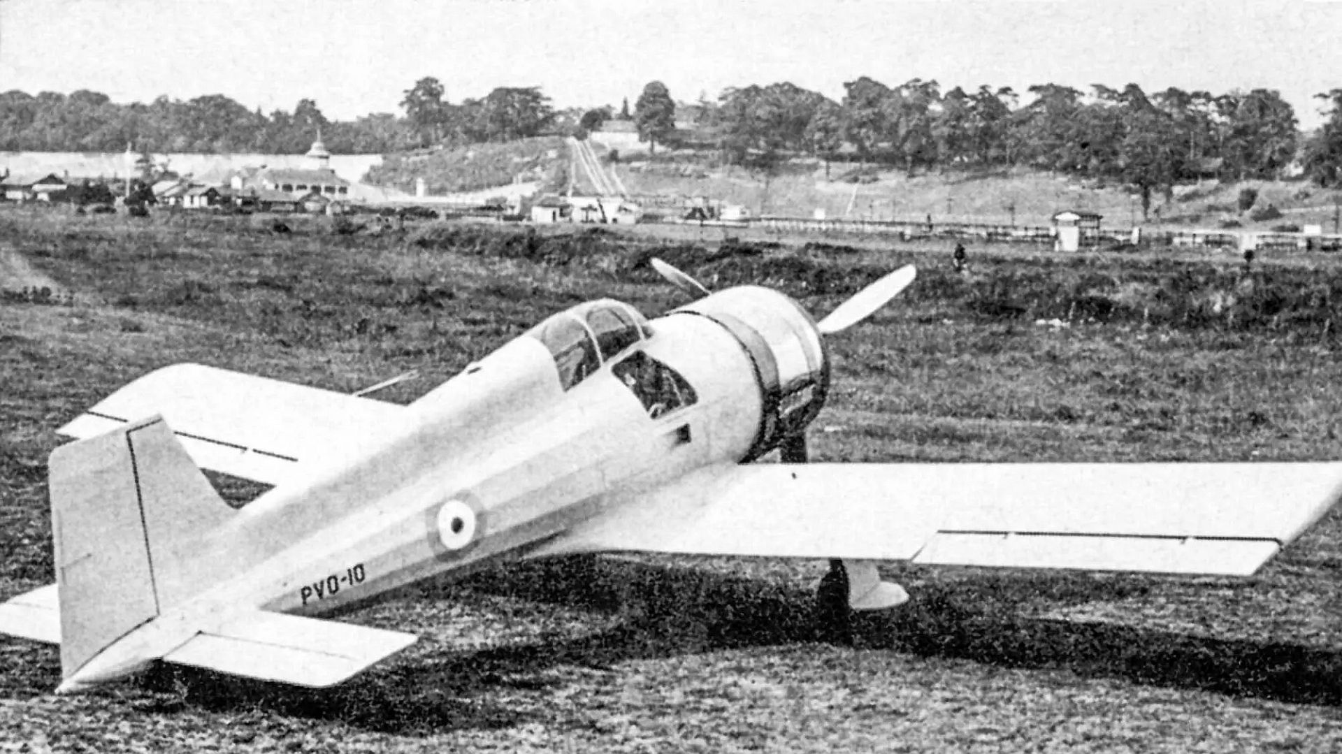

The Venom (originally known as the Jockey Mk II) was a low-wing monoplane, with square-tipped constant chord wings and tailplane. The fin, too, was square-tipped but the rather angular appearance did not extend to the fuselage, whose circular cross section tapered rearwards from the engine's long chord cowling back to the tail. The pilot sat over the wing in a perspex-enclosed cockpit, which had additional windows in the fuselage to enhance the side and downwards view. The inverted U-shaped fairing behind the cockpit extended back to the base of the fin.
The fuselage was an alloy-skinned monocoque structure of polygonal section, and the thicker plates of the wings were also stressed, taking the drag loads. The wings carried flaps that could extend to 90° and there was a wide track, inward-retracting main undercarriage as well as a small fixed tailwheel. Flaps and undercarriage were electrically operated. The RAF 34 wing section provided sufficient depth for the installation of the required eight Browning machine guns. The Venom was powered by a 625 hp (466 kW) Bristol Aquila AE-3S sleeve valve radial engine, hinge-mounted so it could be swung sideways for easy maintenance. The Aquila drove a three-bladed propeller. Joseph "Mutt" Summers flew the Venom on its first flight on 17 June 1936. Unlike the Hurricane and Spitfire, the Venom was fitted with its full armament from its first flight.

Publicly unveiled at the 1936 Society of British Aircraft Constructors (SBAC) display, the Venom appeared in natural polished metal and silver dope on the fabric control surfaces, with temporary company registration markings of PVO-10.[5] In testing, the Venom performed well on the limited power of the Aquila, achieving a maximum speed of 312 mph (502 km/h) and it demonstrated a good climb rate. The Venom had a better rate of roll and turn than its long nosed water-cooled competitors but it was soon clear the potential power from the Rolls-Royce Merlin inline engine was greater than was likely to be possible from the Aquila, while no other engines were available that were suitable for such a small airframe. Jeffrey Quill flew the Venom from Eastleigh, mixing it with Spitfires but the Venom's flying was limited by engine problems. Later flying with RAF roundels and marked with "3" on the fuselages sides, the Venom was painted a cream colour for exhibition purposes. The sole Venom prototype was scrapped in 1939, following a crash during a test flight.
