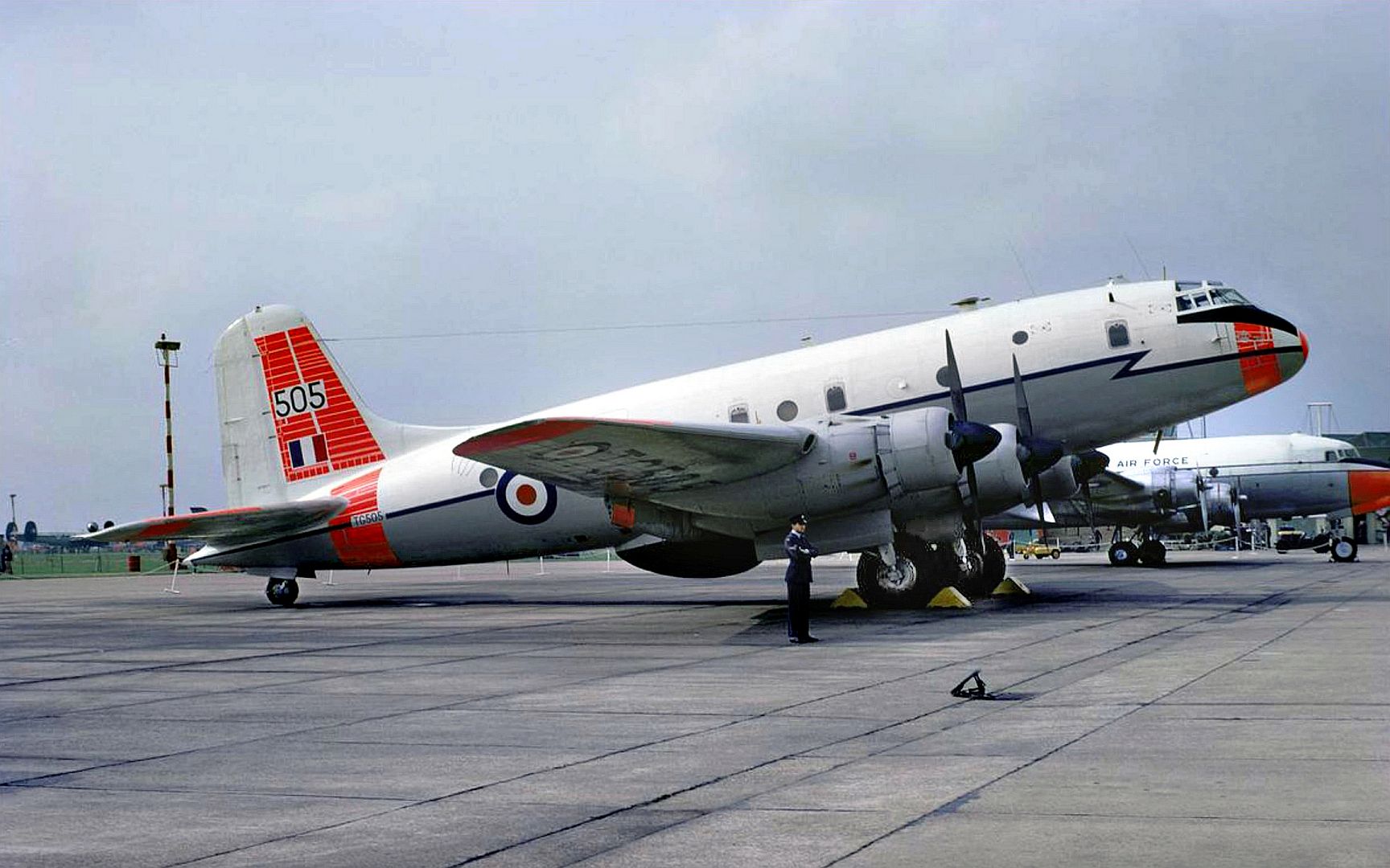

Main AdminThe Handley Page HP.67 Hastings is a retired British troop-carrier and freight transport aircraft designed and manufactured by aviation company Handley Page for the Royal Air Force (RAF). Upon its introduction to service during September 1948, the Hastings was the largest transport plane ever designed for the service.
Development of the Hastings had been initiated during the Second World War in response to Air Staff Specification C.3/44, which sought a new large four-engined transport aircraft for the RAF. Early on, development of a civil-oriented derivative had been prioritised by the company, but this direction was reversed following an accident. On 7 May 1946, the first prototype conducted its maiden flight; testing revealed some unfavourable flight characteristics, which were successfully addressed via tail modifications. The type was rushed into service so that it could participate in the Berlin Airlift; reportedly, the fleet of 32 Hastings to be deployed during the RAF operation delivered a combined total of 55,000 tons (49,900 tonnes) of supplies to the city.
As the RAF's Hastings fleet expanded during the late 1940s and early 1950s, it supplemented and eventually replaced the wartime Avro York, a transport derivative of the famed Avro Lancaster bomber. RAF Transport Command operated the Hastings as the RAF's standard long-range transport; as a logistics platform, it contributed heavily during conflicts such as the Suez Crisis and the Indonesian Confrontation. A handful were also procured by the Royal New Zealand Air Force (RNZAF) to meet its transport needs. Beyond its use as a transport, several Hastings were modified to perform weather forecasting, training, and VIP duties. A civilian version of the Hastings, the Handley Page Hermes, was also produced, which only achieved limited sales. Hastings continued to be heavily used by RAF up until the late 1960s, the fleet being withdrawn in its entirety during 1977. The type was succeeded by various turboprop-powered designs, including the Bristol Britannia and the American-built Lockheed Hercules.

Design

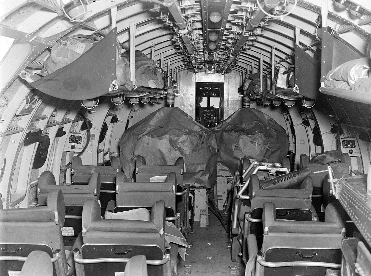

The Handley Page Hastings was a large purpose-built four-engine transport aircraft.It was furnished with several modern features, such as a Messier-built fully retractable undercarriage, which was operated hydraulically, and unprecedented stowage space for an RAF transport aircraft. Roughly 3,000 cubic feet of unrestricted area was used to house various cargoes or passengers. The cabin was fitted with a Plymax floor, complete with various grooves, channels, and lashing points for securing goods of varying sizes, while the walls were sound proofed and lined with plywood for increased comfort. Principal access is provided by a freight door on the port side, which incorporates a paratroop door, while a second paratroop door is present on the starboard side; on the ground, a rapidly deployable ramp suitable for road vehicles can also be used. In service, the aircraft was typically operated by a crew of five; it could accommodate either up to 30 paratroopers, 32 stretchers and 28 sitting casualties, or a maximum of 50 fully equipped troops.
In terms of its structure, the Hastings features a circular cross-section fuselage, which is constructed in three main sections from frames comprising rolled alloy. The frames are typically Z-section units using intercostal plate members, but the wing box makes use of larger I-section structures; these support a metal sheet covering that is rivetted directly onto stringer flanges. The maximum external diameter of 11 ft is maintained for a lengthy portion of the fuselage's length, running both fore and aft of the wing. In order that the Hastings could carry loads too large for its interior, such as Jeeps and some artillery pieces, strong fixture points are present on the underside of the fuselage for the fitting of an under-fuselage carrier platform.
The fuselage is paired with a low-mounted cantilever wing, the connection between the two being smoothly faired. This wing comprised a twin-spar structure complete with inter-spar diaphragm-type ribs; the trailing edge ribs terminate just short of the slotted flaps. Furthermore, the leading edge of the wing's center section was readily detachable, providing easy access to various electrical and control systems housed within the wing.The aircraft's fuel tanks are located just inboard of the inner engine nacelles; retractable ejector pipes were present within the wing, which were used for jettisoning fuel when such action would be required by an emergency situation.

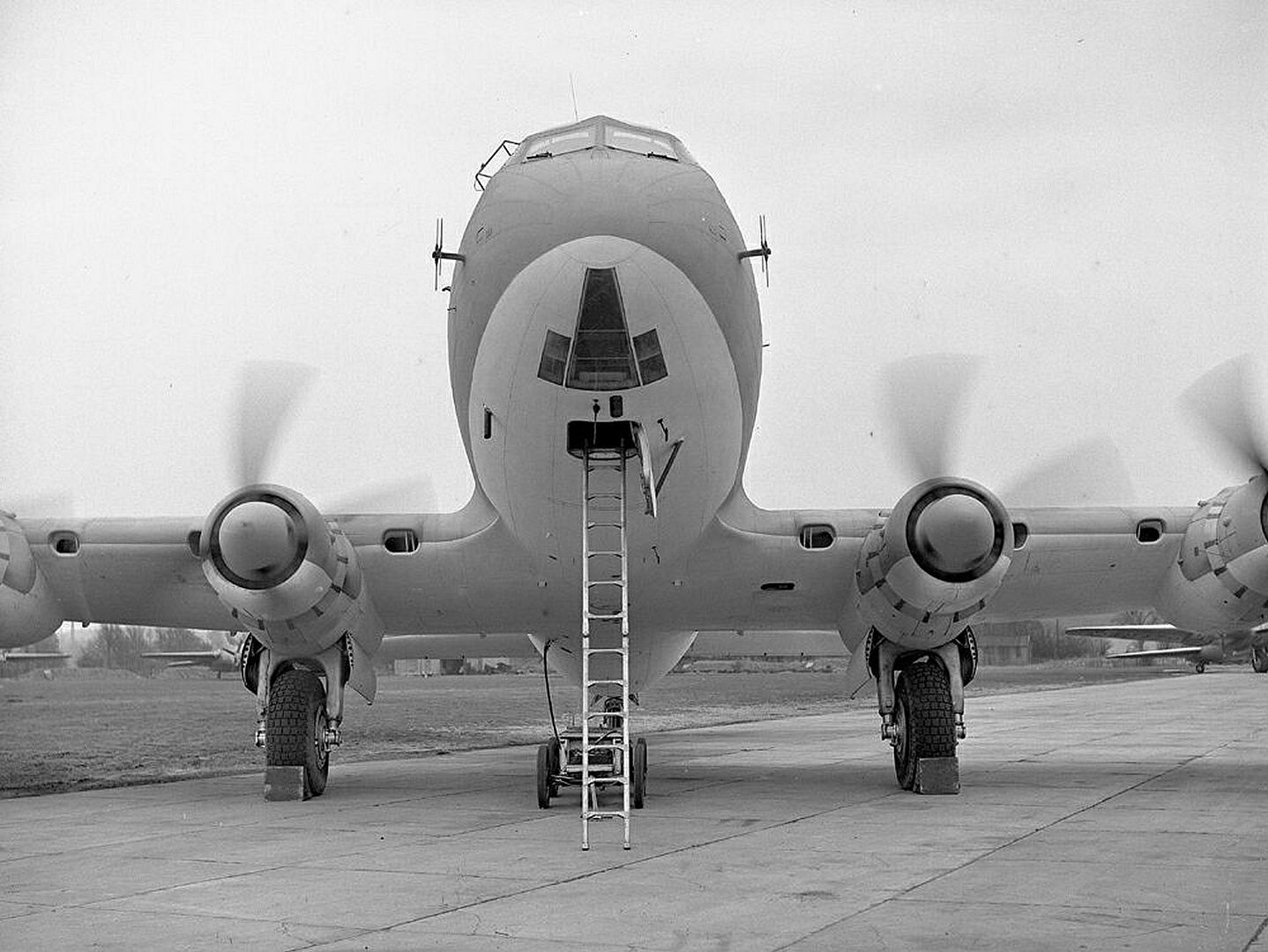

The Hastings was powered by an arrangement of four wing-mounted Bristol Hercules 101 sleeve valve radial engines. These engines were installed upon the leading edge of the wing via interchangeable power-eggs; the air intakes and thermostatically-controlled oil coolers were also present within the wing. A Vokes-build automated air cleaner was present upon each engine, typically deploying during landings and take-offs. Fire detection systems were also installed to alert the crew to such dangers, while fire extinguishers were also installed around each engine. The engines drove de Havilland-built hydromatic four-blade propellers, which could be individually feathered if required.

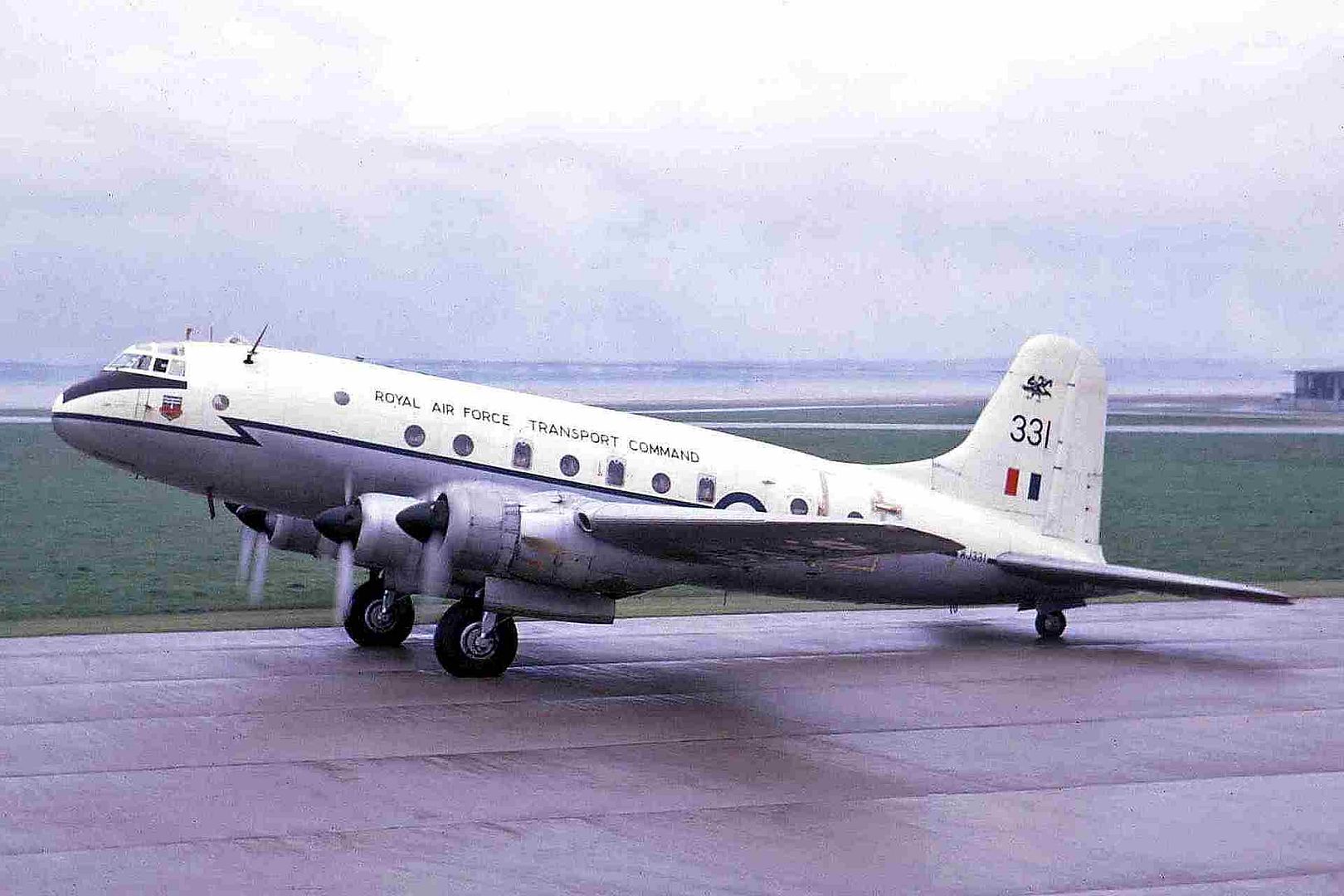

A total of one hundred Hastings C1 and 41 Hastings C2 were procured for service with RAF Transport Command, who commonly deployed the type upon its long-range routes, as well as some use as a tactical transport until well after the arrival of the faster turboprop-powered Bristol Britannia during 1959. A total of four VIP-configured Hastings were assigned to 24 Squadron. An example of the latter use was during the Suez Crisis of 1956, during which several Hastings of 70, 99 and 511 Squadrons dropped paratroopers on El Gamil airfield, Egypt.
Hastings continued to provide transport support to British military operations around the globe through the 1950s and 1960s, including dropping supplies to troops opposing Indonesian forces in Malaysia during the Indonesian Confrontation.During early 1968, the Hastings was withdrawn from RAF Transport Command, by which point it has been replaced by the American-built Lockheed Hercules and British-built Armstrong Whitworth AW.660 Argosy, both being newer turboprop-powered transports.

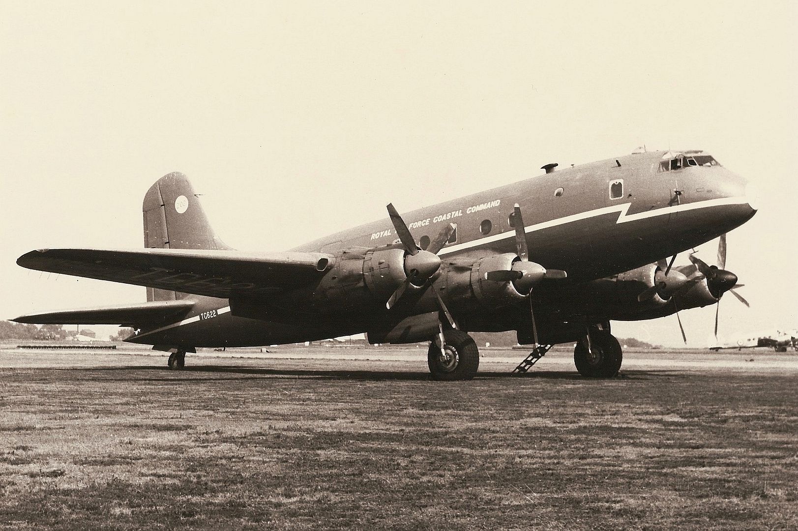

Starting in 1950, the Met Mk.1 weather reconnaissance aircraft were used by 202 Squadron, based at RAF Aldergrove, Northern Ireland; they were used by the Squadron up until its disbandment on 31 July 1964, having been rendered obsolete by the introduction of weather satellites. The Hastings T.Mk 5 remained in service as radar trainers well into the 1970s; the variant was used for other purposes as well during this time, such as the occasional transport, air experience, and search and rescue missions.The Hastings was even deployed for reconnaissance purposes during the Cod War with Iceland during the winter of 1975–76; it was finally withdrawn from service on 30 June 1977.

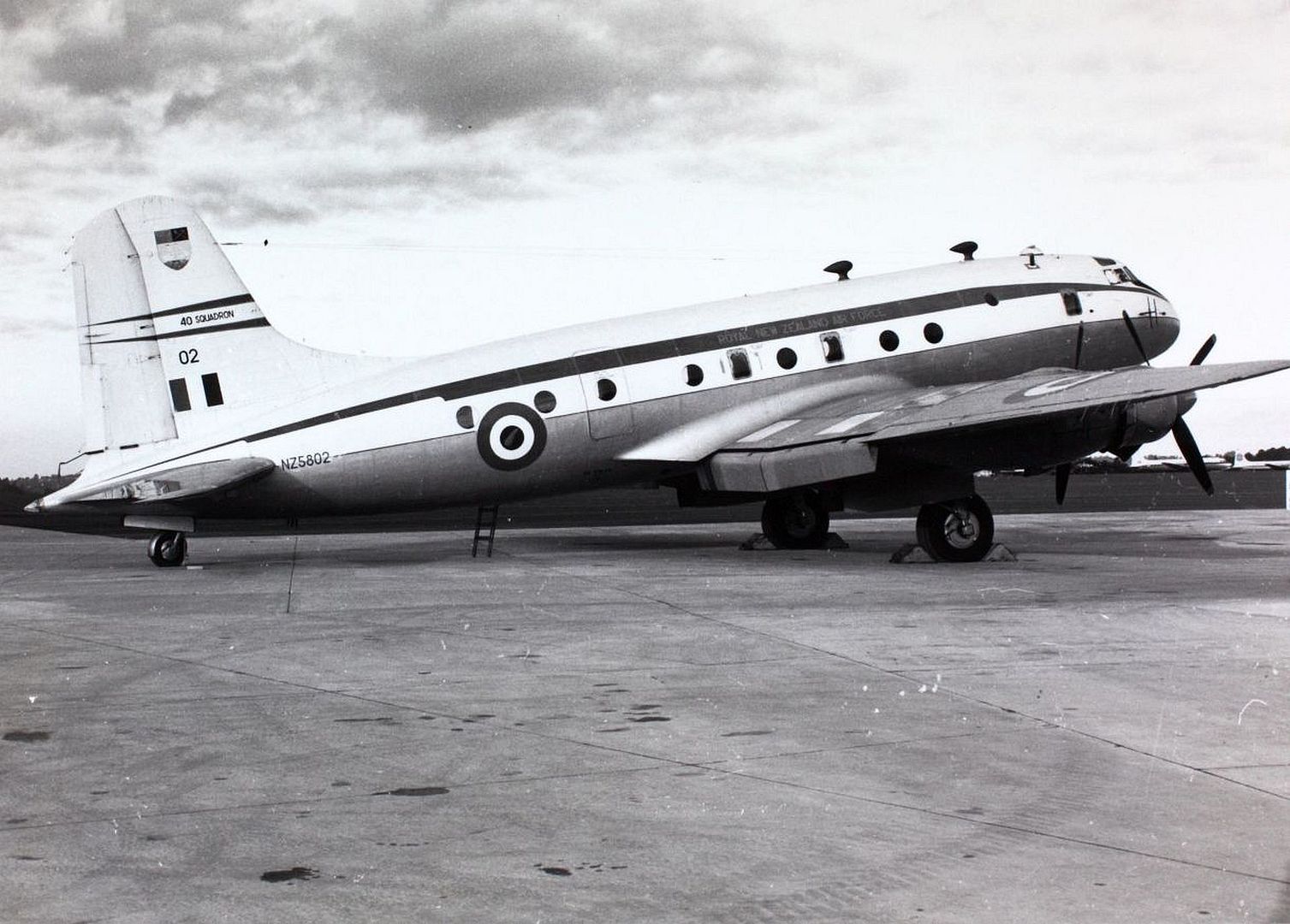

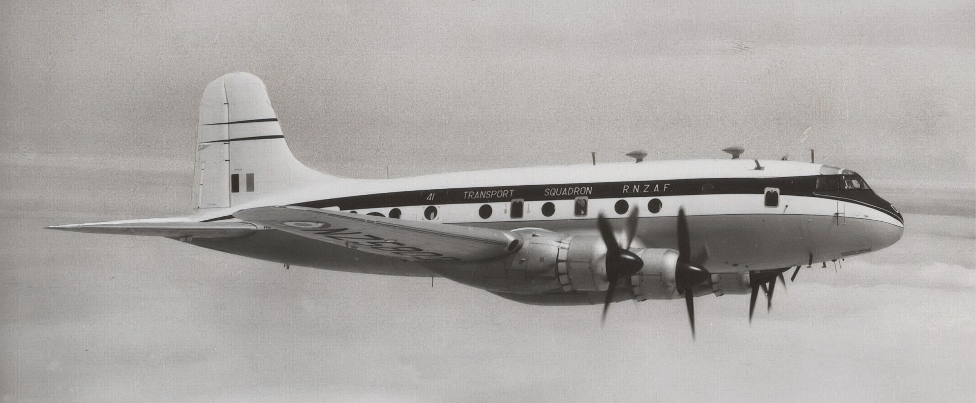

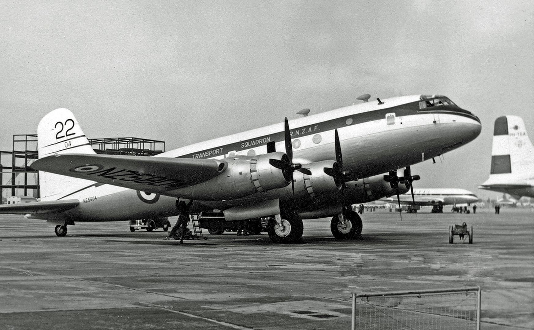

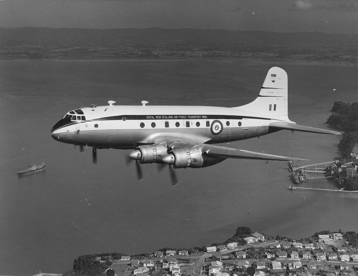

In addition to its use by the RAF, several Hastings were also procured by New Zealand, where they were operated by No. 40 and No. 41 Squadrons of the Royal New Zealand Air Force (RNZAF). The service flew the type until it was replaced by American-built Lockheed C-130 Hercules during 1965. Four Hastings C.Mk 3 transport aircraft were built and supplied to the RNZAF. One crashed at RAAF Base Darwin and caused considerable damage to the city water main, its railway and the road into the city. The other three were broken up at RNZAF Base Ohakea. During the period that the engines were having problems with their sleeve valves (lubricating oil difficulties) RNZAF personnel joked that the Hastings was the best three-engined aircraft in the world.

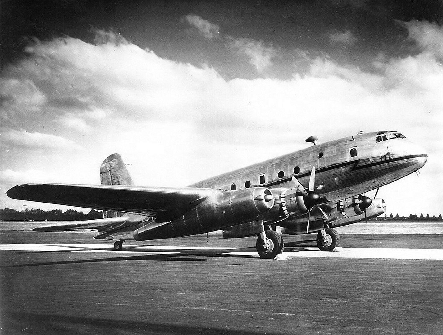

HP.67 Hastings
Prototype, two built.
Handley Page HP67 Hastings, TE583 the second prototype, used as a testbed for the Saphire turbojet.

HP.67 Hastings Met.1
Weather reconnaissance version for Coastal Command, six built.

HP.95 Hastings C3
Transport aircraft for the RNZAF, similar to C2 but had Bristol Hercules 737 engines, four built.

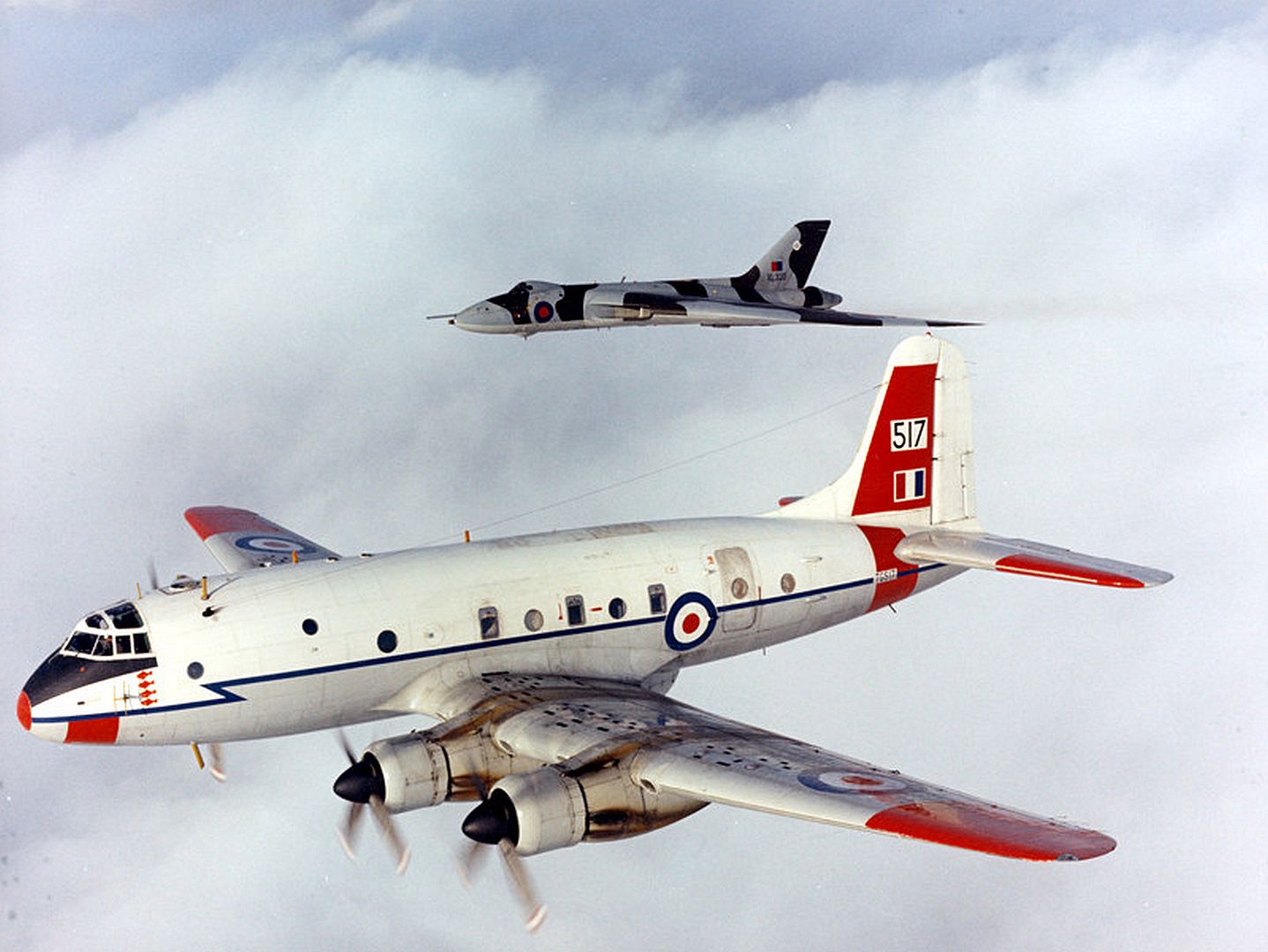

HP.67 Hastings T5
Eight C1s converted for RAF Bomber Command with ventral radome to train V bomber crews on the Navigation Bombing System (NBS).
