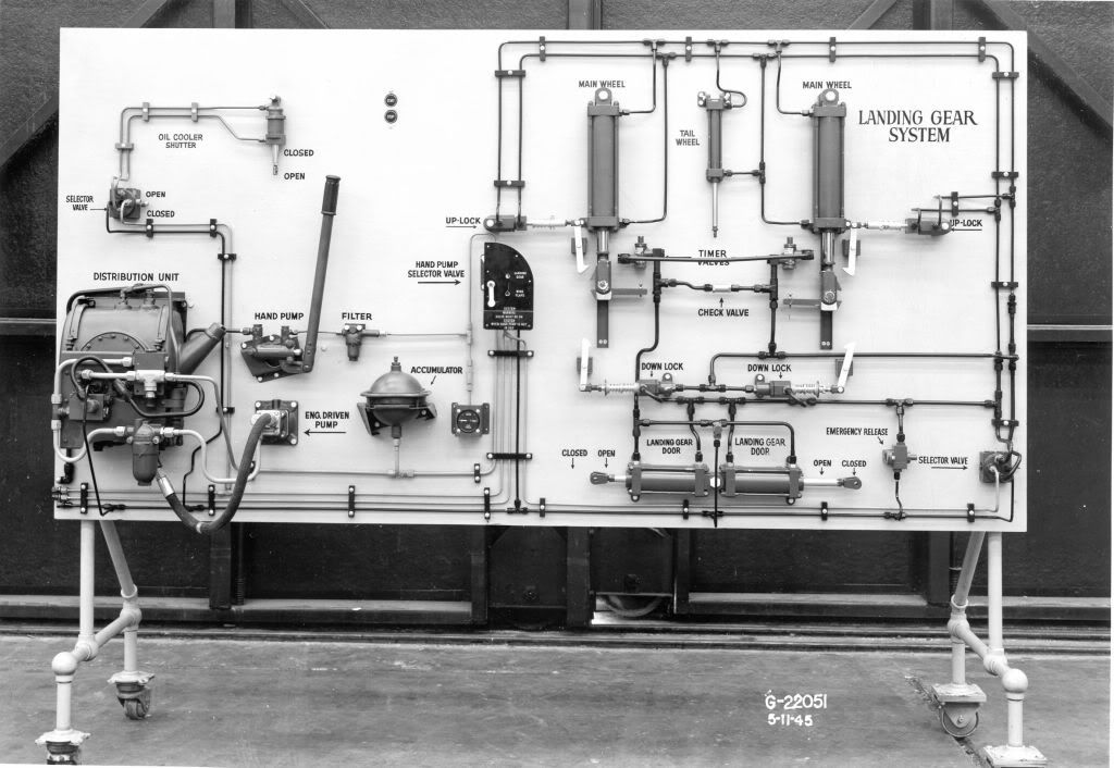

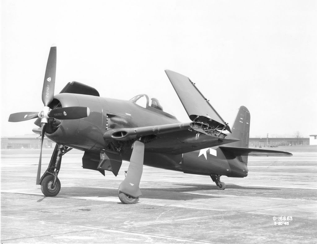

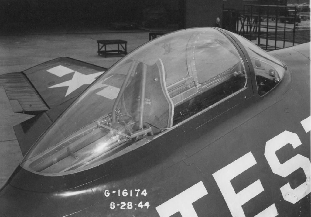

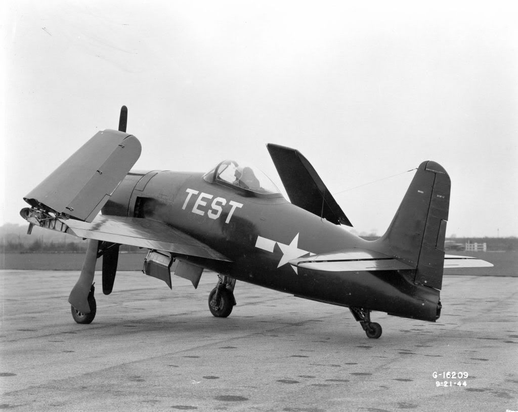

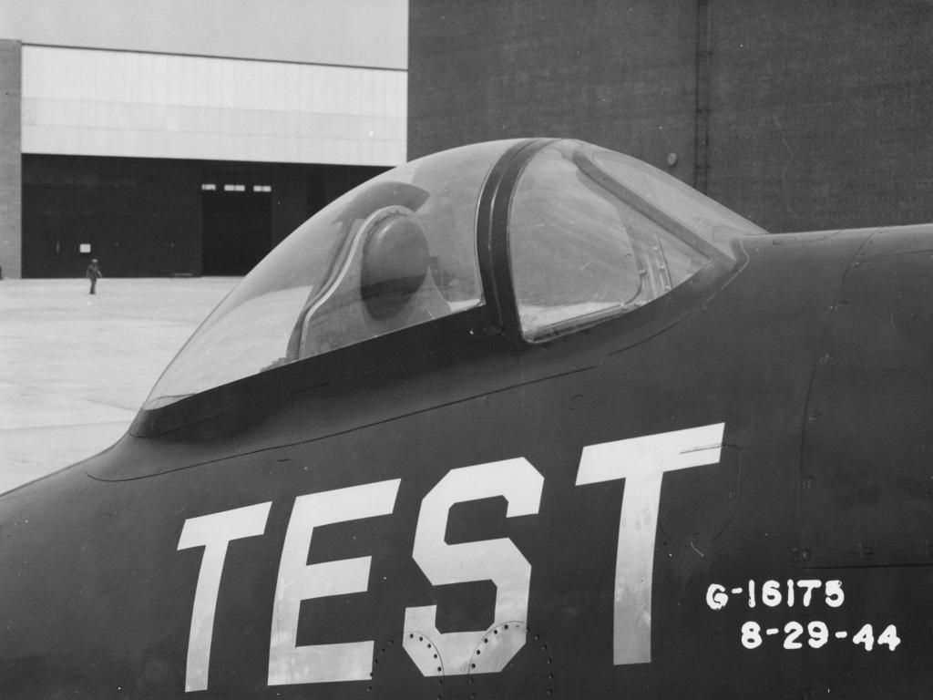

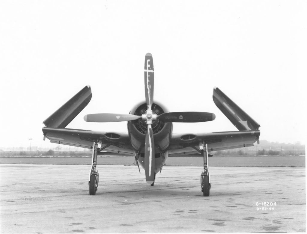

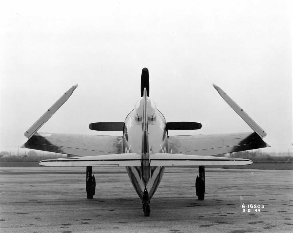

* The Bearcat had a broad resemblance to the Hellcat, but it was very different in detail and it is unclear how much parts commonality there was between the two machines. Like the Hellcat, it was a barrel-shaped aircraft with a low-mounted wings fitted with guns. However, it had an empty weight about 20% less and featured a clearly distinctive all-round vision bubble canopy, being the first operational US Navy fighter with such a feature. It also differed from the Hellcat in having the main gear pivot in the wings and retract towards the fuselage. The wingtips folded up; the Bearcat featured "safety wingtips", in which a wingtip would shear loose at high gee stresses and prevent the entire wing from giving way, permitting the wing to be designed to lower stress limits.

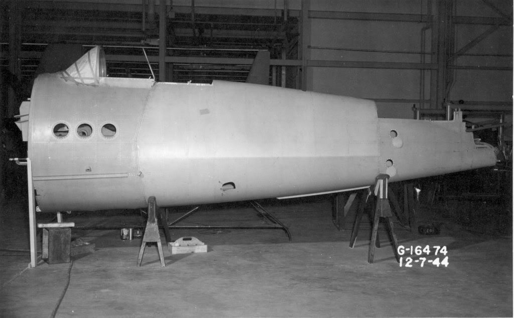

The fuselage skin was thicker, featuring flush rivets and spot welding to reduce drag. The armament was reduced to four 12.7 millimeter Brownings to cut weight. While the ultimate intent was to go to the "E" series Double Wasp engine, with a variable speed supercharger, lack of availability meant that the "C" series engines had to be retained for the time being:

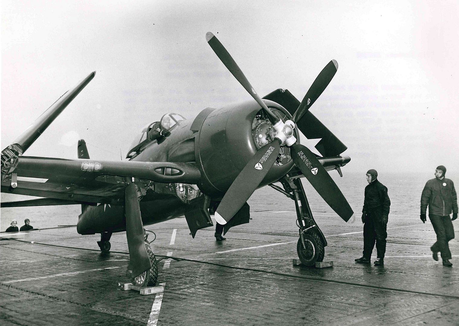

The Double Wasp drove a four-bladed Aeroproducts propeller with a diameter of 3.84 meters (12 feet 7 inches); the prototypes had used Hamilton Standard props.

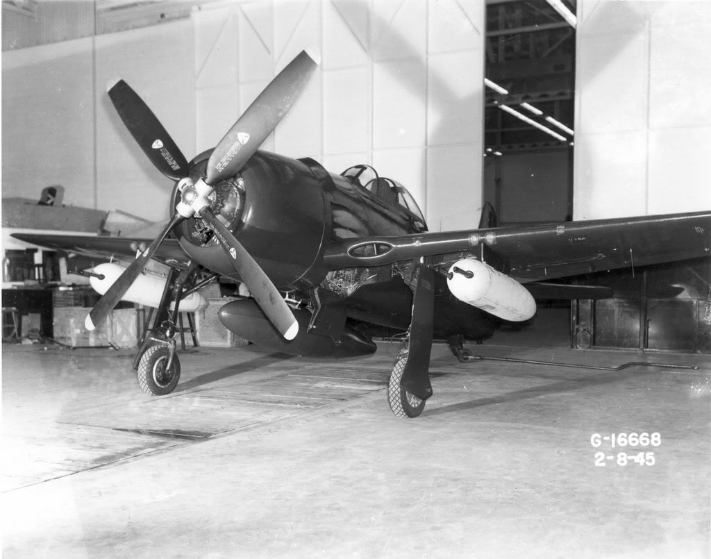

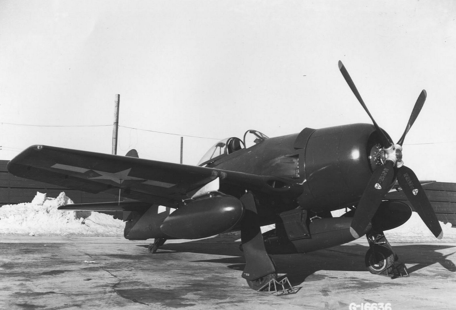

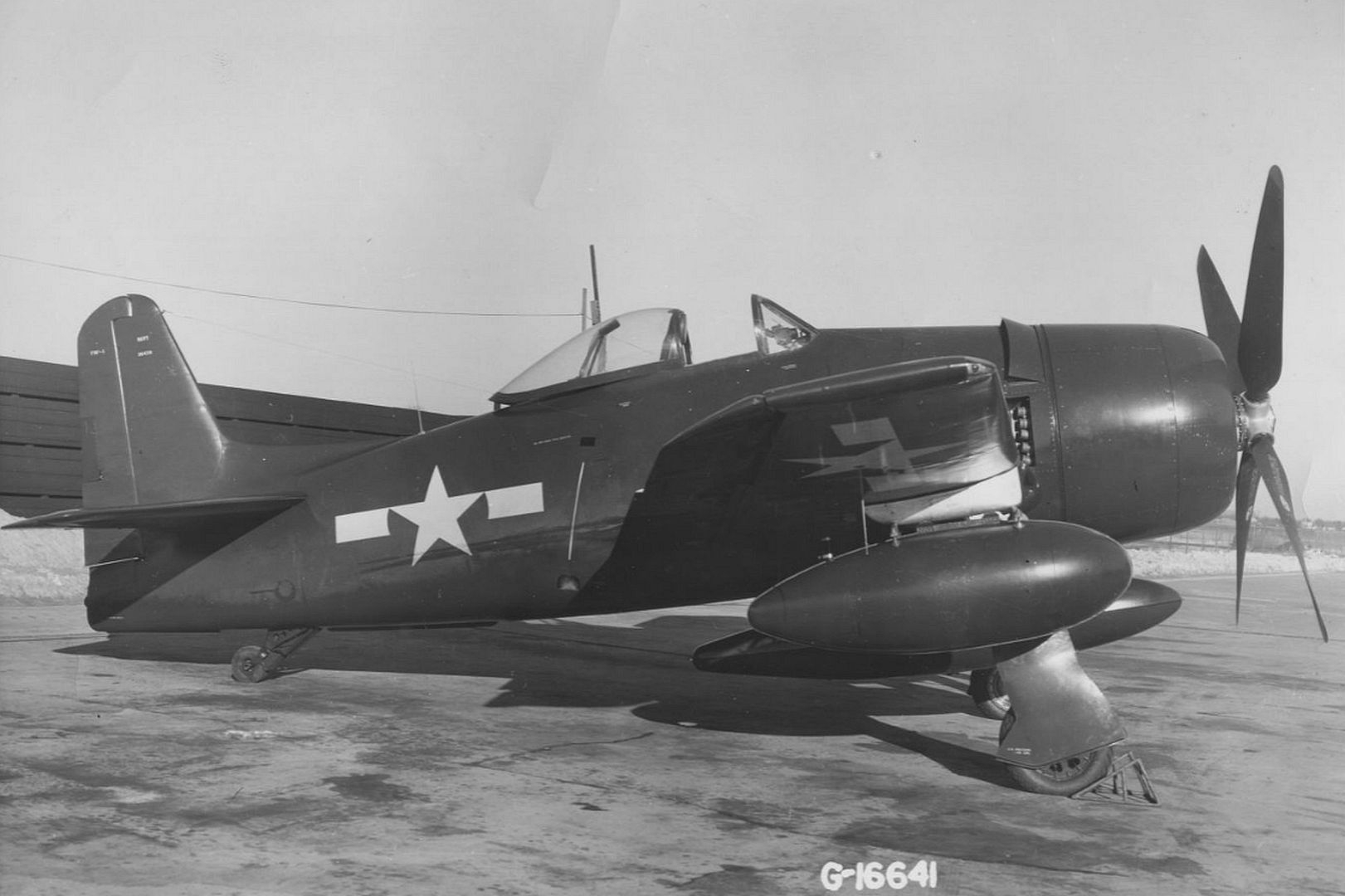

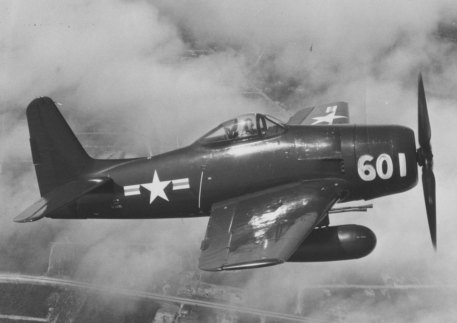

Internal fuel supply was 694 liters (183 US gallons). An external fuel tank with a capacity of 585 liters (150 US gallons) could be carried on a centerline pylon, while a 379 liter (100 US gallon) external tank could be carried under each wing. A 450 kilogram (1,000 pound) bomb could be carried under each wing as an alternative store, with two stubs outboard on each wing for 45 kilogram (100 pound) bombs or HVAR rockets as well. Photographs also show Bearcats carrying two big 29.2 centimeter (11.5 inch) "Tiny Tim" unguided rockets in trials. Total external stores load was 1,090 kilograms (2,400 pounds).

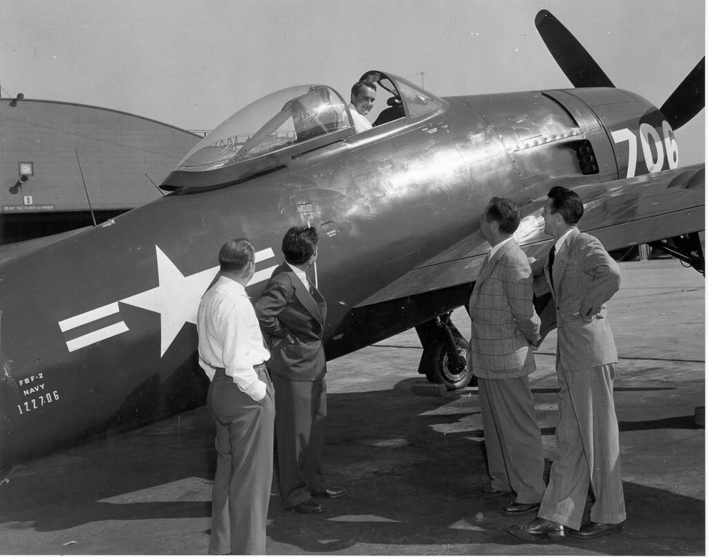

Development of the type "E" Double Wasp engine had been protracted, but after being trialed in two "XF8F-2" prototypes -- both conversions -- it was finally introduced into production with the "F8F-2" in early 1948. The F8F-2s were powered by a water-injected R-2800-30W engine -- despite the lower suffix number, it was a more advanced model than the early R-2800-34W -- providing 1,678 kW (2,250 HP) takeoff power. The F8F-2 also featured 20 millimeter cannon armament as standard, plus a taller tailfin.
365 F8F-2s were delivered, along with 12 new-build "F8F-2N" night fighters and 60 "F8F-2P" photo-reconnaissance machines, featuring cameras plus twin 20 millimeter cannon. However, by the time they were in service the Navy had realized by that time that jets were the way of the future -- mock combat of an F8F-1 versus a Lockheed P-80 on loan to the Navy from the Army Air Forces in the spring of 1946 had proven the P-80 could fly rings around the F8F-1 -- and the Bearcat was seen strictly as an interim solution, until jets like the Grumman F9F Panther and F2H Banshee got into service.

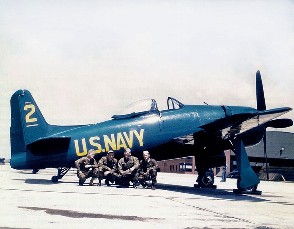

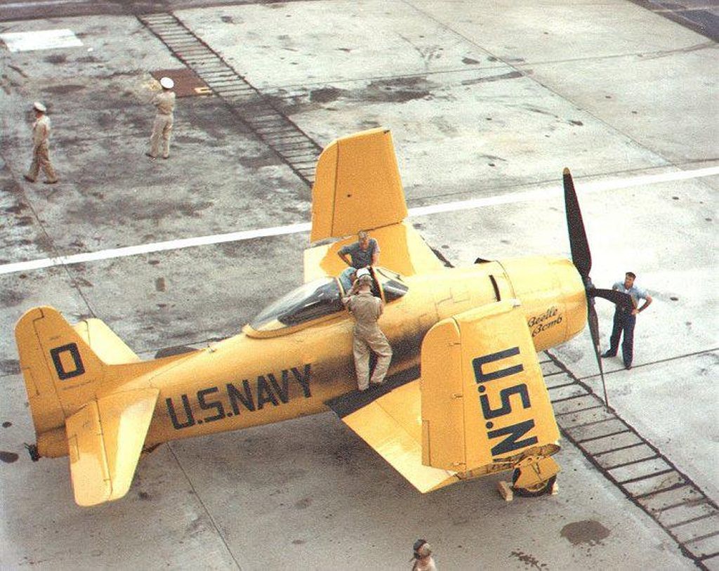

* A total of 24 Navy and Marine squadrons flew the Bearcat in the immediate postwar period. It was the mount for the Navy Blue Angels flight demonstration team from 1946 to 1950. The Bearcat was out of first-line service by the beginning of the Korean War in 1950; it didn't see any combat service in that war because the Navy and Marines judged the F4U Corsair to be a better close-support aircraft. The Bearcat lingered in US military service in the training and, as the "F8F-1D / F8F-2D", drone controller role into the mid-1950s.

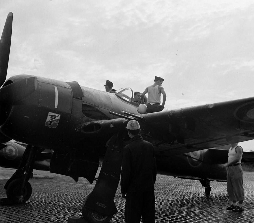

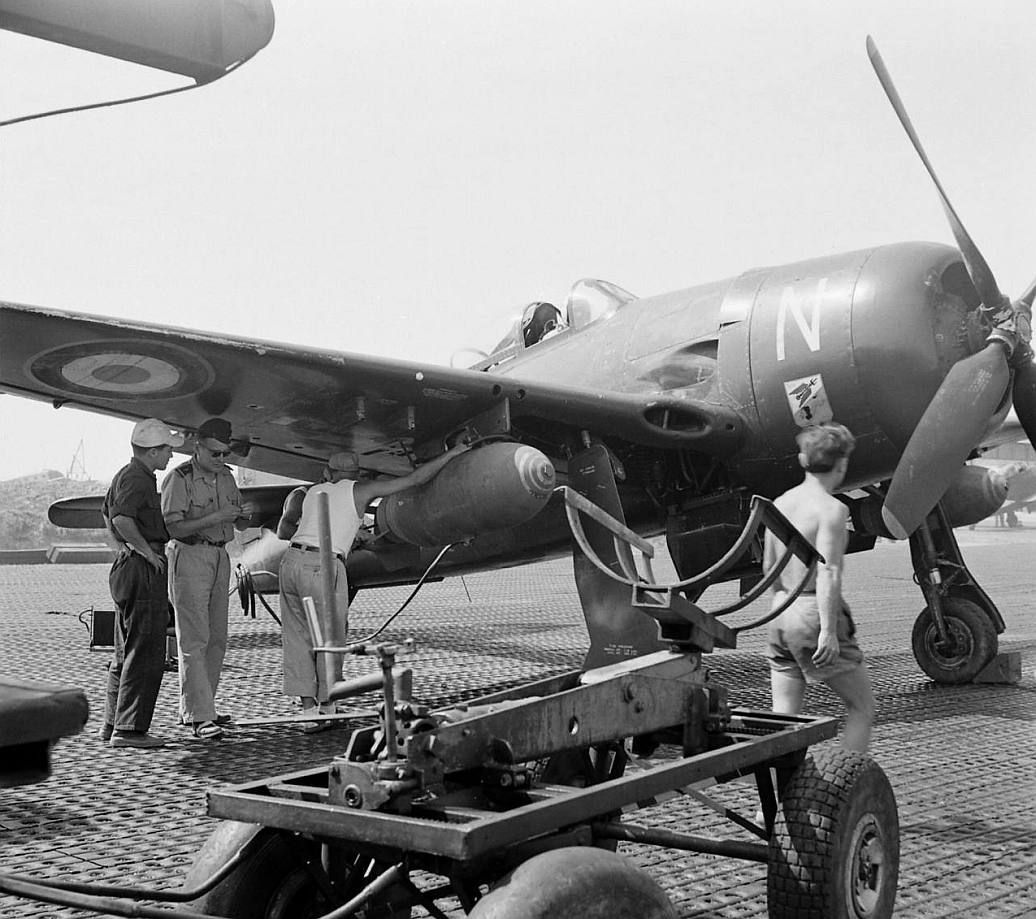

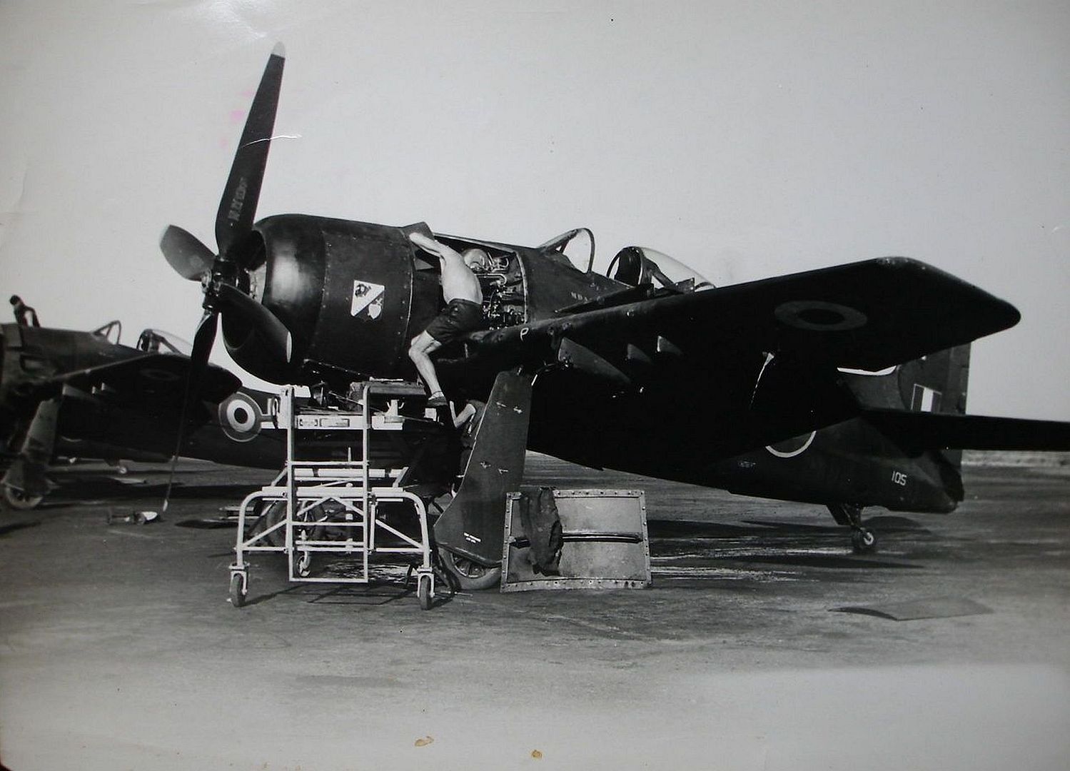

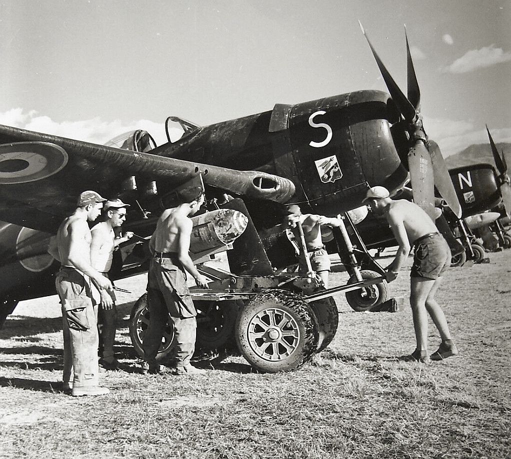

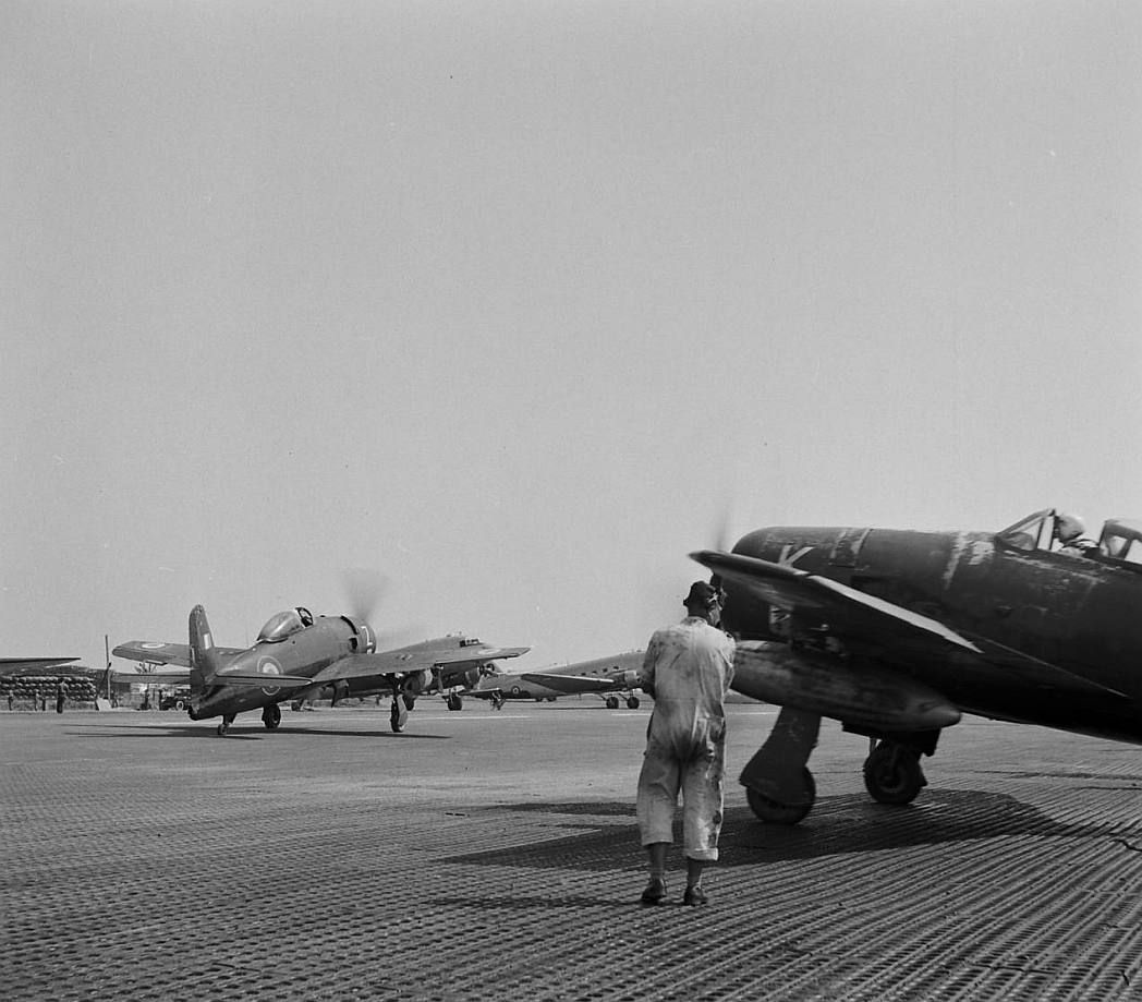

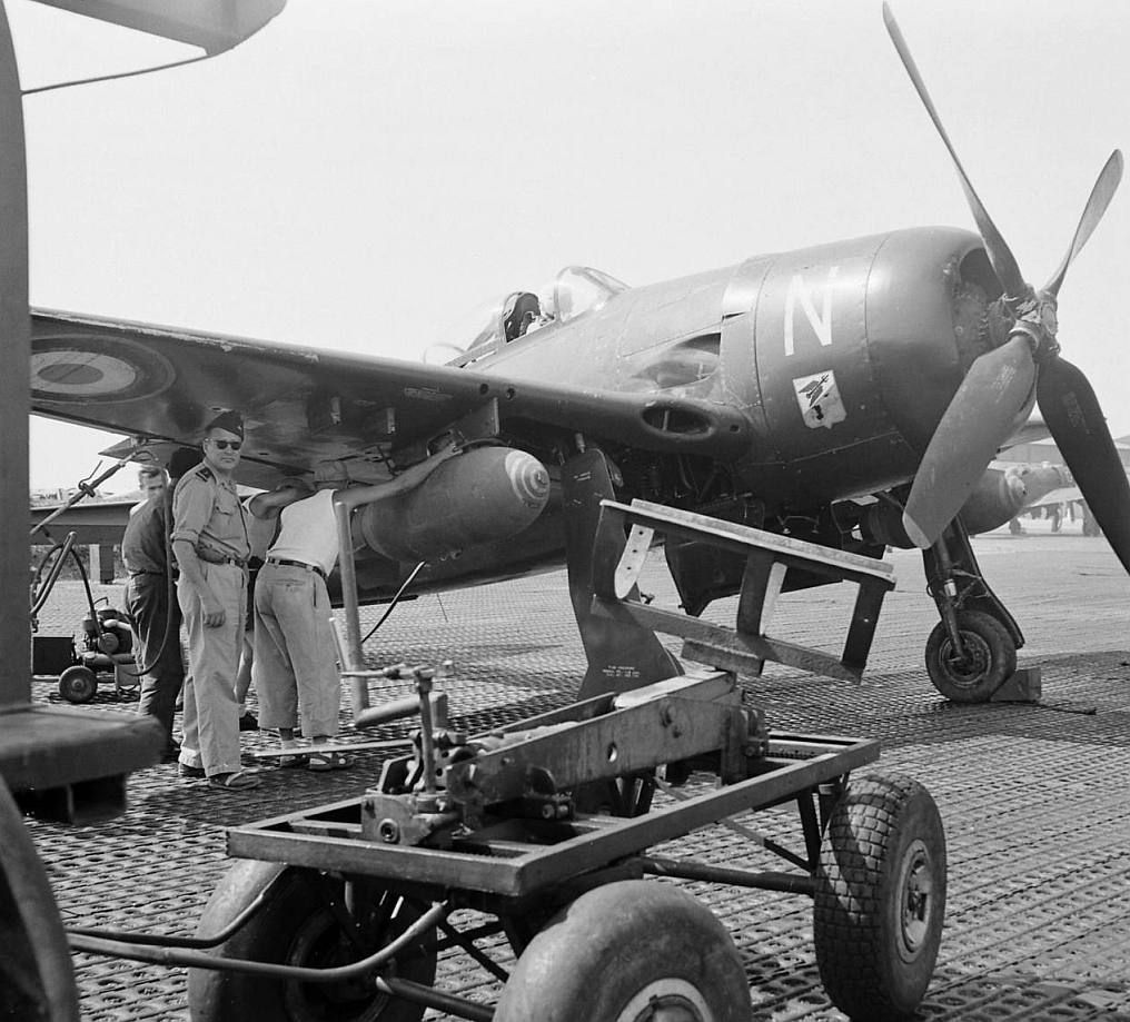

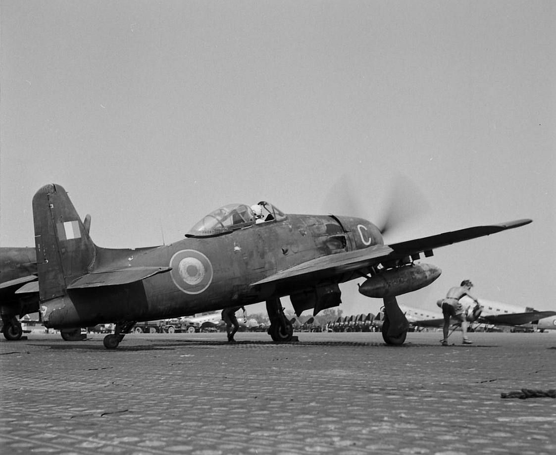

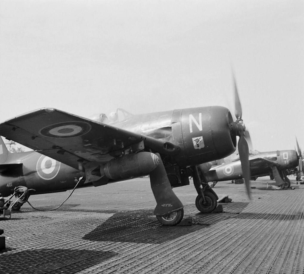

F8F-1s and F8F-1Bs were passed on to the French Armee de l'Air for use in the close-support role during the French war in Indochina in the 1950s. When the French pulled out, some of the Bearcats were passed on to the South Vietnamese Air Force and served into the early 1960s. Bearcats were also passed on to the Royal Thai Air Force, also operating into the early 1960s.

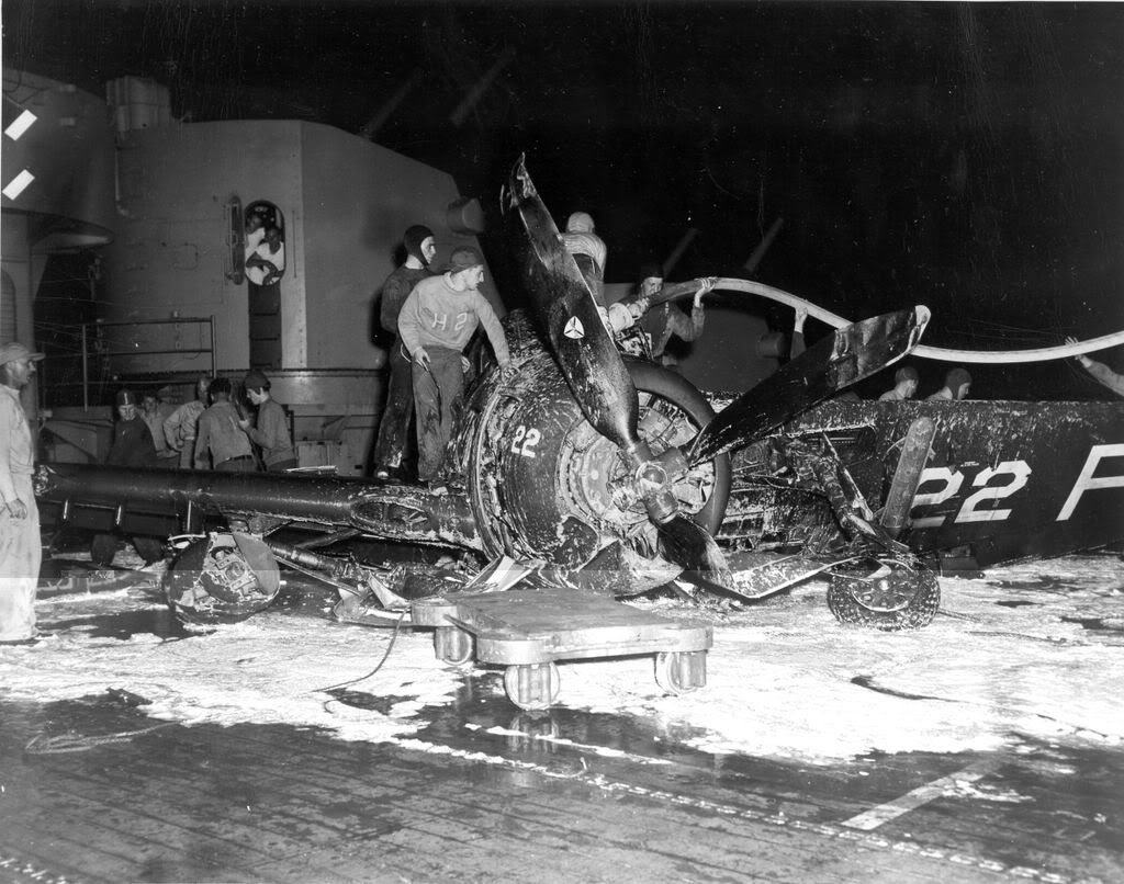

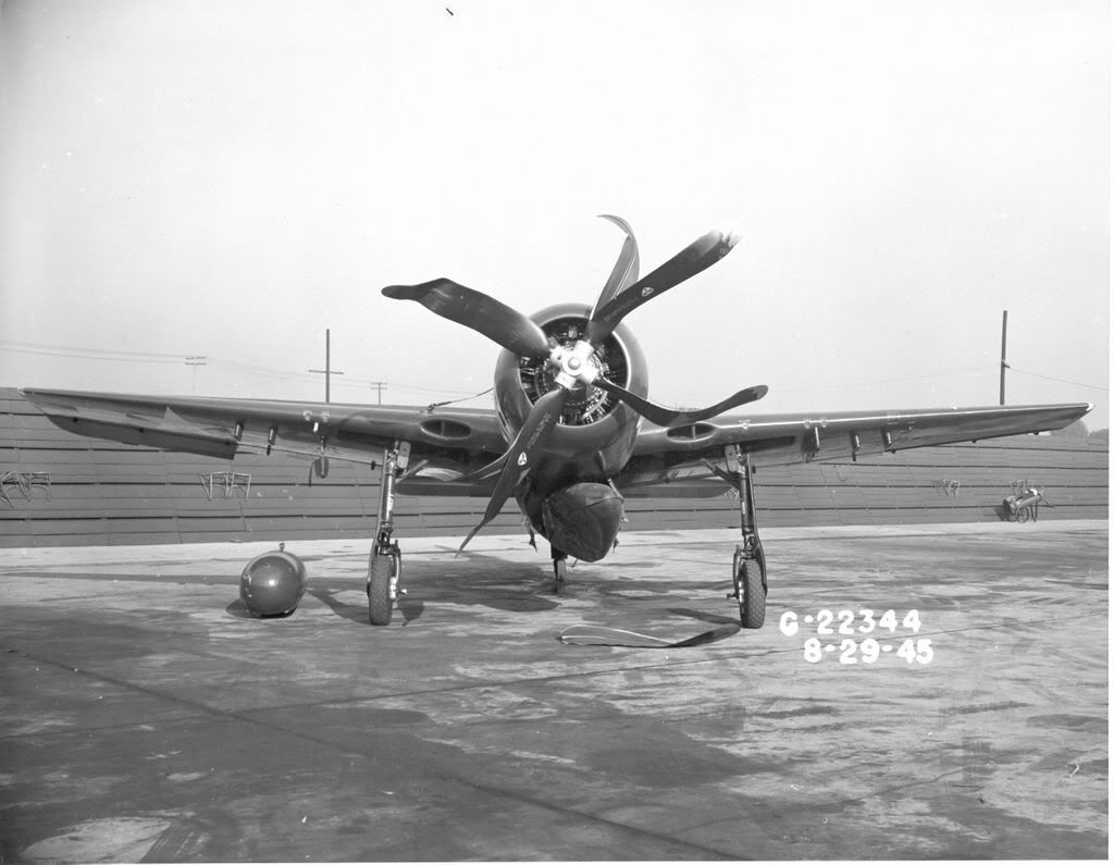

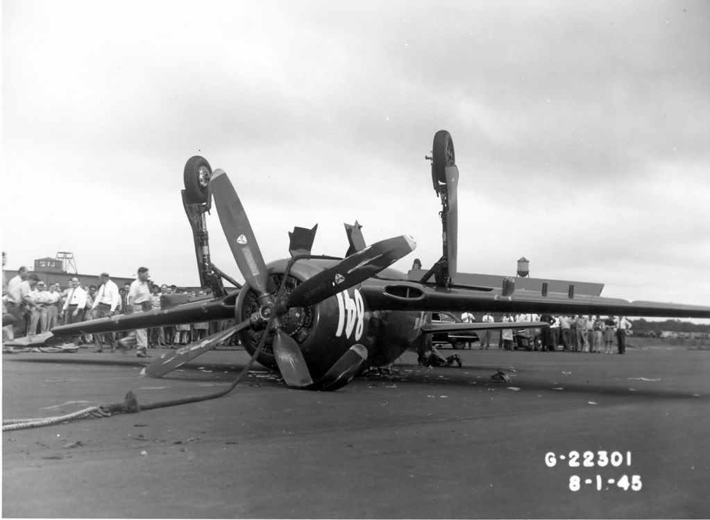

AdminHmmm.... "G-22344" looks like it had a run-in with a Buick Roadmaster or something
