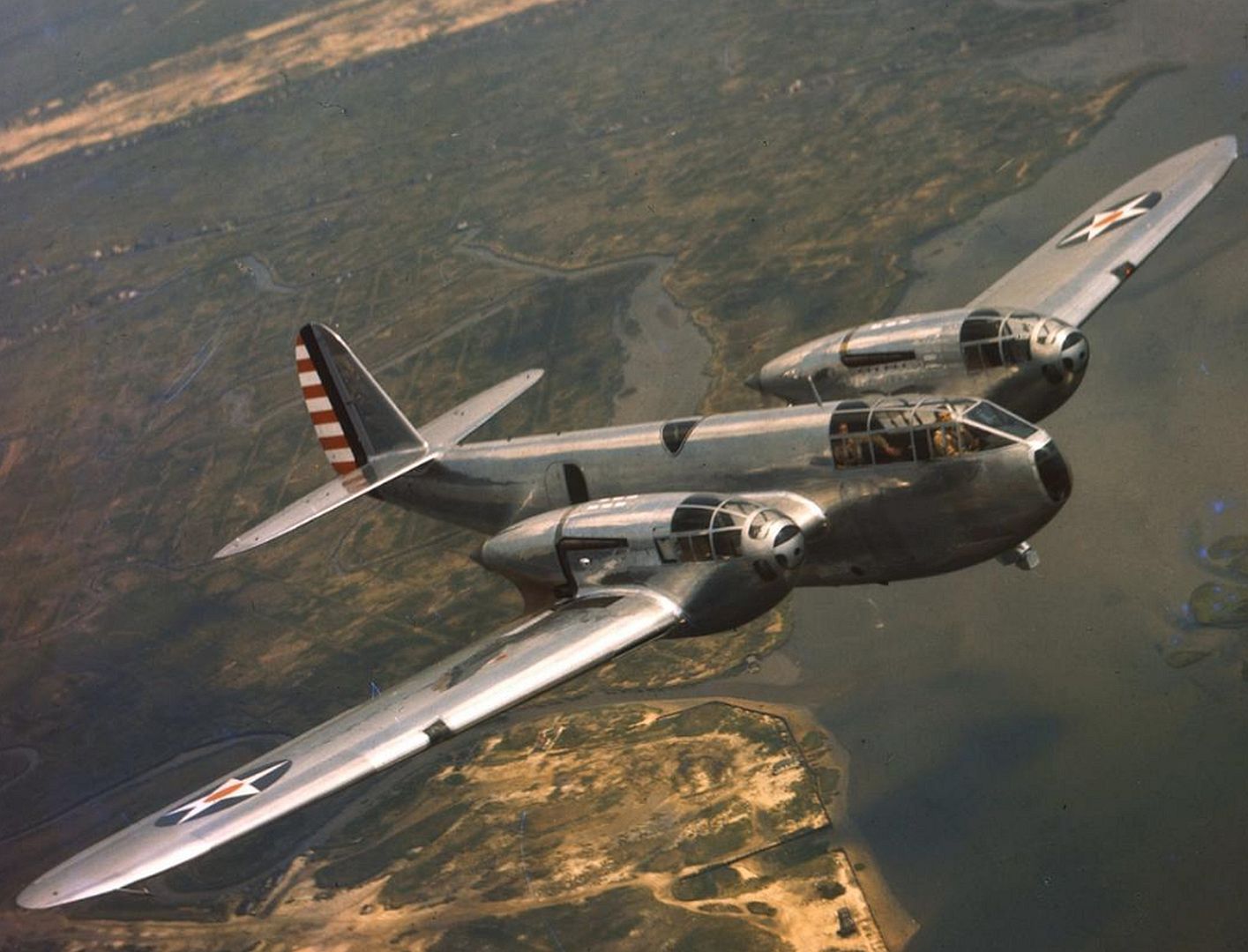

In an effort to break into the aviation business, Bell Aircraft created a unique fighter concept touted to be "a mobile anti-aircraft platform" as well as a "convoy fighter." Created to intercept enemy bombers at distances beyond the range of single-seat fighter interceptors, the YFM-1 (Y, service test; F, fighter; M, multiplace) was an innovative design incorporating many features never before seen in a military aircraft, as well as several never seen again. Using a streamlined, "futuristic" design, the Bell Airacuda appeared to be "unlike any other fighters up to that time."

Design flaws
The Airacuda was plagued with problems from the start. The lofty performance estimates were unobtainable as, despite its sleek looks, the Airacuda was heavy and was slower than most bombers. In the event of interception by enemy fighters, the Airacuda was not maneuverable enough to dogfight, while the meager 600 lb (270 kg) bombload was of little use in the intended fighter-bomber role. Even the 37 mm cannons were of less value than predicted. The cannons had a tendency to fill the gun nacelles with smoke whenever fired and, additionally, fears persisted as to how the gunners would escape in an emergency, with the propellers directly behind them. An emergency bailout would have required both propellers to be feathered, though additional provision was made with the use of explosive bolts on the propellers to jettison them in the event of a bailout.
The Allison V-1710-41 engines, though relatively trouble-free in other types, had no additional cooling systems. Like many pusher designs, they were prone to overheating. On the ground, the aircraft had to be towed to and from the runway and could only be started when the Airacuda was able to take off immediately. Even in the air it was not uncommon to experience overheating problems. Although designed for turbo-supercharging, the first flights were made with V-1710-9 carbureted engines that only delivered 1,000 hp (750 kW) each. Despite the 5 ft (1.5 m)-long shaft extensions, there were no problems with this feature. When the turbos were fitted to the later YFM-1, they were plagued by cranky turbo regulators that backfired continuously. An explosion during a September 1939 test flight made it apparent that the teething engine troubles would not be solved easily.
Additionally, Marshall Wainwright notes that other sources indicate the first eight aircraft were to originally have been powered by Allison V-1710-13 engines fitted with GE Type B-6 turbosuperchargers. These aircraft were eventually delivered with improved V-1710-23(D2) engines. Wainwright further states that two of the YFM-1 airframes were changed on the production line to accept the V-1710-41 without turbosupercharging, becoming YFM-1Bs. This is noted in a contract change dated 19 October 1939 which shows that aircraft 34-489 and 38-490 had their turbos, all associated ducting, and controls removed and V-1710-41(D2A) "Altitude Rated" engines installed instead. The (D2A) was essentially a -23 with higher supercharger gear ratios (8.77:1 versus 6.23:1), which allowed the motor to develop around 1,090 horsepower (810 kW) up to 13,200 ft (4,000 m) ASL. They used the same ratings and components as the Altitude Rated V-1710-33(C15) Allison fitted to the original Curtiss XP-40. Allison was paid $1,690 to modify each engine.
Initial flight testing by Lt. Ben Kelsey proved the Airacuda virtually impossible to control with only one engine, as the aircraft would go into an immediate spin. Problems with stability in pitch were also encountered, and had to be corrected by reducing power. Test pilot Erik Shilling described his experiences in a later book, Destiny: A Flying Tiger's Rendezvous With Fate as:
Flying the Bell Airacuda was a new experience for me, since it was the first pusher aircraft I'd ever flown. Its handling characteristics were foreign to anything I had ever had my hands on. Under power it was unstable in pitch, but stable with power off. While flying straight and level, if a correction in pitch was required, a forward push on the control resulted in the airplane wanting to pitch over even more. Pitch control became a matter of continually jockeying the controls, however slightly, even when the aircraft was in proper trim. The same applied if pulling back on the control. It would tend to continue pitching up, requiring an immediate corrective response. The same happened in a turn with power off, the Bell became stable in pitch. This was fortunate because during approach and landing, it was very stable, and a nice flying airplane."
The Airacuda was also saddled with a complex and temperamental electrical system and was the only aircraft ever built to rely on an independent auxiliary power unit (APU) to power both engine fuel pumps, as well as all aircraft electrical systems. Systems usually powered by an aircraft's engines were instead powered by the single generator. The generator, with its own supercharger, was located in the belly of the aircraft. In the event of a failure (and they occurred frequently), the crew was instructed to begin immediate emergency restart procedures as the aircraft basically shut down. When the APU failed, the pilot had "NO fuel pressure, NO vacuum, NO hydraulic pressure, NO gear, NO flaps and NO ENGINES".
