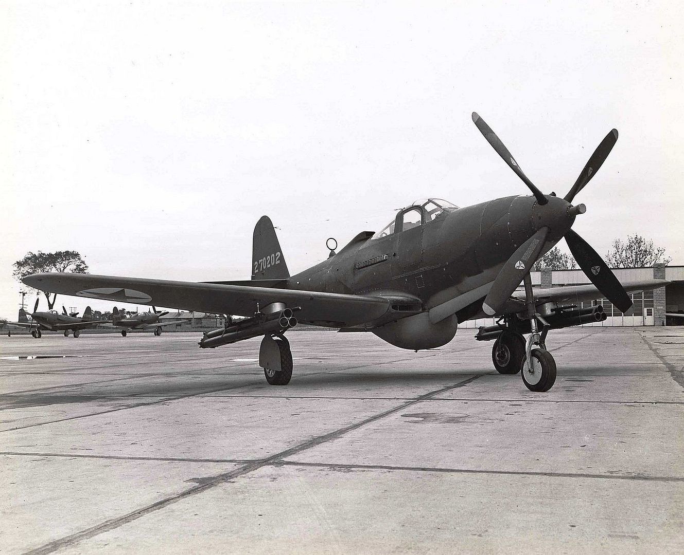

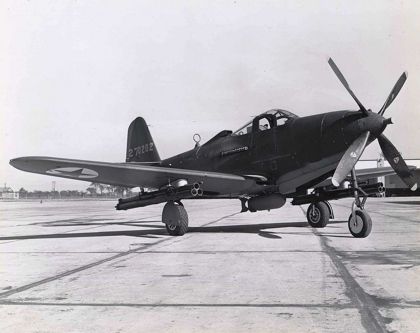

The P-63A-10 had rocket rails fitted underneath the wings. The weight of the armor increased to 236.3 pounds.
