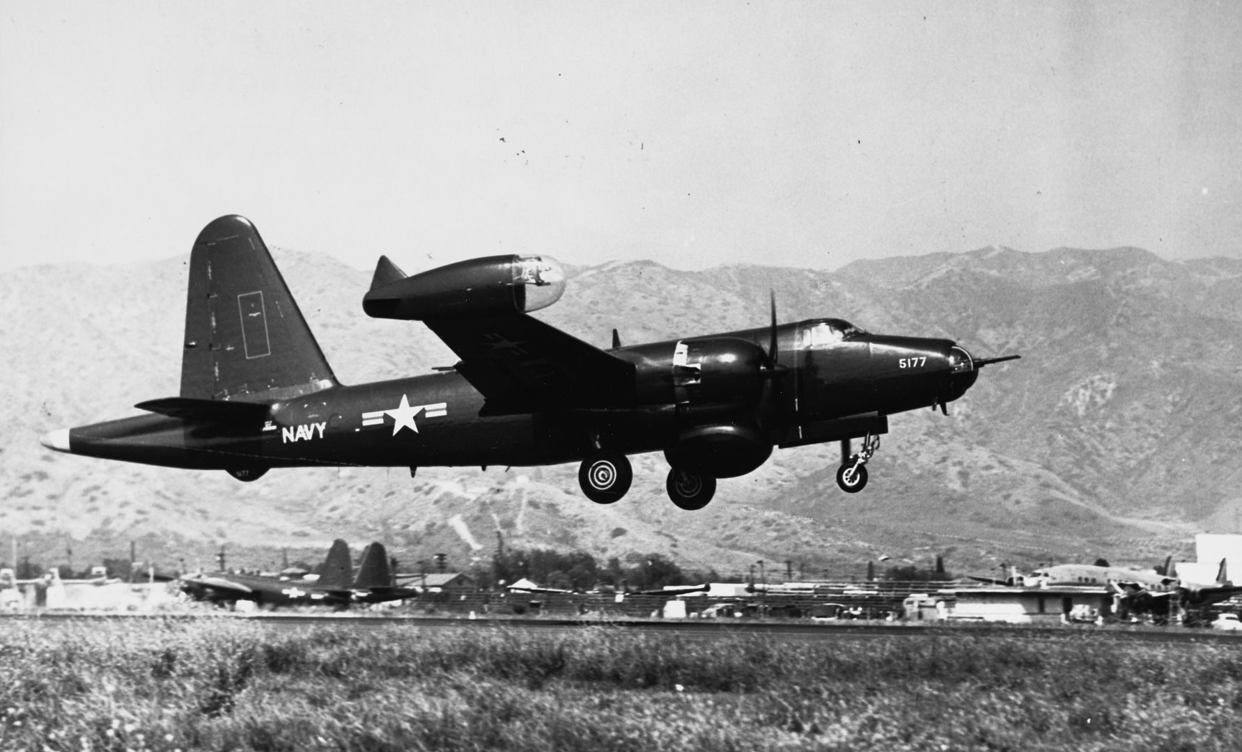

    The US Navy took delivery of the first of 15 production "P2V-1" Neptunes in early 1946, with the last of the variant delivered by May 1947. The production P2V-1s were generally similar to the prototypes, though there were some minor aerodynamic fixes and the size of the radome was enlarged.
    The Neptune handled well on takeoff and landing, could climb rapidly for an aircraft of its configuration, and had good single-engine performance. It had a top speed of 485 KPH (300 MPH) and a range of 6,650 kilometers (4,130 miles). The interior was comfortable by the standards of military aircraft of the time, reducing crew fatigue on long ocean patrols. The flight surfaces of the aircraft were fitted with alcohol de-icers, and the wings could provide flotation for a time if the aircraft were ditched at sea.

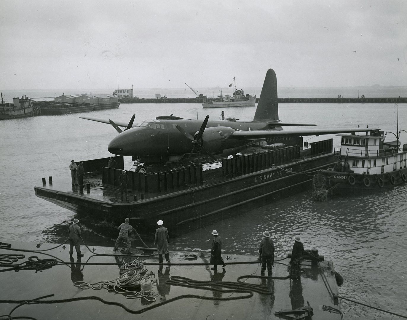

    The third P2V-1, named the TRUCULENT TURTLE, was stripped down, fitted with auxiliary fuel tanks plus an extended nose, and set an unrefueled long distance flight record in September 1947. The TURTLE flew from Perth, Australia, to Columbus, Ohio, with a crew of four Navy officers and a young kangaroo, covering 18,089.3 kilometers (11,235.6 miles) in 55 hours 17 minutes. This record stood until 1962, when an Air Force B-52H flew non-stop from Okinawa to Madrid, Spain, a distance of 20,177 kilometers (12,532.3 miles). The TURTLE is now on display at the US Naval Air Museum in Pensacola, Florida.

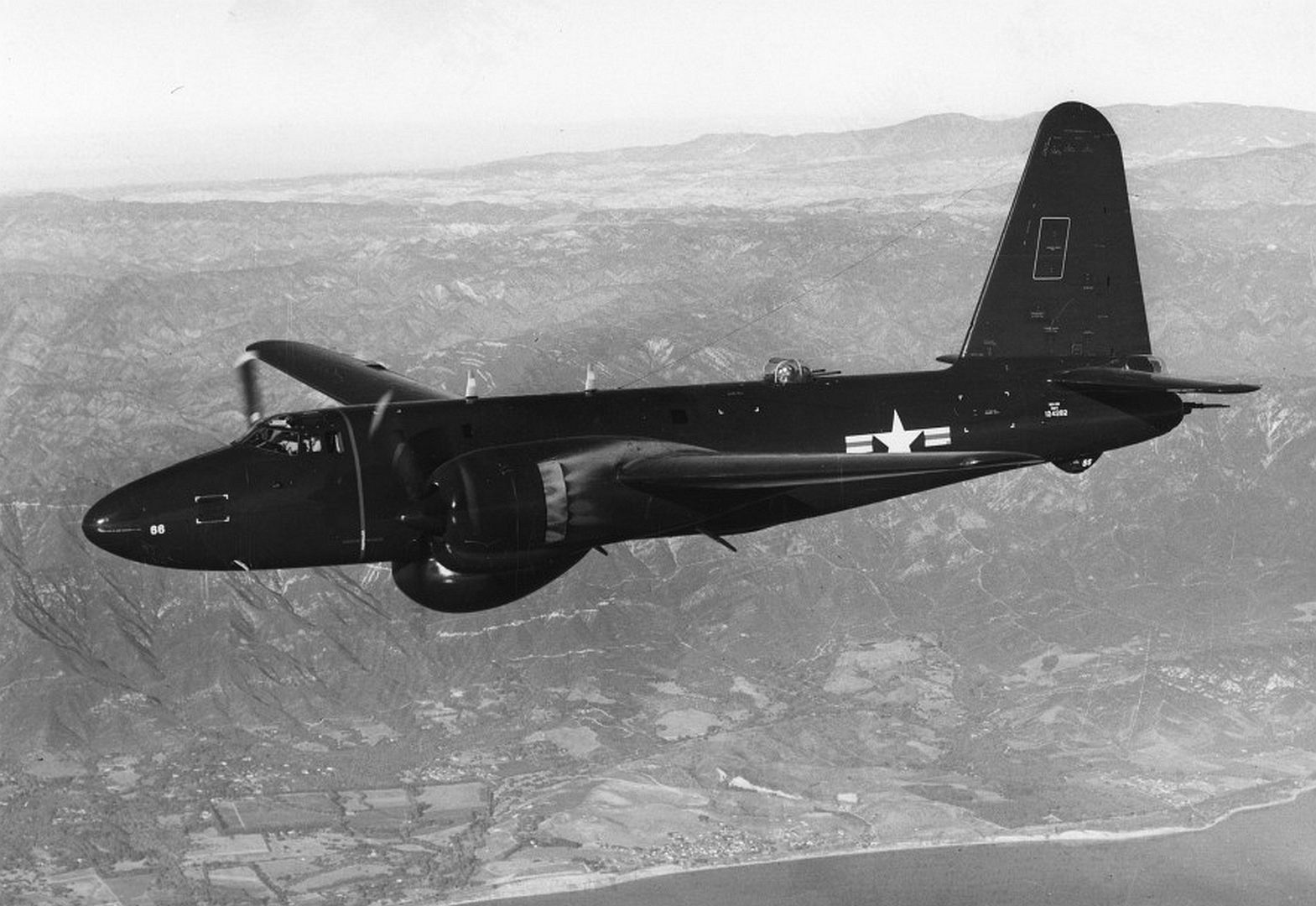

    The prototype for the second series of Neptunes, the "P2V-2", was modified from the fifth production P2V-1 to produce a more effective aircraft with one less crew member. The P2V-2 prototype first took to the air on 7 January 1947. The P2V-2 featured an extended nose, much like that of the TRUCULENT TURTLE, that stretched the aircraft 76 centimeters (2.5 feet) and did much to improve its looks. The nose turret was replaced with six fixed forward-firing 20-millimeter cannon; the nose also contained radar. The dorsal turret was lowered and streamlined. The twin 12.7-millimeter tail guns were retained in early production, but were replaced by twin 20-millimeter cannon in the ninth and later aircraft. The wings were fitted with a total of sixteen stubs for 12.7-centimeter (5-inch) High Velocity Air Rockets (HVARs).
    The P2V-2 had uprated Wright Cyclone R-3350-24W engines, providing 1,865 kW (2,500 HP) each, with takeoff power of 2,090 kW (2,800 HP) using water injection. The P2V-2 was fitted with three-bladed Hamilton Standard propellers, replacing the four-bladed props used on the P2V-1. Racks for four jet-assisted take off (JATO) rocket bottles were provided on each side of the rear fuselage. The JATO bottles could provide 35.3 kN (3,600 kgp / 8,000 lbf) of thrust for ten seconds. Some P2V-2s had a second dome aft of the bomb bay; it might have been for some type of signals intelligence (SIGINT) gear, such as a radio emitter locator.
    The changes resulted in an increased maximum takeoff weight of 28.6 tonnes (63,078 pounds), and a slightly reduced range of 6,410 kilometers (3,980 miles). However, the more powerful engines gave the P2V-2 a higher top speed of 515 KPH (320 MPH).

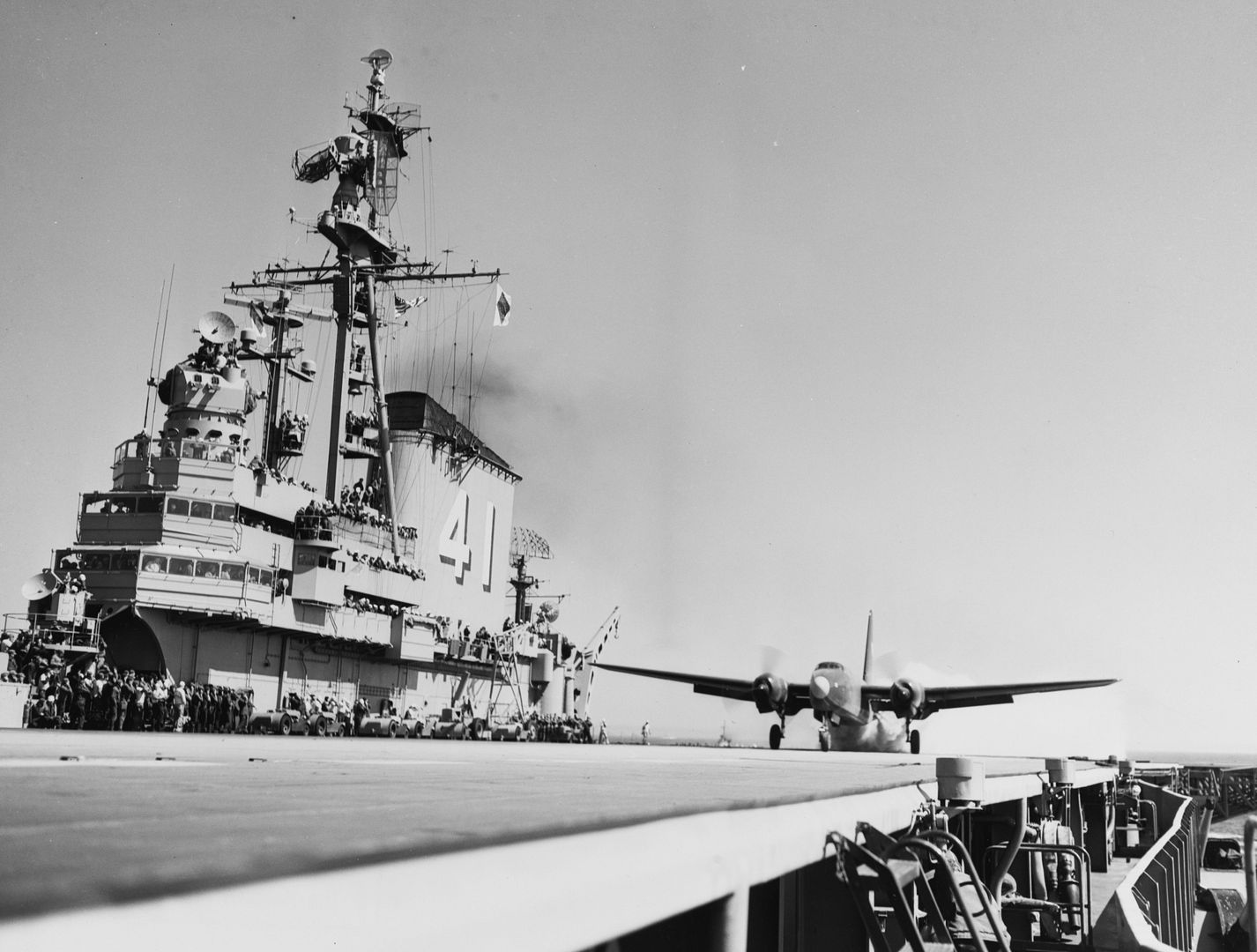

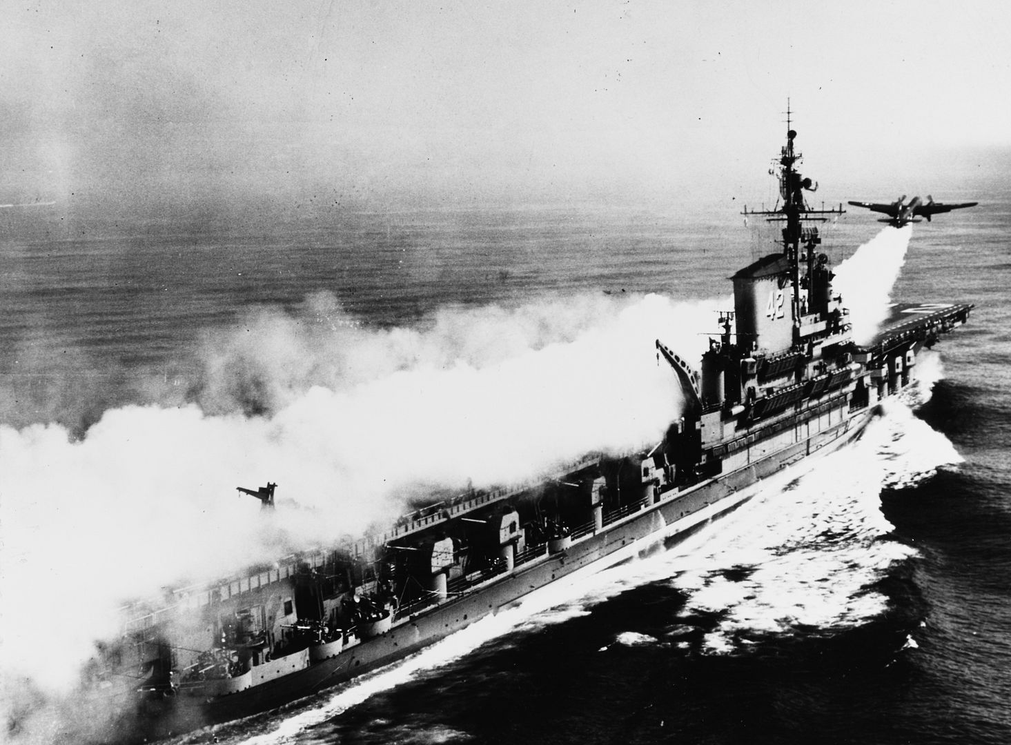

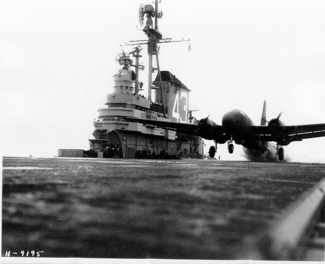

    The "P2V-3C" carrier-launched aircraft. Eleven P2V-3Cs were built to provide the US Navy with a carrier-launched nuclear strike capability. These aircraft were fitted them with eight 4.4 kN (450 kgp / 1,000 lbf) thrust JATO bottles under the rear fuselage. Unsurprisingly, there was no provision for carrier recovery. Getting such a big aircraft off a carrier deck was impressive when the Neptune hadn't been designed to do such a thing to begin with, and landing it on a carrier would have been quite a trick. The aircraft was to fly to a friendly base after dropping its nuclear weapon, or ditch near a Navy vessel. The P2V-3C was purely a stopgap, a politically-driven measure intended to give the Navy a nuclear strike capability until the North American AJ Savage carrier-based nuclear bomber became available.
    The P2V-3C was stripped of nose armament, dorsal turret, HVAR stubs, belly radome, astrodome, and tail skid. Additional fuel tanks were installed. Several P2V-3Cs set records for carrier-launched aircraft in 1948 and 1949.

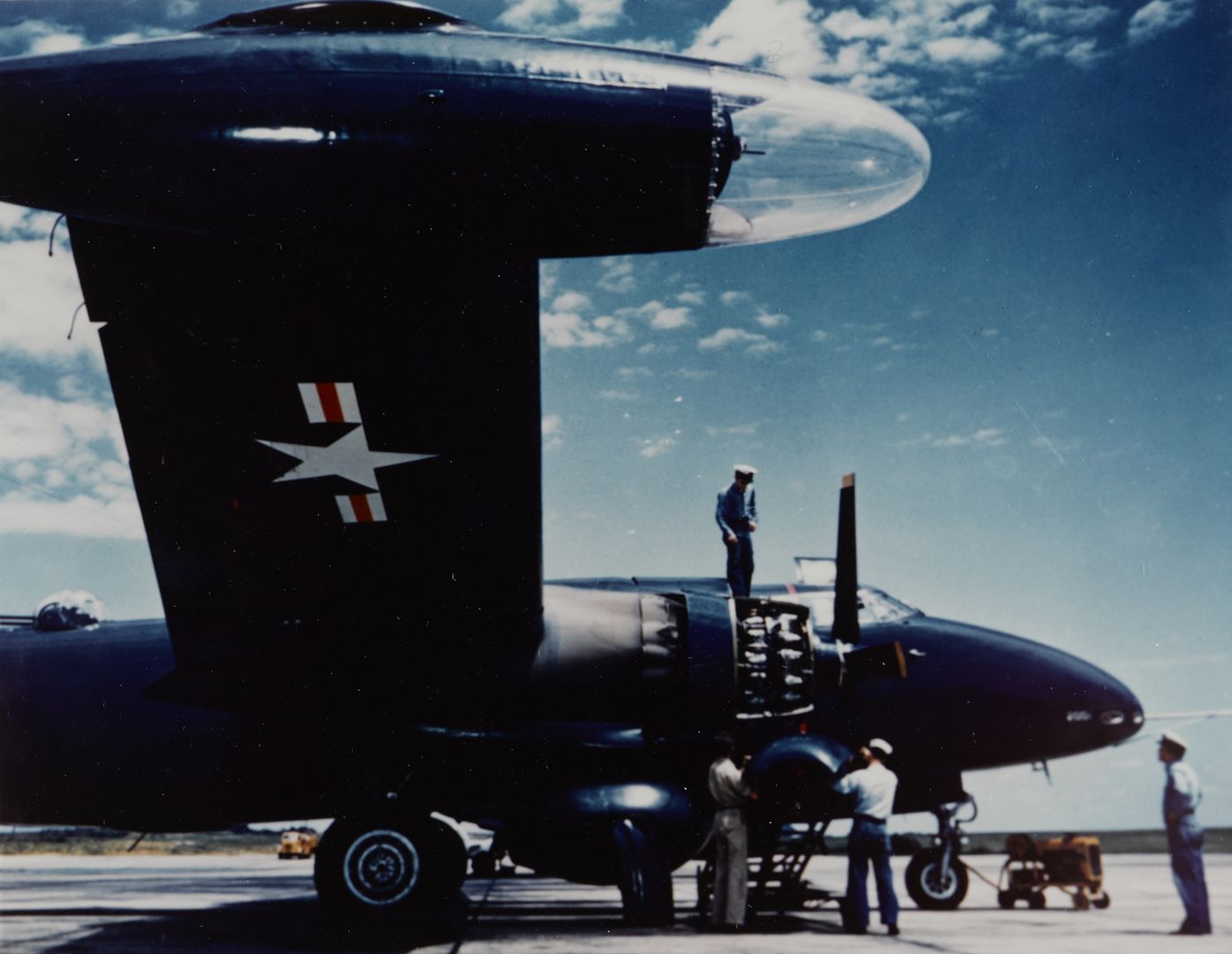

    * The "P2V-4" was another stepwise refinement of the Neptune type, featuring yet another uprated powerplant fit, increased fuel capacity, and standard fit of the AN/APS-20 radar and associated enlarged radome used on the P2V-3W. The first P2V-4 flew on 14 November 1949.
    The new powerplants were Wright R-3350-30W Turbo-Compound engines with 2,800 kW (3,750 HP) each, though early production aircraft had the R-3350-26W engines used on the P2V-3 and were upgraded to the new engines later. All the P2V-4s used four-bladed propellers. The top speed was increased once more, to 565 KPH (350 MPH). The additional fuel tanks fitted to the P2V-1 TRUCULENT TURTLE for its record breaking distance flight led Lockheed engineers to consider what might be done to improve the fuel capacity of the Neptune in general, and the P2V-4 incorporated additional fuel tanks in the fuselage and wings. It also featured spindle-shaped external tanks that were attached under the wing tips. The external tank attached to the right wingtip included a searchlight in its nose. The increased fuel capacity gave the P2V-4 a range of 6,750 kilometers (4,200 miles).
    Armament fit of the P2V-4 was the same as that of the standard P2V-3. It carried radio sonobuoys to improve its antisubmarine capabilities, and was known as the "Snorkel Snipper" since its likely prey was to be diesel submarines operating with snorkels. Crew was increased to eight to include a sonobuoy operator.
    52 P2V-4s were built. There were no formal subvariants. Some P2V-4s were used for ocean patrol during the Korean War. In 1962, the US military changed to a uniform aircraft designation system, and P2V-4s still in operation with the US Naval Reserve were redesignated "P-2Ds".

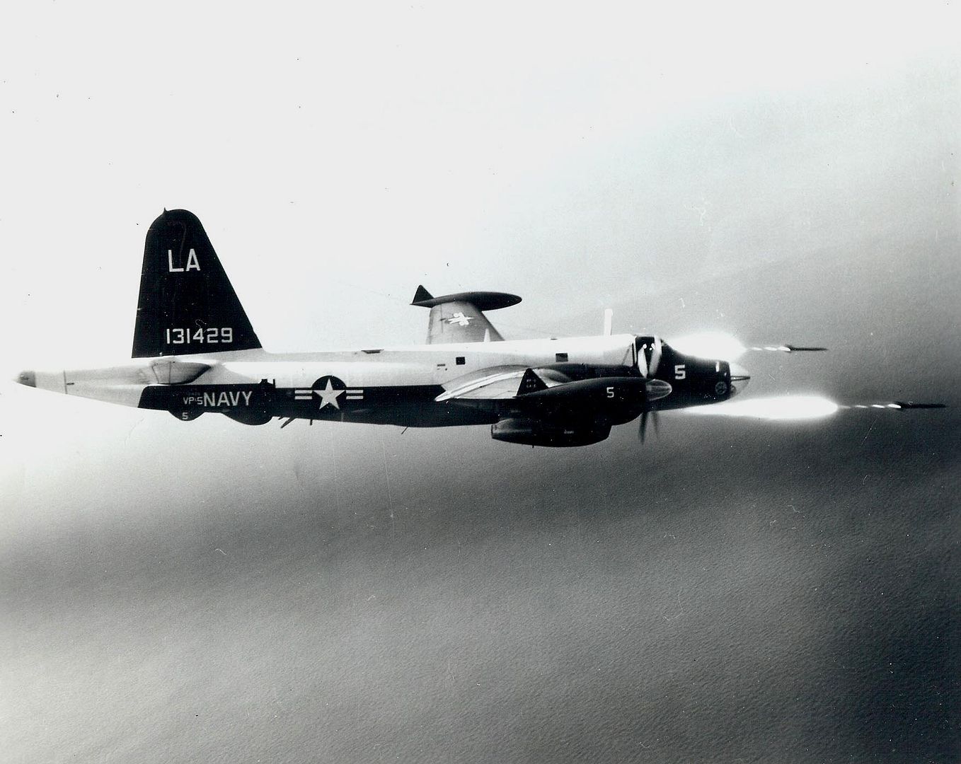

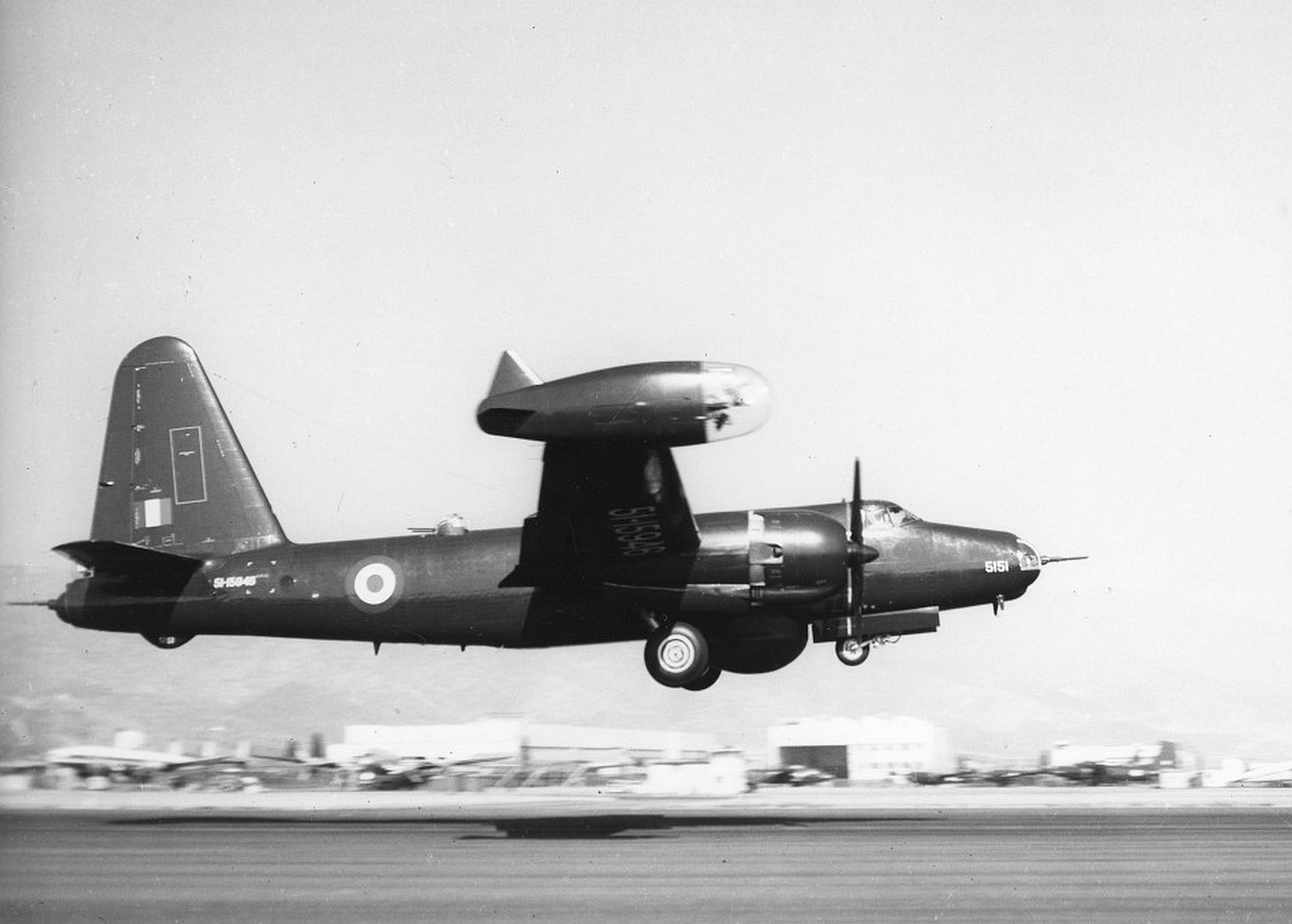

    The "P2V-5" was the definitive Neptune variant, with 424 built. It replaced earlier Neptune variants in first line operation, relegating them to reserve status. Various changes and enhancements made through its subvariants resulted in an aircraft distinctly different in appearance from its predecessors. Its successors would retain much the same configuration.
    The first P2V-5 flew on 29 December 1950, and the type performed ocean patrols during the later parts of the Korean War. The P2V-5 retained the same powerplants as the P2V-4, but the six fixed 20-millimeter cannon in the nose were replaced by an Emerson nose turret mounting twin 20-millimeter cannon. Additional anti-submarine warfare (ASW) and electronics countermeasures (ECM) gear -- particularly an AN/ALR-3 countermeasures receiving set, with small fairings on the side of the nose and rear fuselage -- were incorporated, and another crew member was added to operate the new ASW-ECM gear, bringing the total to nine.
    The wingtip tanks introduced in the P2V-4 were enlarged and attached directly to the wingtips, instead of under them, though initial production retained the earlier tanks. Range was increased to 7,650 kilometers (4,750 miles). The bigger tanks had fins and could be dropped in an emergency. The right wingtip tank had a searchlight in front whose movement was synchronized to and boresighted with that of the nose turret. Apparently one of the wingtip tanks was also fitted with a short-range radar, variously given as the AN/APS-8 or AN/APS-31, and either fitted in the nose of the left wingtip tank or ganged to the searchlight in the right. In any case, the P2V-5 retained the AN/APS-20 search radar of the P2V-4.
    The P2V-5 was upgraded with new features during production, such as:
    A raised cockpit with bigger windscreens for improved visibility.
    A clear glass observation position that replaced the nose turret.
    A long AN/ASQ-8 MAD stinger that replaced the tail turret.
    One of the most distinctive updates was a refit with two 15.1 kN (1,540 kgp / 3,400 lbf) thrust Westinghouse J34-WE-34 turbojets, fitted outboard of the piston engines. These turbojets were used to assist in take-offs and for additional combat speed. The number of HVAR stub launch rails was reduced from 16 to 8 when the turbojets were fitted. This subvariant was designated the "P2V-5F".

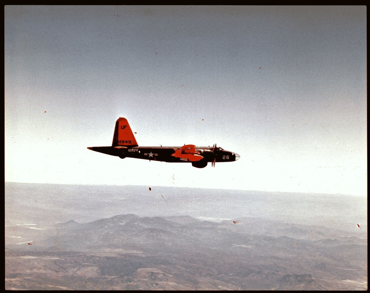

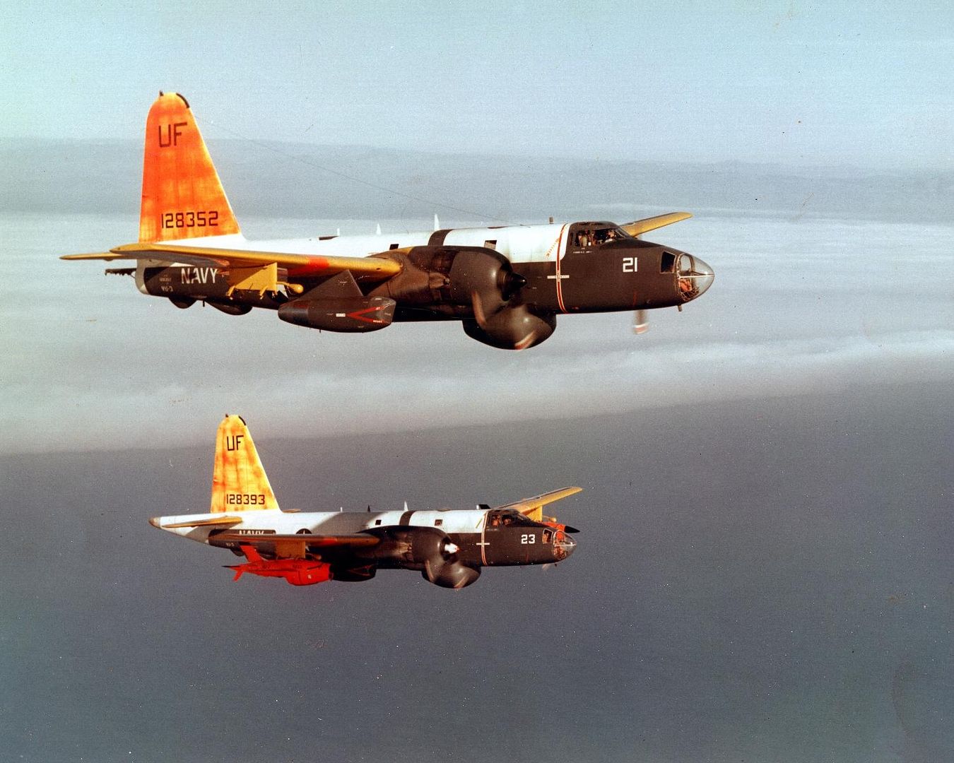

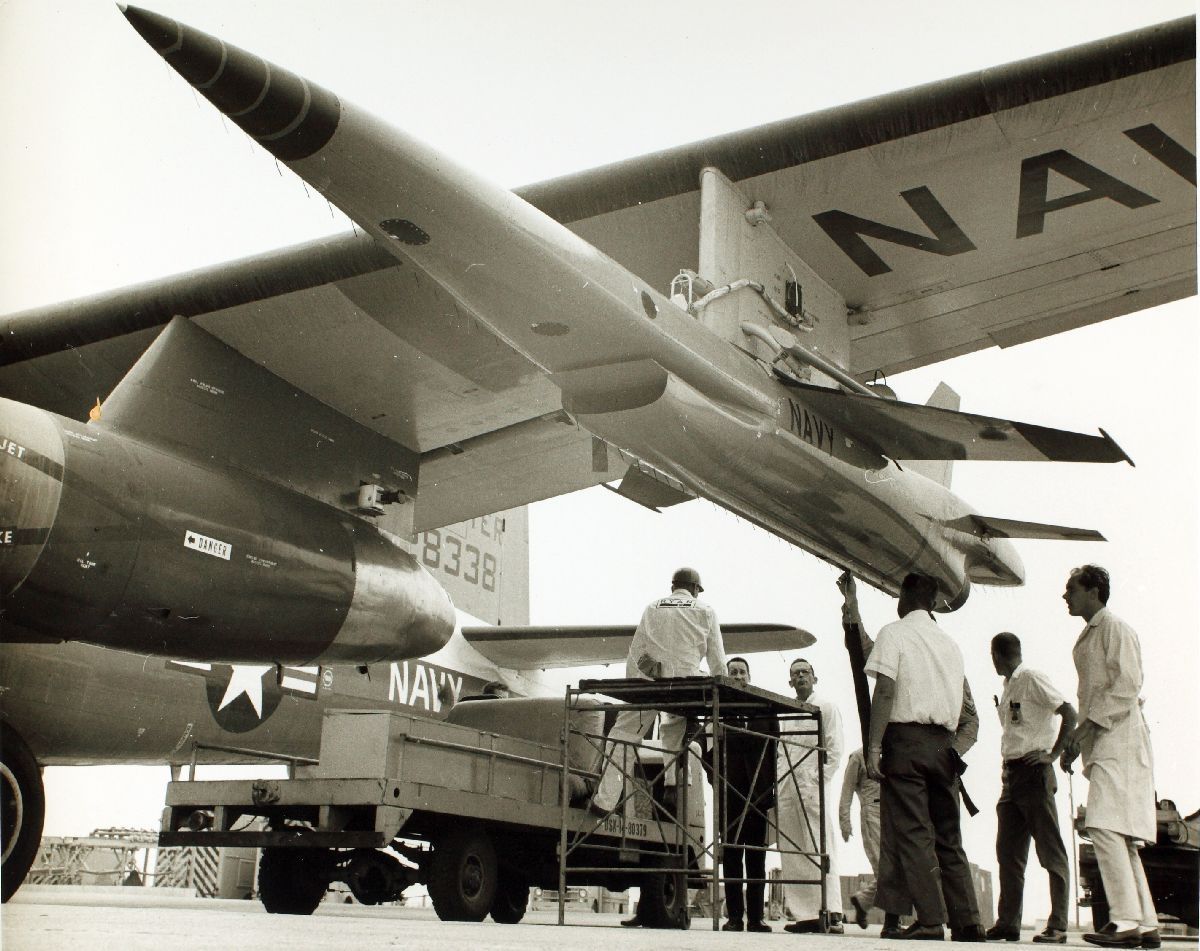

    The P2V-5F led to further subvariants. The "P2V-5FD" was a modification to act as a target drone controller. All armament was removed as well as most of the combat avionics, and the aircraft was fitted with drone control systems and a pair of pylons for carrying Ryan Firebee drones. These drone controllers remained in service until the early 1970s.
