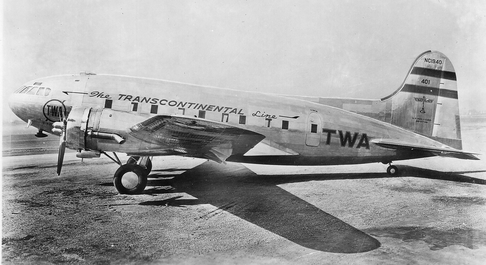

Main AdminThe Boeing Model 307 Stratoliner was the first commercial transport aircraft to enter service with a pressurized cabin. This feature allowed the aircraft to cruise at an altitude of 20,000 ft (6,000 m), well above many weather disturbances. The pressure differential was 2.5 psi (17 kPa), so at 14,700 ft (4,480 m) the cabin air pressure was equivalent to an altitude of 8,000 ft (2,440 m). The Model 307 had capacity for a crew of six and 33 passengers. The cabin was nearly 12 ft (3.6 m) across. It was the first land-based aircraft to include a flight engineer as a crew member (several flying boats had included a flight engineer position earlier). In addition to its civilian service it was also flown as the Boeing C-75 Stratoliner by the United States Army Air Forces, who used it as a long-range cargolift aircraft.

An Aigle Azur Stratoliner at Paya Lebar in 1967
TWA sold its Stratoliner fleet to the French airline Aigle Azur who used them on scheduled flights from France to North and Central Africa, and later to French Indo-China. These 307s were later transferred to Aigle Azur's Vietnamese subsidiary and were used by a number of airlines in South East Asia, with at least one aircraft remaining in commercial use until 1974.
