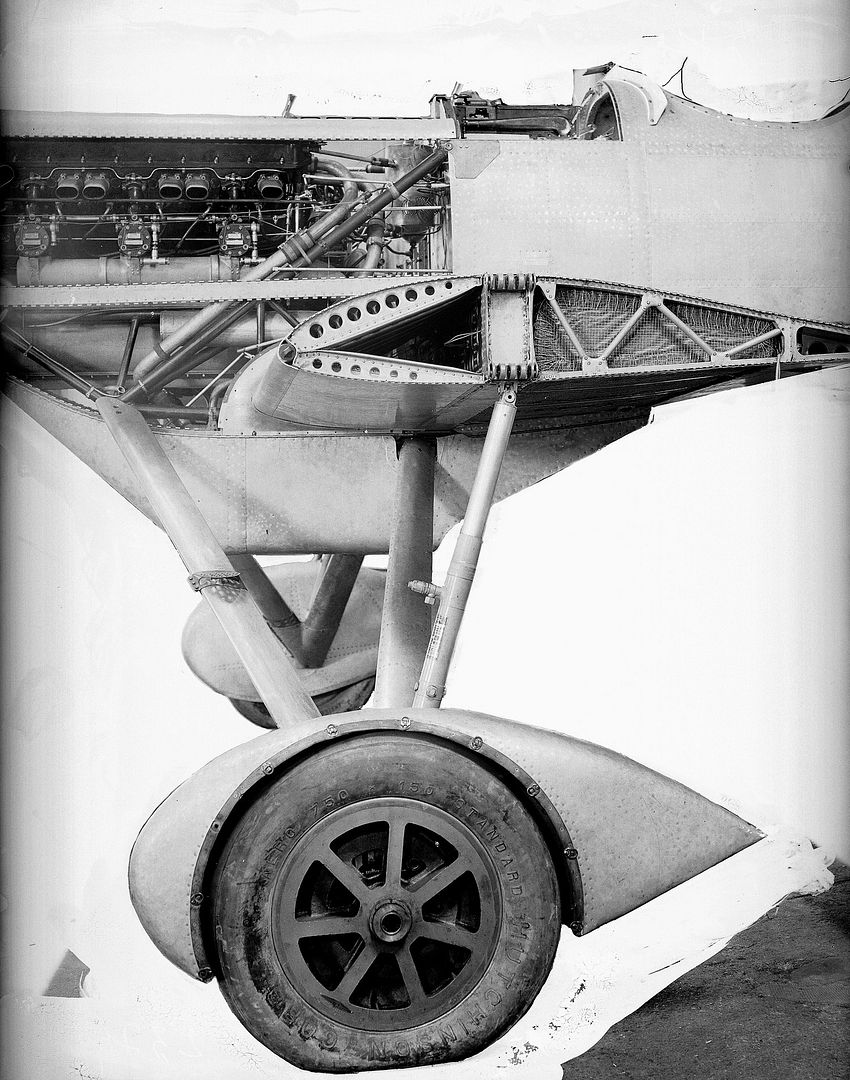

In service, those aircraft armed with a pair of twin nose-mounted machine guns were designated as D.500 while those fitted with a single 20 mm cannon that fired through the propeller hub received the designation D.501. Perhaps the most significant derivative of the type was the D.510, the principle difference of which was the adoption of a more powerful Hispano-Suiza 12Ycrs engine, capable of 640 kW (860 hp); minor refinements included a slightly lengthened nose, an increase in fuel capacity and a refined undercarriage arrangement. A total of 381 D.500s and its derivatives were built by the end of production. The design was further developed into the more capable Dewoitine D.520, which featured an enclosed cockpit and a retractable undercarriage, unlike its predecessor.

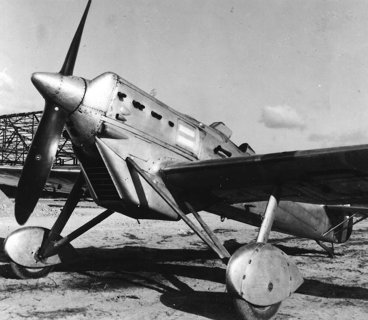

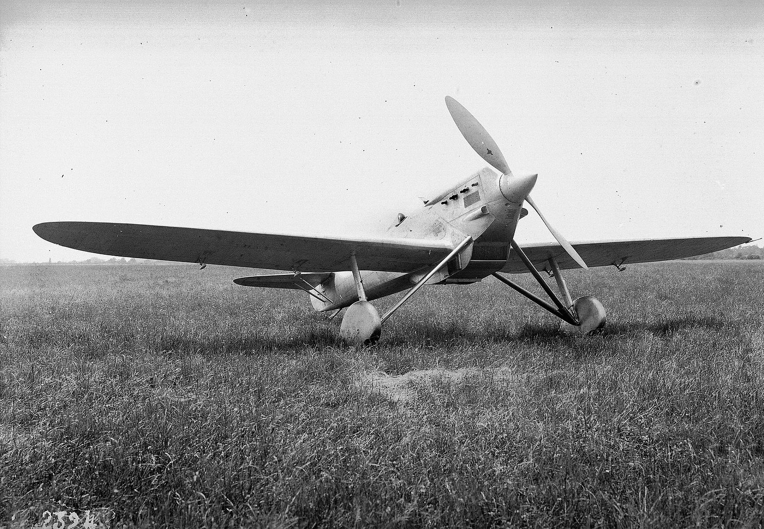

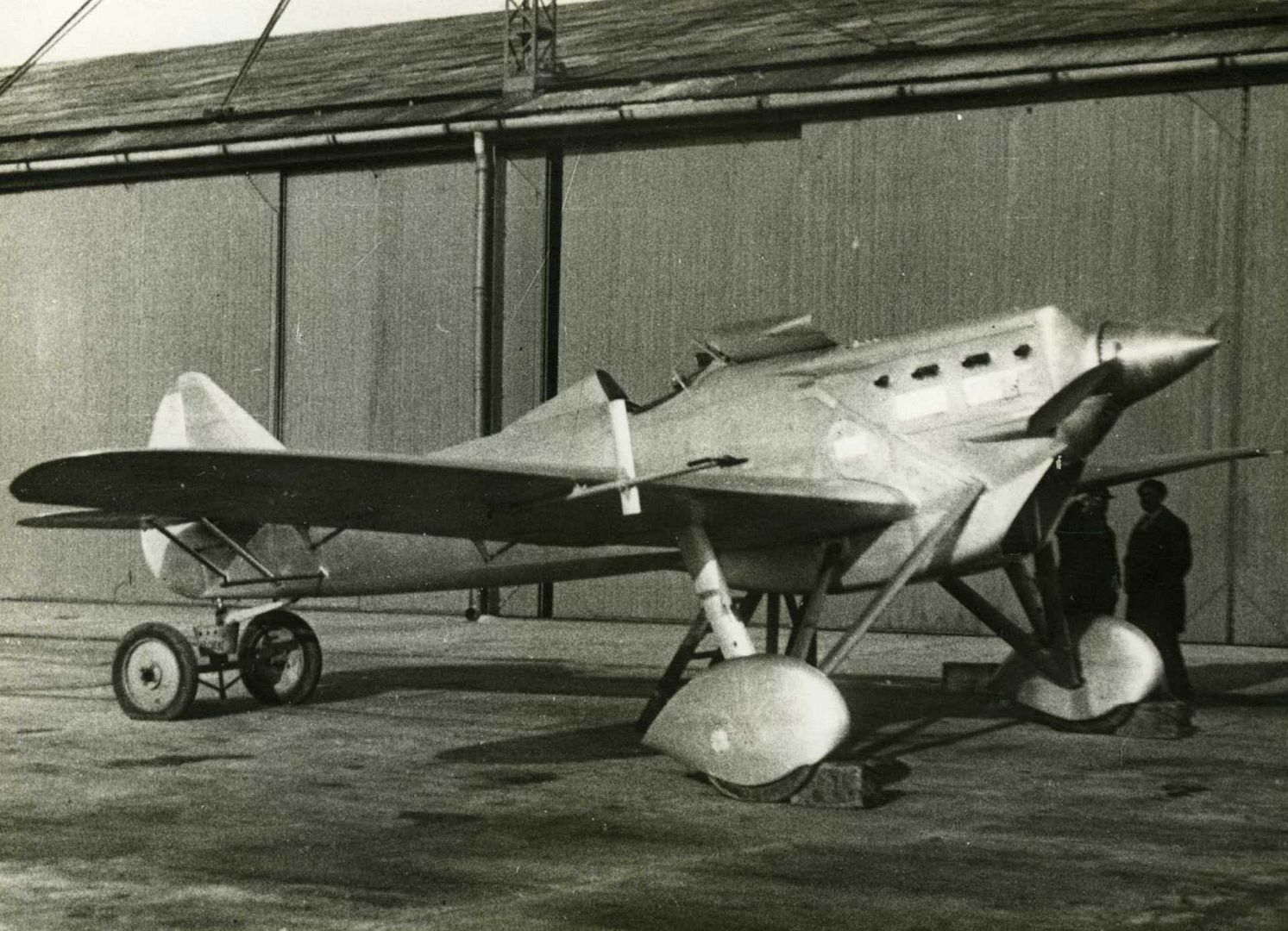

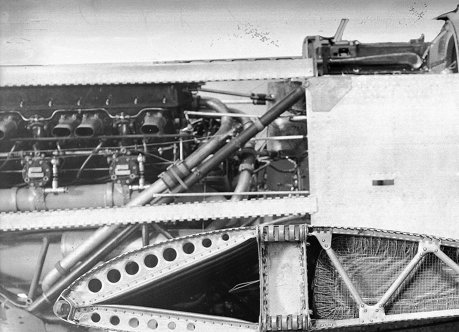

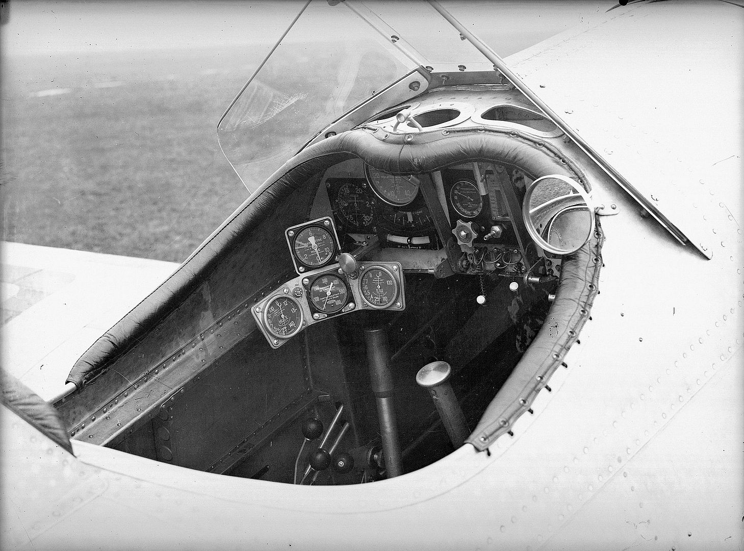

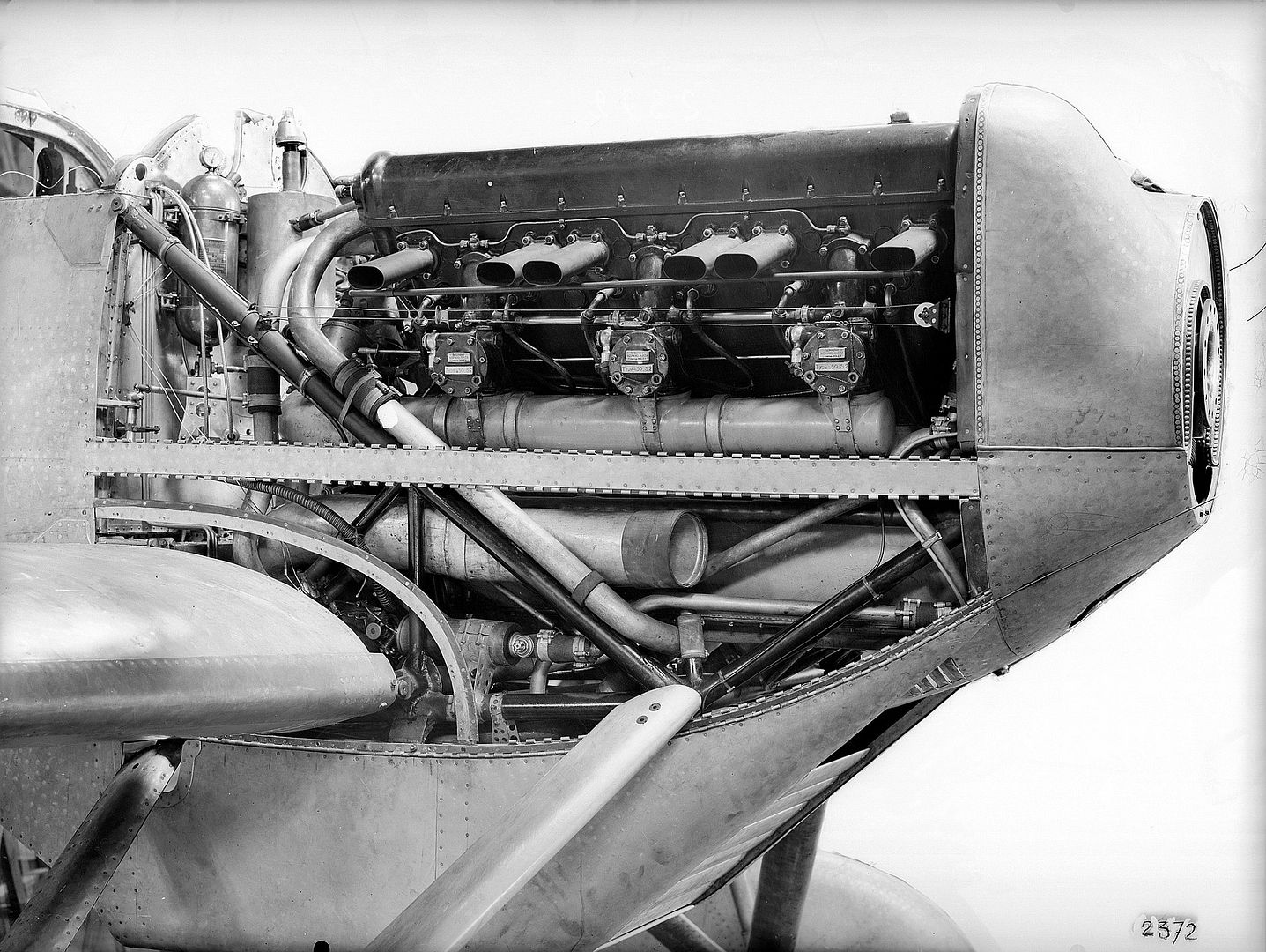

The Dewoitine D.500 was an all-metal low-wing cantilever monoplane. It featured a sharp fuselage, complete with a streamlined nose section that housed the aircraft's powerplant, a single Hispano-Suiza 12Xbrs V-12 liquid-cooled piston engine capable of generating up to 515 kW (691 hp). Underneath the fuselage was a relatively large-volume radiator, which was designed to present the smallest possible frontal area while still conforming with the cooling requirements of the Hispano-Suiza engine. The cockpit of the D.500 was located directly above the trailing edge of the wing. The pilot was provided with a vertically-adjustable chair, which can be raised in-flight to improve visibility for landing. The cockpit was furnished with oxygen apparatus as well as a radio set for communication.The control stick was connected to the aircraft's ailerons via a rod transmission to horns present on the upper wing's surface. The control surfaces of the D.500 were relatively small as a result of the aircraft's high speed performance.

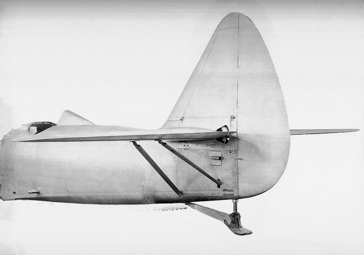

The D.500 possessed an oviod-shaped monocoque fuselage, the structure of which comprised five main and eight false bulkheads that were connected together via four longerons and intermediate stringers; these stiffened the external metal sheet covering, which was riveted onto the structure. The sternpost was integral with the fuselage, while the engine bearer, comprising an oblique frame, was directly bolted to the attachment brackets of the crankcase. The aircraft's adjustable stabiliser was hinged around its front spar while rigid struts connected to either side of the lower fuselage to provide transverse stiffness. The fixed undercarriage features faired axleless wheels, complete with pneumatic brakes, which are attached via a pair of triangle-shaped struts onto the lower fuselage longeron. The undercarriage's vertical stresses are absorbed by an oleo-pneumatic strut bolted to the central wing's single spar and is integral with the fuselage.

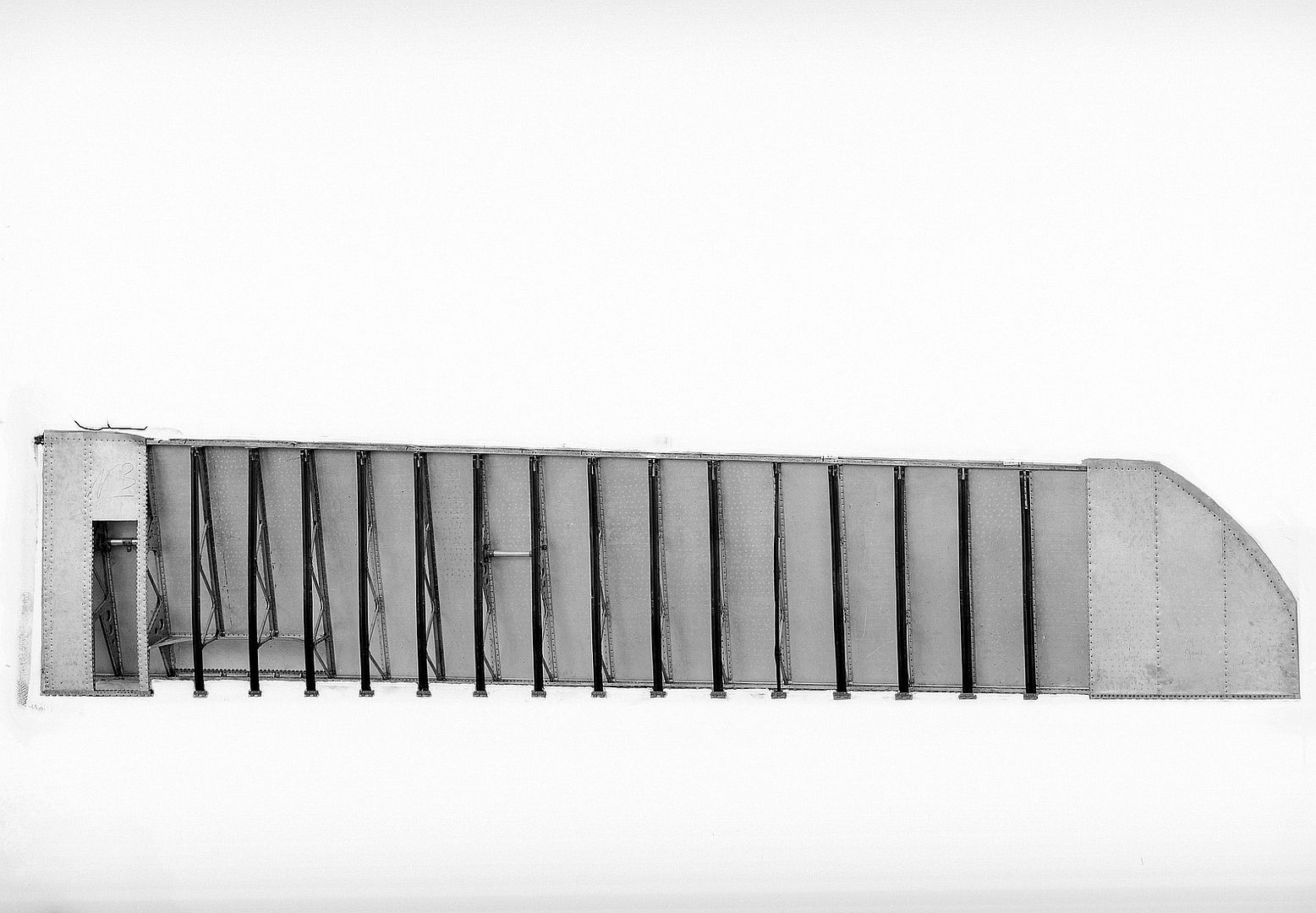

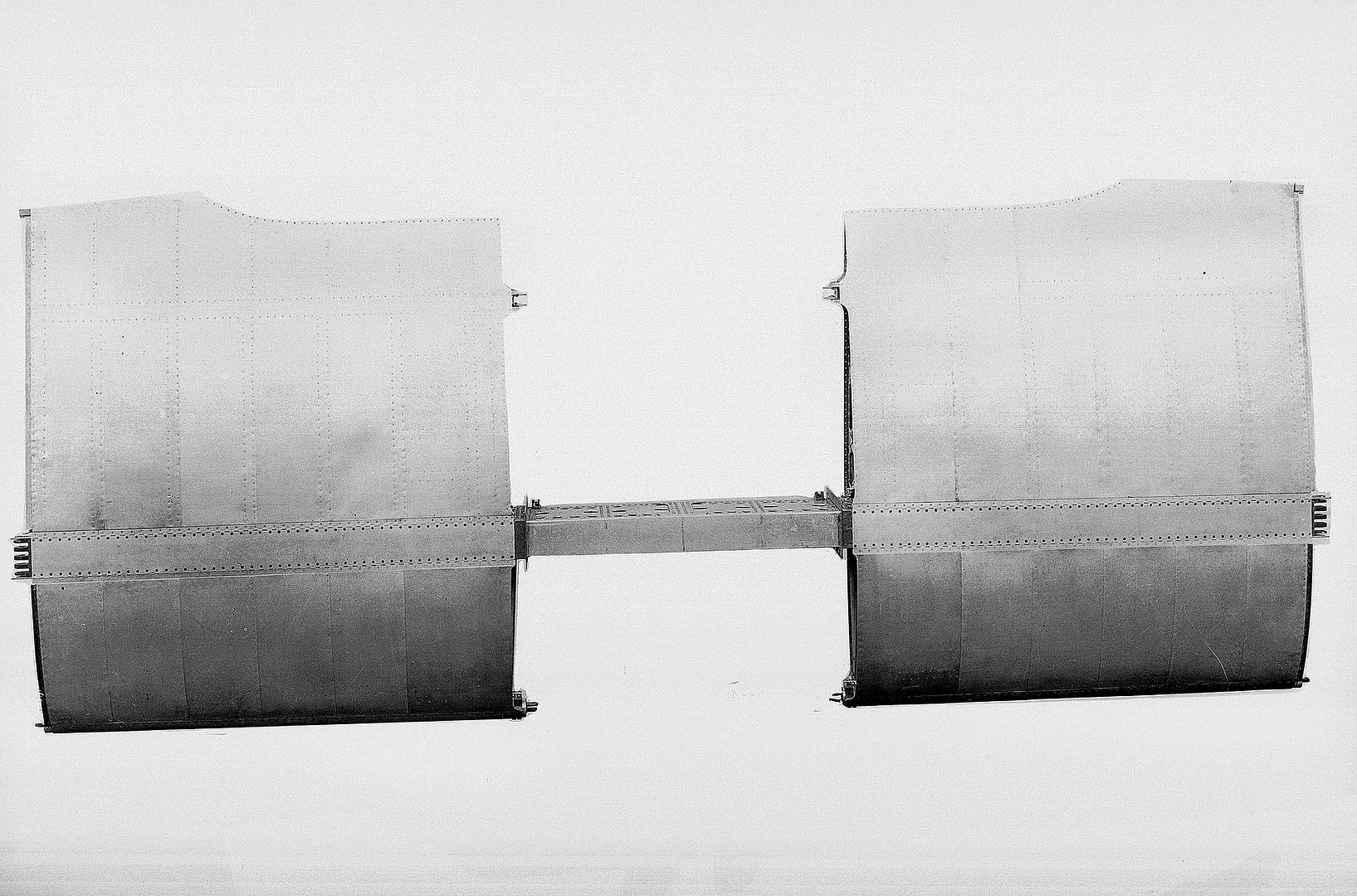

The D.500 was furnished with low-mounted elliptical, all-metal cantilever wing, possessing an aspect ratio of 8.9.It possessed a relatively small chord and contained only a single spar, akin to the record-setting Dewoitine D.33. The wing's strength came from its box spar, which was formed from a pair of vertical webs of sheet metal that connect with the flanges, which are in turn riveted to the flat sheet rib arcs of the sheet covering. The wing had a thickness of 0.3 m (11,81 in.) at the root, gradually tapering towards its rounded-off tips. Balanced ailerons extended throughout the span, except near the fuselage, where these were reduced to provide greater downward visibility for the pilot. The lower wing surface sat only 1.5 m (4.92 ft.) above the ground, which generated a beneficial ground effect to significantly reduce landing speeds. The aircraft's fuel tanks, which were located in the wing's center portion on either side of the axis of symmetry, could be separately isolated using a multi-way stopcock.

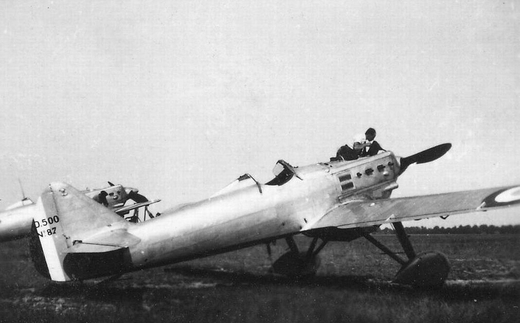

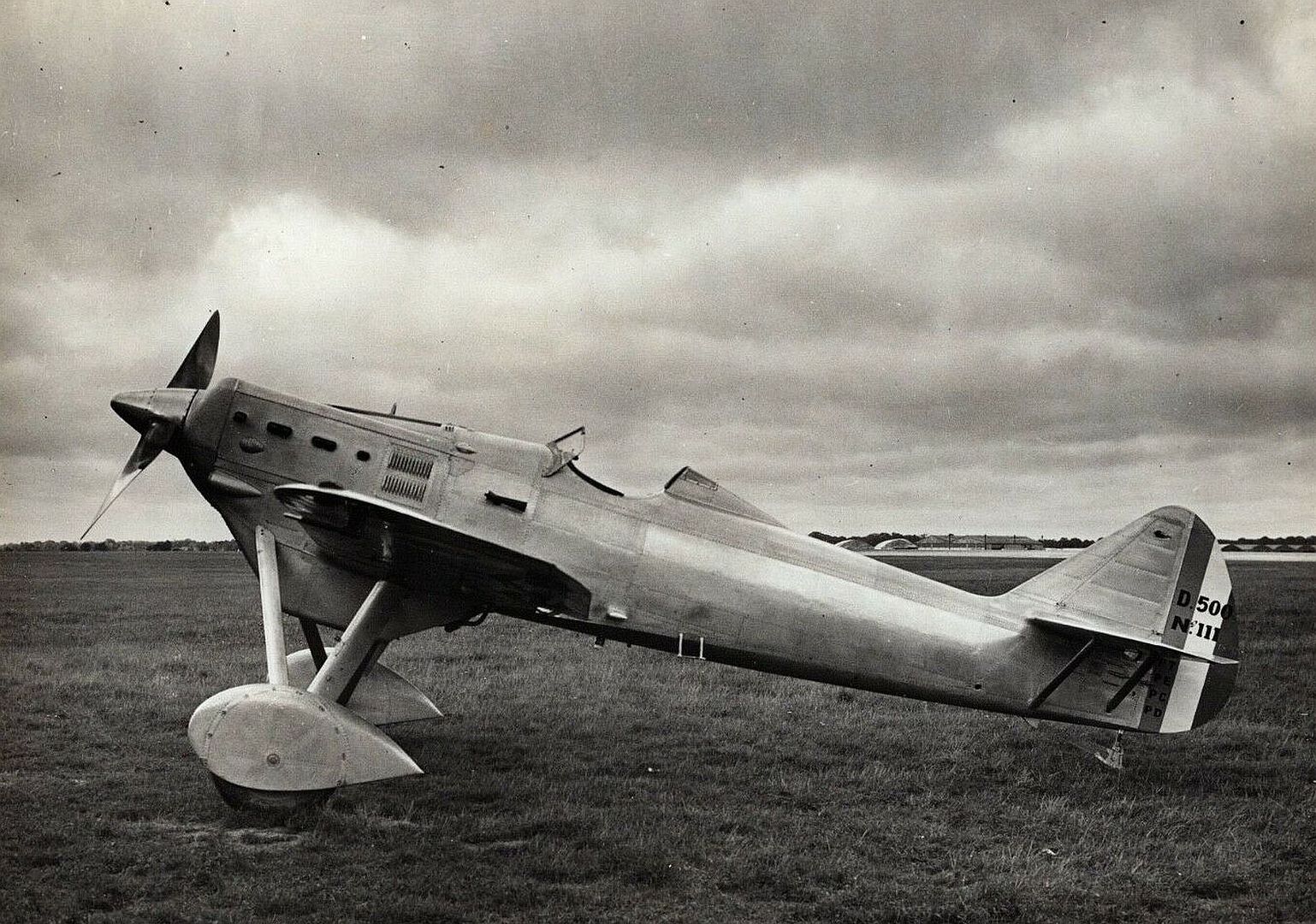

D.500
First production version with a 515 kW (691 hp) Hispano-Suiza 12Xbrs engine and was armed with 2 × 7.7 mm (.303 in) Vickers machine guns or 2 × 7.5 mm (.295 in) Darne machine guns in the nose, provision for 2 × additional Darnes in the wings. 101 built.

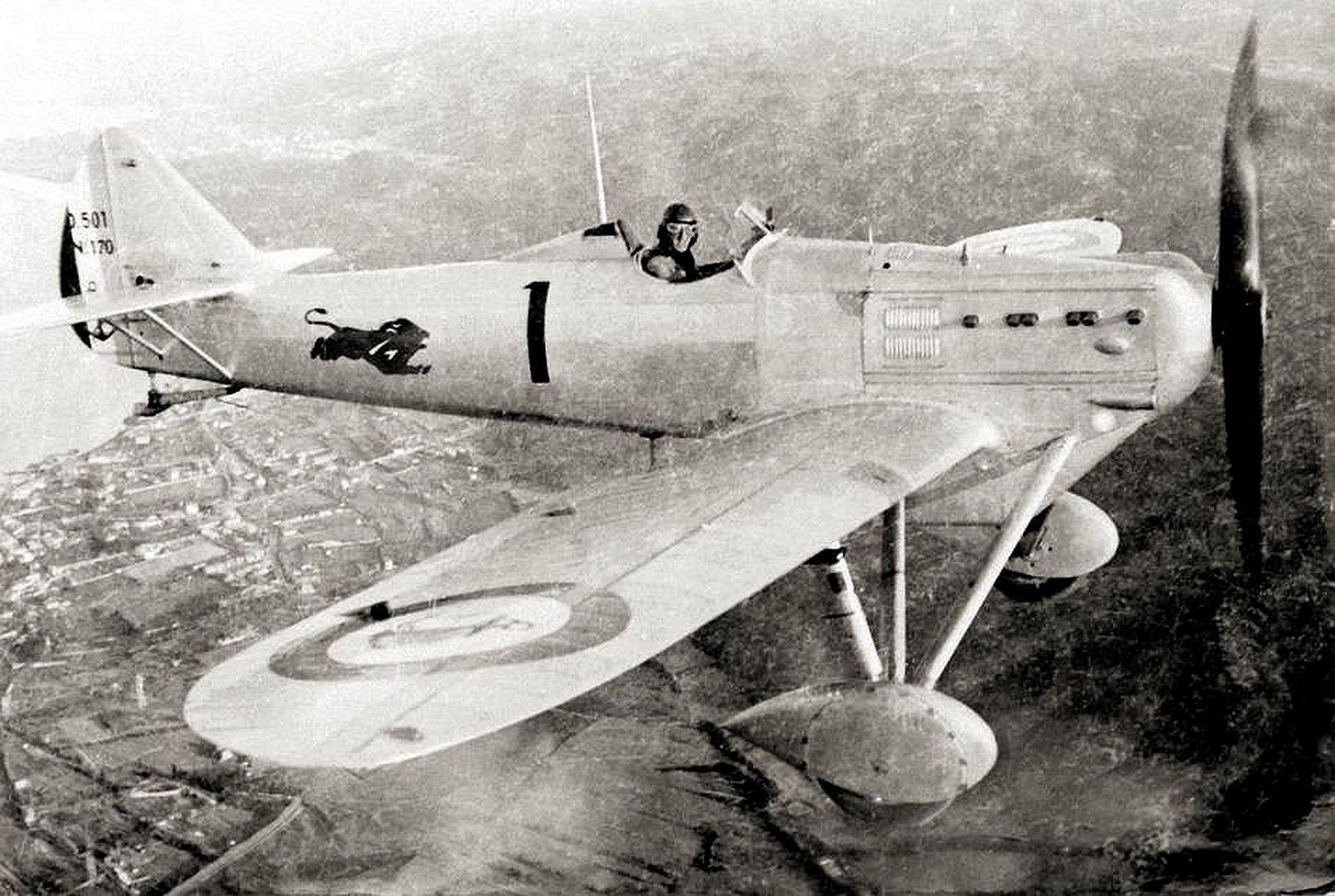

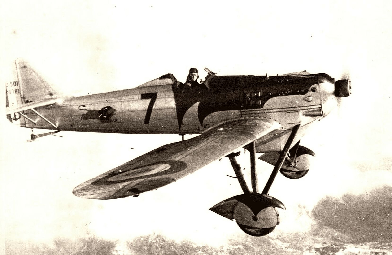

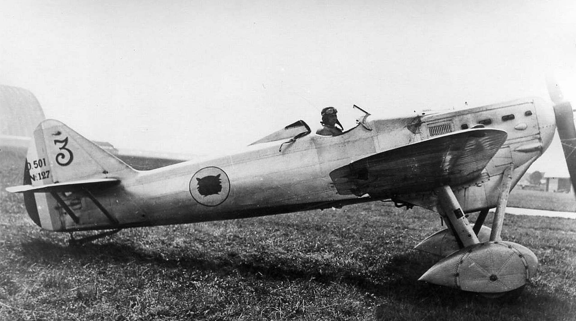

D.501
Re-engined with a Hispano-Suiza 12Xcrs engine, it was armed with a 20 mm (0.79 in) Hispano-Suiza S7 cannon between the engine cylinder banks firing through the propeller hub and 2 × wing-mounted machine guns. 157 built.
