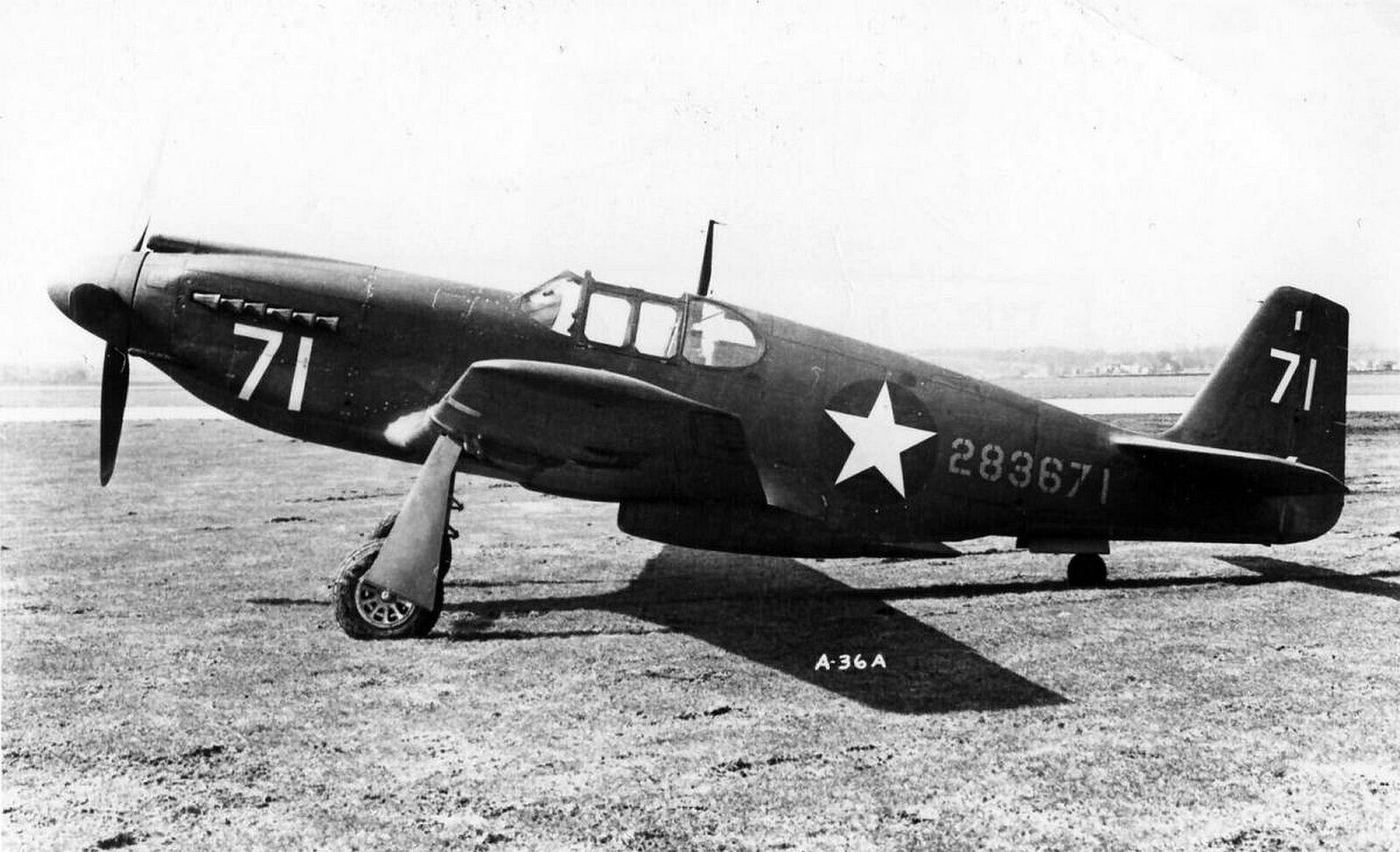

3 years agoSat Dec 23 2023, 08:11pmDuggyMain AdminOnly after Pearl Harbor did the US Army finally agree to order the Mustang for its own use. General H. H. "Hap" Arnold, Chief of Staff of the USAAF, was instrumental in breaking up the bureaucratic log-jam and getting the Army to relent and order the Mustang for its own use. On April 16, 1942, the Army finally ordered 500 NA-97s. The NA-97 was a ground attack version and was designated A-36A (in the attack series rather than the fighter series). Serial numbers were 42-83663/84162.

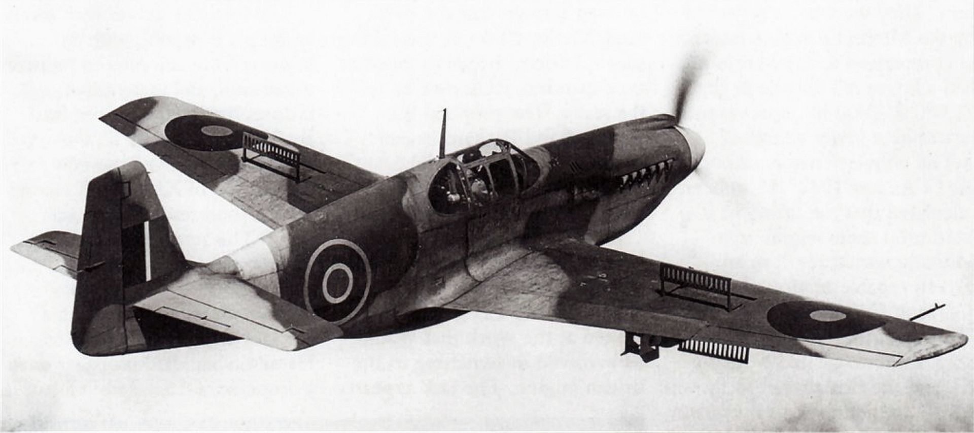

The A-36A differed from previous Mustang versions in having a set of hydraulically-operated perforated door-type dive brakes mounted at approximately mid-chord on both the upper and lower wing surfaces outboard of the wing guns. The brakes were normally recessed into the wings, but were opened to 90 degrees by a hydraulic jack to hold diving speeds down to 250 mph. A rack was fitted under each wing for a 500-pound bombs, a 75 US gallon drop tank, or smoke-curtain equipment. A built-in armament of six 0.50-inch machine guns (two in lower fuselage nose, four in the wings) was fitted, however the two nose guns were often omitted in service. The wing guns were moved closer to the main landing gear strut in order to minimize stress under taxi and takeoff conditions. The engine was the Allison V-1710-87 (F21R), rated at 1325 hp at 3000 feet. Normal and maximum loaded weights rose to 8370 pounds and 10,700 pounds, and the maximum speed in clean condition fell to 356 mph at 5000 feet and 310 mph with the two 500-lb bombs fitted. With the bombs, range and service ceiling were 550 miles and 25,100 feet respectively.

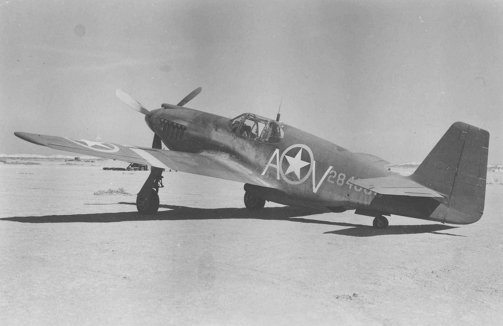

The first A-36A flew on September 21, 1942. Deliveries of the A-36A were completed by the following March. The A-36A equipped the 27th and 86th Fighter Bomber Groups based in Sicily and in Italy. They initially were painted in olive-drab and light-gray finish and were painted with yellow wing bands and yellow circles around the national insignia. Both of these Groups arrived in North Africa in April of 1943 just after the end of the Tunisian campaign. They saw their first action during aerial attacks on the island of Pantelleria, with the first sortie being flown on June 6, 1943. The A-36A was involved in the taking of Monte Cassino, and participated in the sinking of the Italian liner Conte di Savoia.

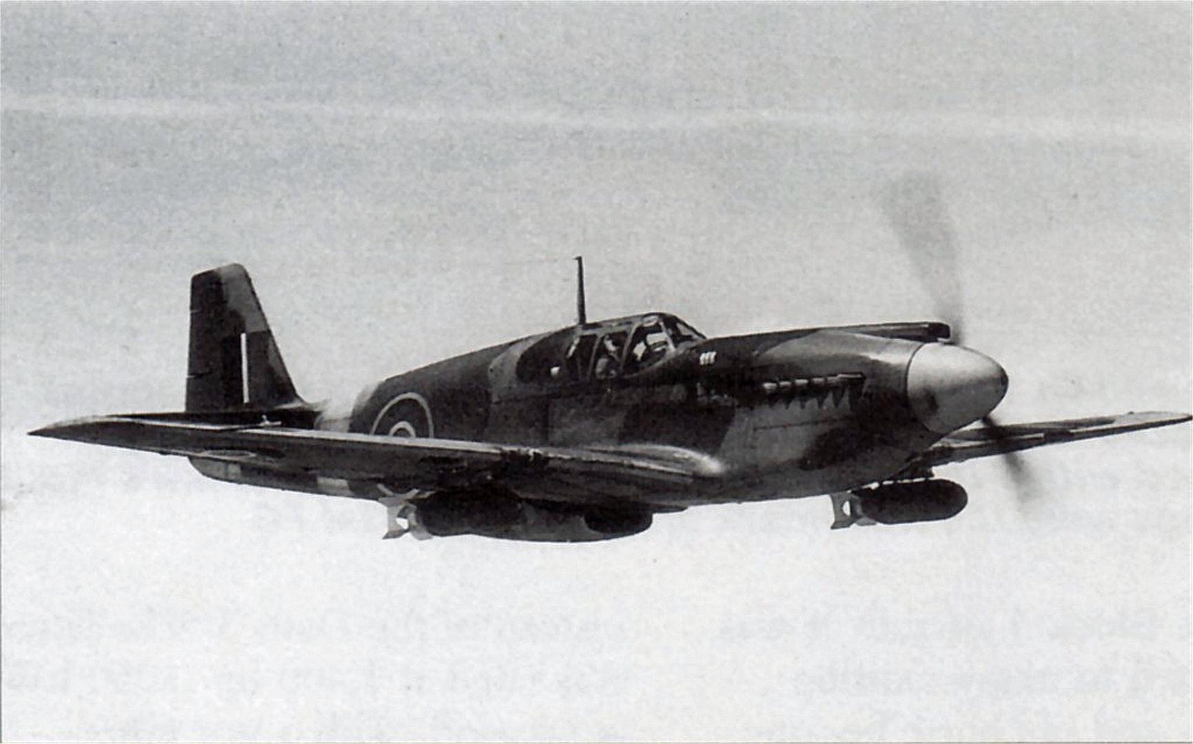

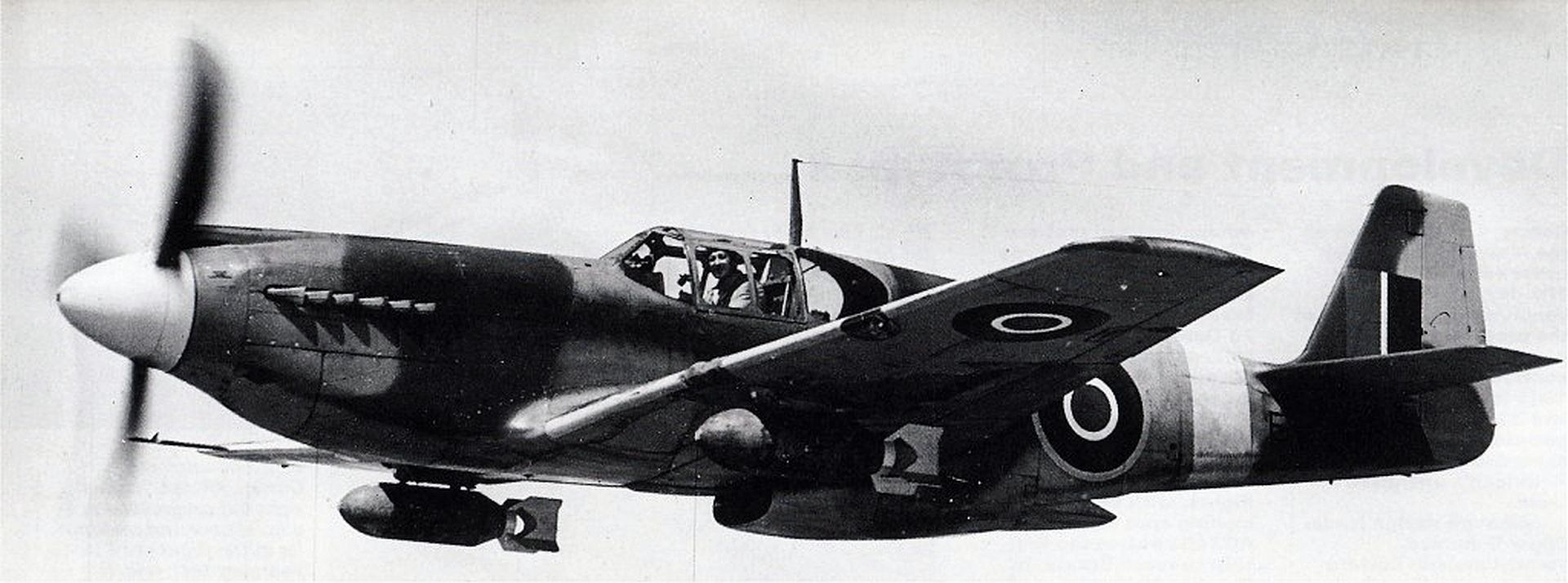

One A-36A was supplied to the RAF in March of 1943 for experimental purposes. Its RAF serial number was EW998.

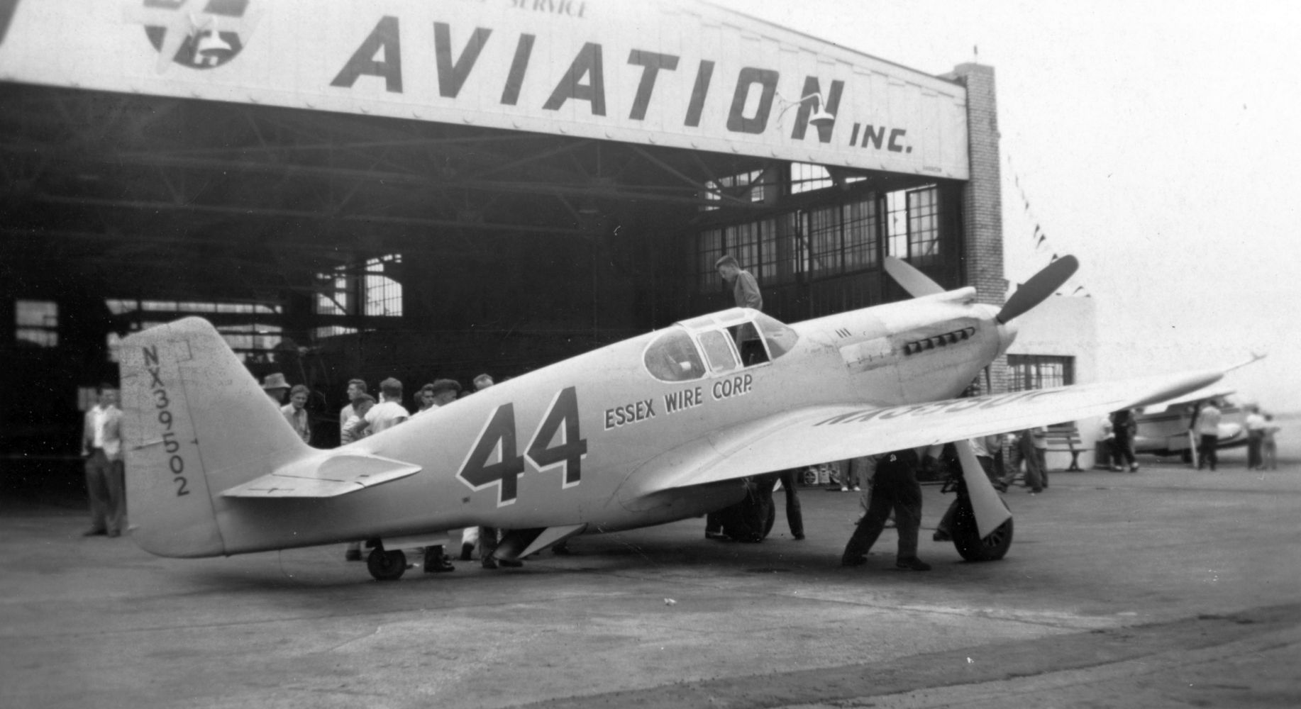

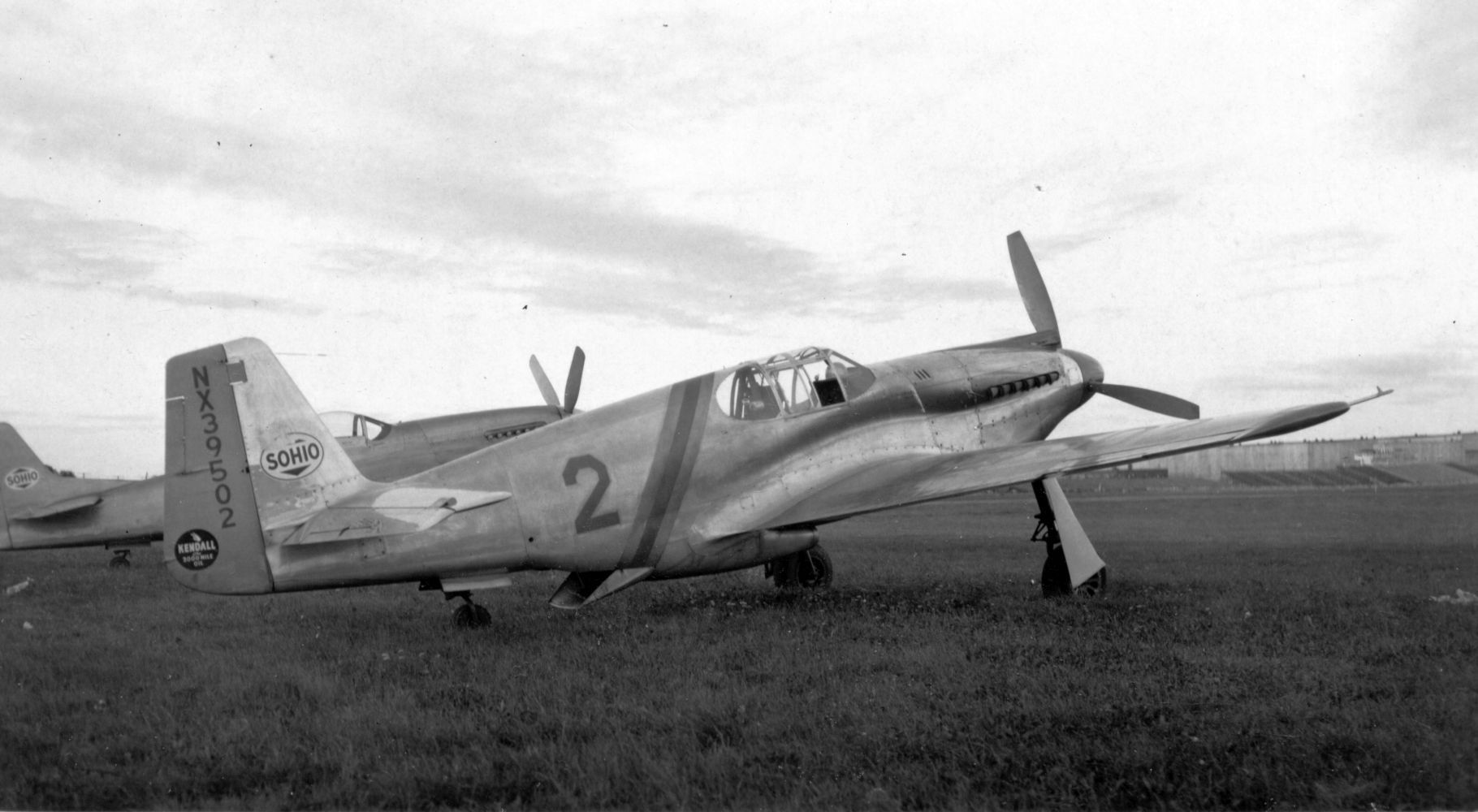

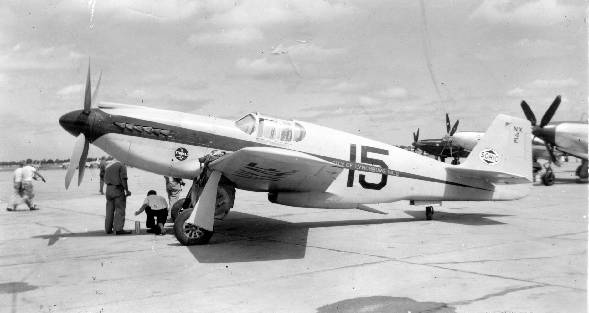

Relatively few A-36As survived the war and the subsequent postwar retirement and scrapping of obsolete types. One A-36A, bearing race number #44, owned and flown by Kendall Everson, was entered in the 1947 Kendall Trophy Race. It was able to reach 377.926 mph (608.213 km/h), finishing second to the winning P-51D flown by Steve Beville.
