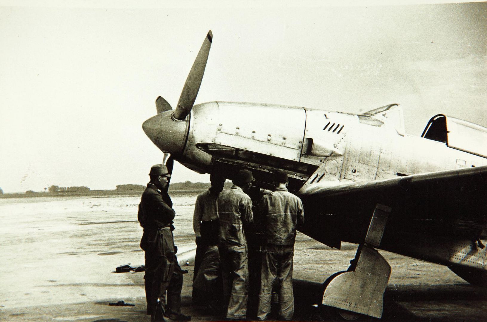

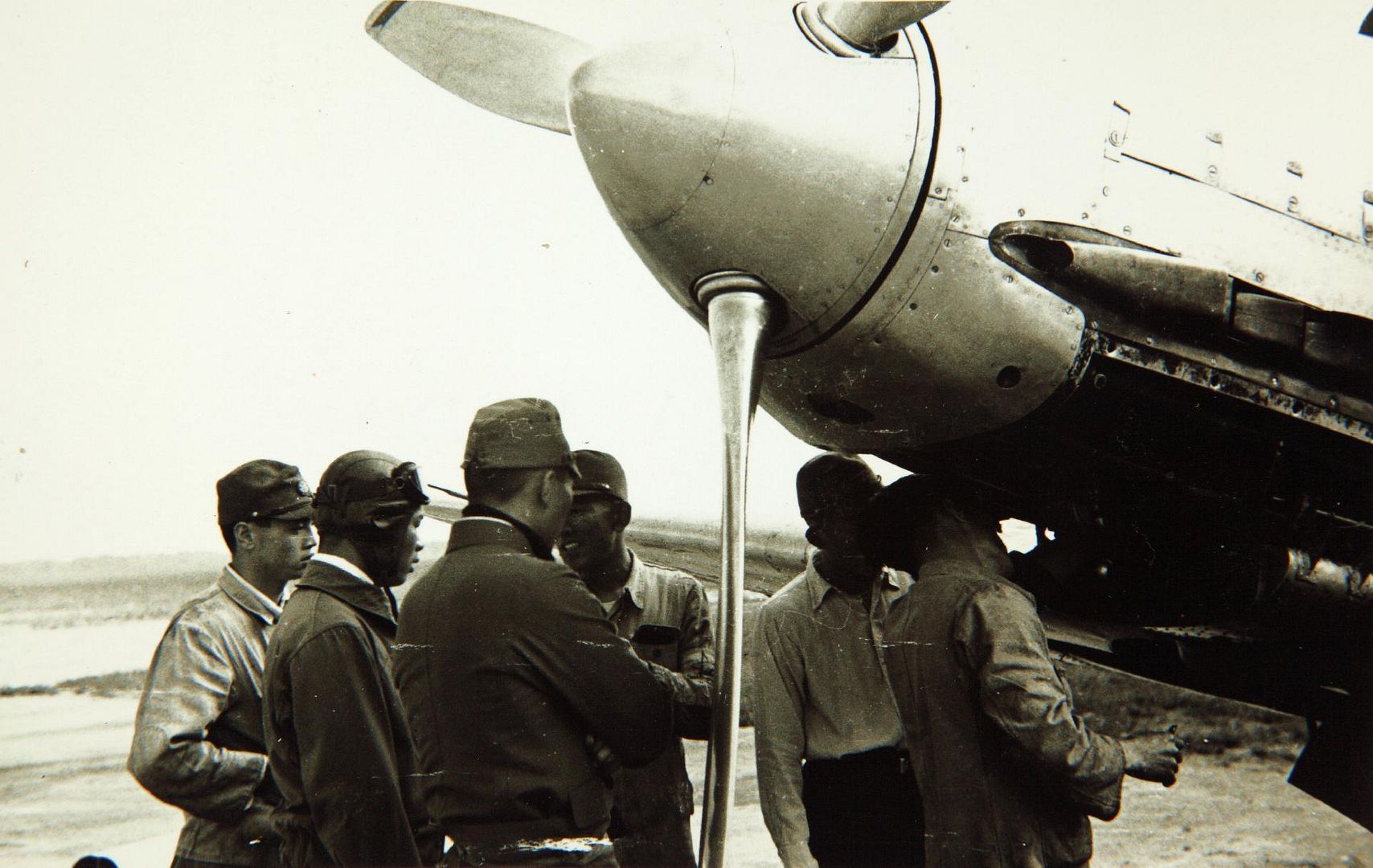

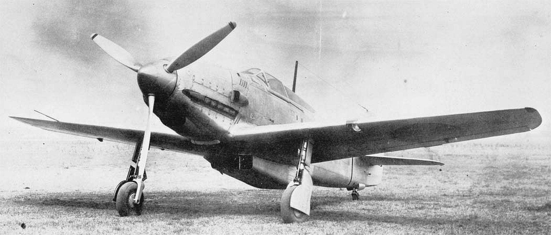

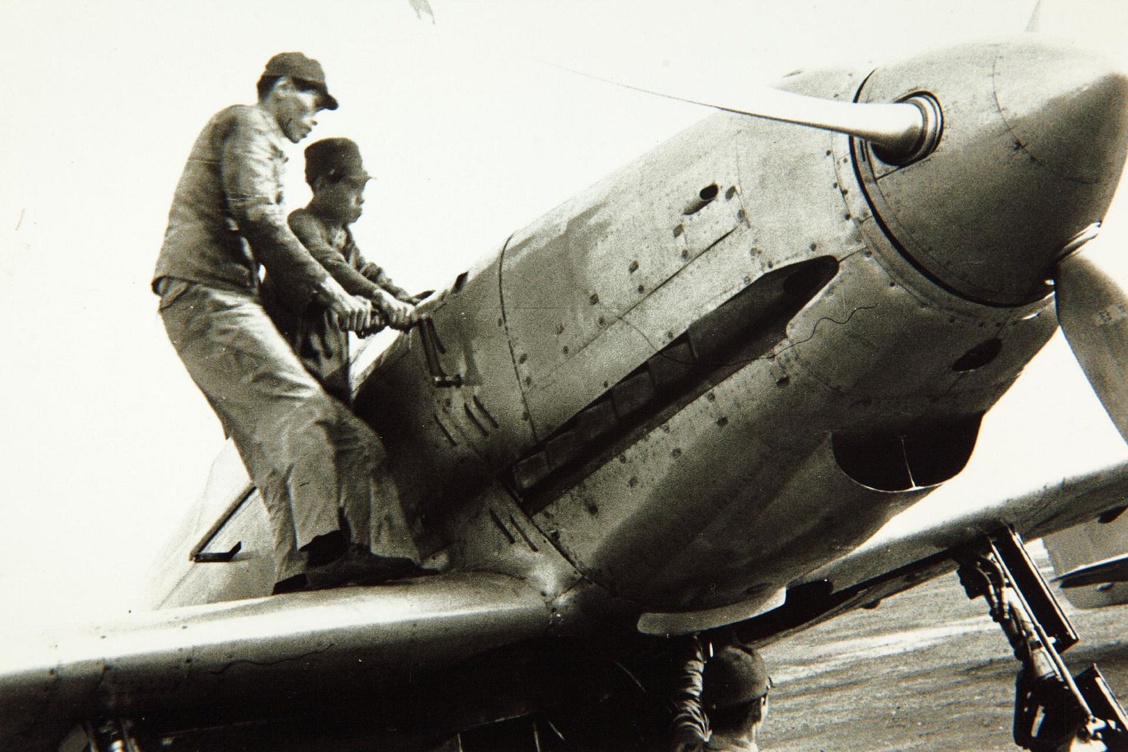

The first prototype of the Ki-60 emerged in March 1941 as a compact, all metal, stressed skin monoplane with a relatively deep fuselage (1.46 metres or 4 feet 9 inches) and tapered wings with rounded tips built around a system of three spars; a Warren truss main spar and two auxiliary spars. The rear spar carried the split flaps and long, narrow chord ailerons, while the front spar incorporated the undercarriage pivot points. The undercarriage track was 3 metres (9 ft 10 in). The pilot's seat was mounted high over the rear spar, giving the fuselage a distinctive "humped" profile; the hood featured a framed, rear sliding canopy and an elongated rear transparent section. The main coolant radiator was housed in a long ventral bath under the wing centre-section and central fuselage, while the oil cooler was mounted under the engine with a long air intake. The prototype was powered by an imported DB 601A as production of the Ha-40 had not yet started. A total fuel capacity of 410 L (90.2 Imp gallons) was carried.
The armament carried was two synchronized, fuselage mounted 12.7 mm caliber Ho-103 machine guns which were set in a "staggered" configuration (the port weapon slightly further forward than that to starboard) in a bay just above and behind the engine. One German made Mauser MG 151/20 20 mm cannon was housed in a weapons bay in each wing. With a normal loaded weight of 2,890 kilograms (6,370 lb) and a gross wing area of 1.48 m2 (15.9 sq ft) the wing loading was 181.76 kg/m2 (37.23 lb/ft2), which was extremely high by Japanese standards (the standard IJAAF fighter, the Ki-27, had a wing loading of 70 kg/m2 (14.33 lb/ft2)).

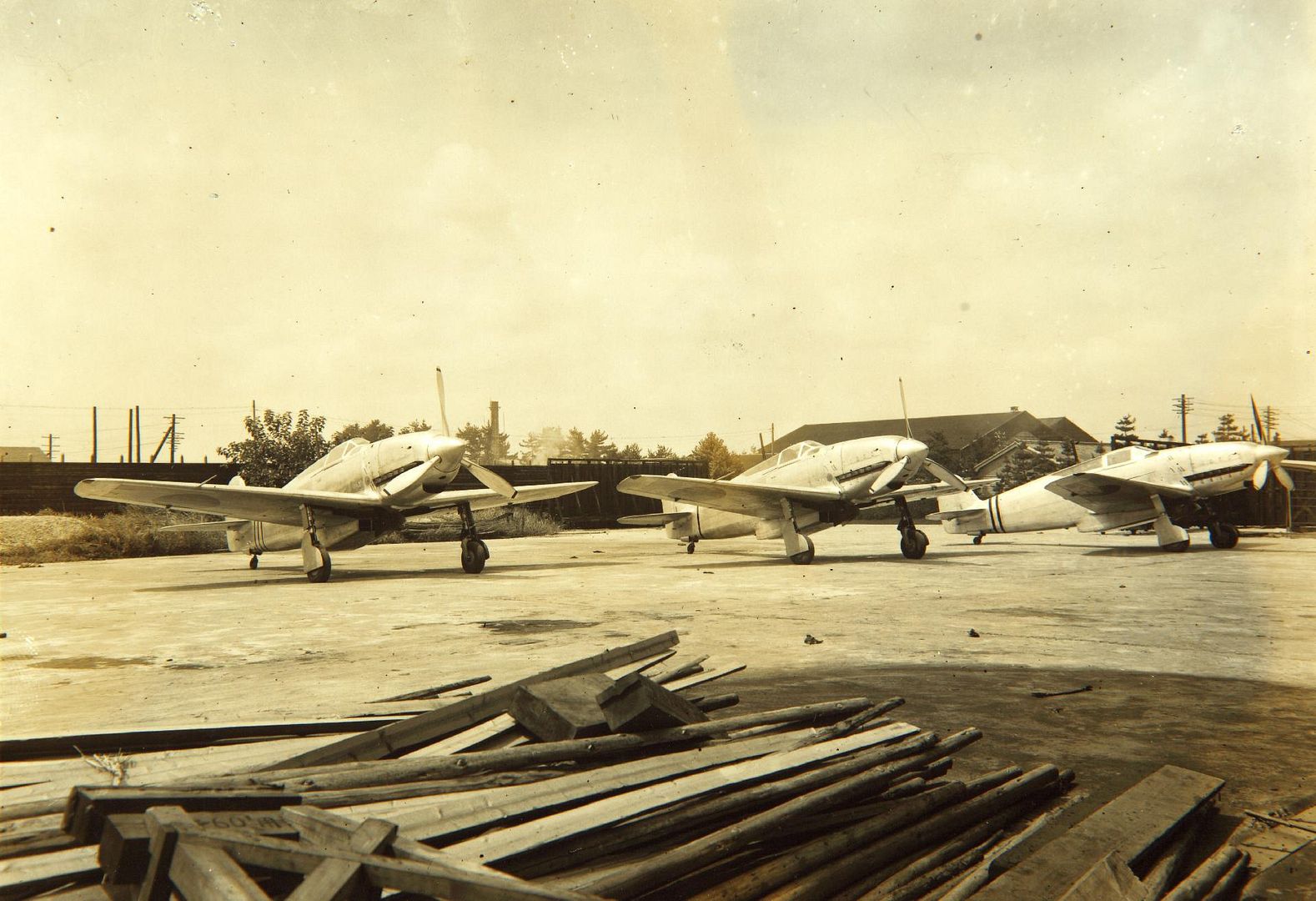

As a result, the second and third prototypes, which were still being built, were hurriedly modified in an attempt to mitigate some of the more undesirable traits. Approximately 100 kilograms (220 lb) were removed, primarily by replacing the MG 151 cannon with Ho-103 machine guns. This reduced the normal loaded weight to 2,750 kilograms (6,060 lb). Coupled with a slight increase in wing area to 1.5 m2 (16 sq ft), this resulted in a slightly lower wing loading of 169.7 kg/m2 (34.76 lb/ft2). Detail changes were made to airframe sealing and to the contours of the air intakes and radiator bath. Flight tests were still disappointing, with both of the modified prototypes displaying most of the shortcomings of the first. A top speed of only 560 kilometres per hour (350 mph) was reached, with a climb rate still well below specifications. By this time the Nakajima Ki-44, which had also been designed as a dedicated interceptor, was beginning to show some promise and the Koku Hombu selected this in fulfilment of its requirements. From early 1941 the full attention of Takeo Doi and Shin Owada was focused on the Ki-61; the Ki-60 became important in that the Ki-61 design was able to be improved using the lessons learned from the poor characteristics of the Ki-60.Plans for production were cancelled in late 1941 after three airplanes had been built.
