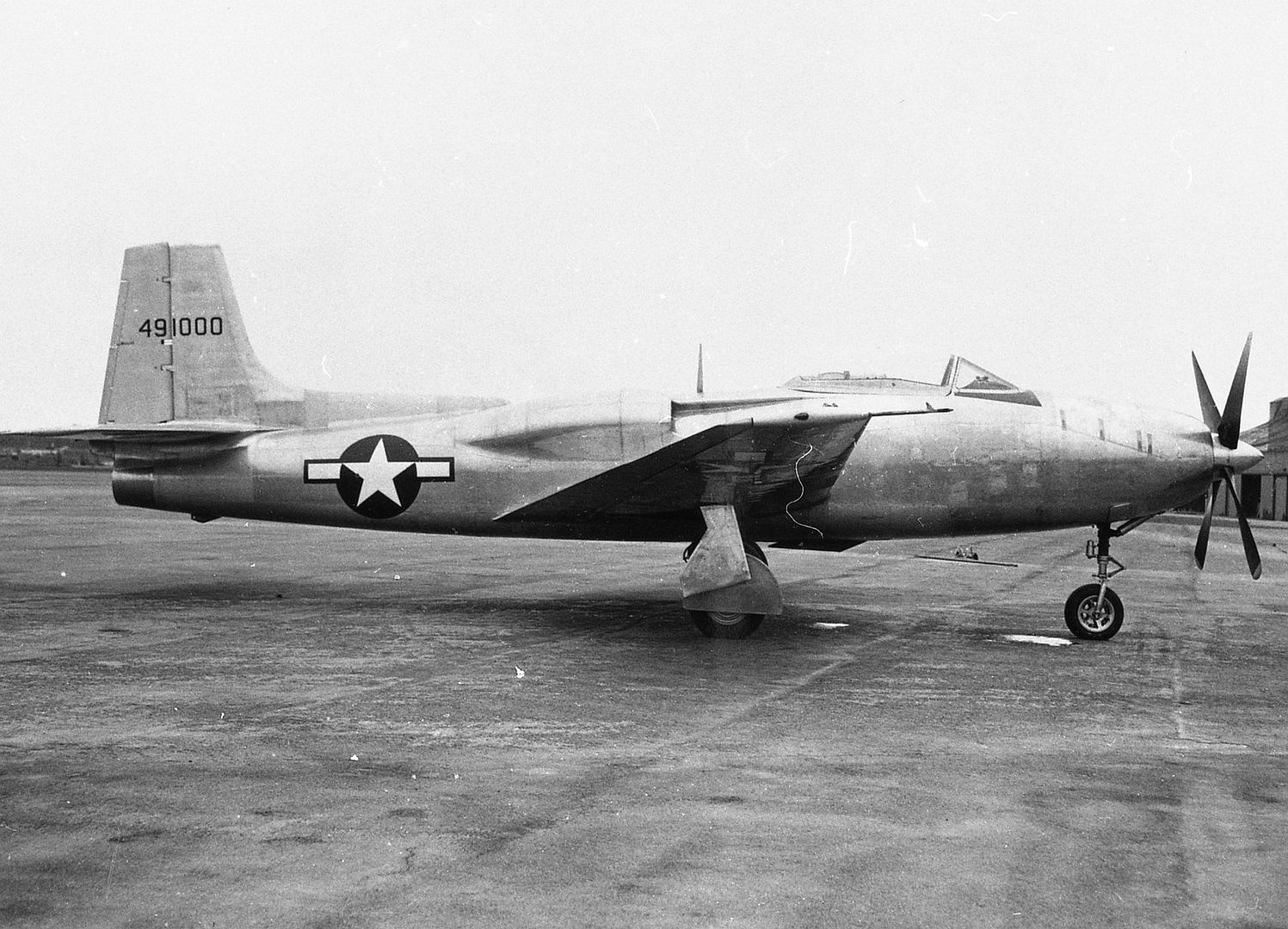

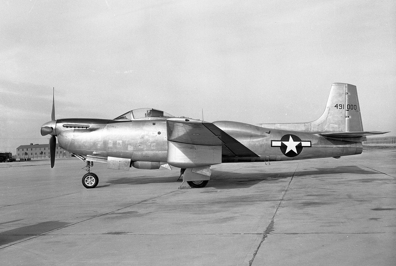

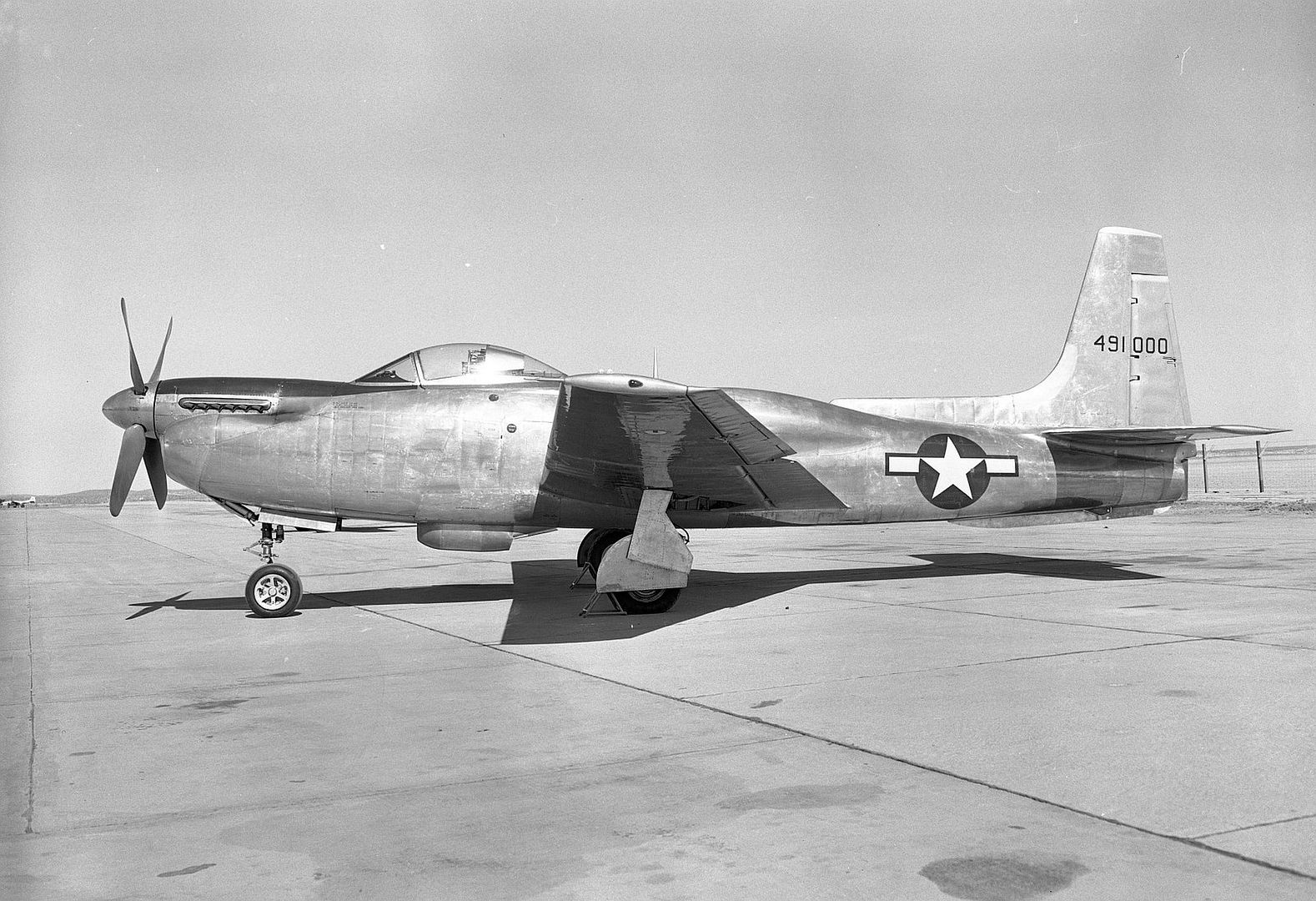

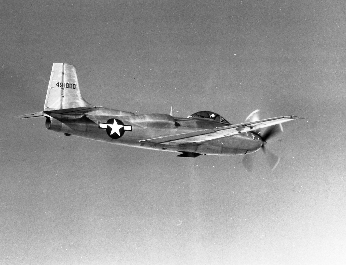

Main AdminThe Consolidated Vultee XP-81 (its newly-merged builder soon to be better known as Convair) was the first American aircraft powered by a turboprop engine.
Two prototype aircraft were ordered on 11 February 1944 that were designated XP-81. The engine selection was an attempt to couple the high-speed capability of the jet engine with the endurance offered by the propeller engine. The XP-81 was designed to use the General Electric TG-100 turboprop engine (later designated XT31 by the US military) in the nose driving a four-bladed propeller and a GE J33 turbojet in the rear fuselage. The turboprop would be used for normal flight and cruising and the turbojet added for high-speed flight.

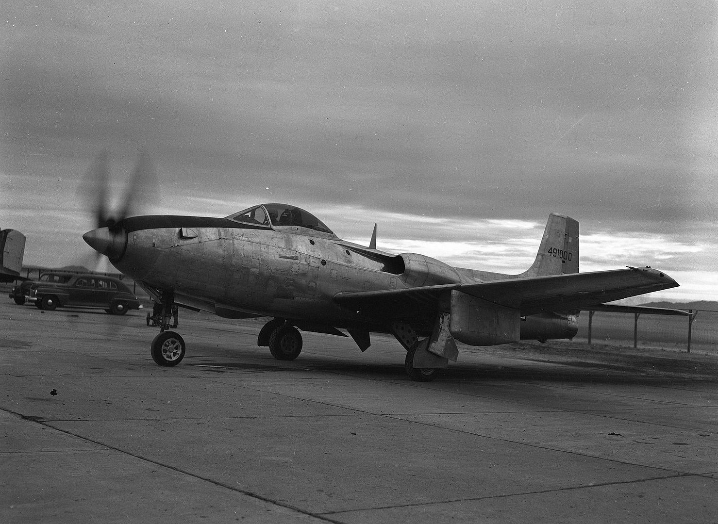

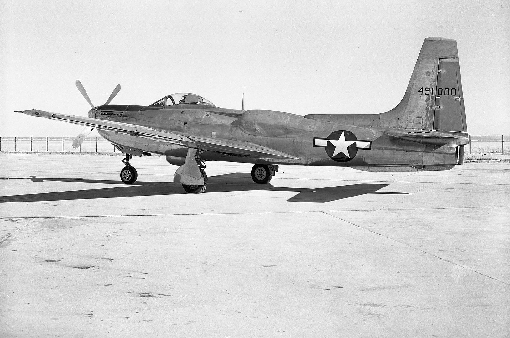

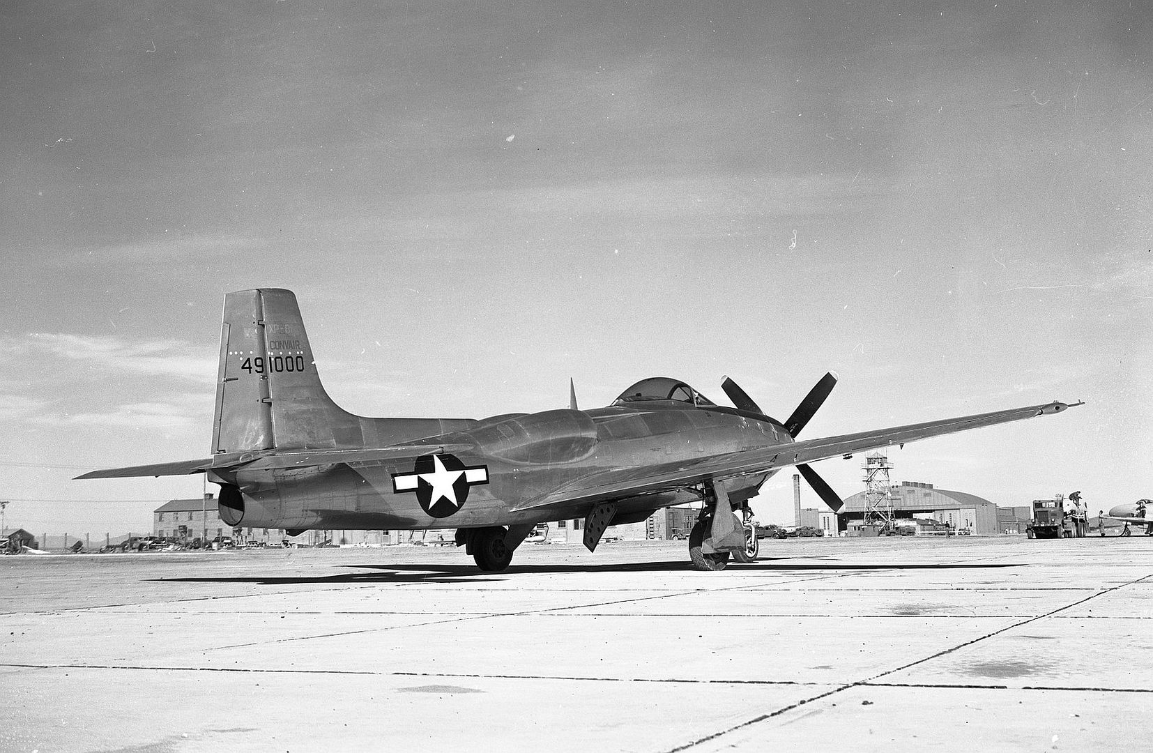

The first XP-81 (serial 44-91000) was completed in January 1945 but because of developmental problems the turboprop engine was not ready for installation. A decision was then made to mount a complete V-1650-7 engine package from a P-51D aircraft in place of the turboprop for initial flight tests. This was done in a week and the Merlin-powered XP-81 was sent to the Muroc airbase where it flew for the first time on 11 February 1945. During 10 flight test hours, the XP-81 displayed good handling characteristics except for inadequate directional stability due to the longer forward portion of the fuselage.
In November 1946, Convair produced the second XP-81 prototype, 44-91001, which was ready for flight testing at Muroc by February 1947. This second prototype differed from the first in that it had a longer ventral fin than the one added to the first prototype and was fitted with a Hamilton Hydromatic propeller as opposed to the original prototype’s Aeroproducts propellers, which engineers felt was the source of many of the first prototype’s issues.
While 13 YP-81 pre-production aircraft had been ordered, the capture of Guam and Saipan obviated the need for long-range, high-speed escort fighters and then, just before VJ Day the contract was cancelled, after 85% of the engineering was completed. The YP-81 was to be essentially the same as the prototype but with a lighter and more powerful GE TG-110 (XT41) turboprop engine, the wing moved aft 10 inches (0.25 m), and armament of either six .50 cal (12.7 mm) machine guns or six 20 mm cannon.

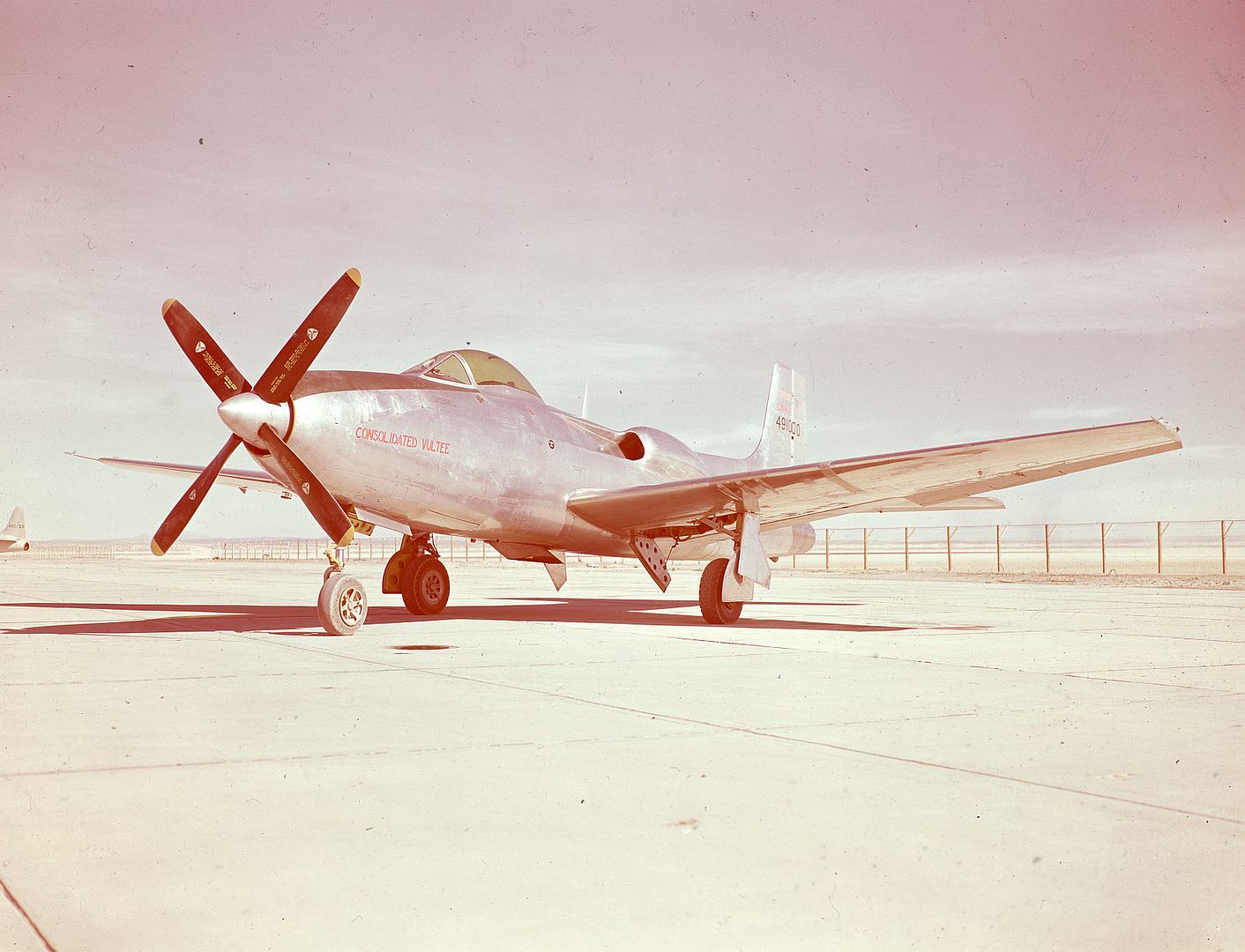

After the XP-81 was returned to Vultee Field, the TG-100 turboprop was installed and flight testing resumed, including the first flight by an American turboprop-powered aircraft on 21 December 1945. However, the turboprop engine was not able to produce its designed power; producing only the same output as the Merlin (1,490 hp or 1112 kW) with the resultant performance limited to that of the Merlin-engined version.

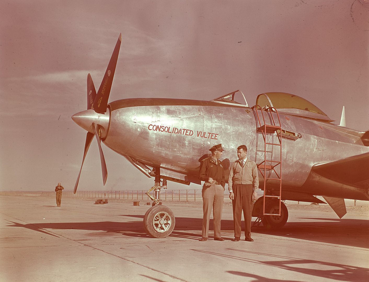

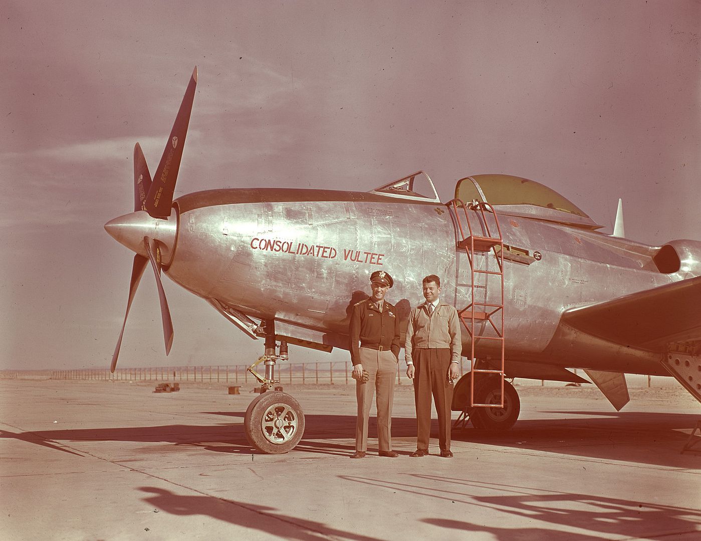

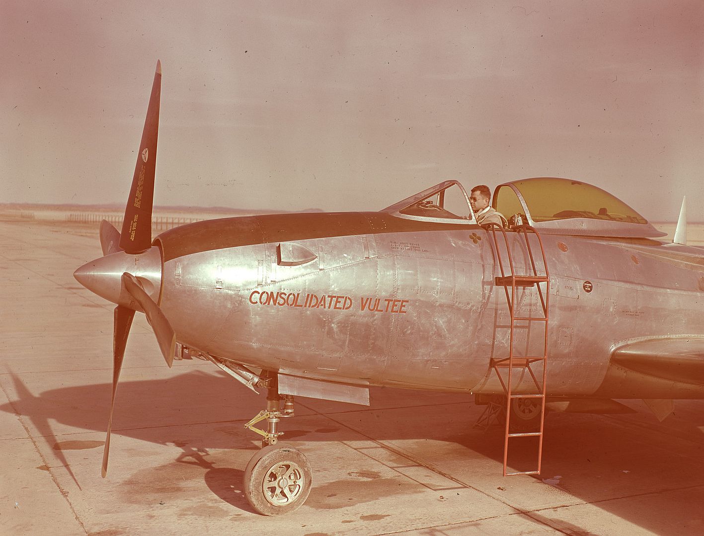

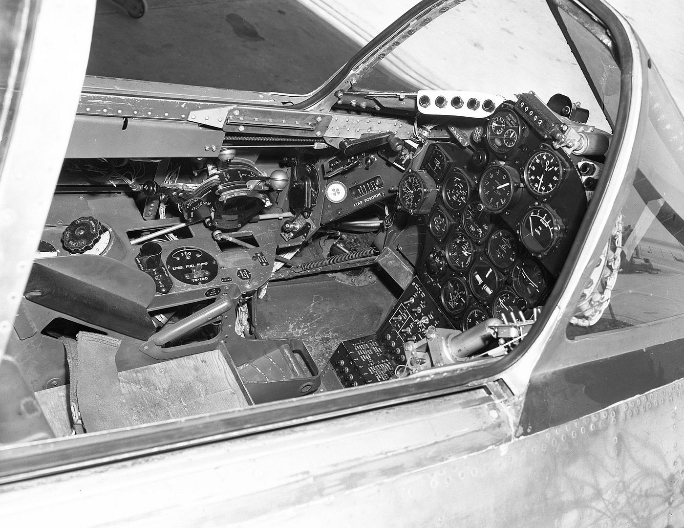

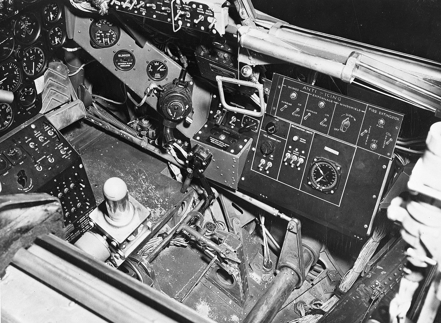

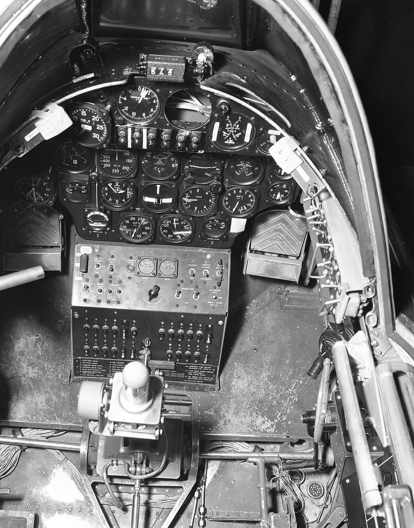

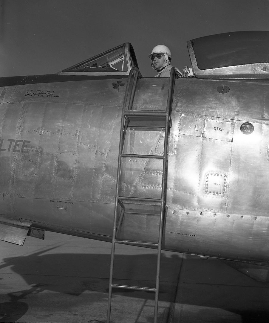

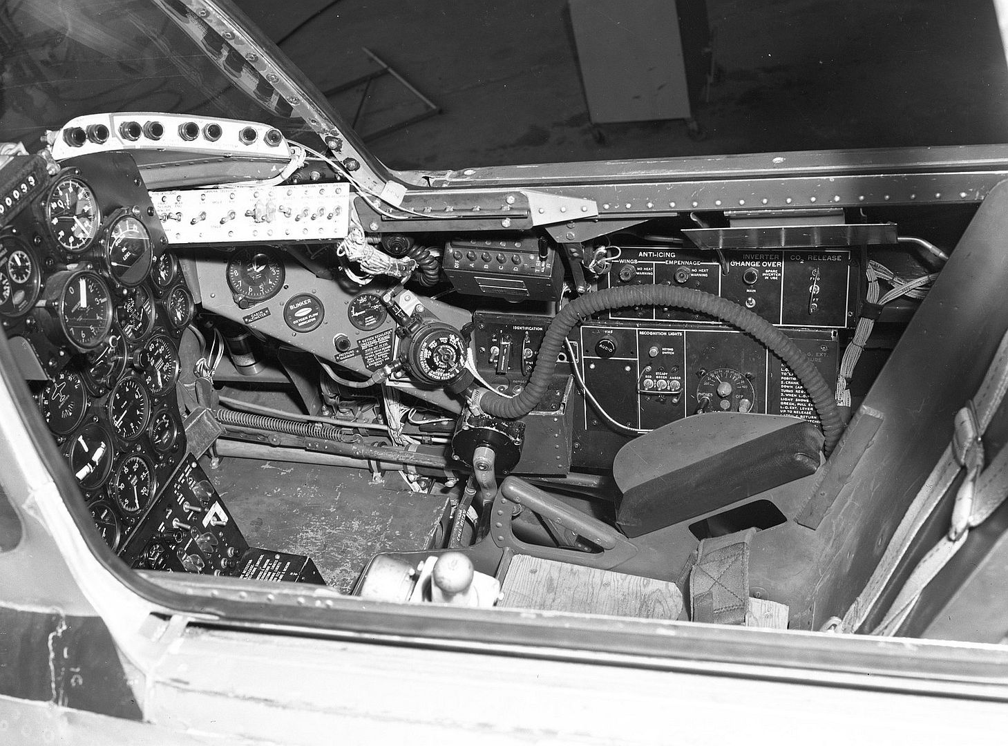

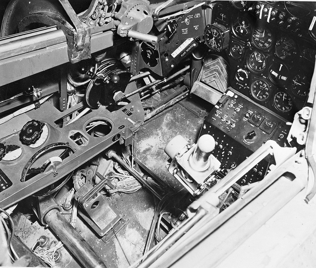

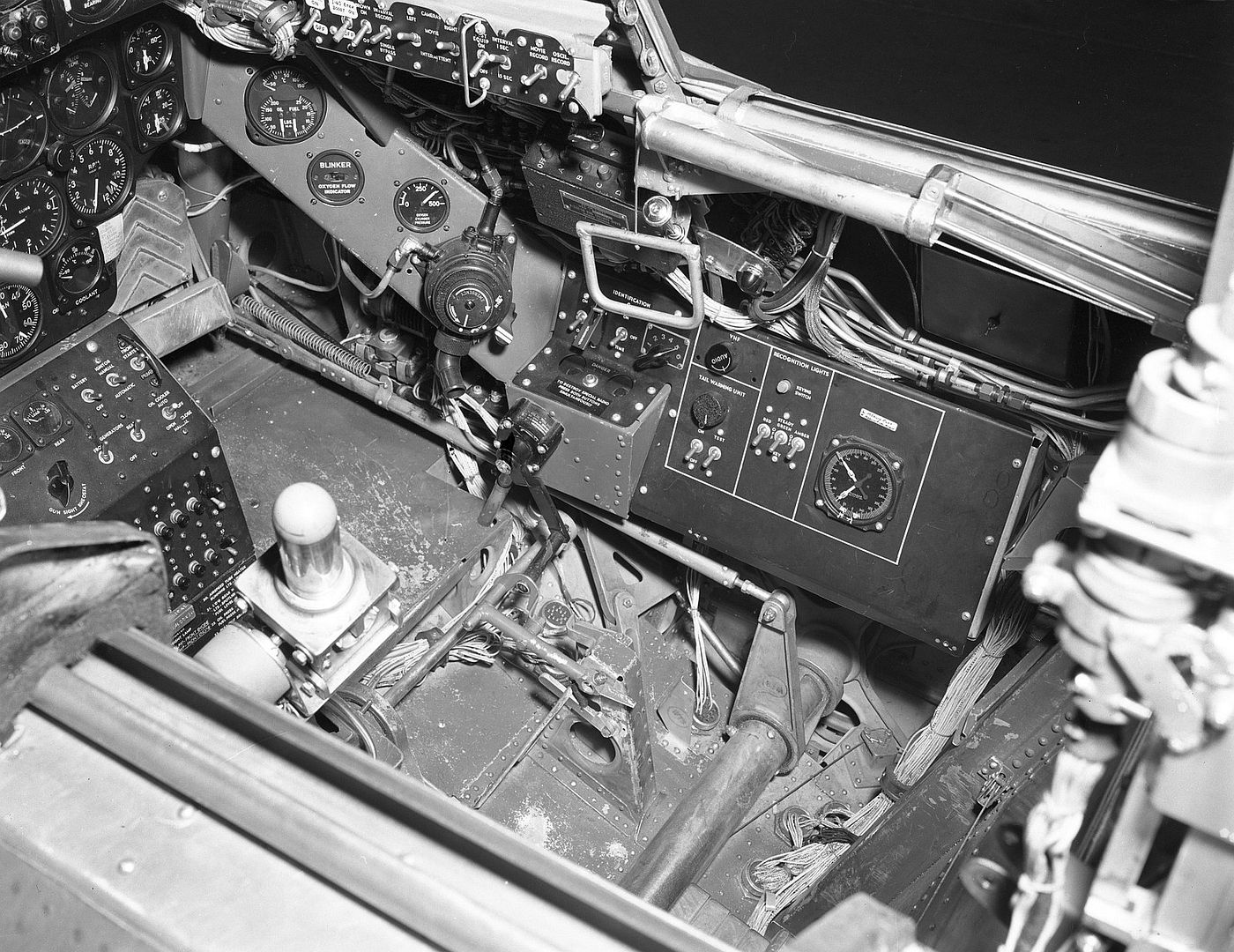

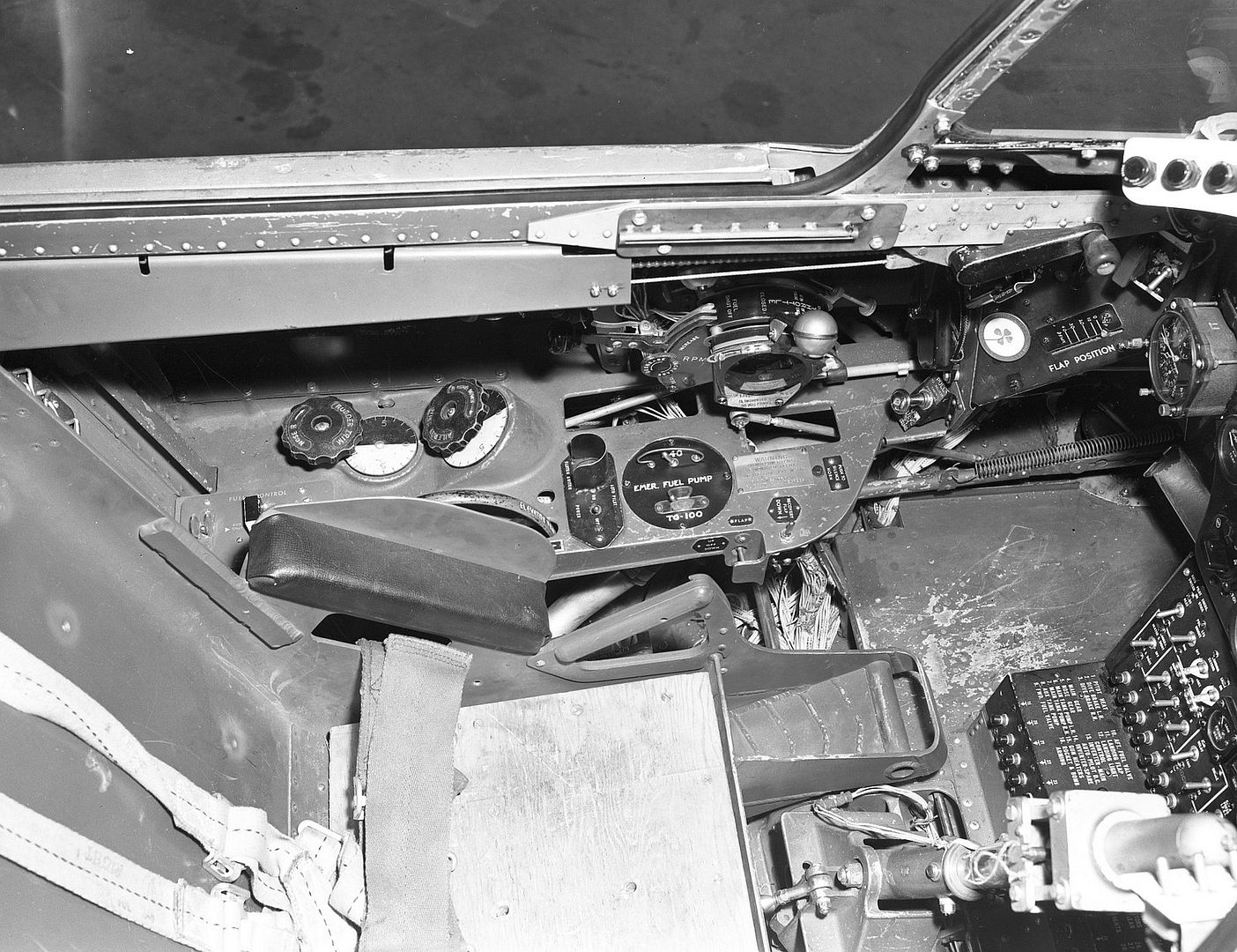

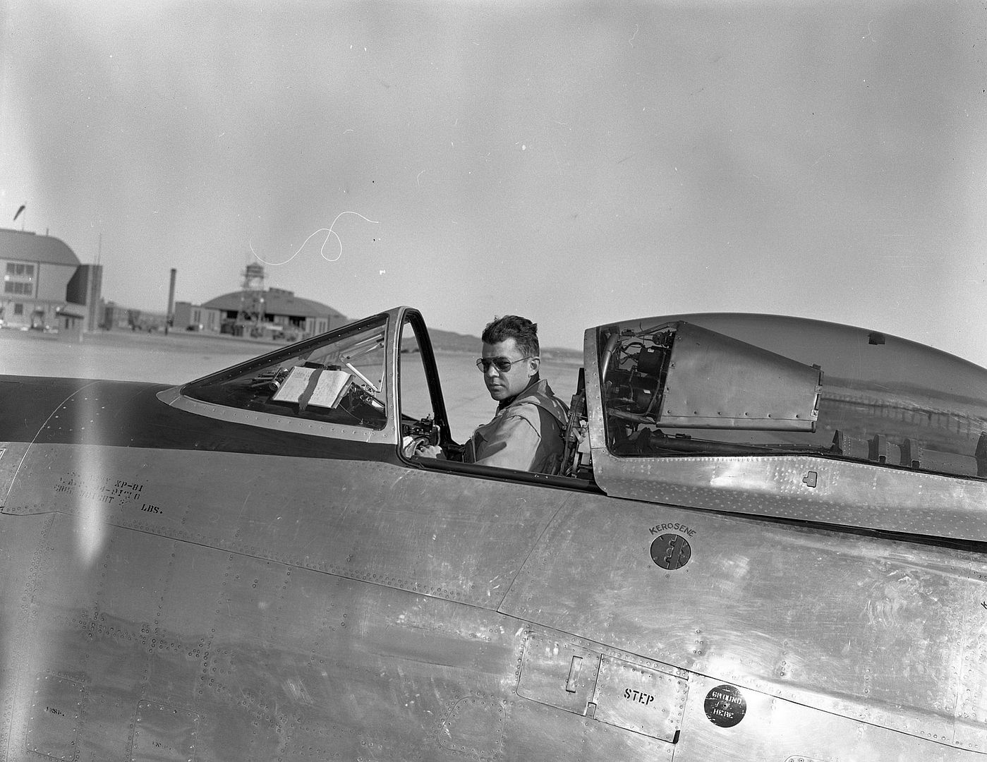

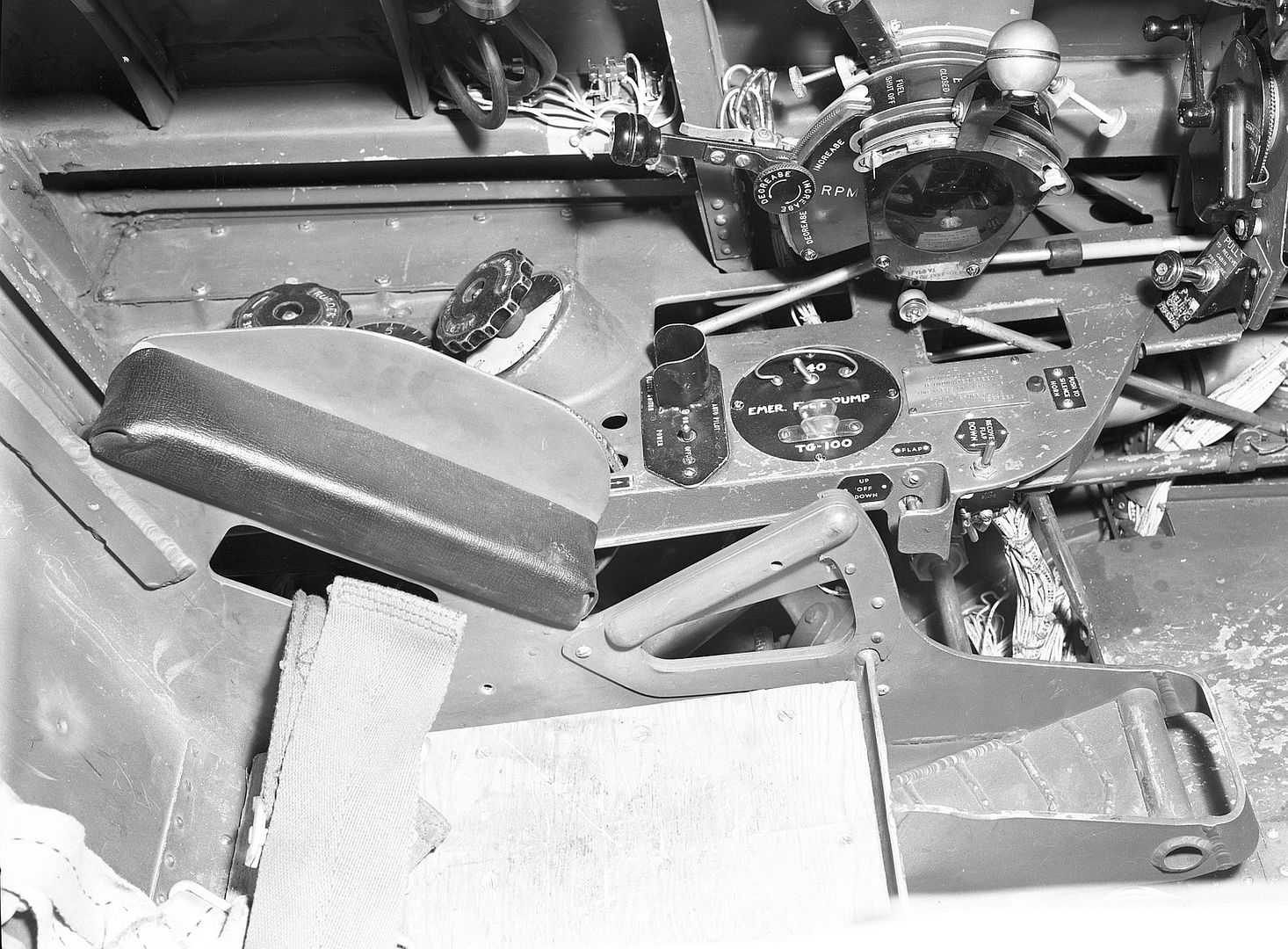

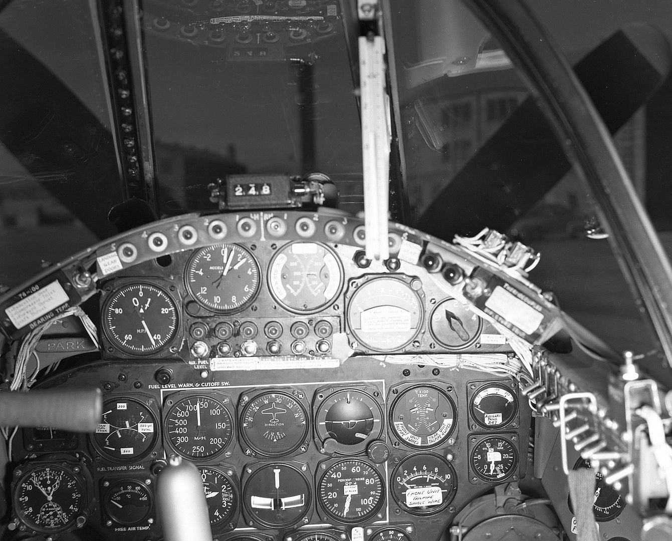

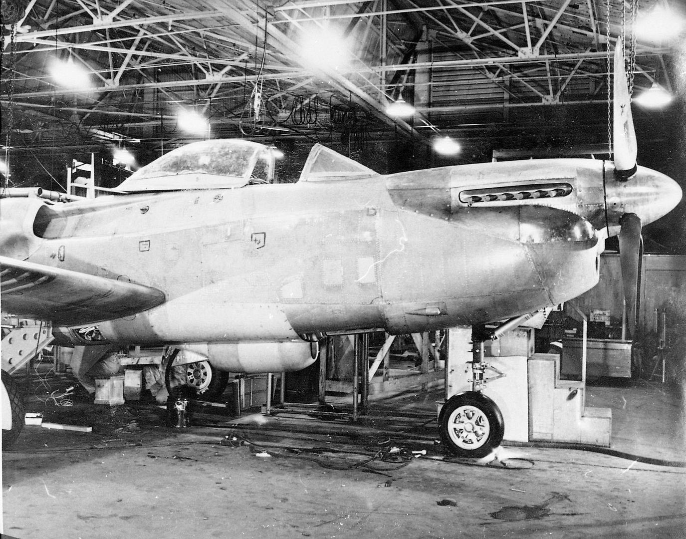

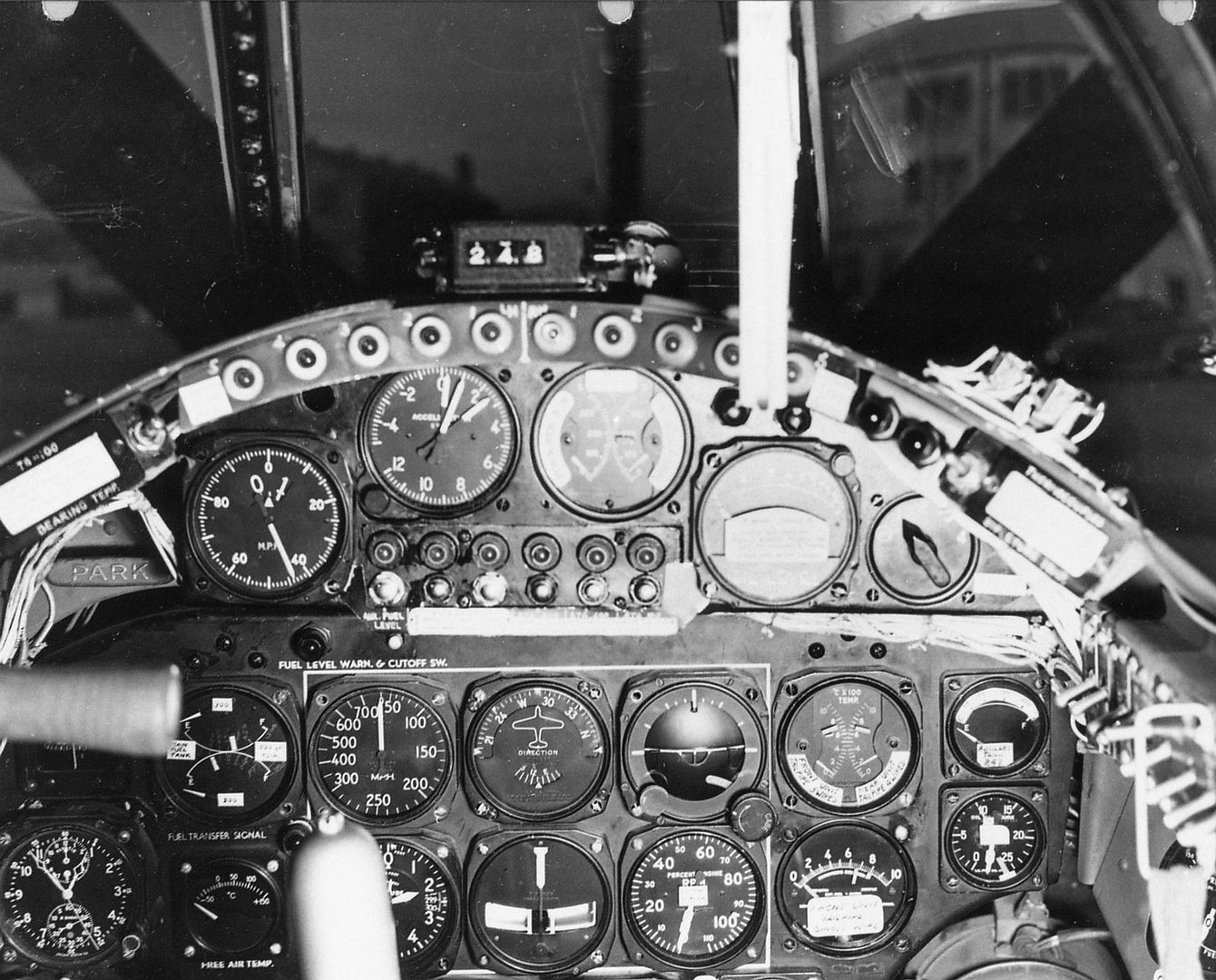

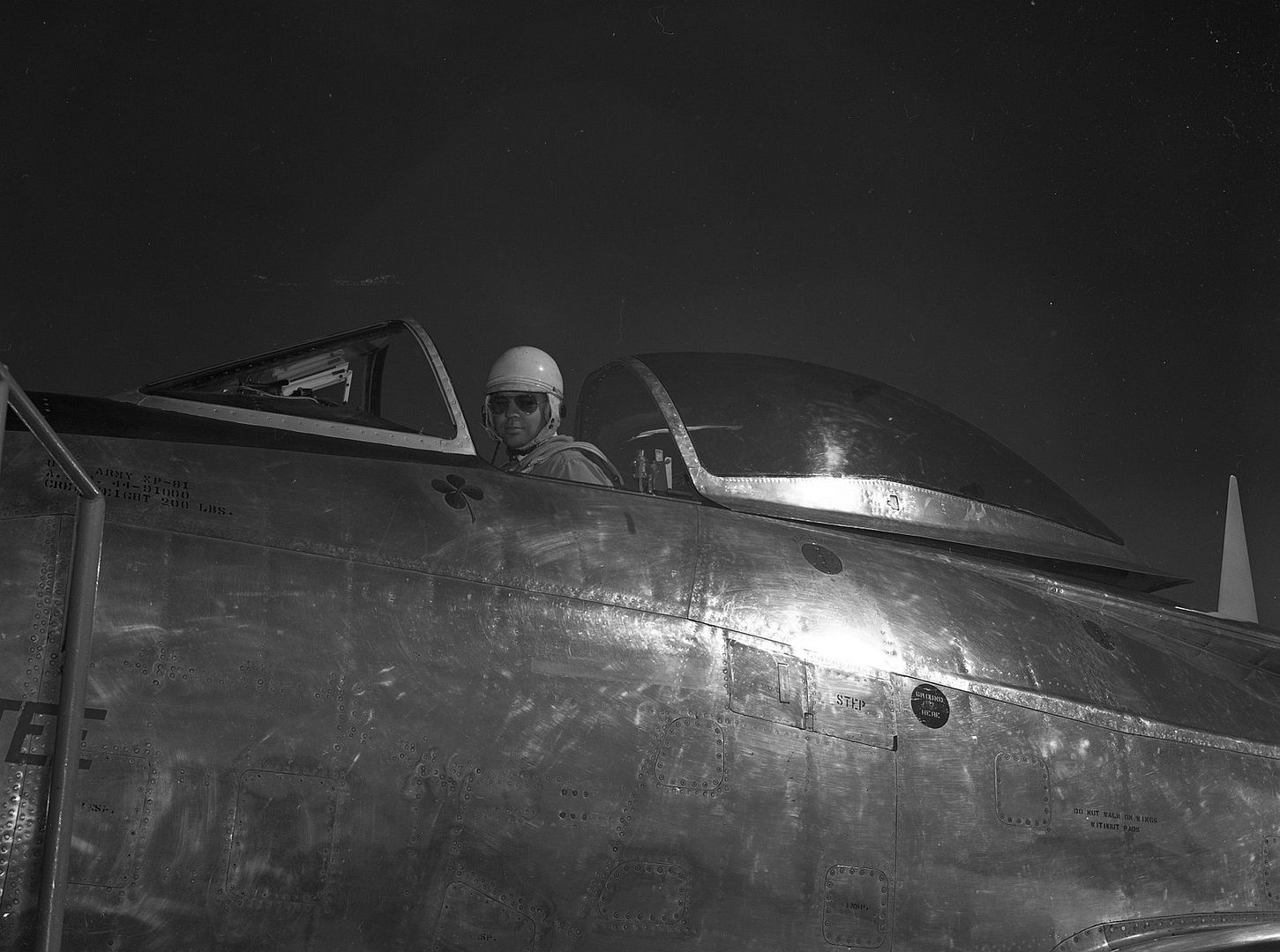

Below cockpit.(Taken at different stages)

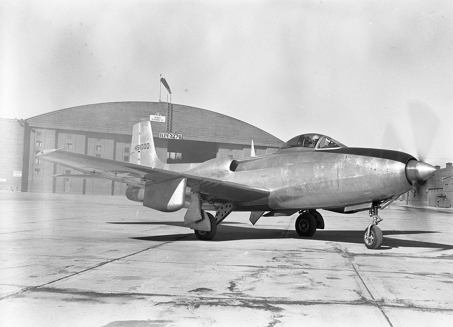

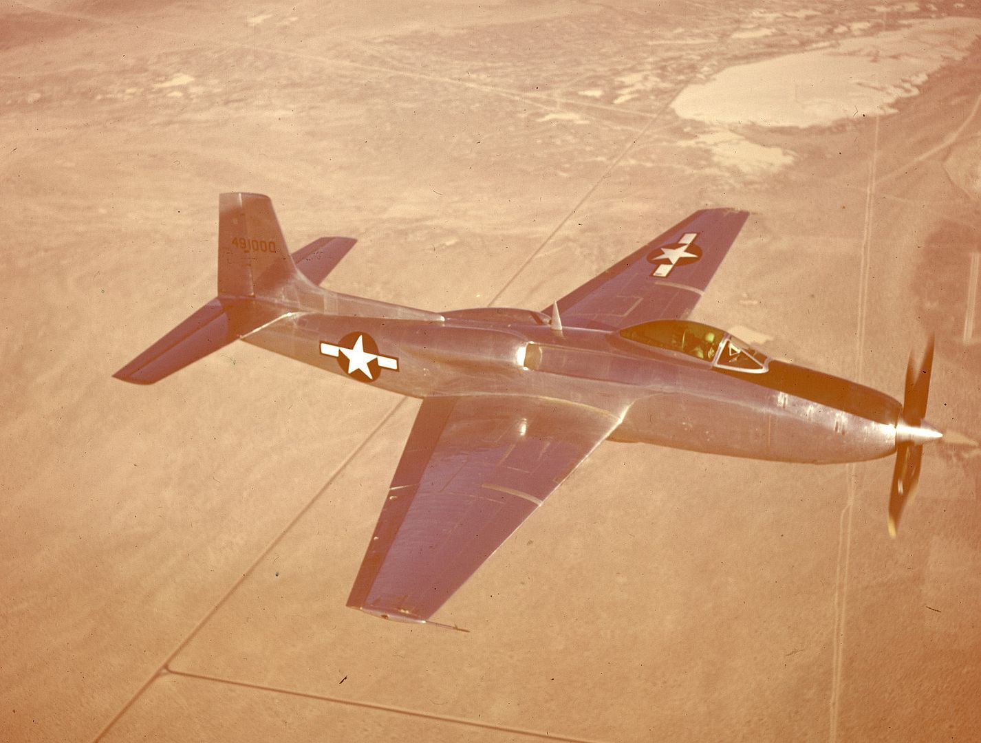

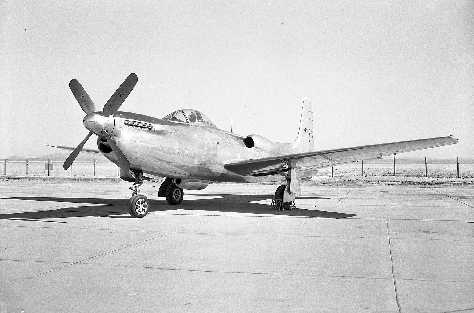

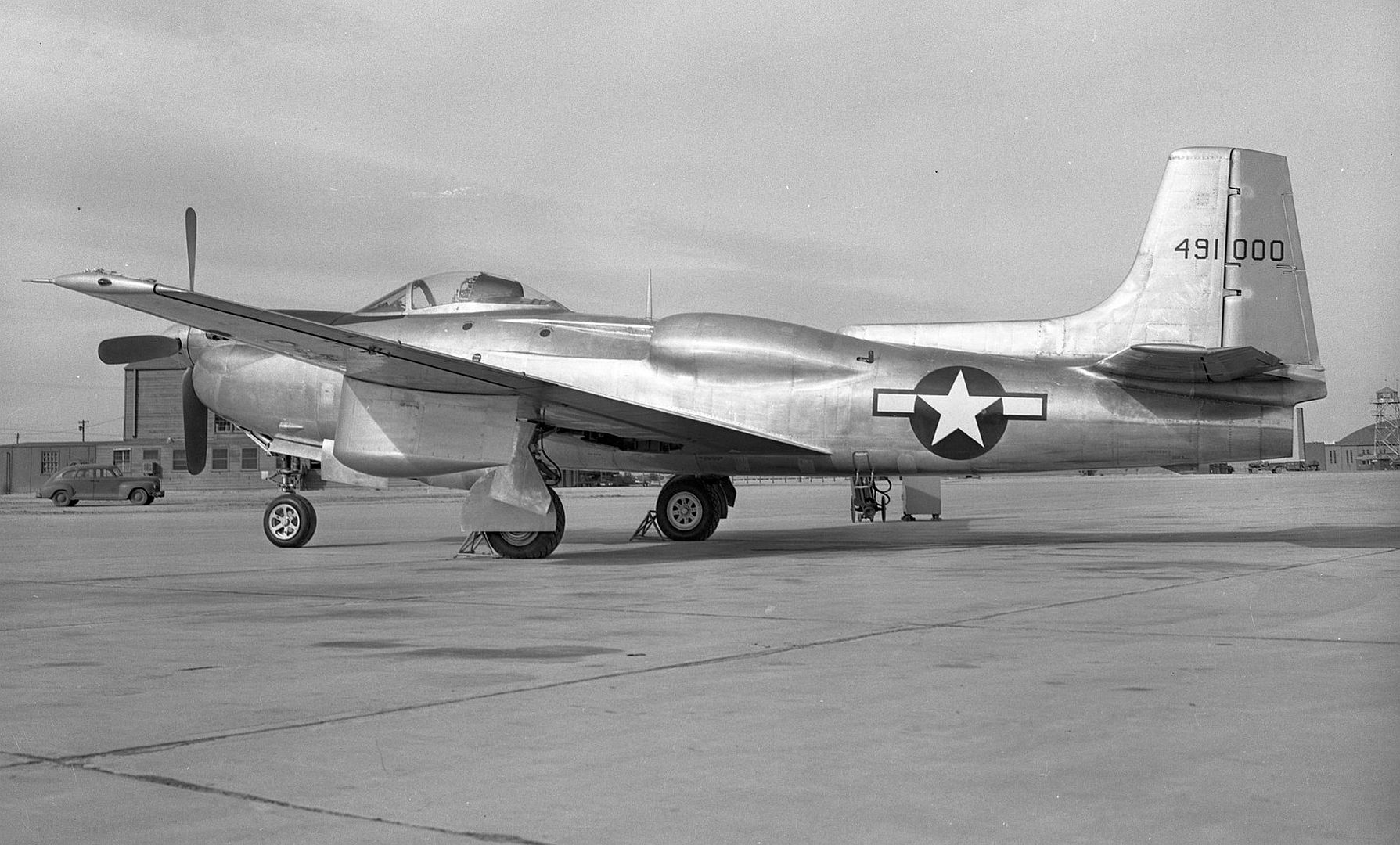

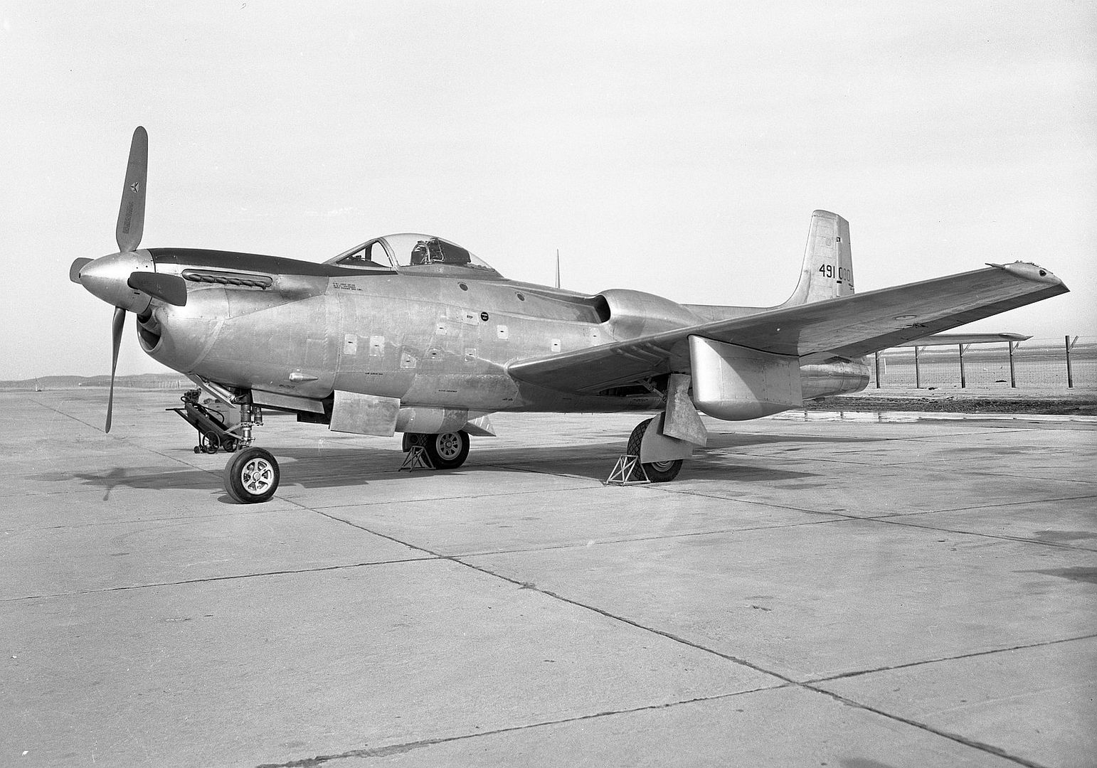

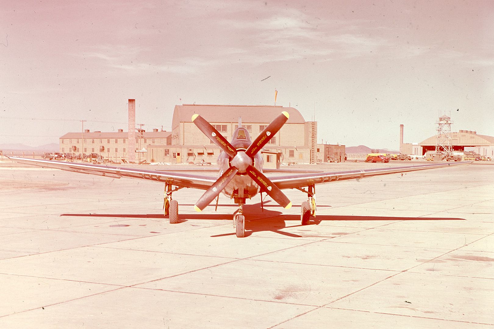

Below with Merlin.

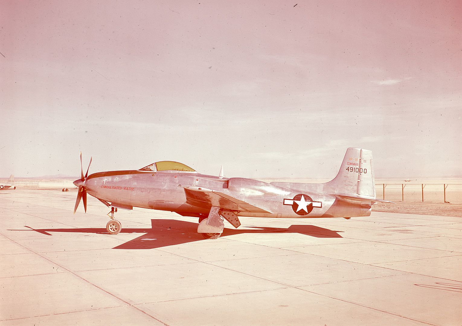

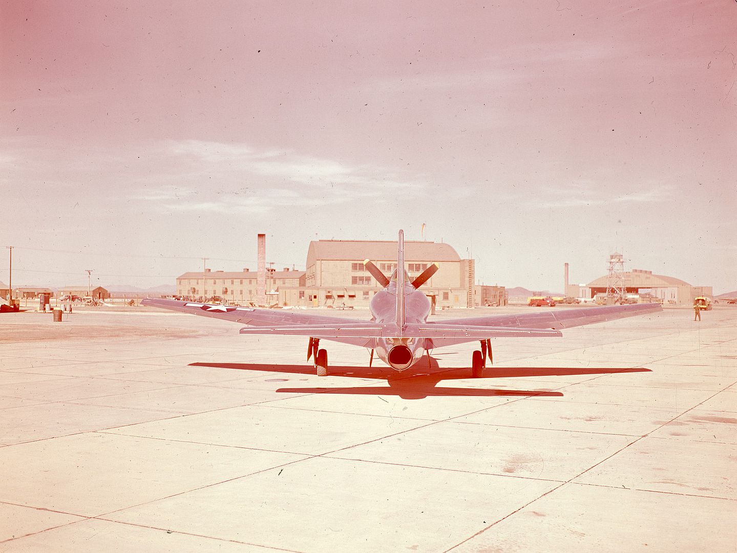

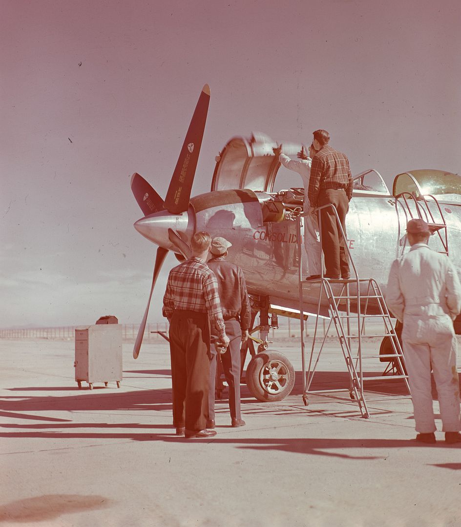

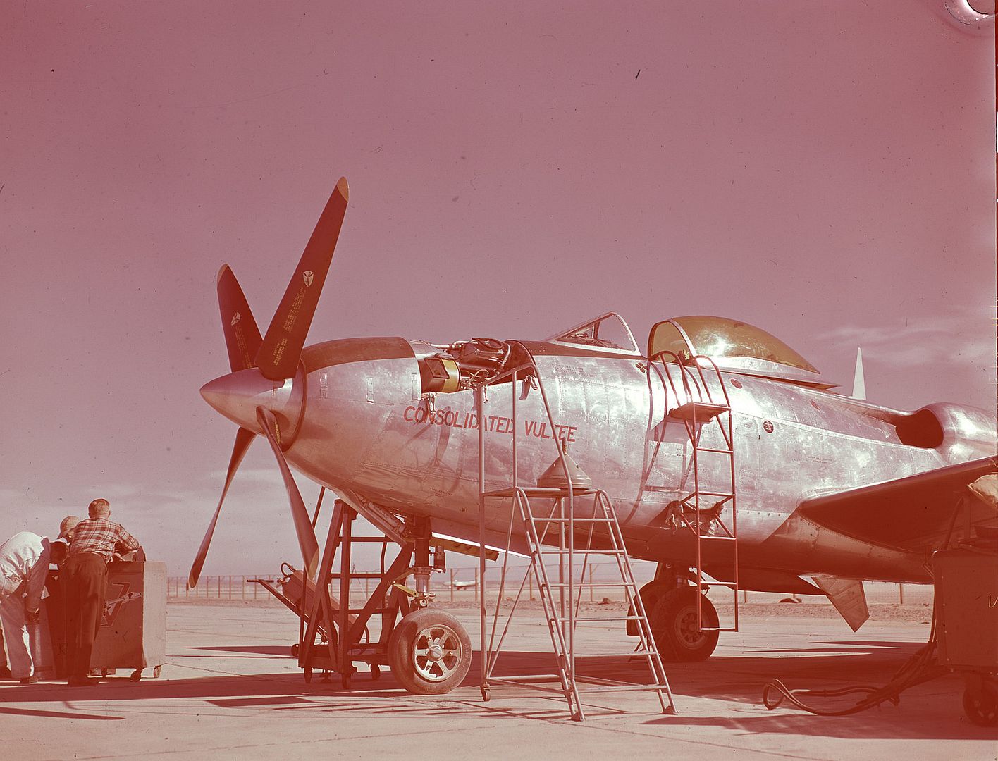

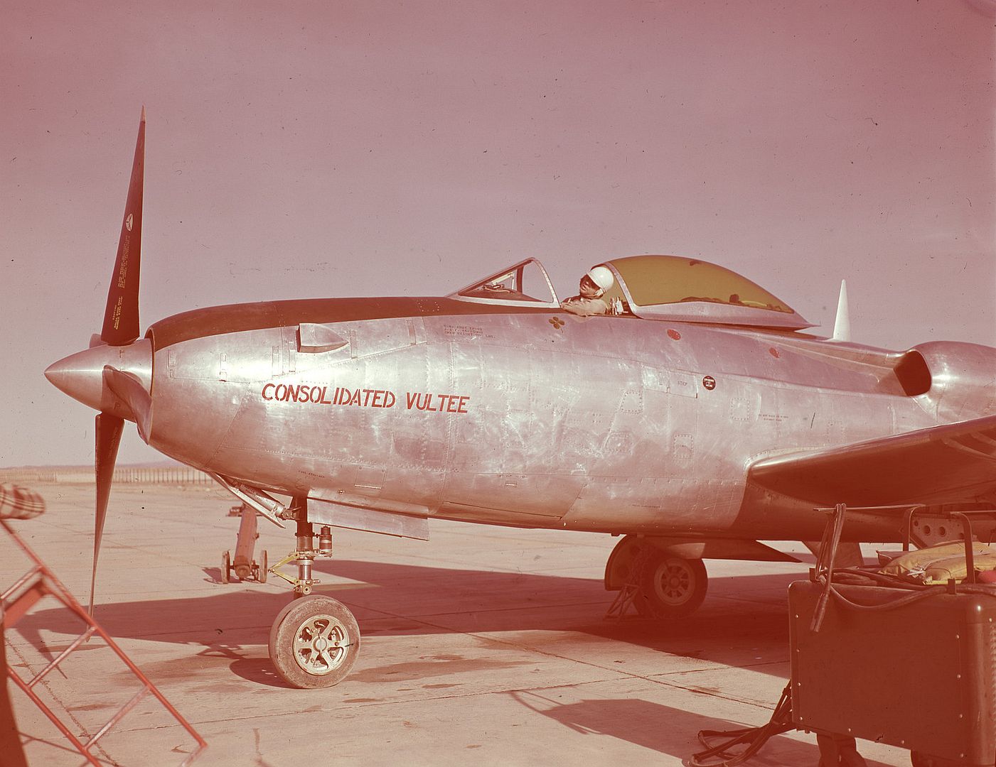

Below with General Electric TG-100 turboprop engine
