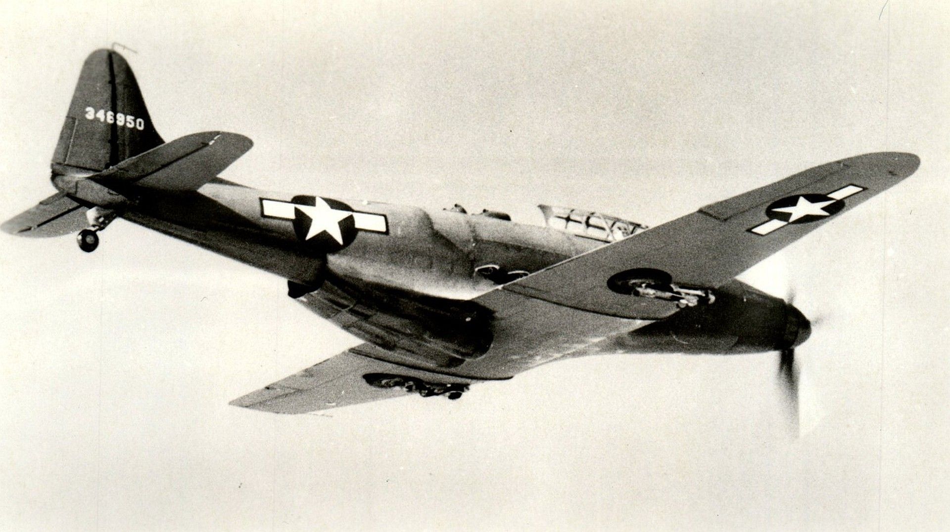

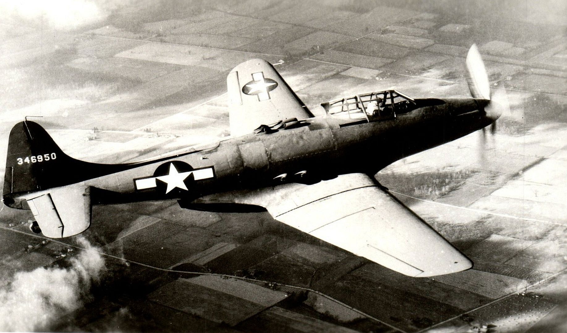

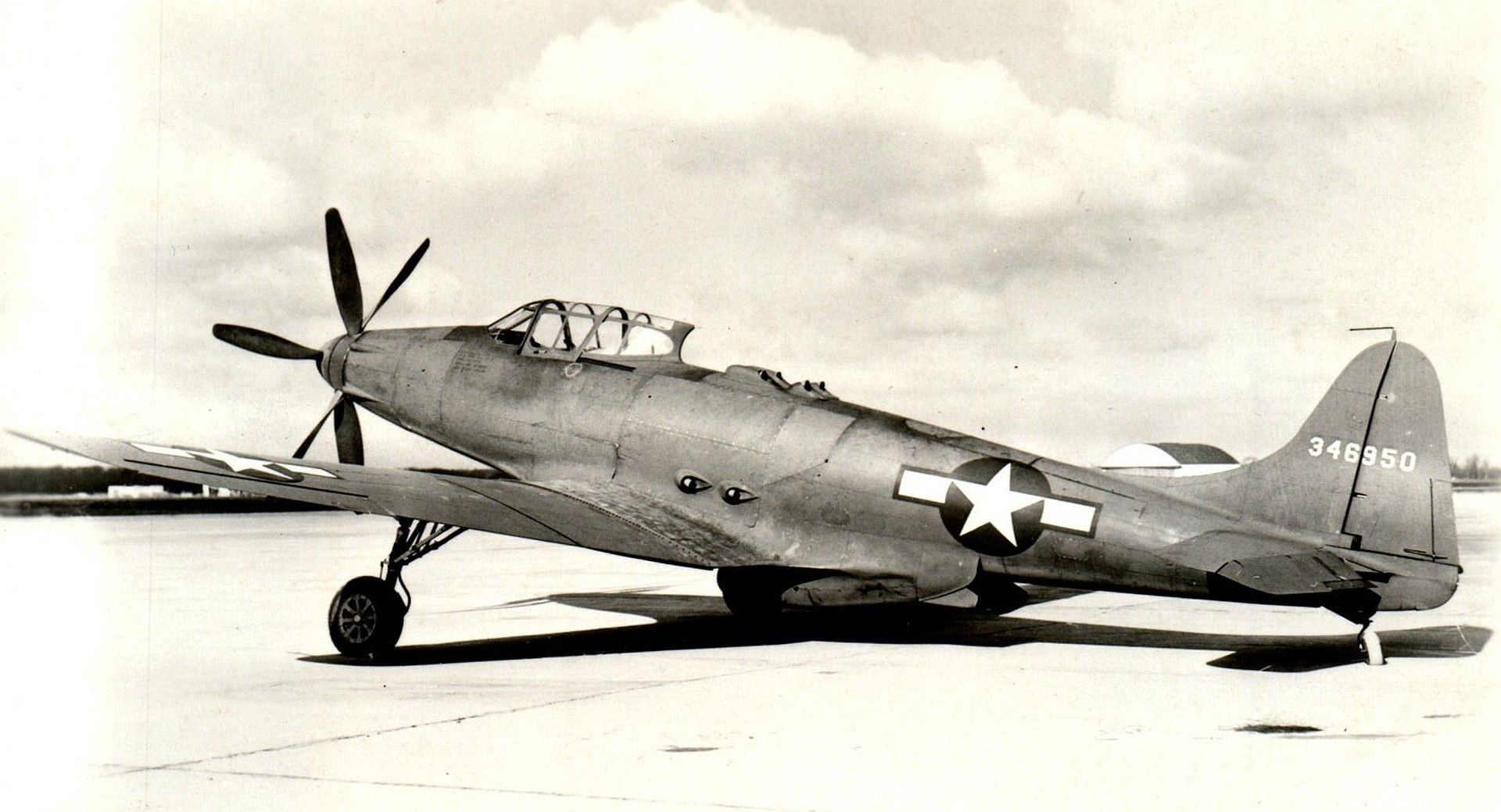

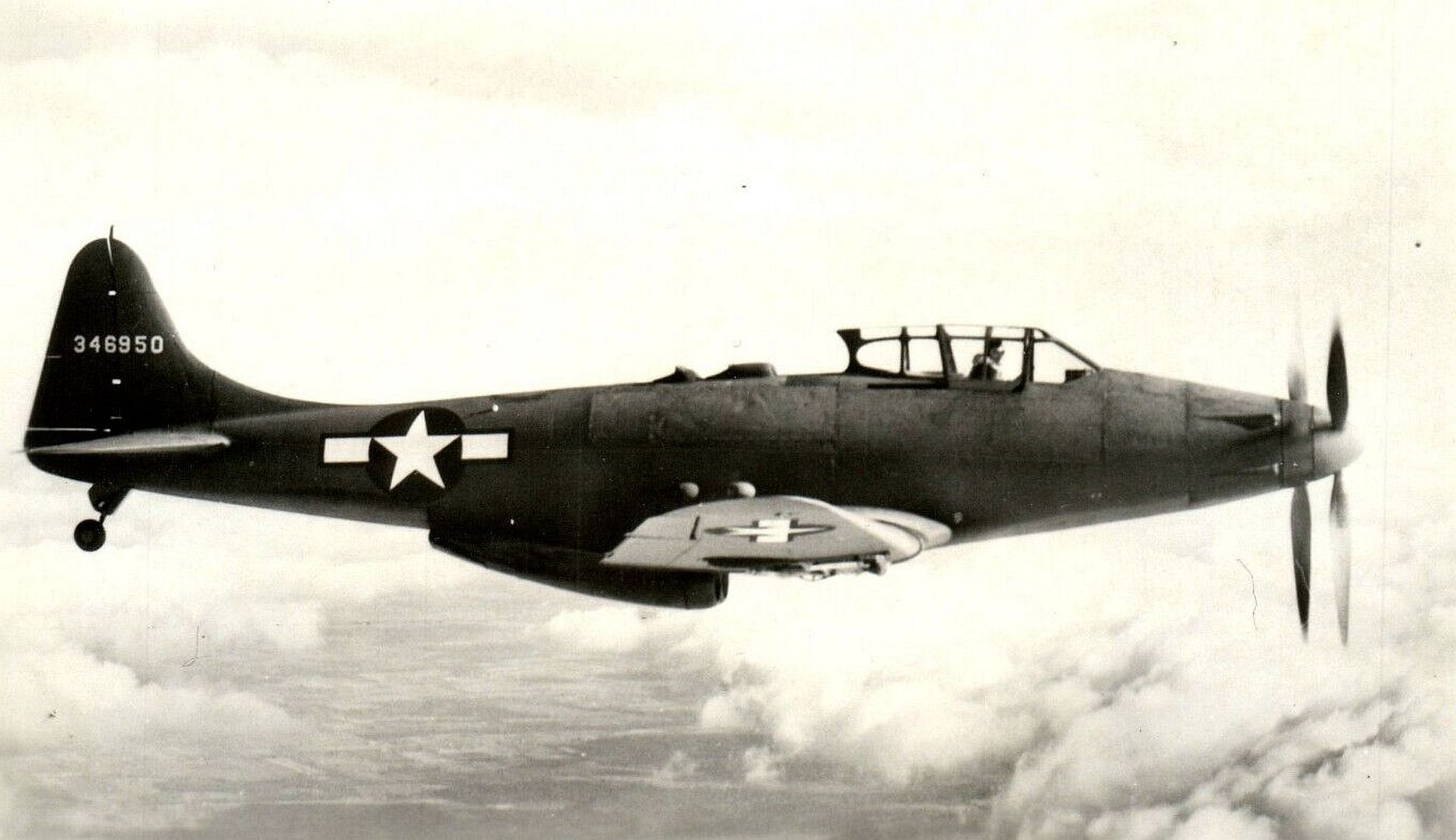

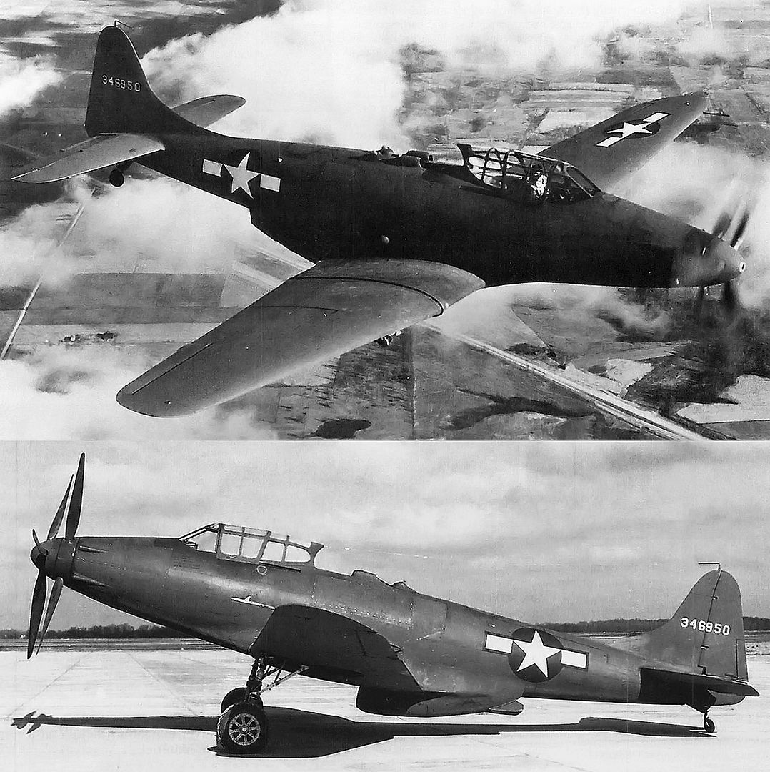

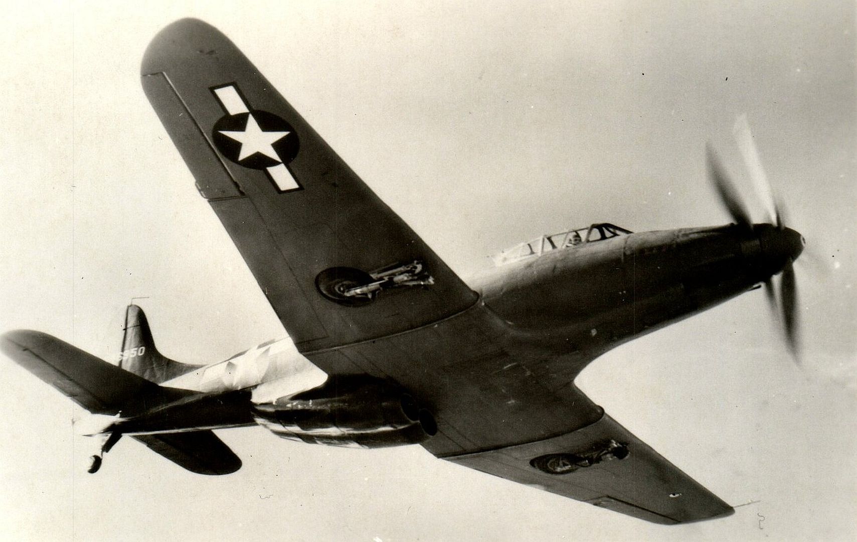

Serial numbers 43-46950 and 43-46951 were assigned to the two XP-75 prototypes. The Allison engine was to be located behind the cockpit a la P-39 Airacobra, and was to drive a set of contrarotating propellers via an extension shaft and a reduction gearbox. The engine was cooled by means of a large duct in the ventral fuselage. Initially, it was planned that the outer wing panels of the P-51 Mustang would be used in an inverted-gull configuration, and that the tail assembly of the Douglas A-24 (Army version of the SBD Dauntless) and the undercarriage of the Vought F4U Corsair would be used. However, at an early stage it was decided to drop the inverted gull-wing configuration and go with a straight wing design utilizing outer wing panels from a P-40.

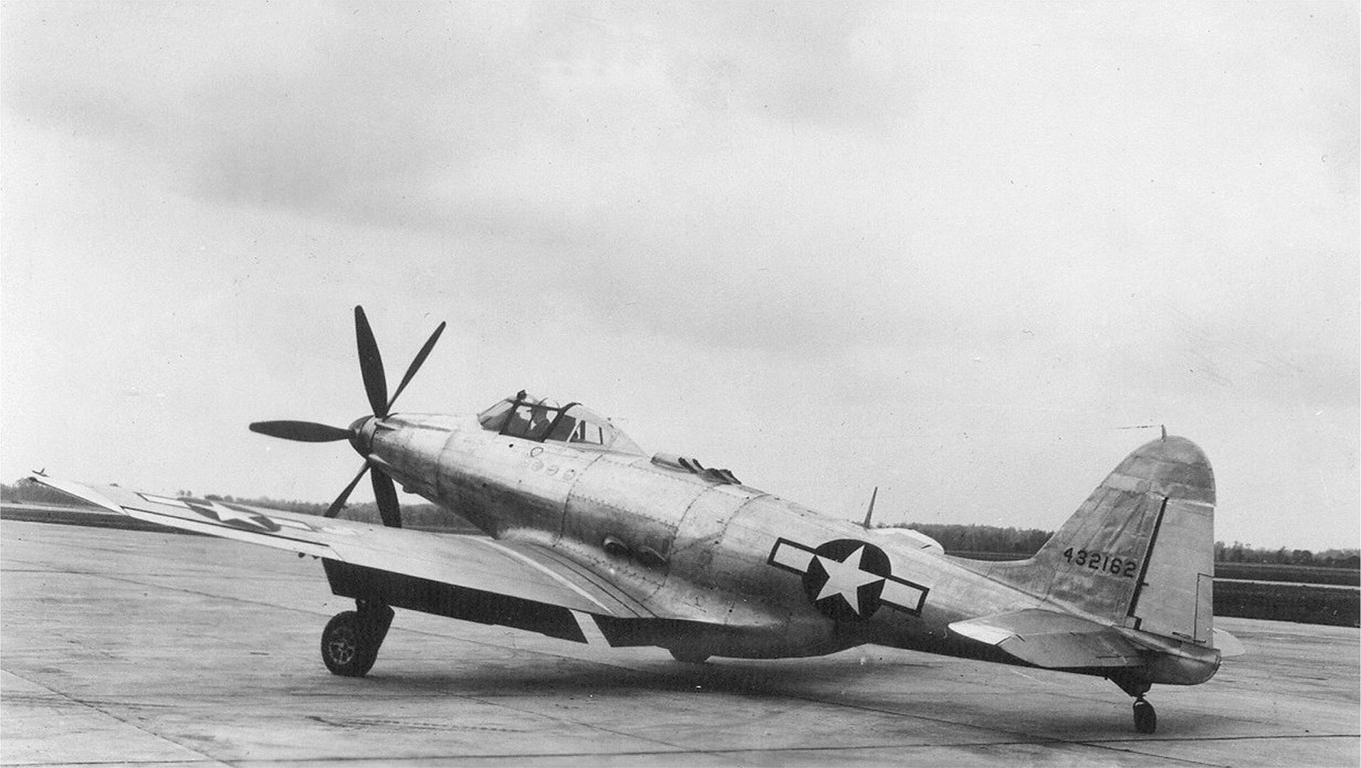

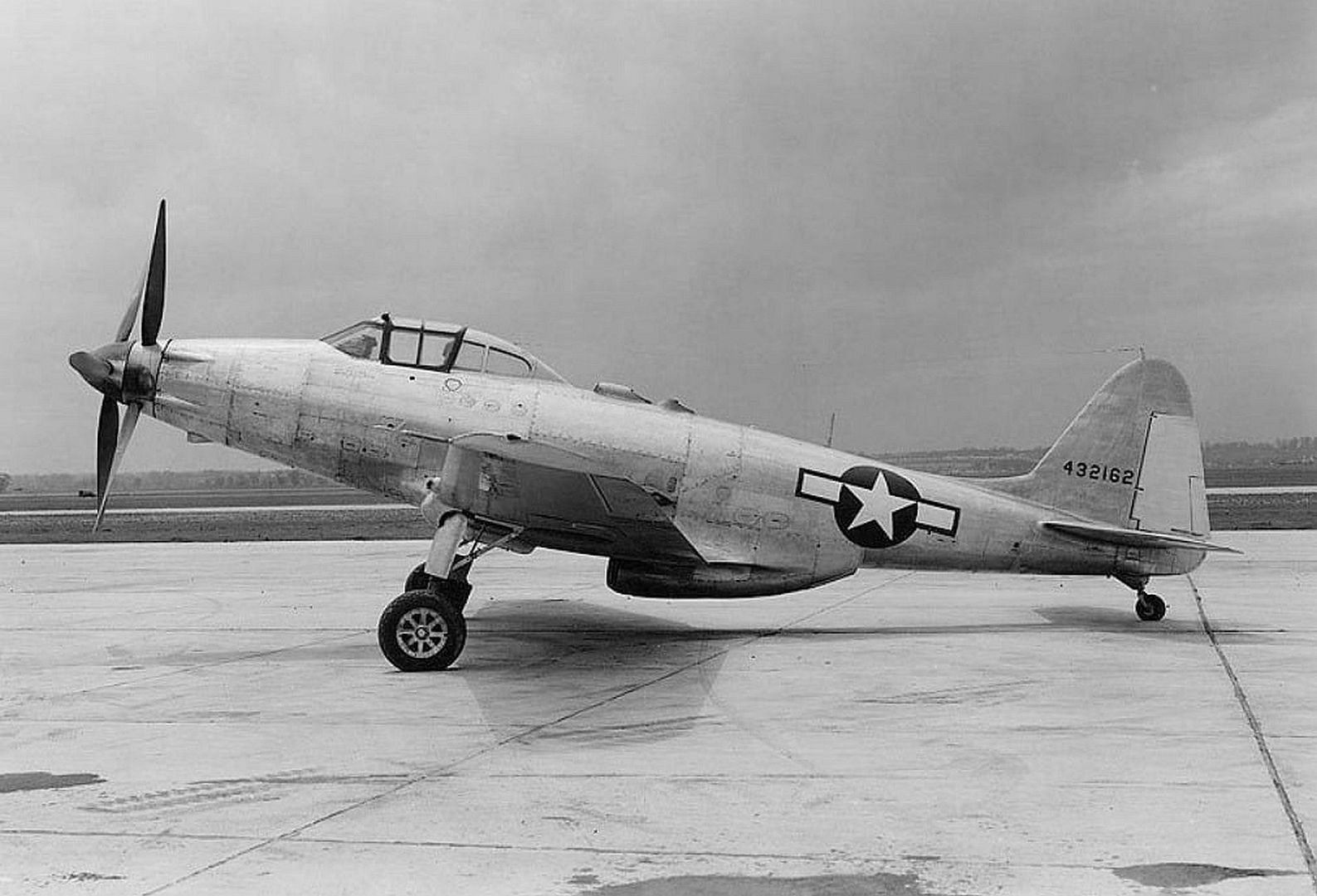

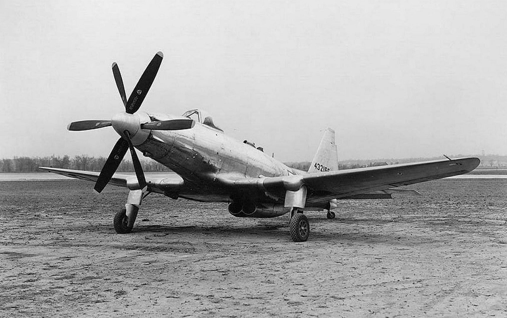

By the summer of 1943, the USAAF had a more urgent need for long-range escort fighters than it did for fast-climbing interceptors. On July 6, 1943, the USAAF ordered six more prototypes that would be adapted to fulfill the long-range escort role. They were assigned the designation XP-75A, and the serial numbers were 44-32161/32166. They were to be powered by an Allison V-3420-23 engine, and were to be armed with six 0.50-inch machine guns in the wings and four 0.50-inch guns in the fuselage nose. At the same time, the USAAF decided to order no less than 2500 production P-75As, although they did stipulate in the contract that if the production aircraft did not meet specifications the order might be cancelled. Maximum speed was to be 434 mph at 20,000 feet and 389 mph at sea level. These production P-75As were to be built at the Fisher plant in Cleveland, Ohio.
The first XP-75 flew on November 17, 1943. It was powered by an Allison V-3420-19 engine rated at 2600 hp for takeoff and driving a pair of contrarotating propellers. As planned, the wing was of a straight center section with P-40 outer panels with modified tips. The tail assembly was from an A-24, and the main undercarriage members were taken from an F4U Corsair.
All six XP-75A long-range escort versions were in the test program by the spring of 1944. Some problems were encountered with instability, since errors had been made in the initial estimate of the aircraft's center of mass. The coupled Allison engine failed to give its full rated power. The engine cooling was inadequate, aileron forces were excessively high, and the spinning characteristics were poor.

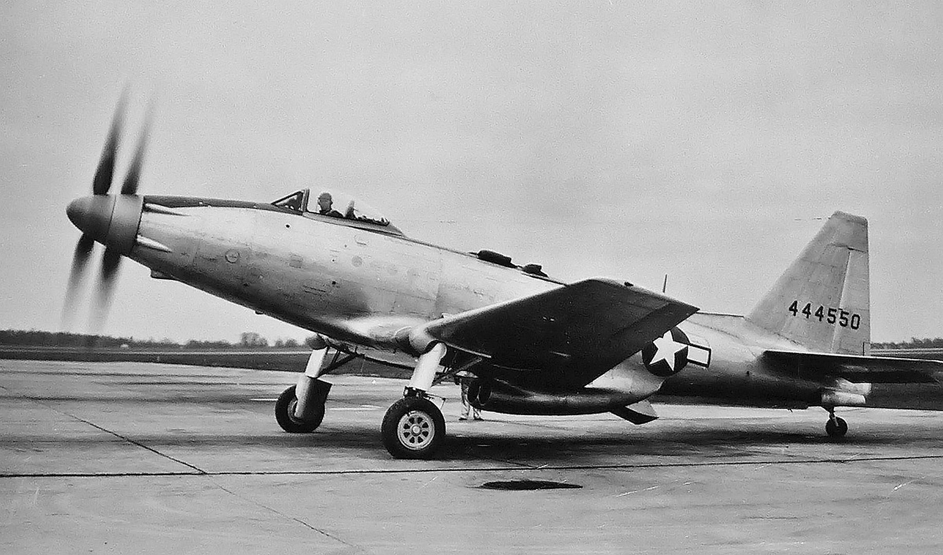

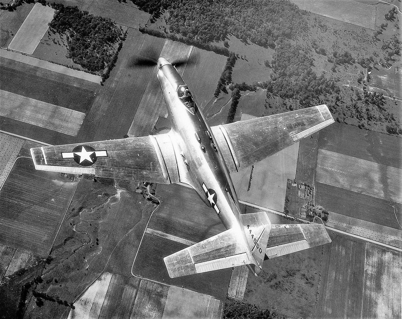

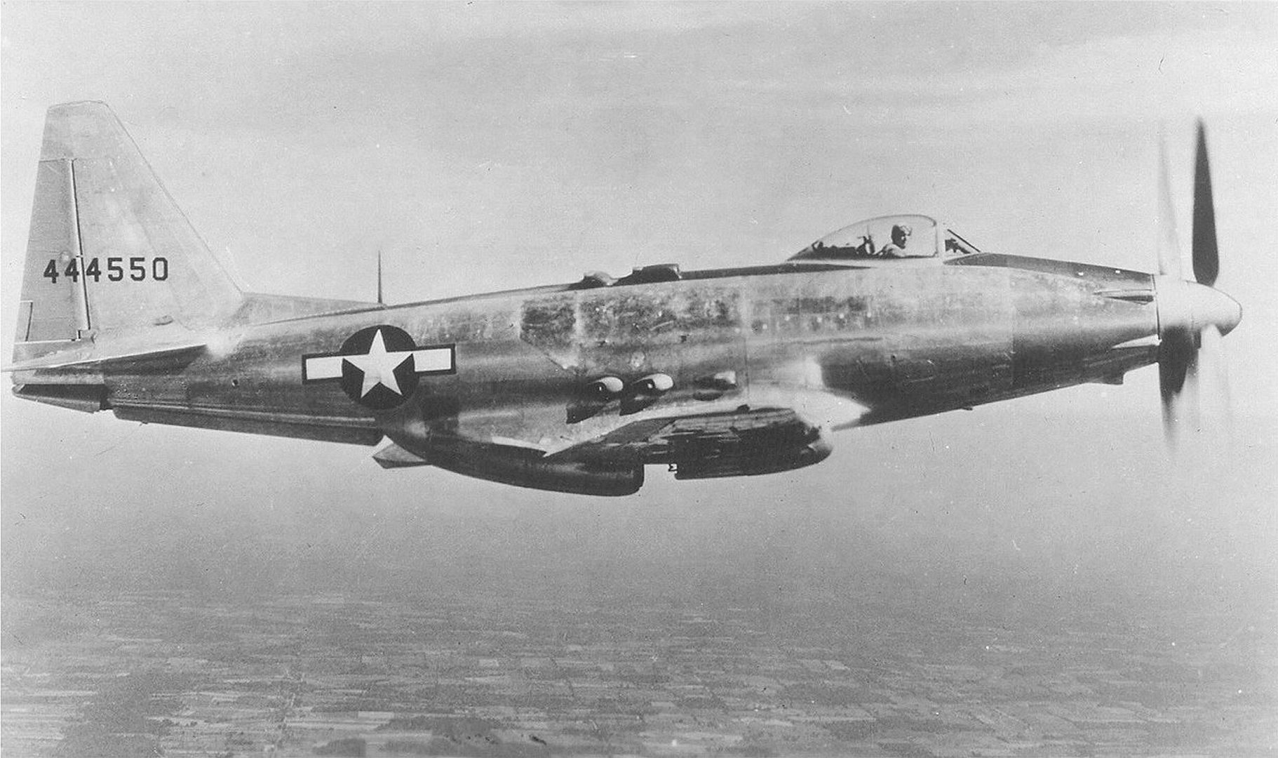

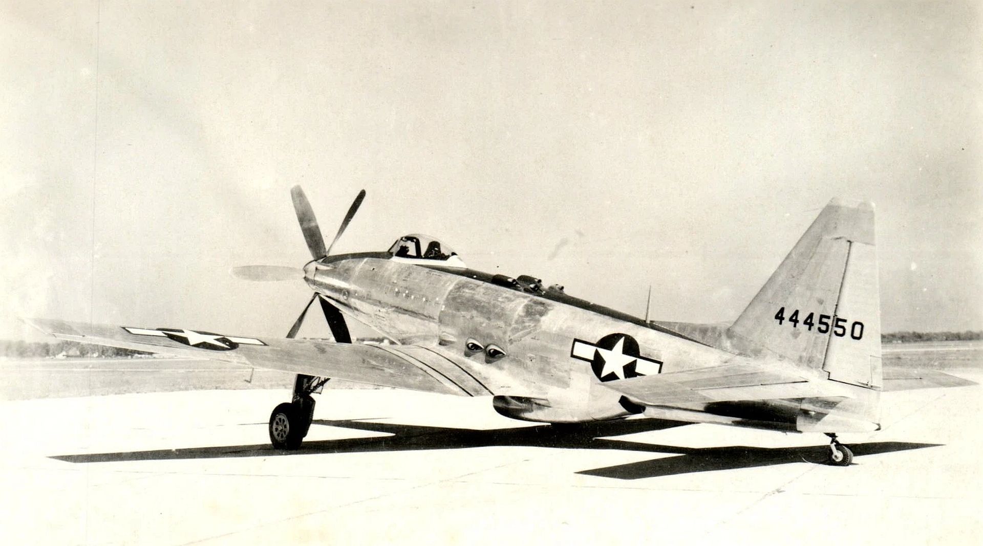

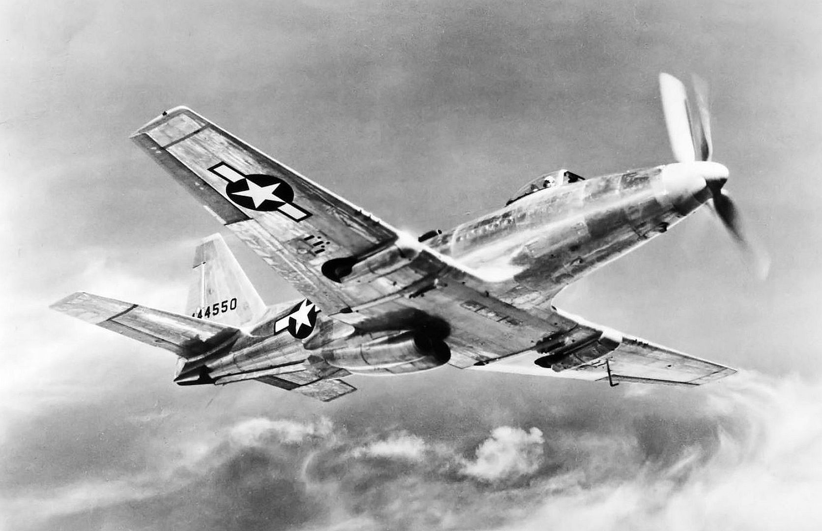

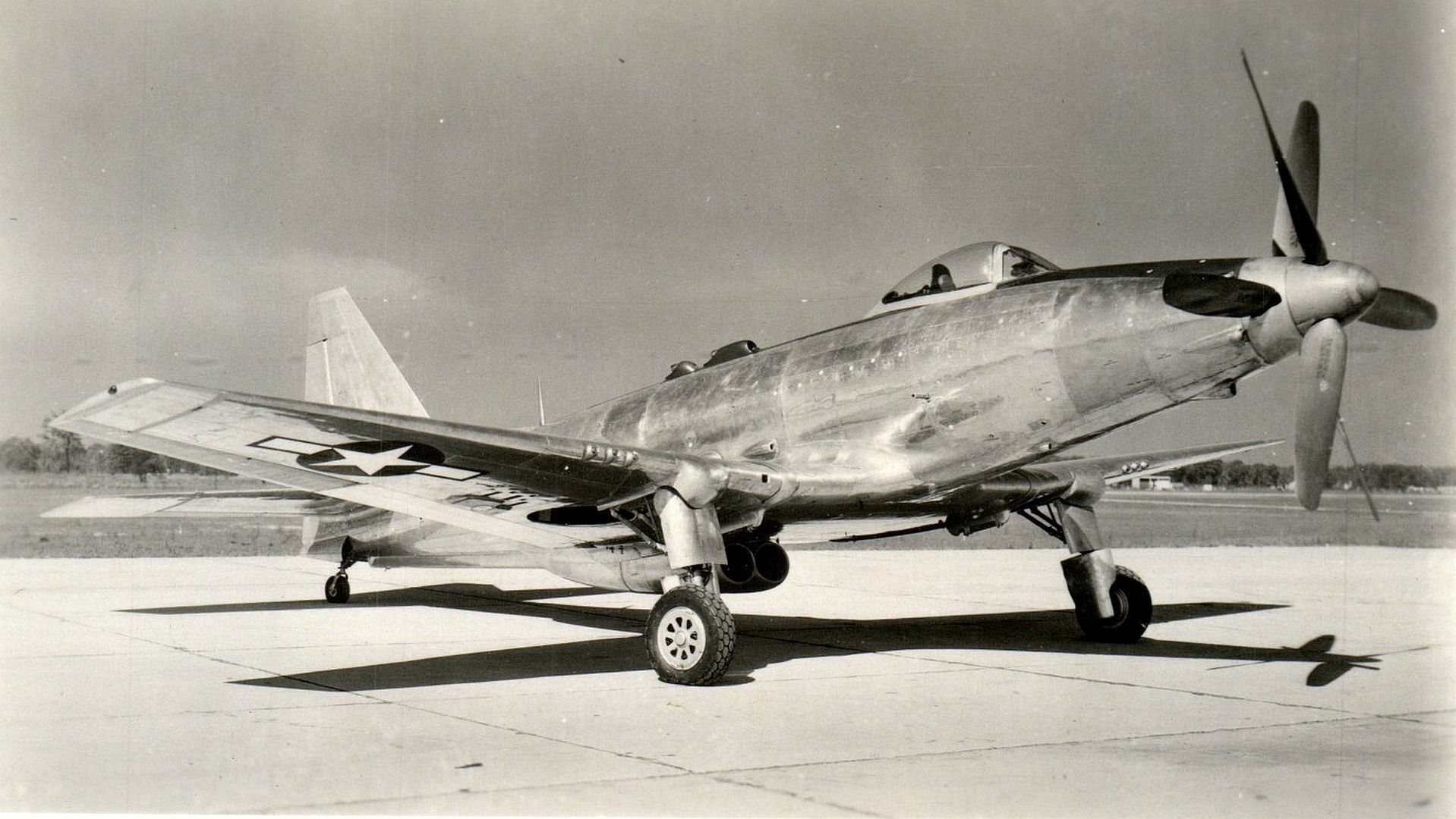

The P-75A production aircraft featured a modified tail assembly and had a bubble-type canopy replacing the framed and braced cockpit hood of the earlier versions. It featured the V-3420-23 engine of the XP-75A. The first P-75A flew on September 15, 1944. By that time, most of the bugs had been ironed out of the design. However, at that stage in the war, the Republic P-47D Thunderbolt and the North American P-51D Mustang were more than adequately fulfilling the long-range escort role, and the USAAF decided that there was no longer any need for a new escort fighter. Consequently, the USAAF decided to terminate the P-75 development program, and the production contract for the P-75A was cancelled on October 27, 1944 after only six examples had been built. The serial numbers of the six P-75As built were 44-44549/44553.
By the time of contract termination, the first and second P-75A had been delivered to Elgin Field, Florida for tactical suitability trials, the third machine was in the shop being fitted with an experimental intercooler, and the fourth and fifth machines were almost complete. Although the USAAF no longer had any need for the P-75, it was decided to go ahead and finish these machines and use them for development work. The sixth machine was to be placed in storage and scavenged for spare parts to keep the rest flying.
The five production P-75As never completed official performance trials, but enough testing was performed to confirm the fact that the maximum speed was at least 30 mph below that guaranteed by the manufacturer. The third machine received an experimental intercooler installation which permitted substantial increases in engine power.

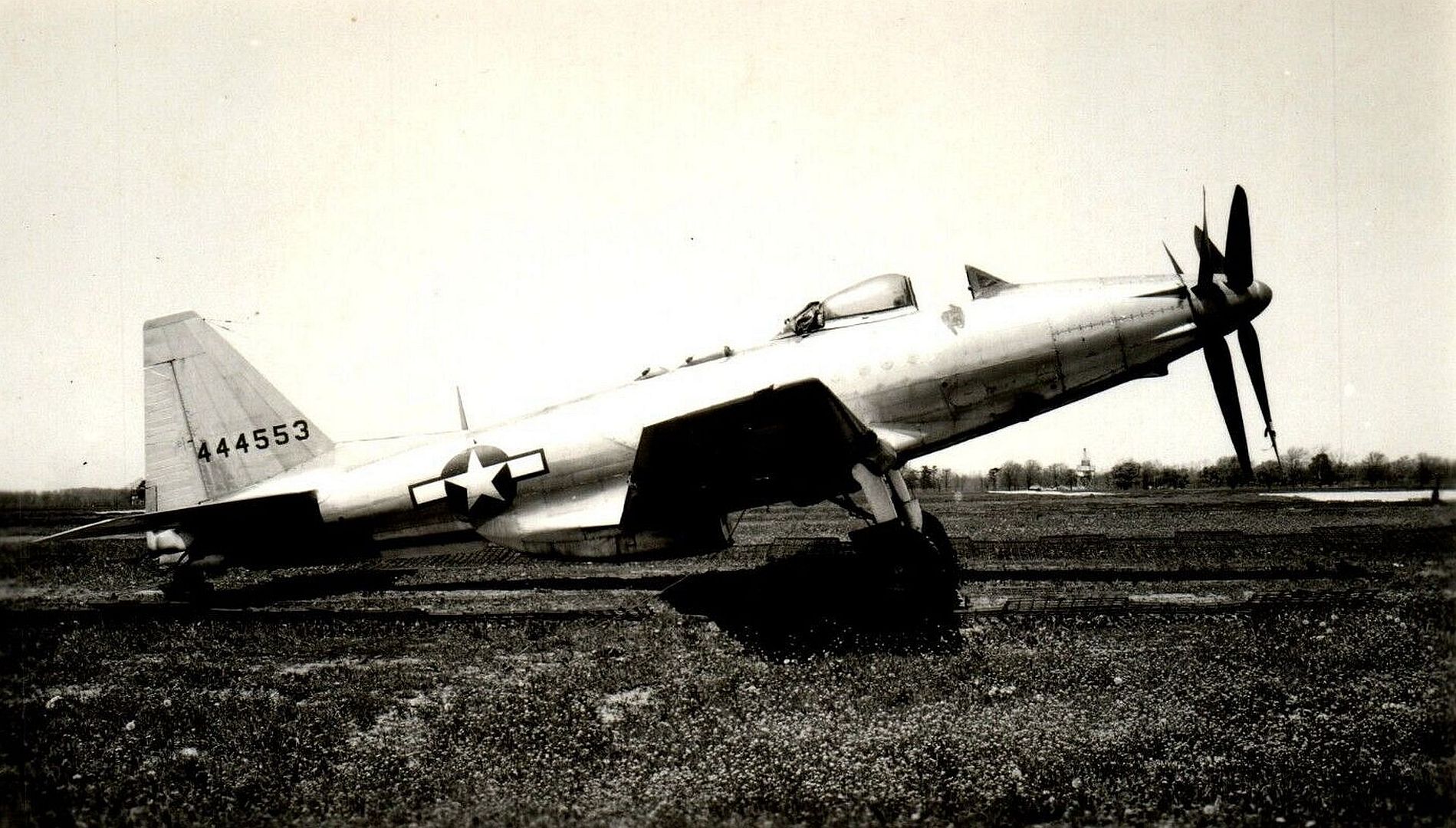

AAF Ser. No. 44-44553: National Museum of the United States Air Force at Wright-Patterson AFB in Dayton, Ohio. For many years this aircraft was on display in the museum's Experimental Aircraft Gallery. Extensive deterioration of the airframe was discovered by the staff in 1999, which forced the Museum to undertake a full restoration of the aircraft. The work has been completed and the aircraft returned to display in the museum's Experimental Aircraft Gallery.
