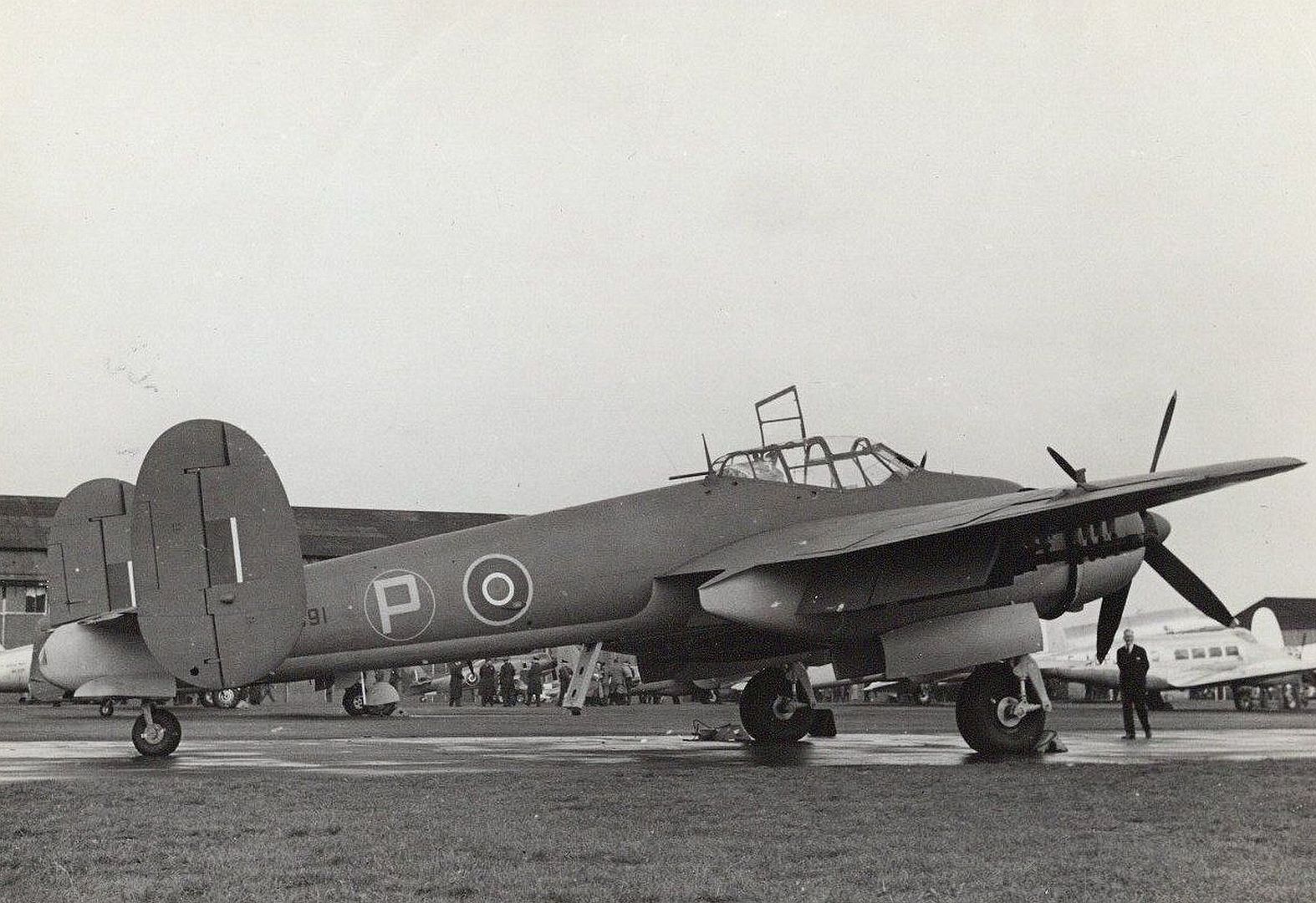

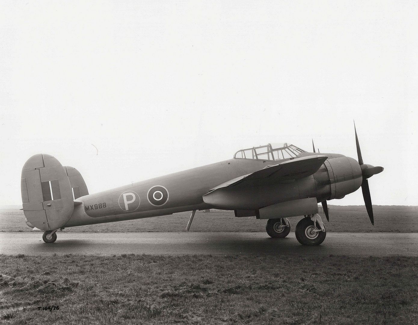

The first of four prototypes MX988 was flown on December 4th 1944 at Flixton by Captain Cyril Unwin.

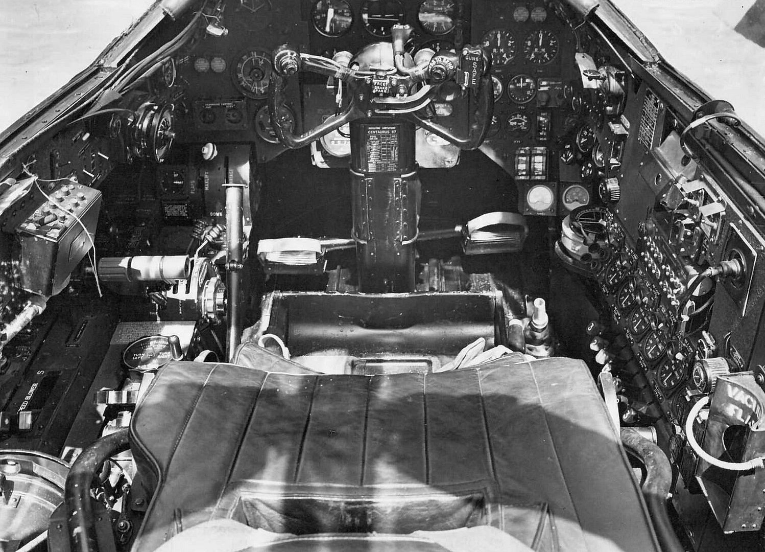

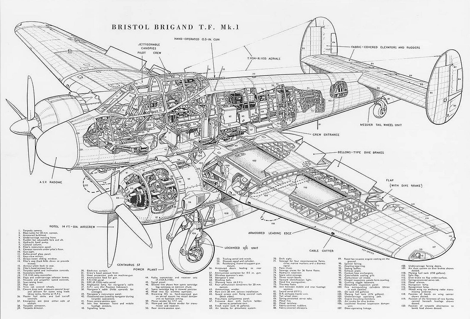

The Bristol design team led by Leslie Frise used the wings, tail and undercarriage of the Buckingham with a new fuselage of oval cross-section. The pilot, navigator/bomb aimer and radio-operator/gunner were grouped in the forward cockpit. In spite of the official change in its role to a bomber, the first eleven Brigands off the production line were completed as torpedo bombers. These early aircraft served with RAF Coastal Command from 1946 to 1947 before being converted to bombers.

As the Brigand became subject to more restrictions both unit commanders had serious doubts about the continued use of the aircraft. It was decided to continue operating them, since as long as thorough maintenance was carried out it was felt that nothing else could go wrong. Another design flaw arose in the leather bellows used to deploy the air brakes during dives. In the tropical climate, the leather would rot, causing the brakes to fail. This led to Brigands losing wings in dives due to excessive airspeed or rotation as only one brake deployed. When this problem was discovered the air brakes of all Brigands were wired shut, decreasing the aircraft's dive bombing capabilities.

Four prototypes originally with Centarus VII engines.MX988, MX991 MX994 and TX374.

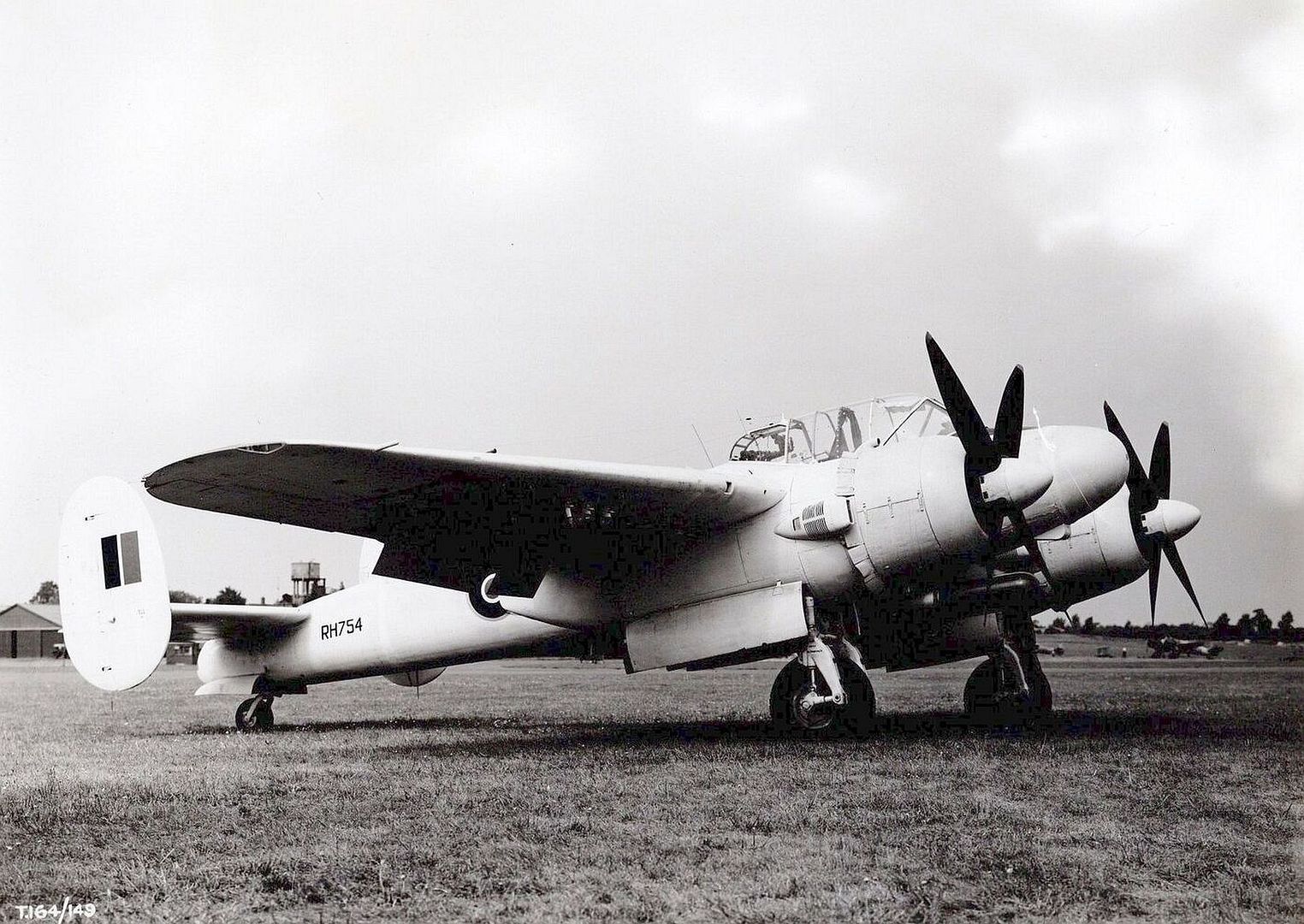

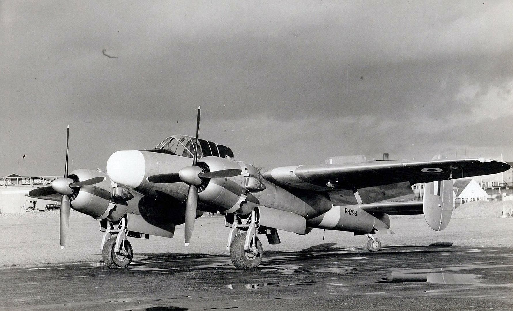

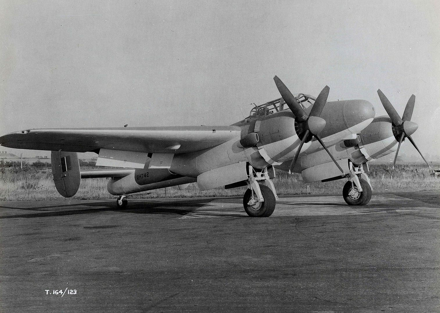

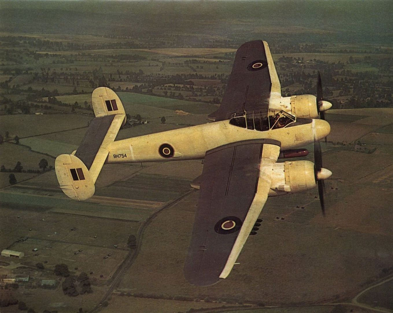

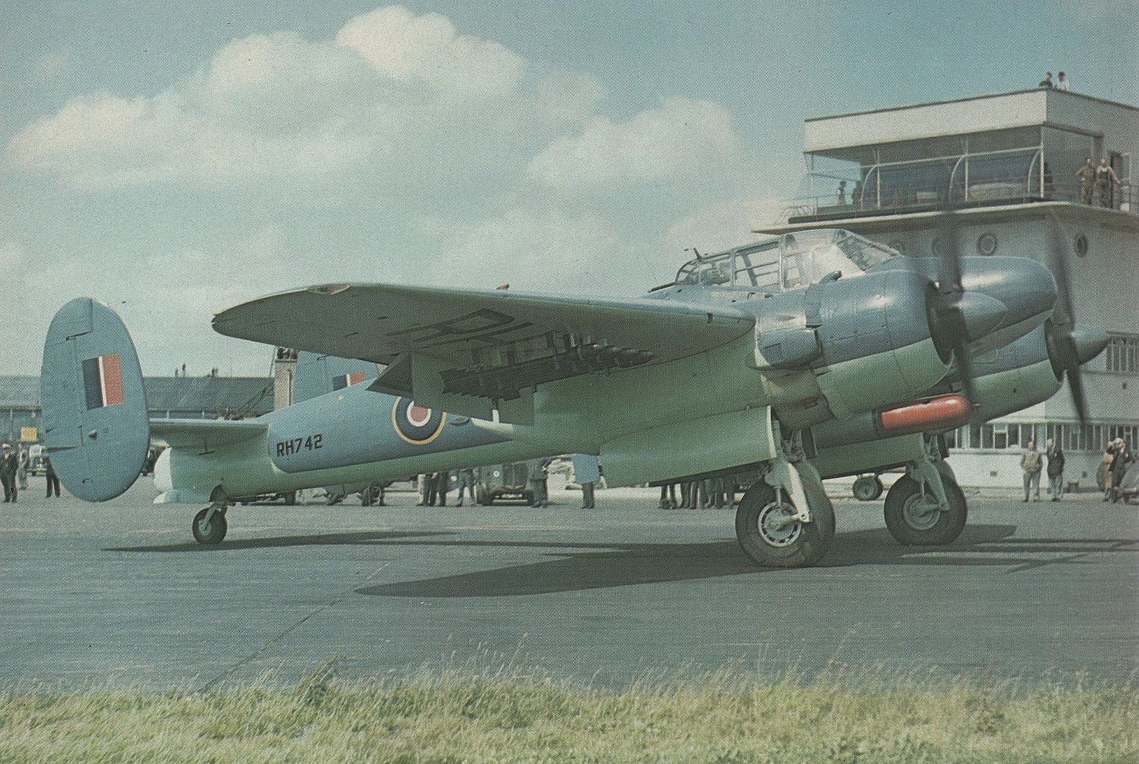

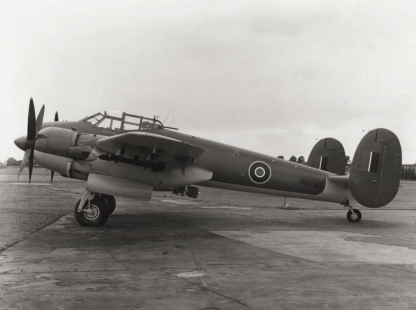

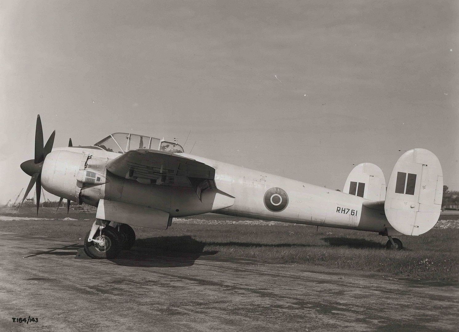

Brigand TF.1
Production torpedo-bomber variant, 11 built later converted to B.I. inc RH742, RH744,RH746,RH748, RH754,RH761 and RH797

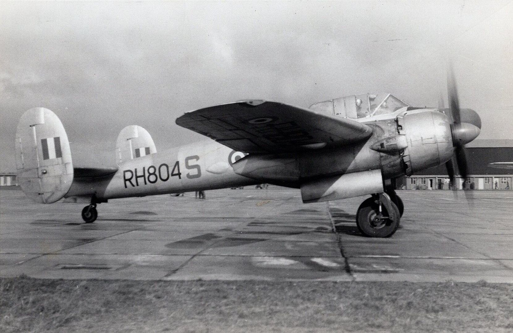

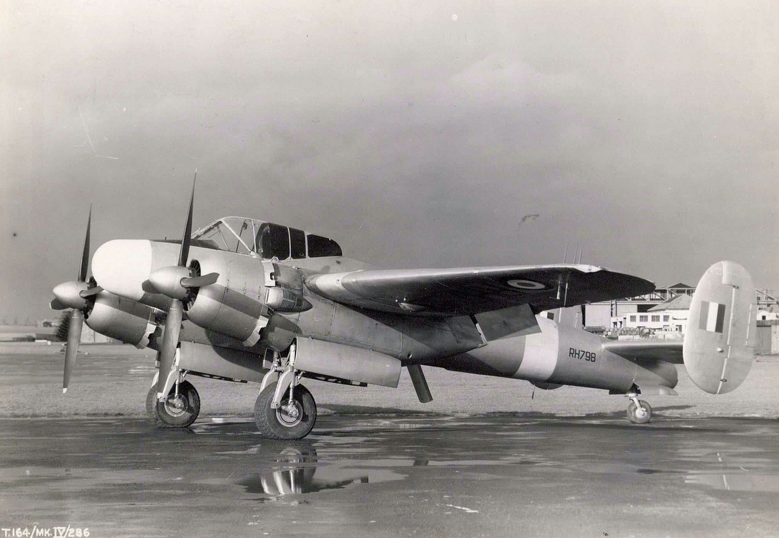

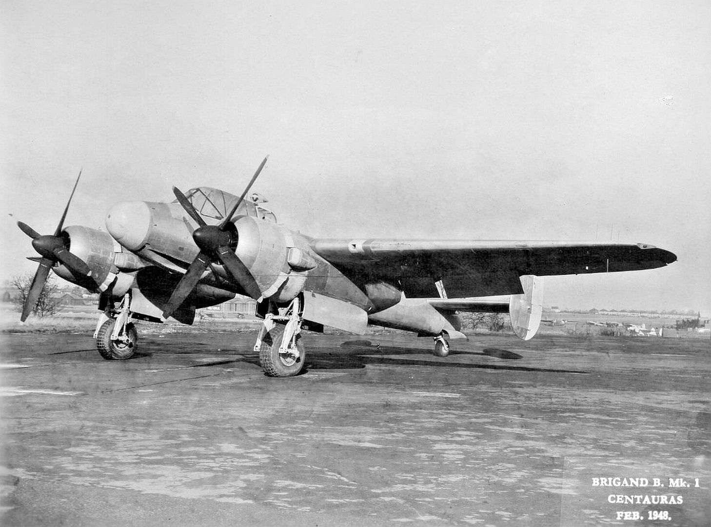

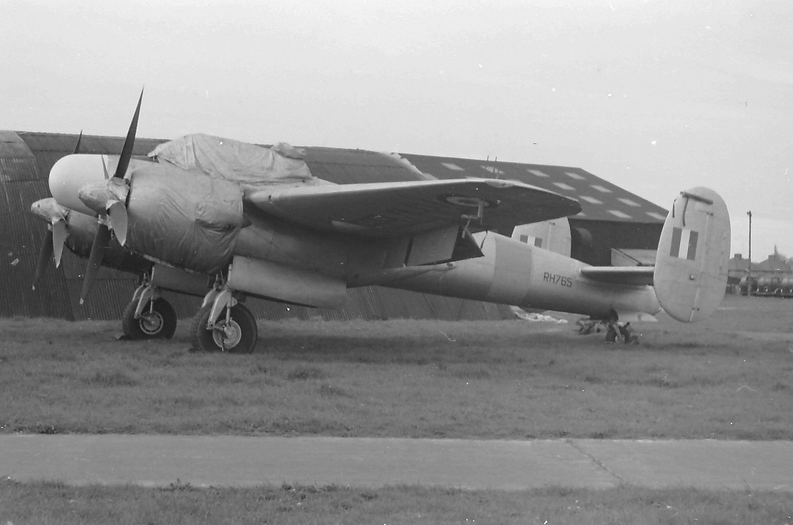

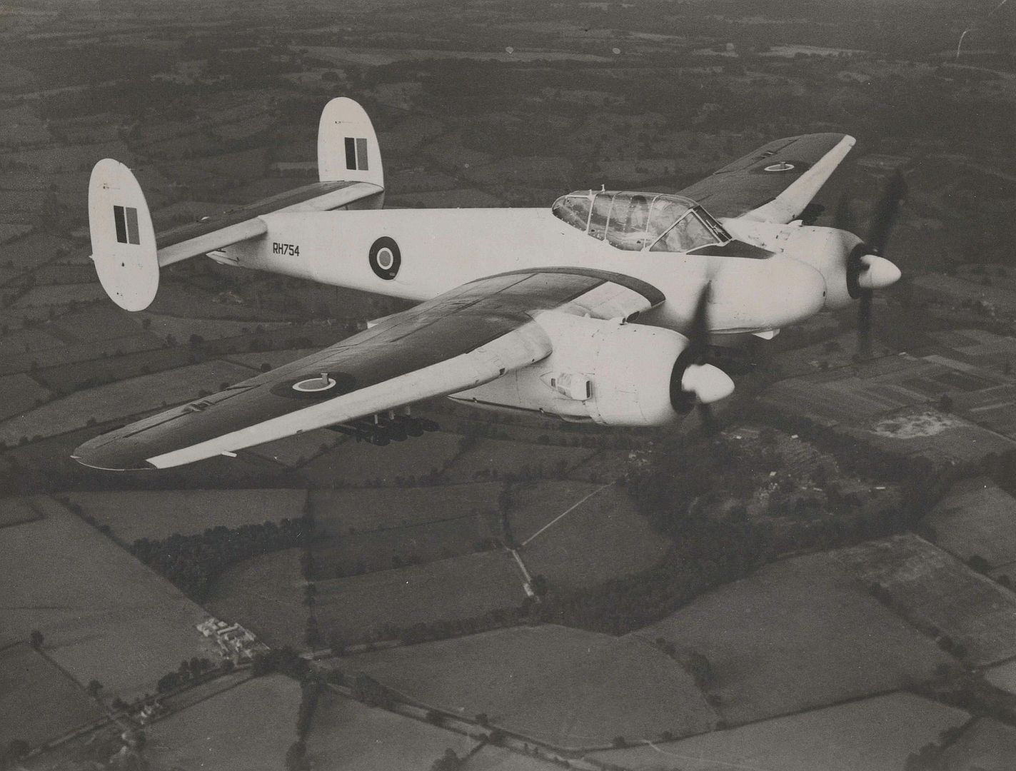

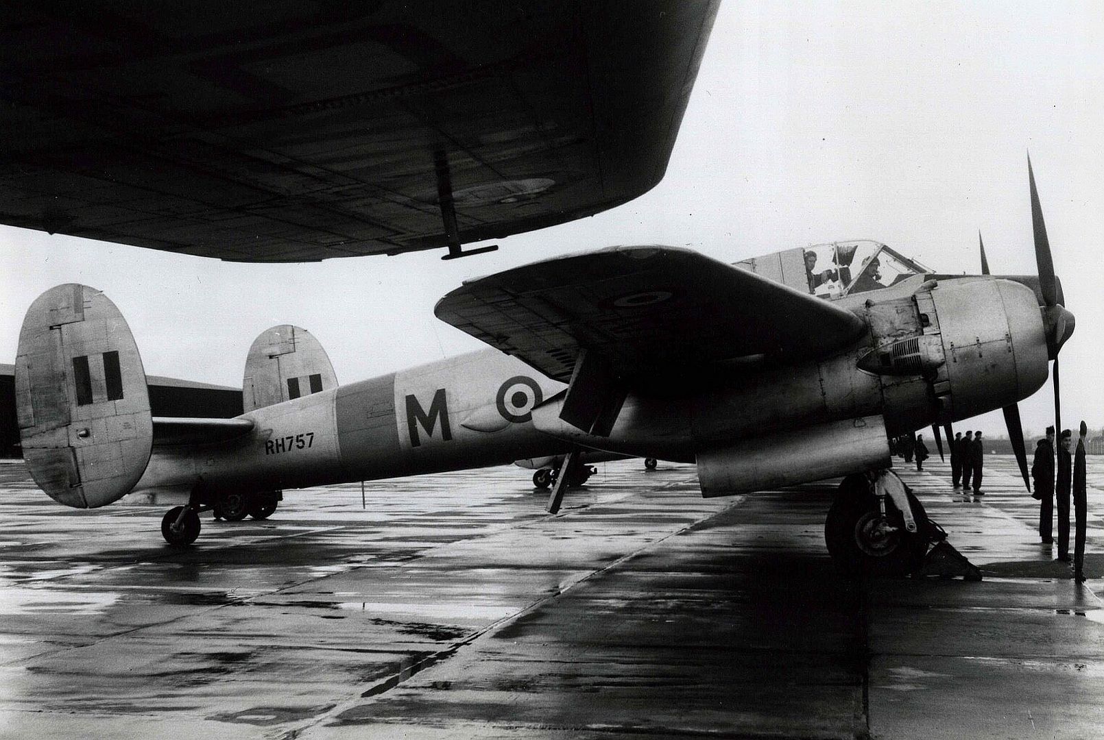

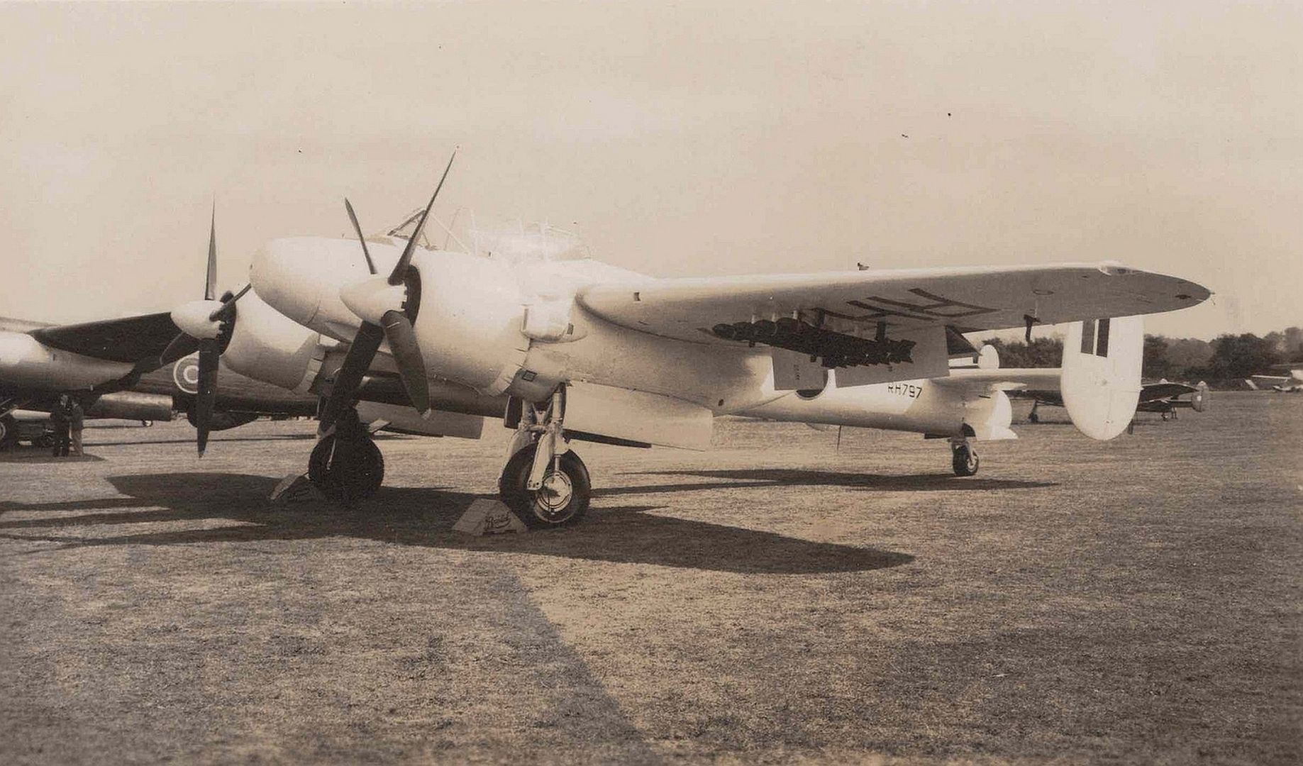

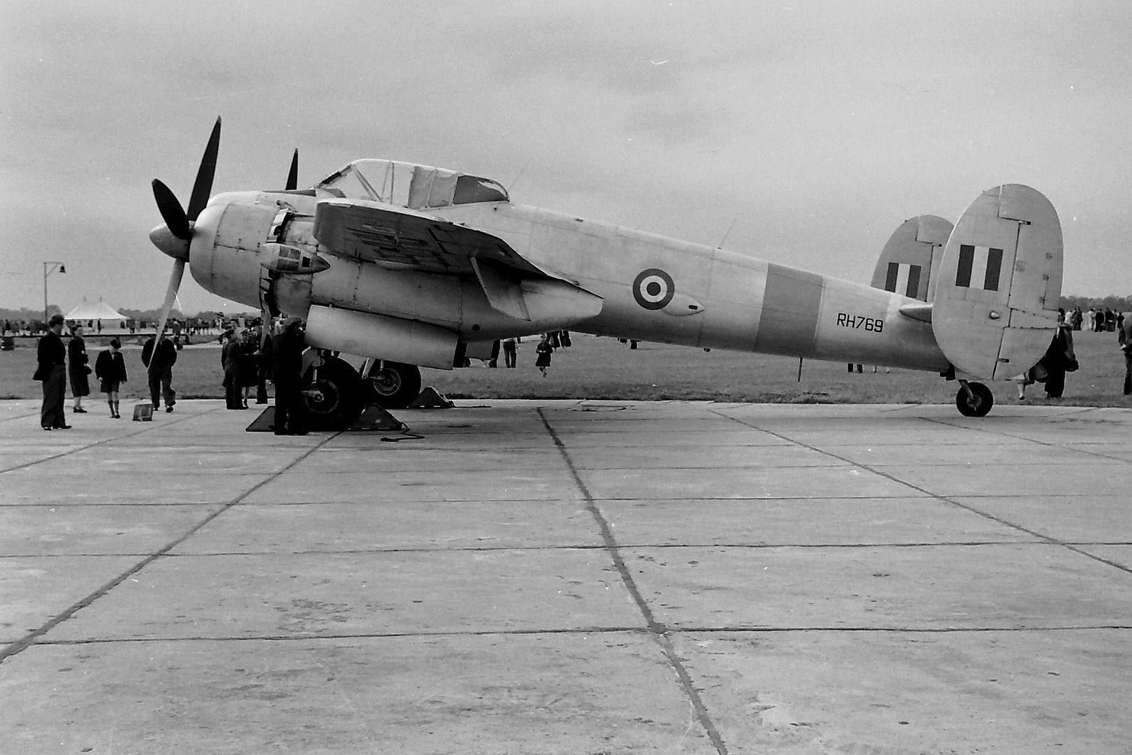

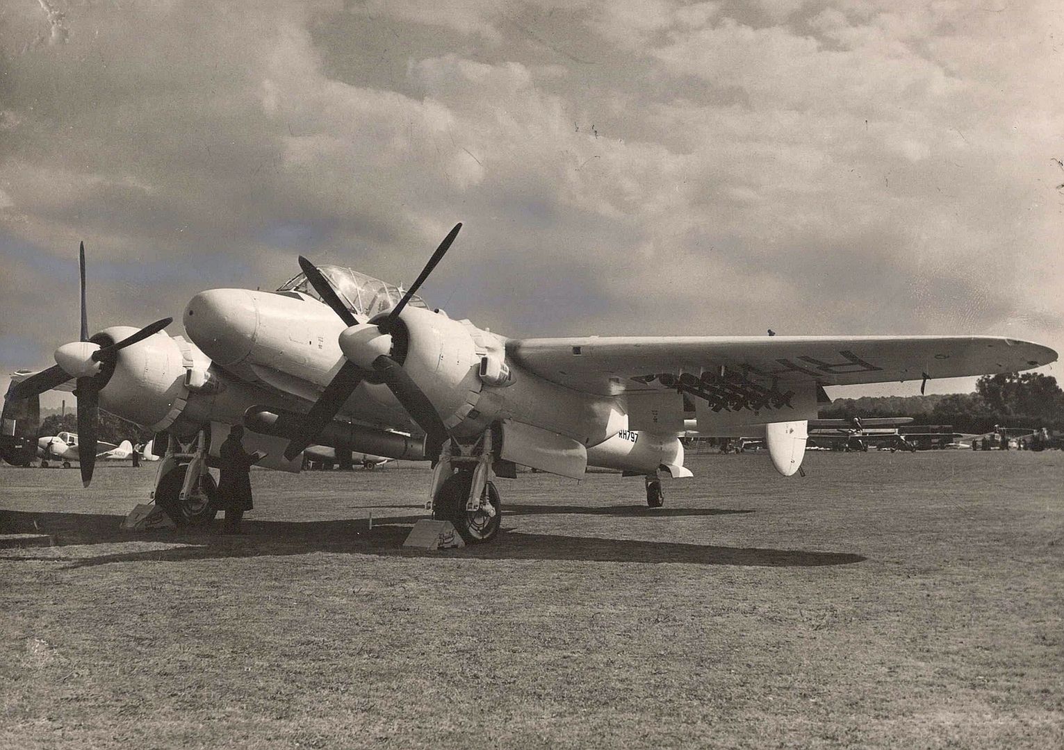

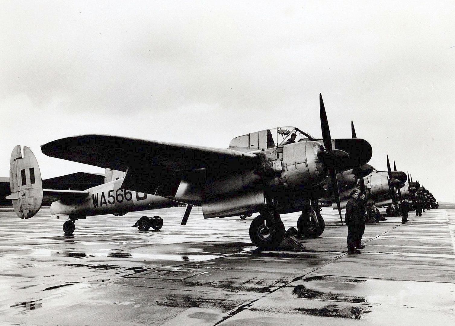

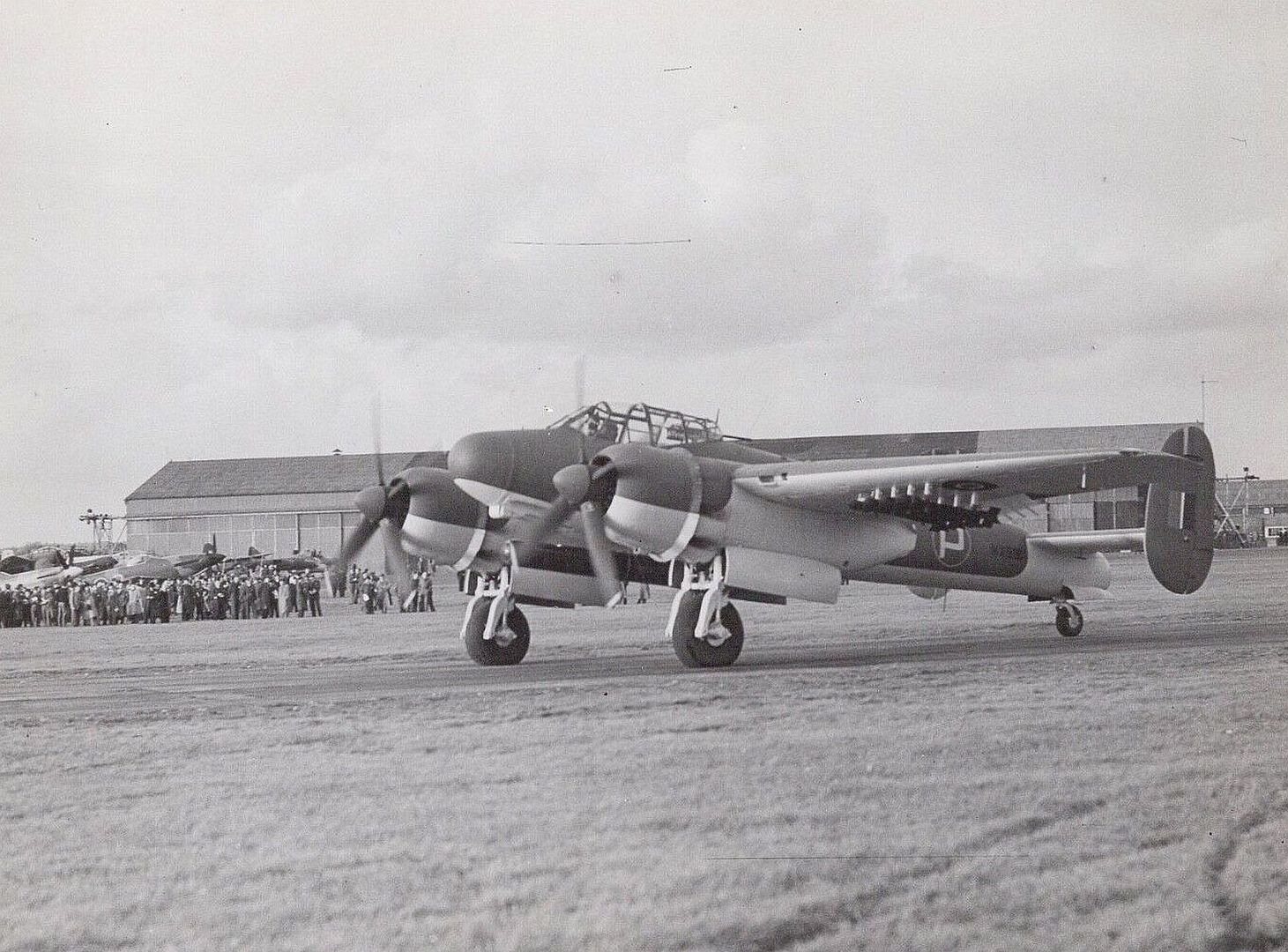

Brigand B.1
Bomber variant, rear gun removed and external bomb racks and rails for rockets added, 106 built and 11 conversions from TF.1
RH742 – RH777, RH792-RH832, RH850-RH852, VS828-VS839, VS854-VS877, WA560, WB236.

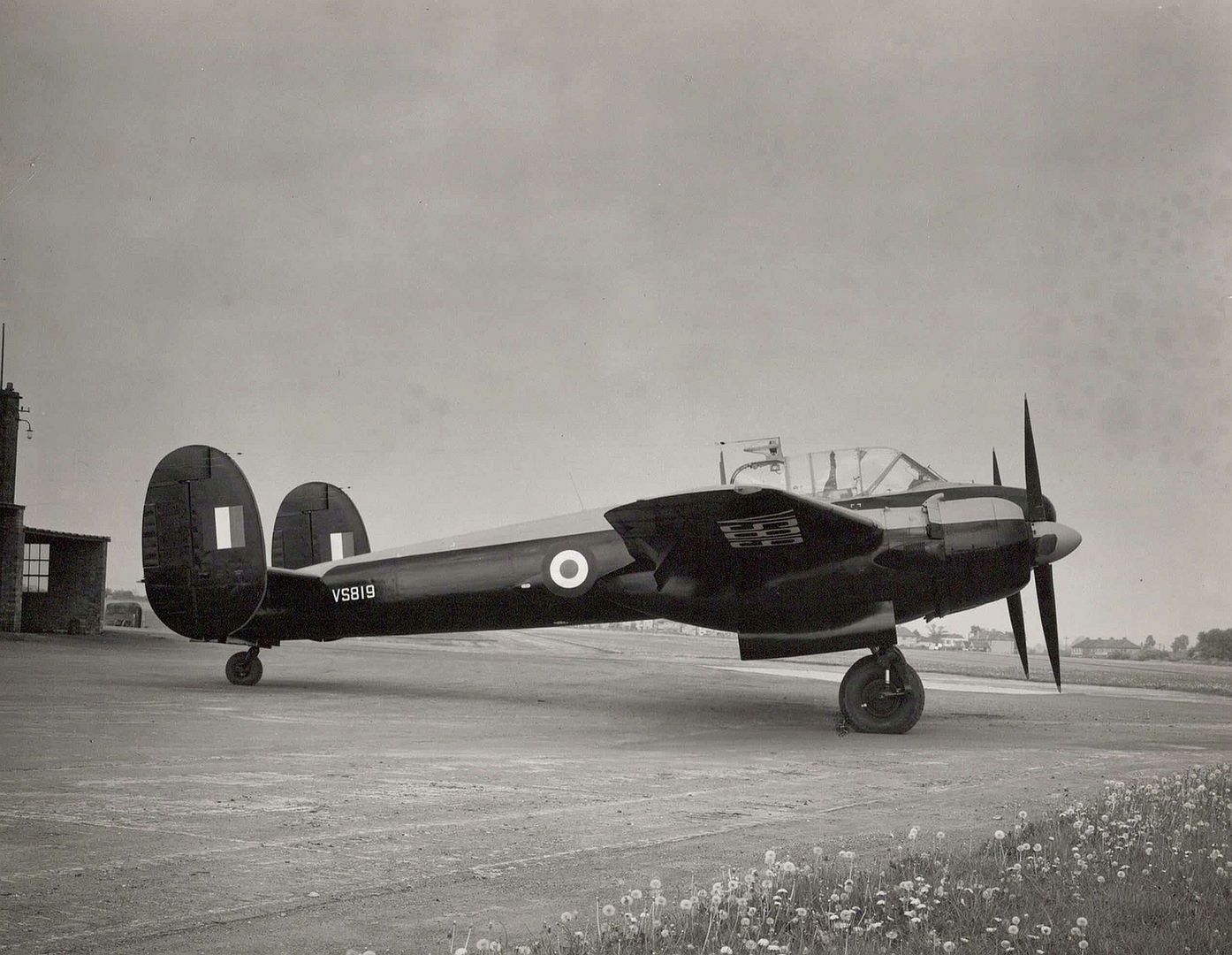

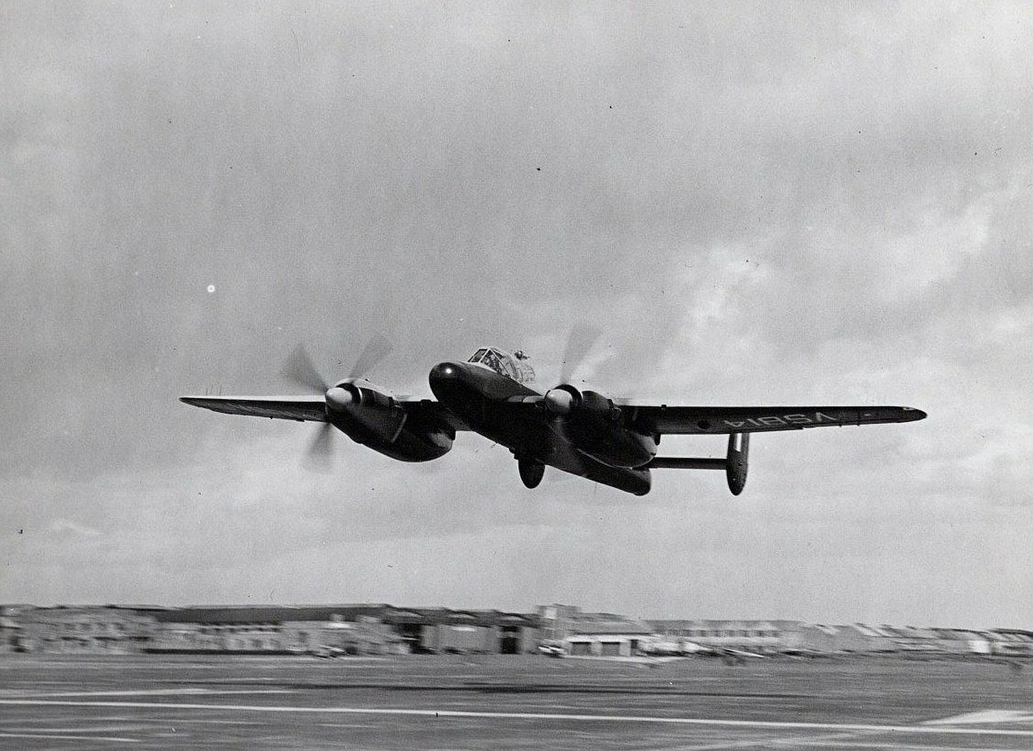

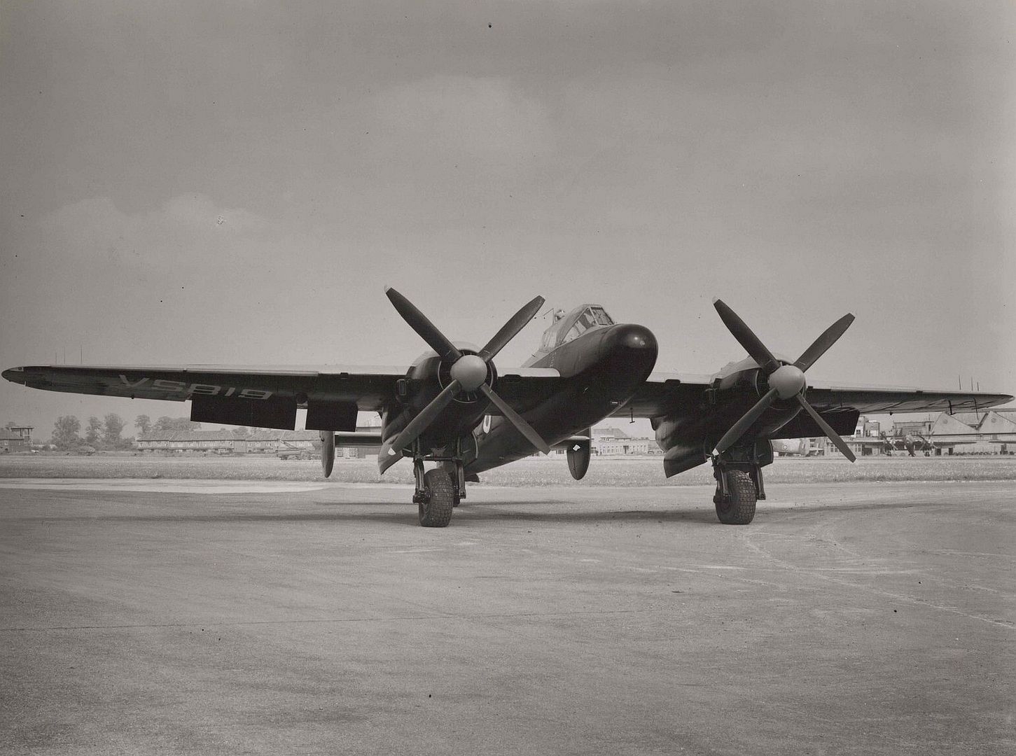

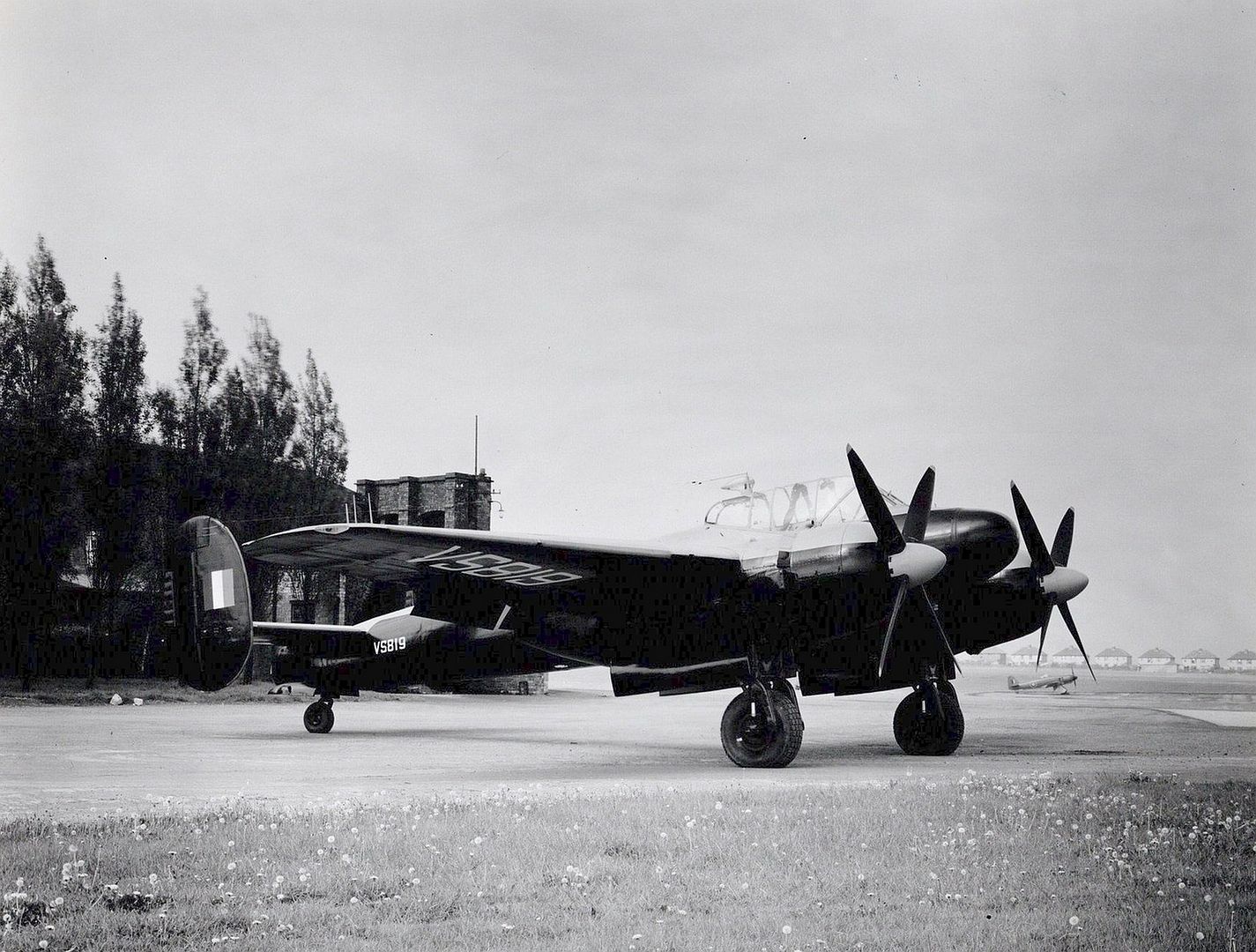

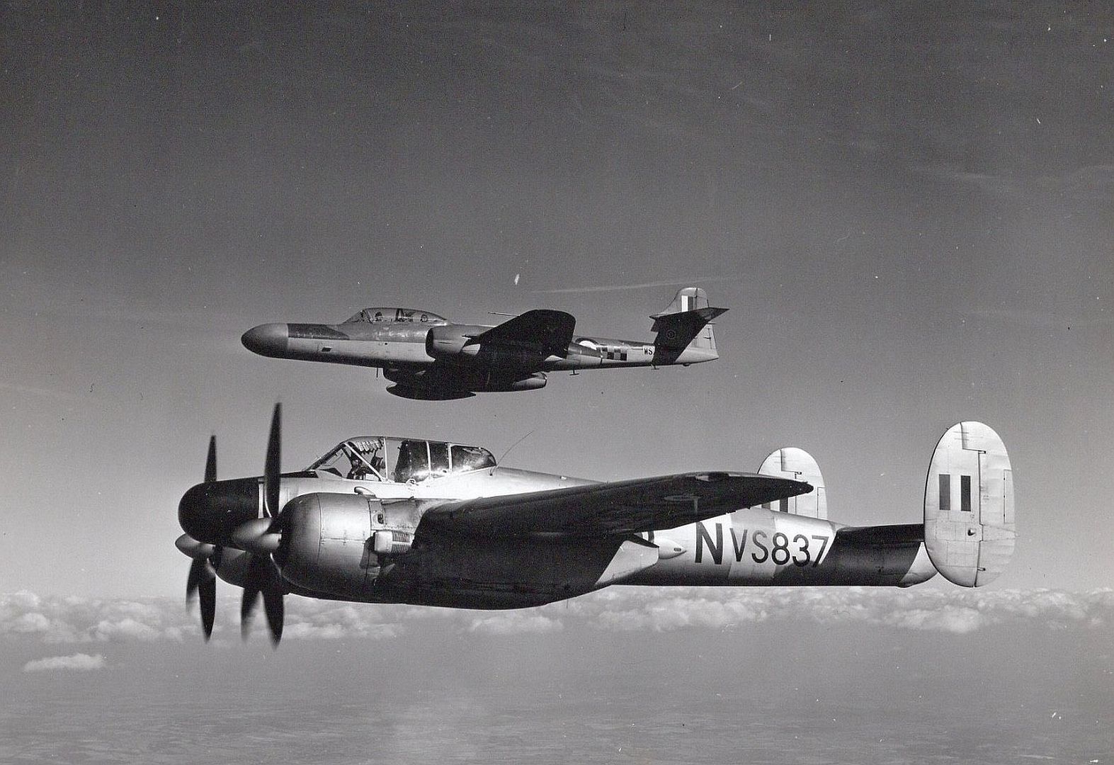

Brigand MET.3
Unarmed meteorological reconnaissance variant, 16 built.VS812-VS827

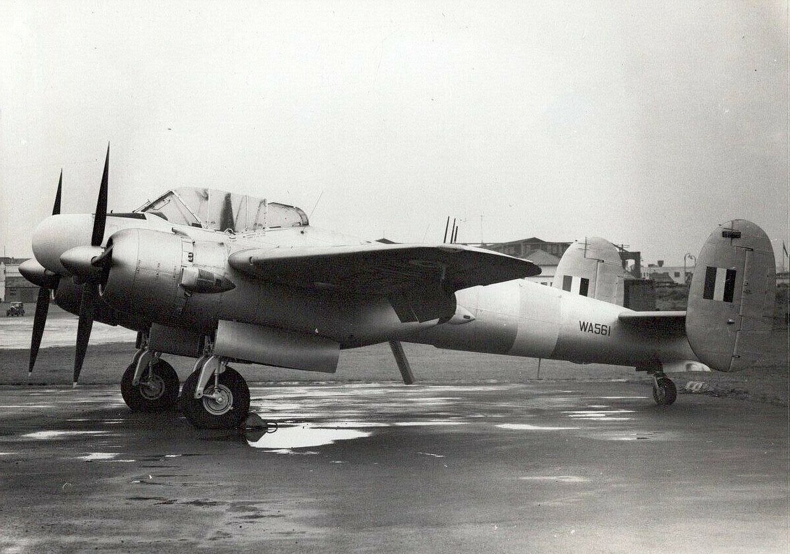

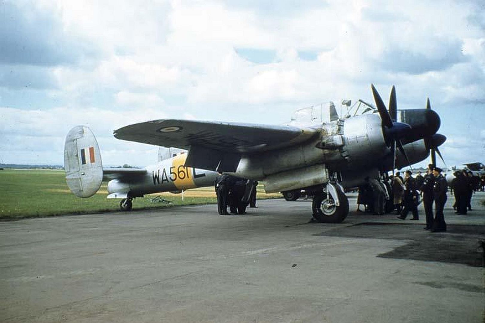

Brigand T.4
Trainer variant, used to train aircraft interception (AI) radar operators, nine built, survivors to T.5 standard.WA561-WA569.
Brigand T.5
Improved training version, which like the T.4 before it, was used to train AI radar operators, conversions from B.1 and T.4.
