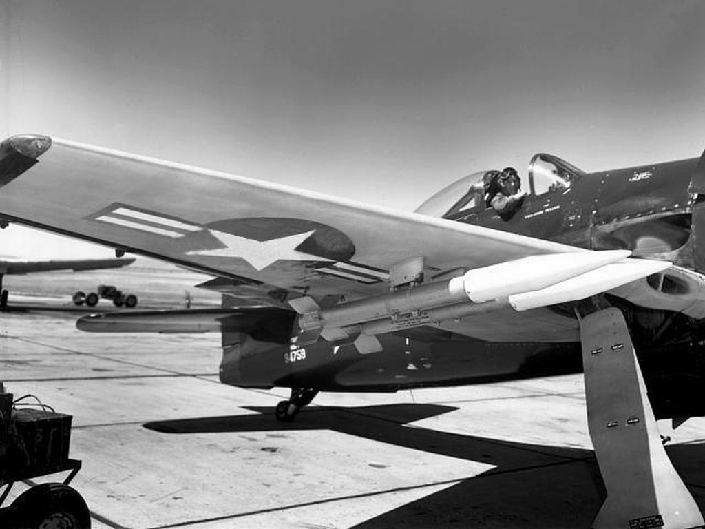

    Internal fuel supply was 694 liters (183 US gallons). An external fuel tank with a capacity of 585 liters (150 US gallons) could be carried on a centerline pylon, while a 379 liter (100 US gallon) external tank could be carried under each wing. A 450 kilogram (1,000 pound) bomb could be carried under each wing as an alternative store, with two stubs outboard on each wing for 45 kilogram (100 pound) bombs or HVAR rockets as well. Photographs also show Bearcats carrying two big 29.2 centimeter (11.5 inch) "Tiny Tim" unguided rockets in trials. Total external stores load was 1,090 kilograms (2,400 pounds).

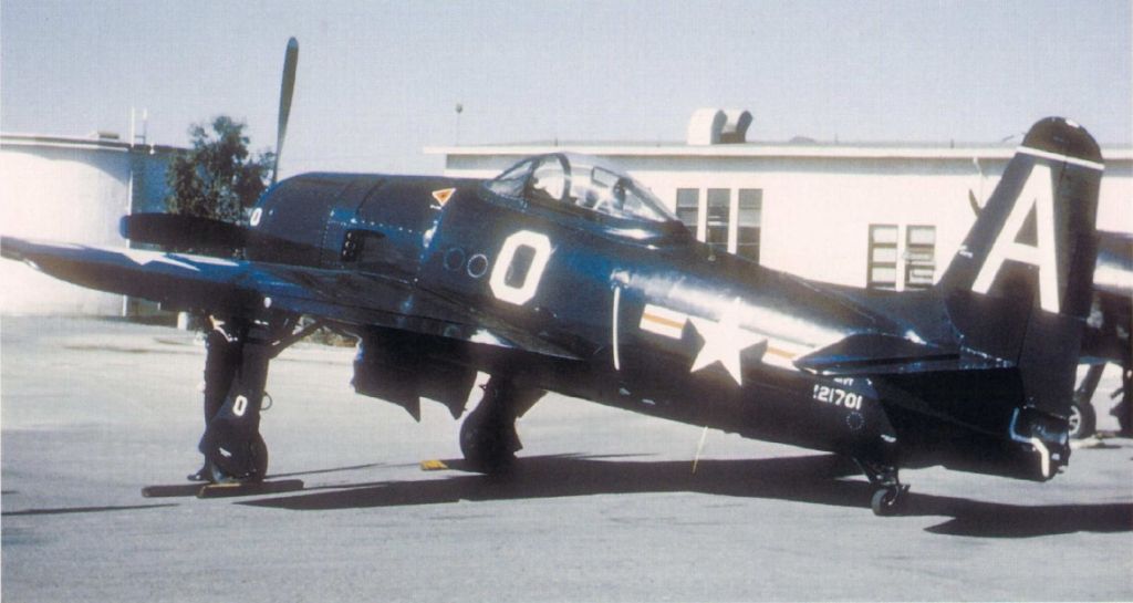

    Pilots were not particularly happy about the light armament, and so a hundred Bearcats were completed with four 20 millimeter cannon instead of four 12.7 millimeter Brownings under the designation of "F8F-1B" (initially "F8F-1C"). These machines were rolled out in parallel with the F8F-1, with 226 built. Two "XF8F-1N" prototype night fighters with AN/APG-19 radar in an underwing pod were rebuilt from F8F-1s, leading to the production of a small batch of 13 "F8F-1N" night fighters, also as updates.

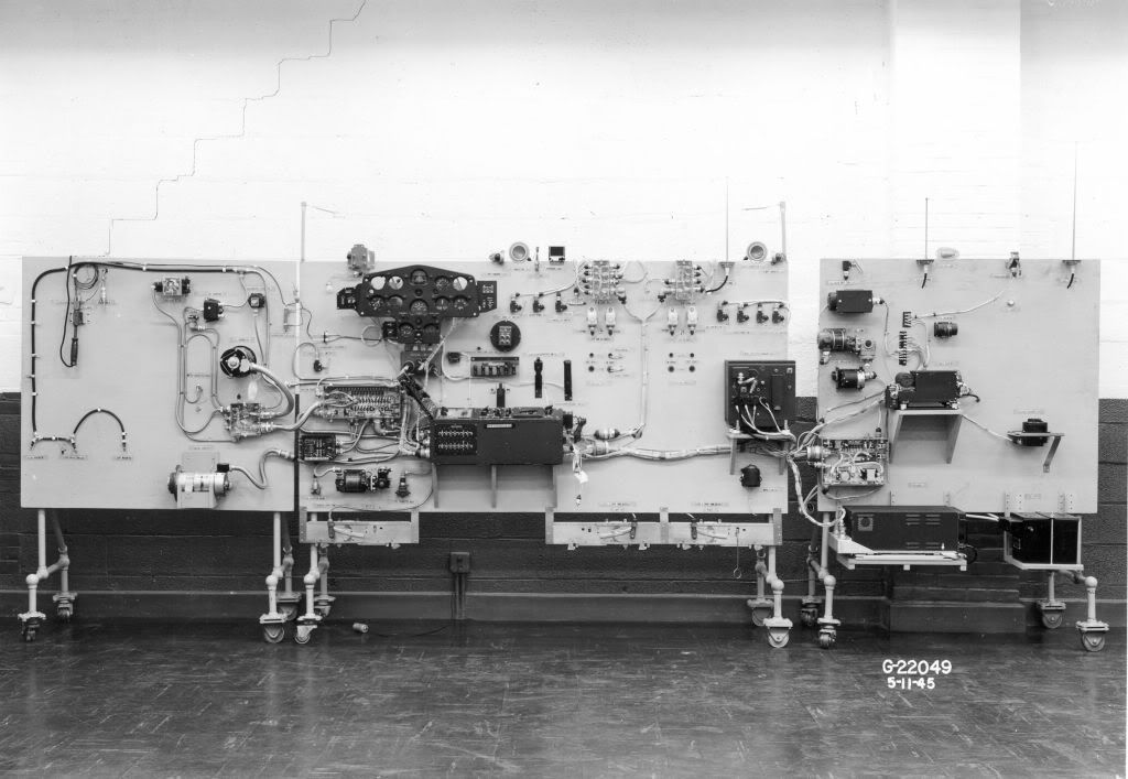

  • Hmmm.... "G-22344" looks like it had a run-in with a Buick Roadmaster or something smile
